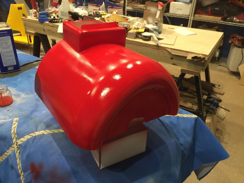

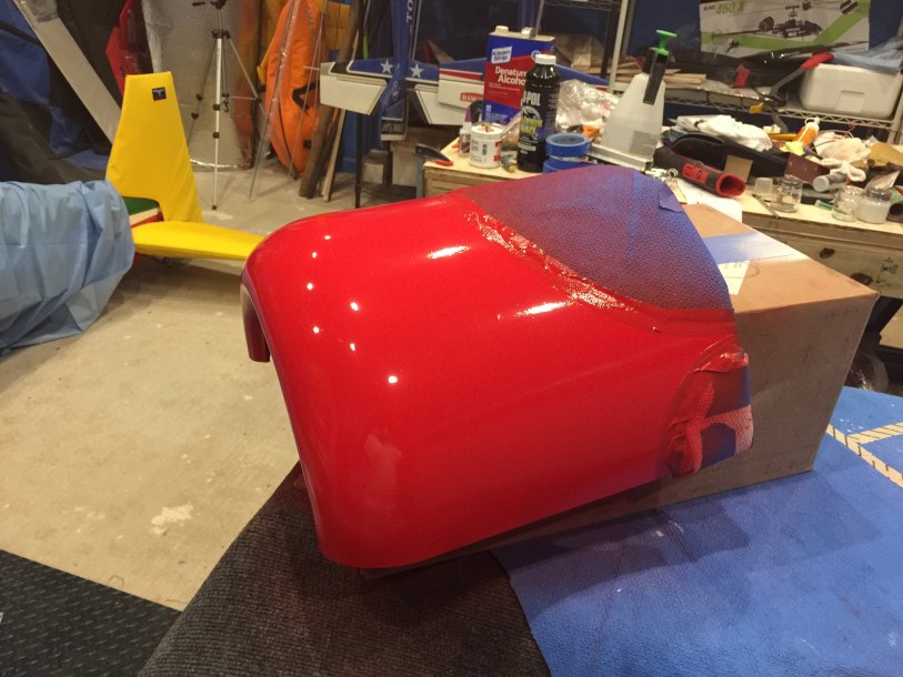

2. When applying paint, he recommends:

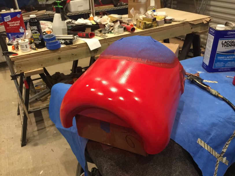

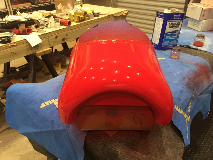

Film thickness should be built up by applying successive thin coats of paint and allowing about 20 minutes "flash off" time between coats.

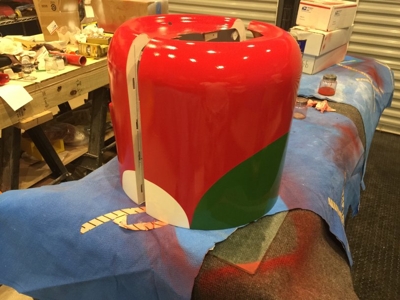

3.  After 4 hours, you can apply masking tape to the painted surface, if you then have to apply a different color.
4.  You can use his clear as well. You can sand down the painted surface, then apply the clear.  SO you must work fast if you want the chemical bond of all the layers!!!

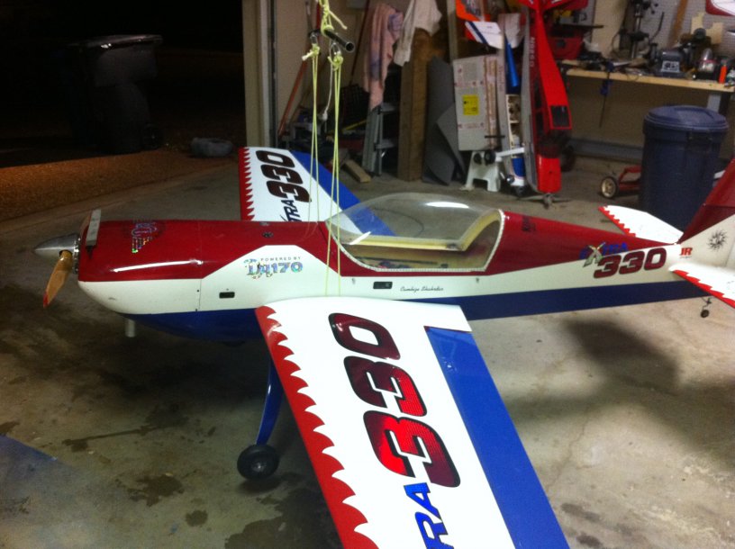

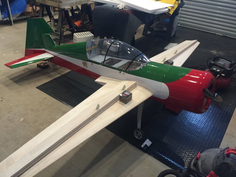

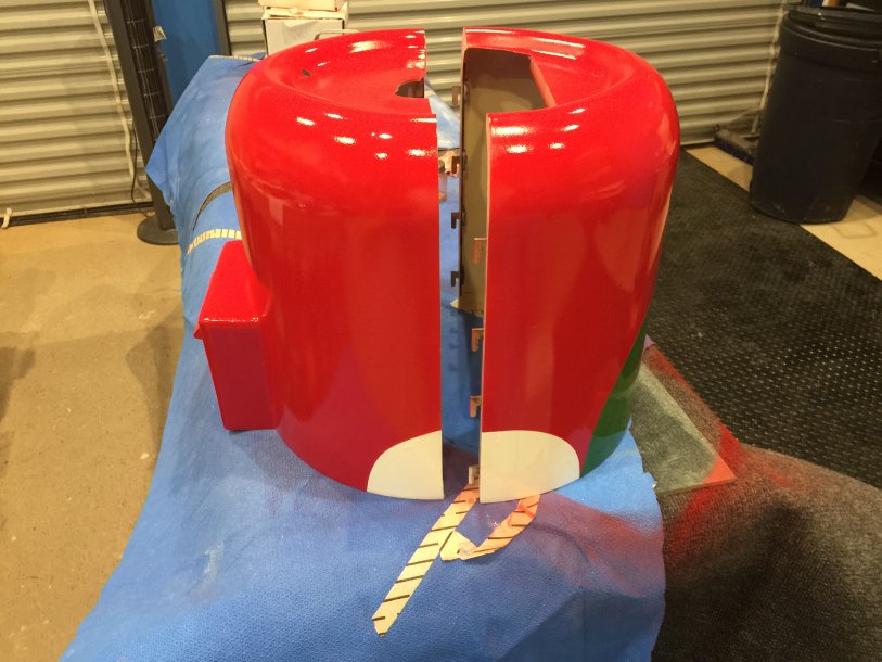

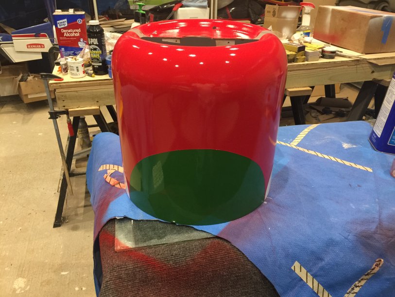

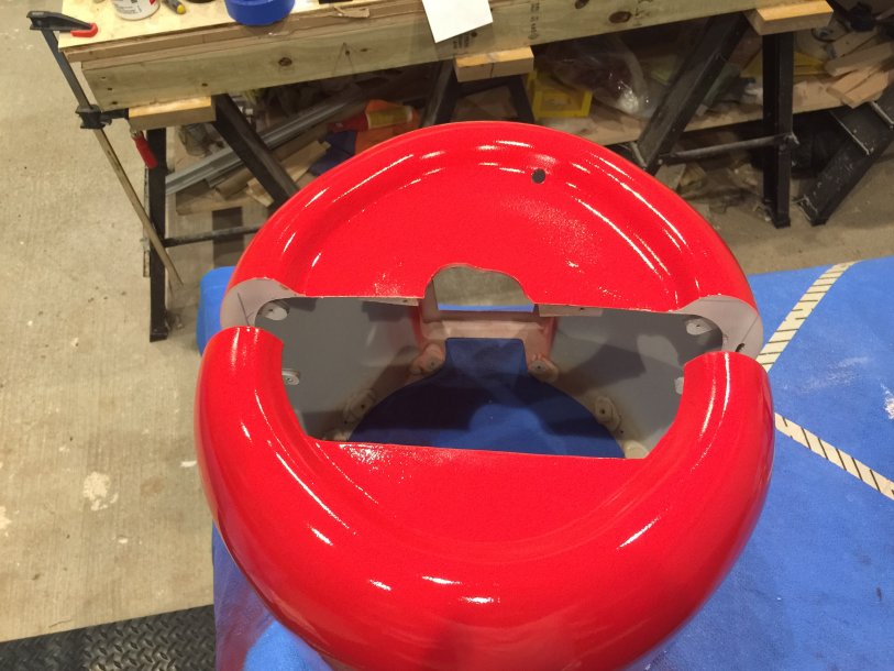

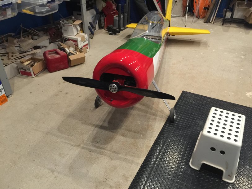

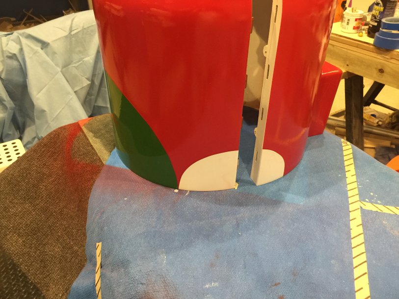

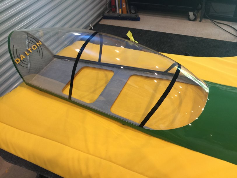

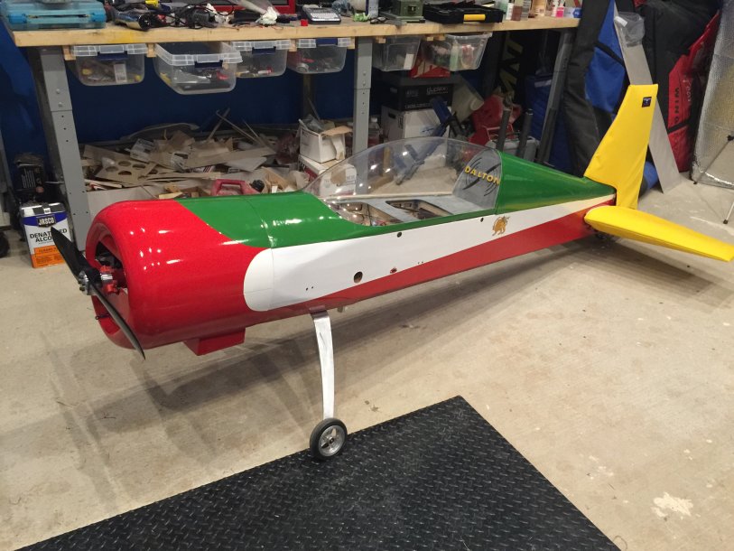

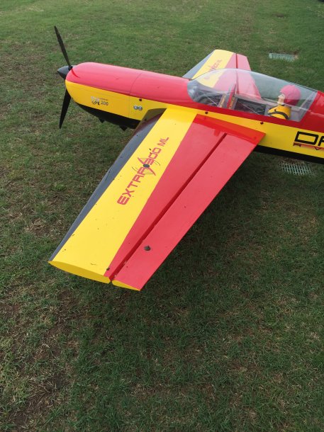

(and I am not an expert at this, but this is my 3rd airplane that I have painted with Klass Kote)

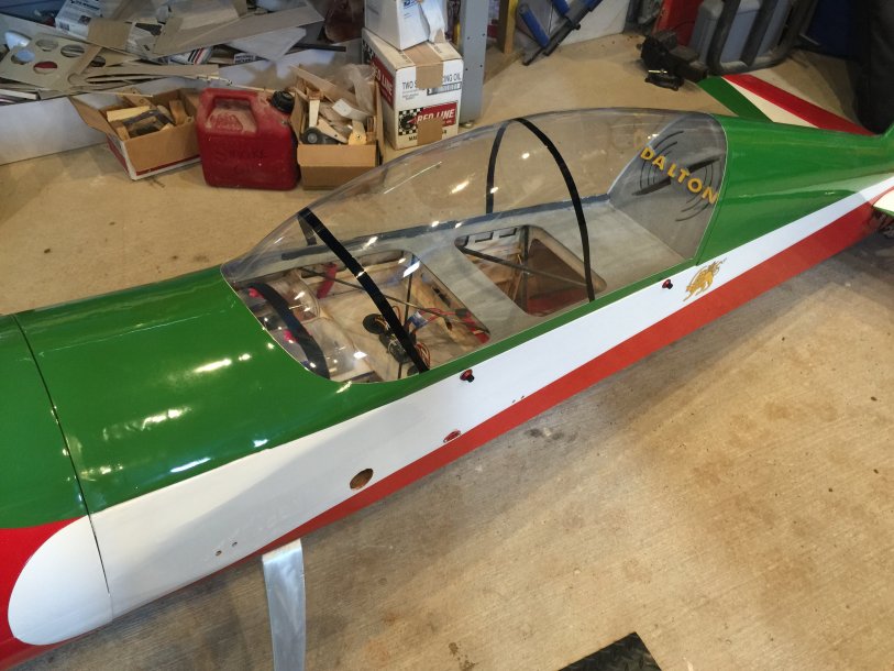

 the cowl and canopy are painted, every thing else is monokote.
On this one, this is a 3W extra, and the fuselage is painted, only thing covered is the wings and stabs, everything else is Klass Kote paint.
