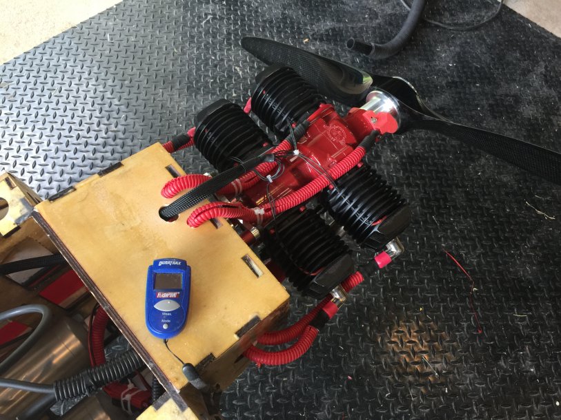

OK, once she warmed up, the front cylinders are 30 to 50 degrees cooler than the rear cylinders.  This is based off the telemetry sensors, and with no cowl or shroud on.
range was 180 to 240 among all 4 cylinders, with higher temps in rear 2 cylinders..
I also checked the cylinder temp on telemetry and compared to the IR, and temp was within 5 degrees.

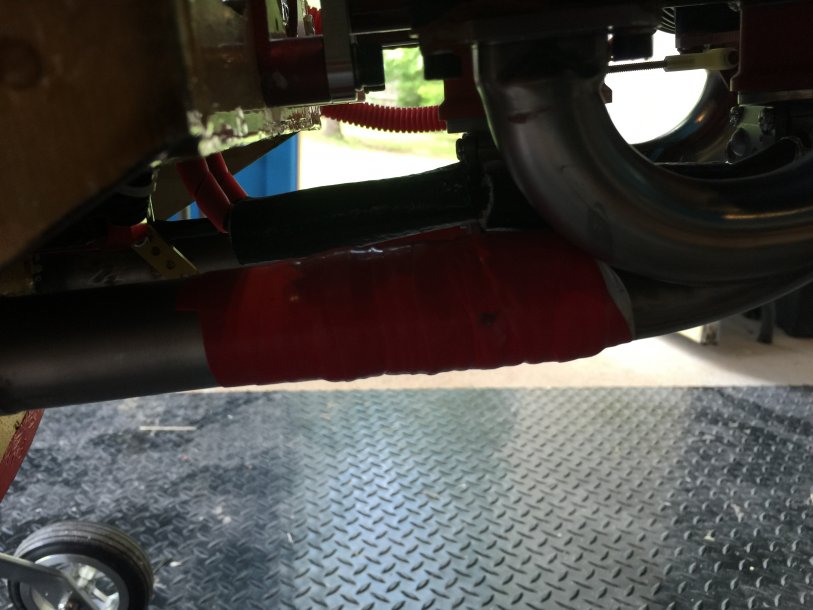

I also checked the temp of the header using the IR gun, as pictured , and this had a temp of 200 F.
the temp of the canister was 105 to 110 F.
pretty cool!!
these temps were taken while the motor was running.
