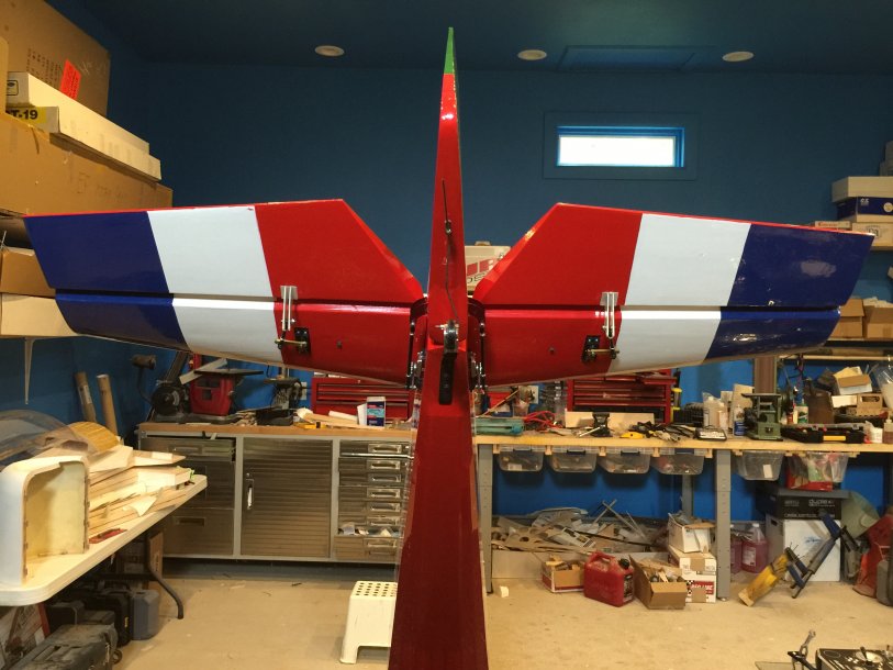

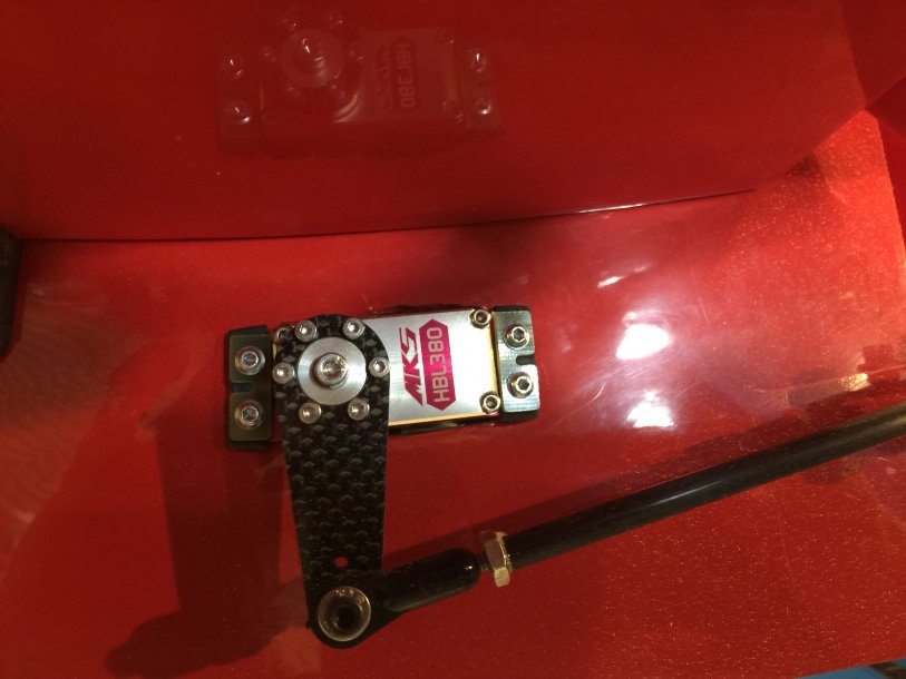

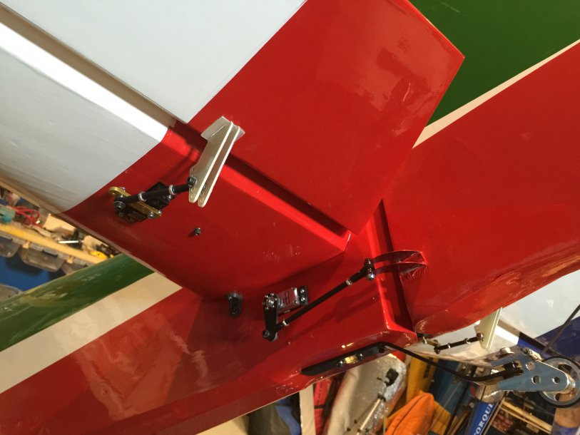

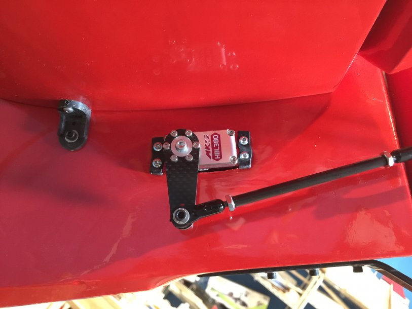

ALL THE TAIL servos are installed and programmed! I made the pushrods myself. They are 6-32. Also, the ball links are all DUBRO monster ball links, 6-32. I am not painting the control horns or any of the wood in the inside of the fuselage or the motor-box. The motor box and fuel tank tray has had brushed on, thinned epoxy resin.
I matched the rudder servos using an amp-meter.

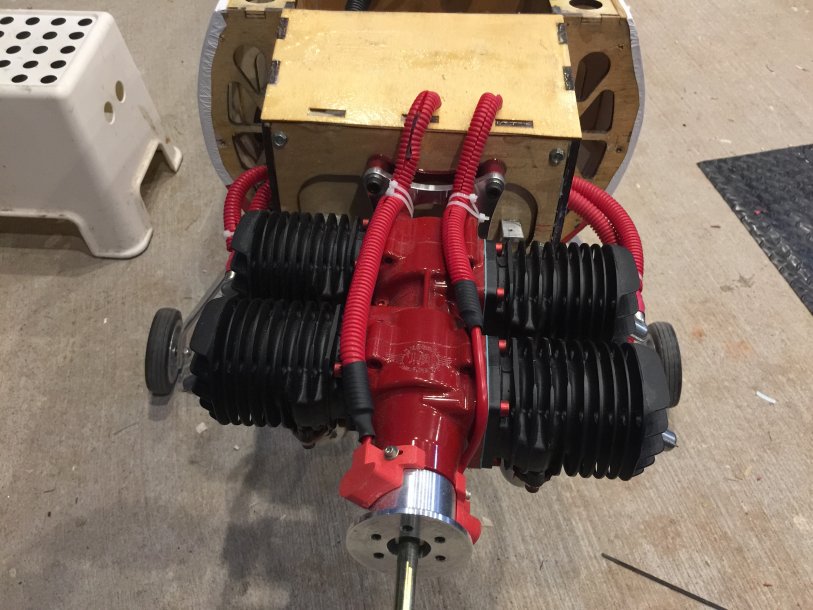

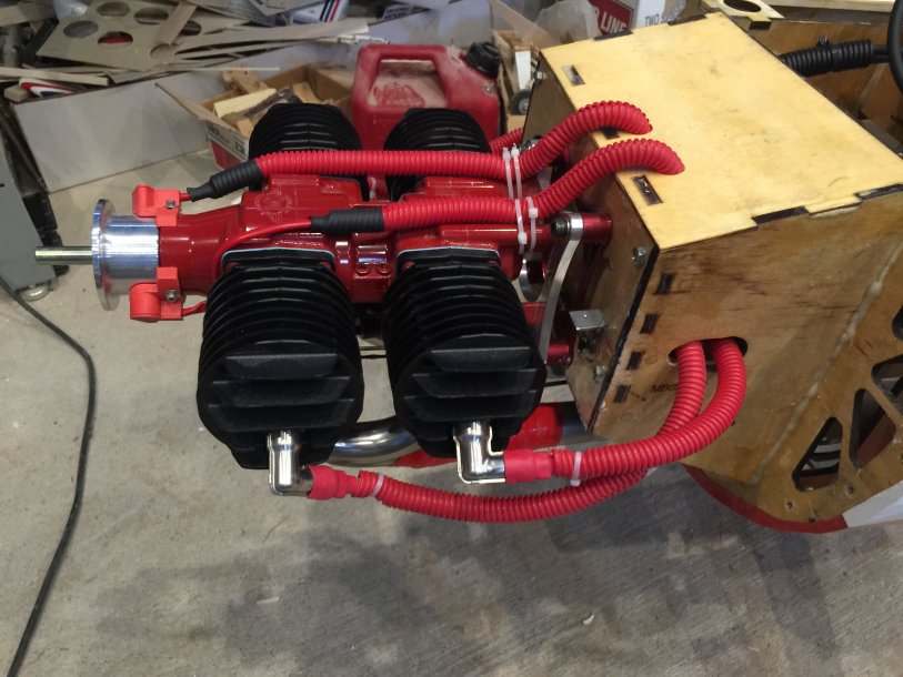

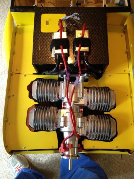

The motor and all necessary electronics are installed, as well as the CDI, the IBEC's X2, etc....
Next step is to install the telemetric sensors.
Before i forget, i need to make sure i tighten the spark plugs!! do not trust anyone!! well, sometimes, these plugs are not tightened so be sure to always tighten them before you fly!
