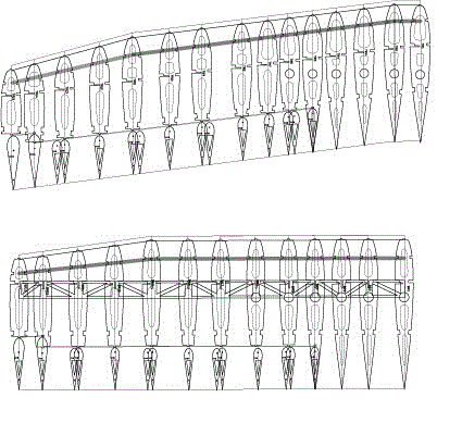

A few more additions to the top and bottom wing. I think this will do it. Unless we have more ideas to add. https://www.GiantScaleNews.com/forums/images/smilies/209.gif
But I thin this looks like a solid wing construction with features included that aid in building a straight wing with interlocking parts.

Some info on laser cutting. I have done quite a bit of CAD drawings, and I learned here and there a few things. When you draw something, for example a slot for stock balsa, you always compensate for the laser. It is just like your circular saw or band saw. You never cut on your line but a little bit over, otherwise your part is not the right size. Same goes with the laser. As for making other scale kits, I simply can not redraw every size kit people are requesting. As for now I have drawn a 100" wingspan, as this was the original size we planned to have, but then went to 86.5" wingspan. All slots and notches for the two sizes are made for standard stock balsa. Going smaller then 86.5 or larger than 100" will obviously have bigger or smaller slots. However they would be so minimal that an experience builder will have no trouble to go about it. Also, I will only have cowl, canopy and wheel pants for 100" wingspan available, in case somebody is interested.

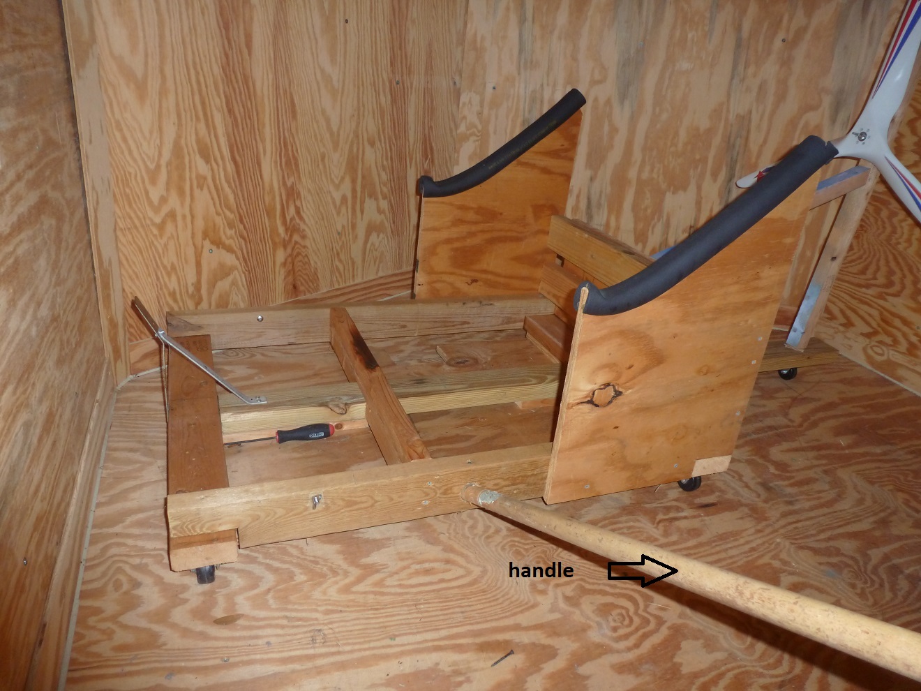

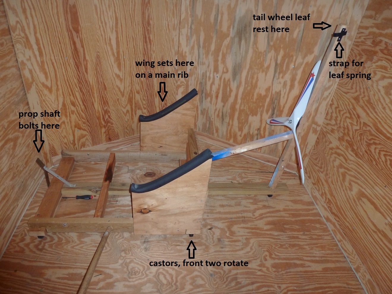

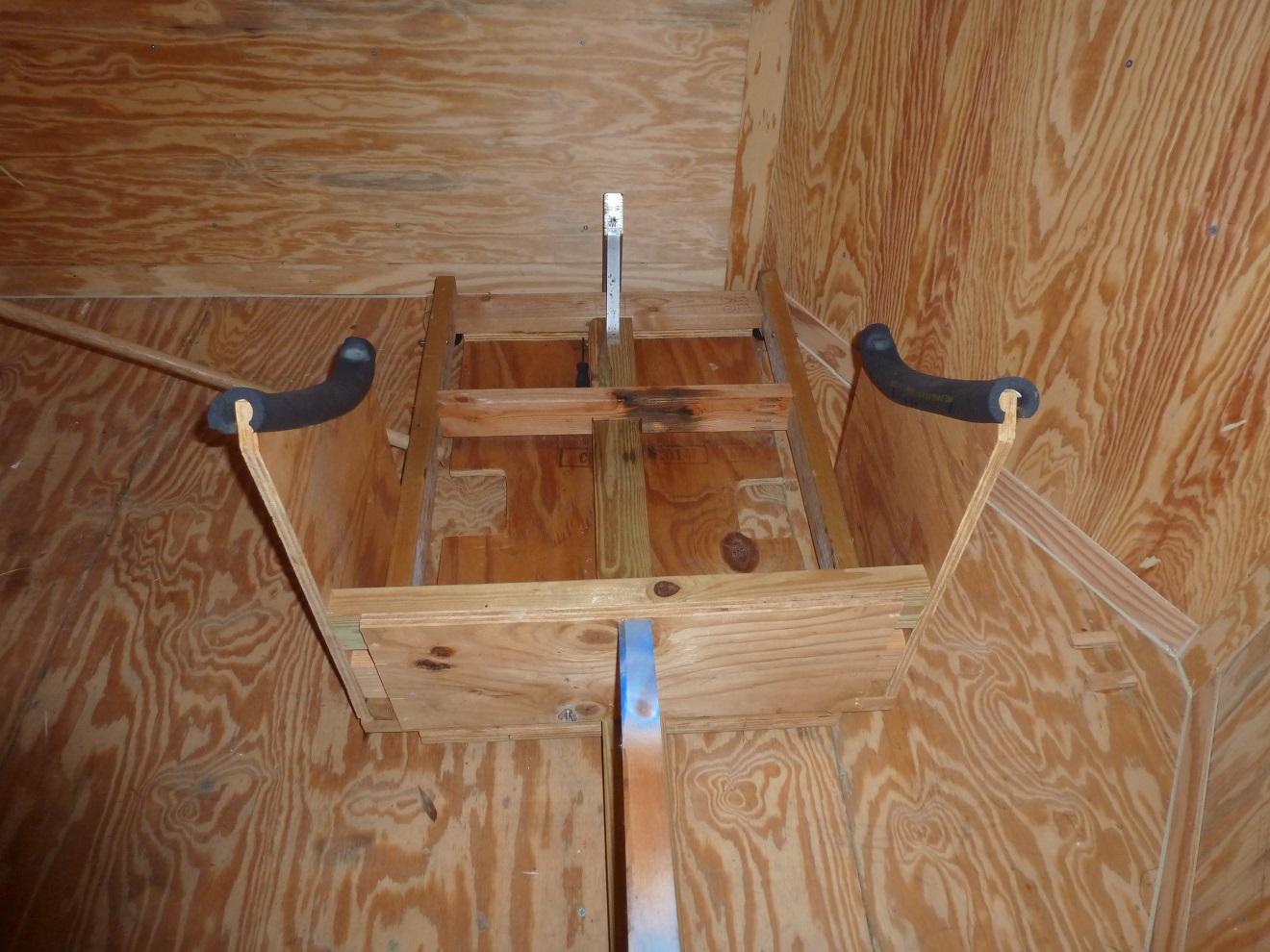

Hey @Wacobipe, I finally got around to taking a couple pics of the dolly.

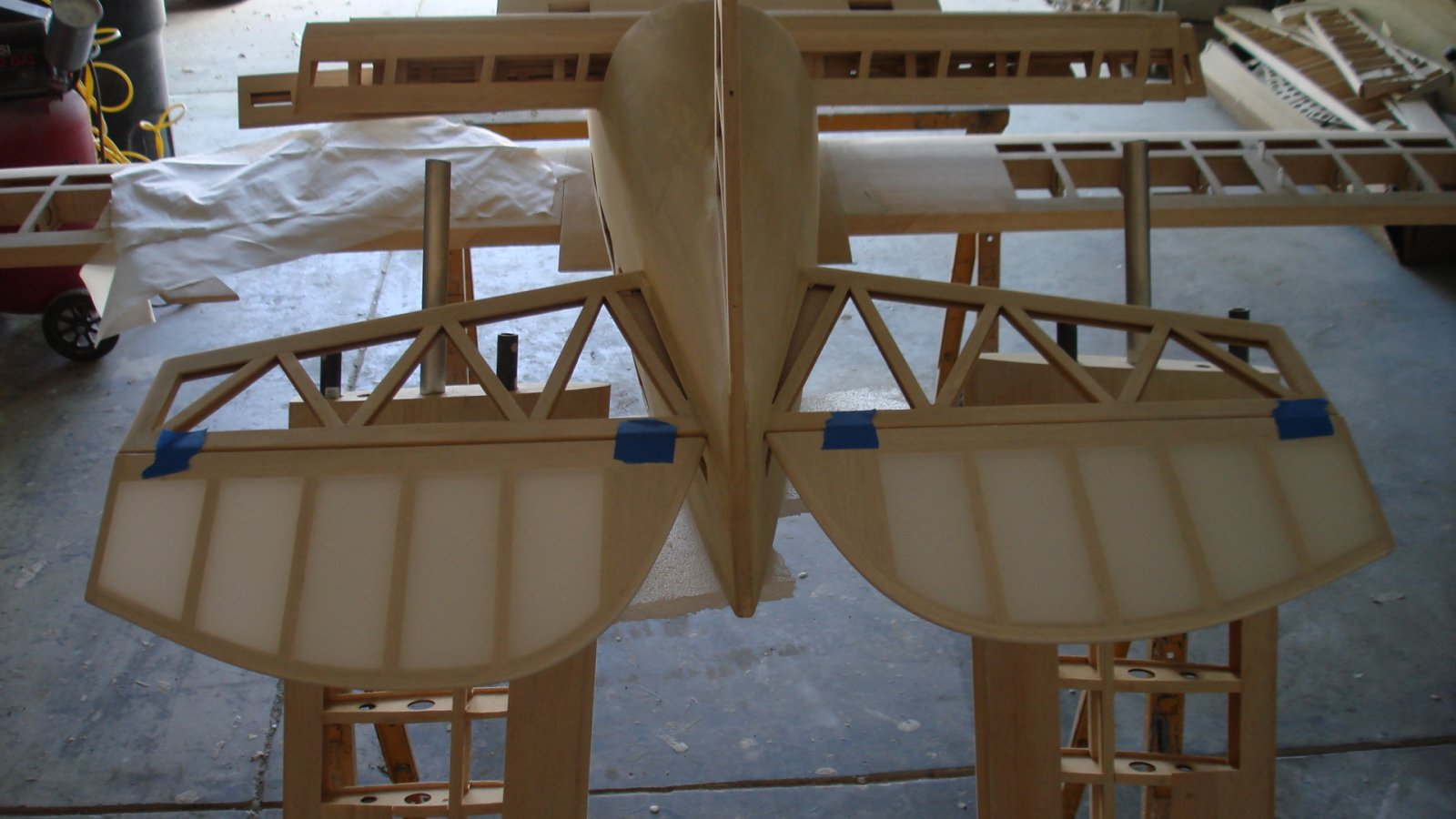

Curious as to which method you are using for adhering the fabric? I don't see the discoloration of the Polytak, or shading of Stixit.
Blazing Wings
You lucky dog! I am through the construction part of the remodel. Should be starting the painting next week so it won't be long now. I am getting a bit homesick so really pushing to get done.
Just brushed on polytak, dries almost instantly, then ironed on the fabric. Maybe Polytak changed the recipe?? There is no discoloration.
Not using stixit.
