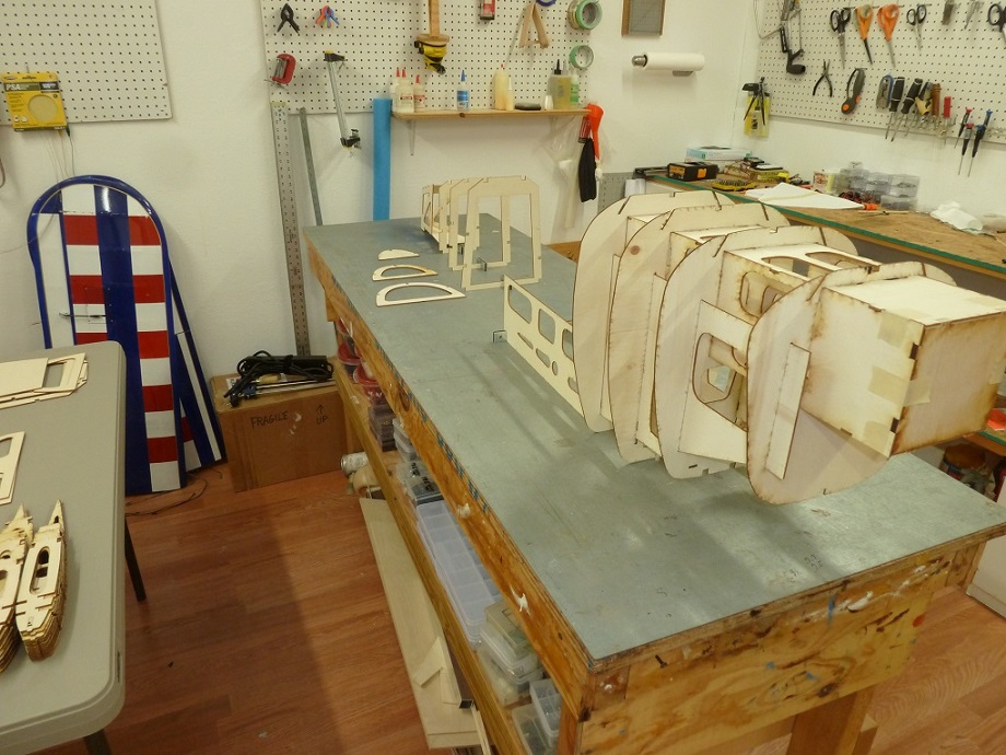

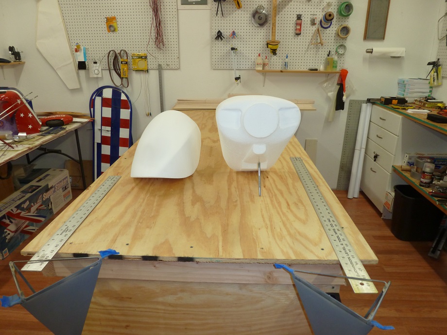

Here is a shot of getting a little familiar with the parts.
But in all seriousness I can not actually start the build until the Eagle is out of the way, two pieces of PETG is the hold up, as I need the room. Plastic is scheduled for pickup by Friday so by the end of next week it should be done and out of the way. And I should have the cowl plug by then to verify it's fit with the first former. This Bulldog build will take place by using full scale Bulldog pics projected to a screen, sized to the proper measurements, that is what I will have to go by to place the parts throughout the build. So be patient, it is coming.

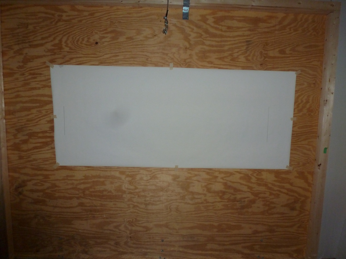

First pic is paper taped in placed on a good surface, happens to be the door here. Then, using the provided reference measurements of 61.19 I make marks at that distance.

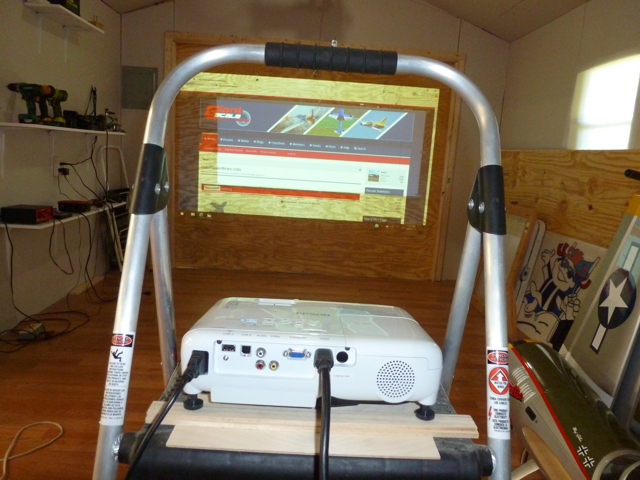

Second pic is of the projector set up with an image somewhat centered. I used my laptop to enhance the distance line as the pencil was not showing up very well.

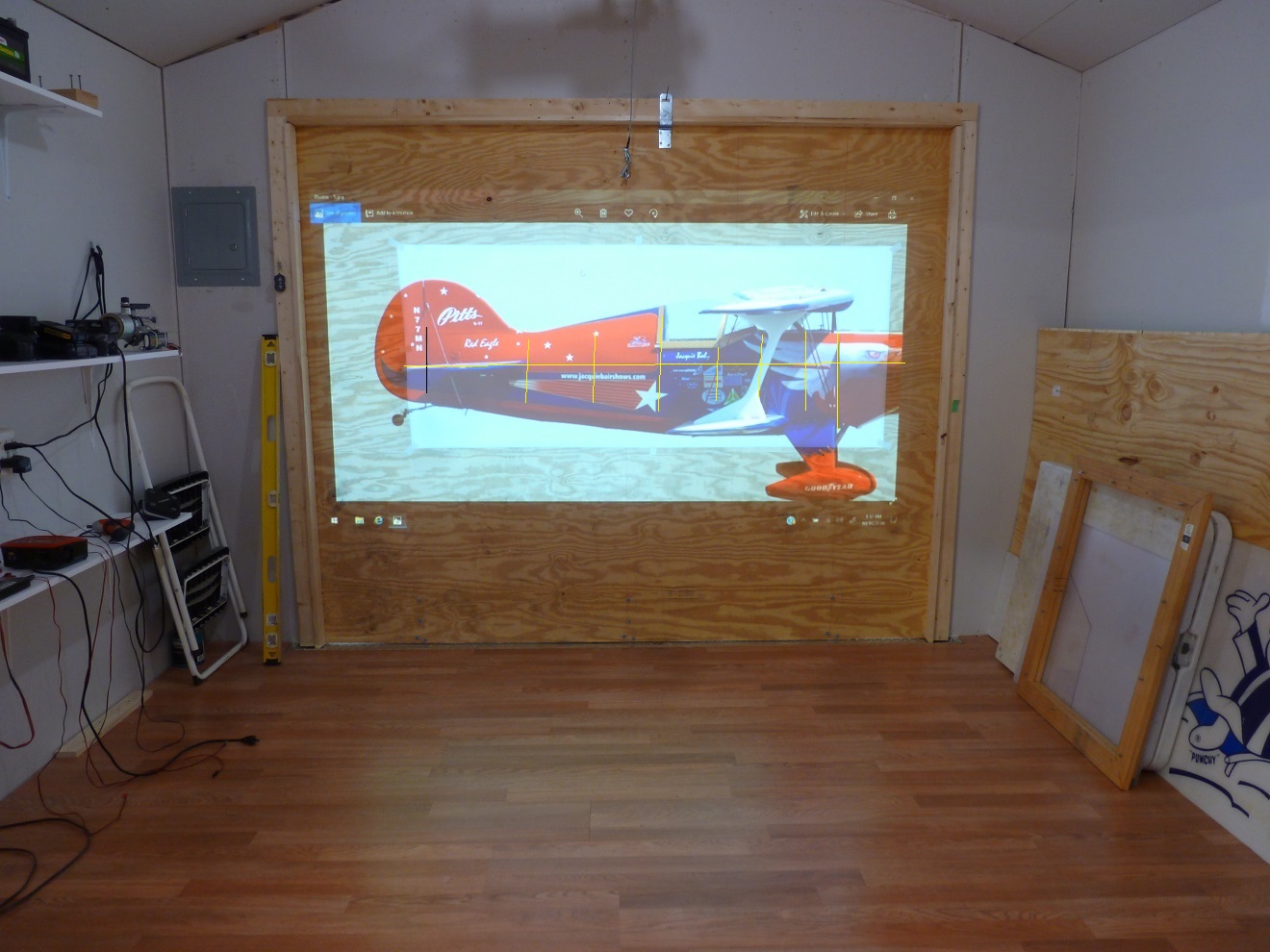

Third pic, I am using the Eagle for this as I can't post any of the photos I am using, so lets say the given of distance of 61.19" is from the TE of the fin to the former at the front of the cabane, I enlarge the pic until it fits the marks.

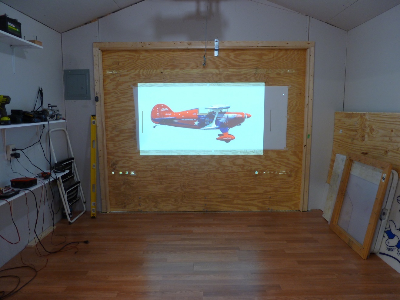

Fourth pic is the fuse sized and centered to those marks.
Fifth pic is where I would draw all the lines on the paper that I would need to lay out to build the fuse on the table. I used the LT to add yellow lines for a better visual of how I would mark the paper.

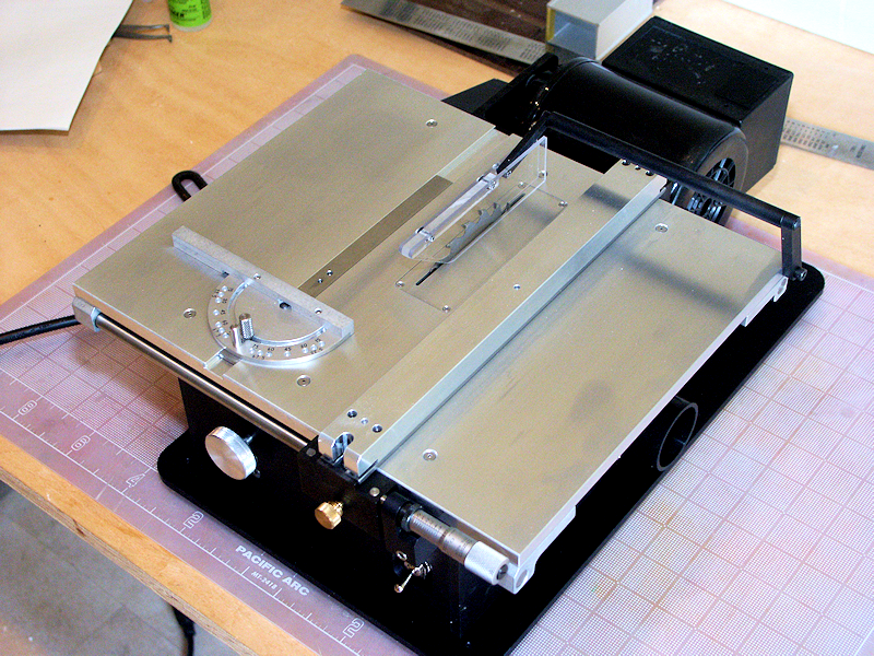

Boy o boy, I went and did it now. I was just thinking of getting some things laid out now that the table is empty. Whilst I was setting all the balsa and ply out I was thinking about the only part that I don't much like in a build, cutting all this lumber on a bandsaw. Sooo, I went and ordered something I have been wanting for some time now. I will wait for it's arrival next week to go any further. See pic.
A Byrnes Model Machines miniature table saw.
