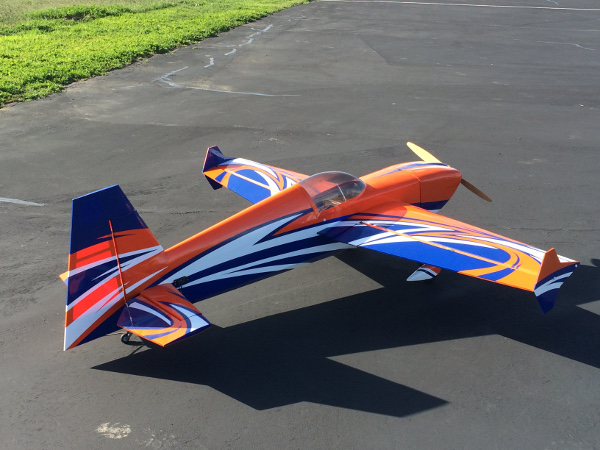

@Xpress hi there picked up my Aerobeez 540 slick 78 inch at Toledo Friday. Still have to open the box but excited to get it, now I have a home for my DA 50. Thanks for your help.

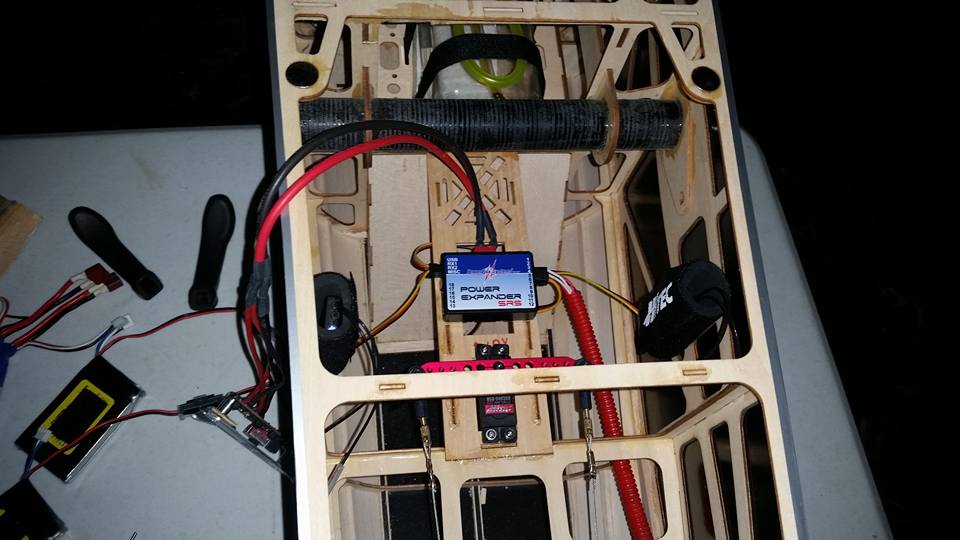

Some more work has been done over the past few days. For one I got all of the elevator wiring fitted and cleaned up inside of the fuselage. I also fitted my PowerBox and my Maxima SL receivers. Decided to go back to using the flight preservers because why not, they protect the receiver from vibrations, wrap the receiver snugly inside and keep it from moving, and also give a good way to mount them. Since I am using the Single Line (S.Bus) receivers, they don't generate heat from a lack of current flowing through them so there's not issue in wrapping them. Velcro sticks like glue to the flight preservers so I know they won't move.
With the PowerExpander being installed I plugged the elevators in and set them up again. For some reason everything was all off so I just reset them to neutral and started over.

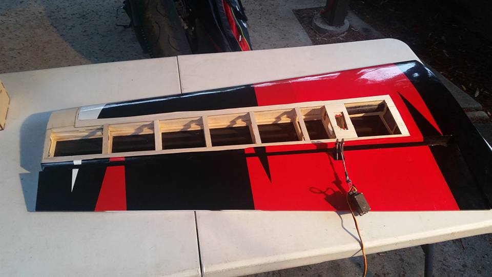

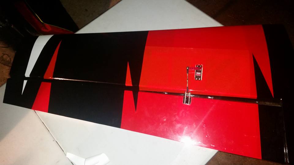

Received my covering and ball link hardware yesterday so I covered up the bottom of the right wing panel. I spent some time going over all of the glue joints and repairing ribs to make sure it was solid, should last quite a while.
And after. Ultracote is by far my favorite covering to work with because I find it simple and easy to work. A casual 45 minutes of work and it was looking like factory.
You'll see the red patch up close, but who cares in the air. Certainly not me.
