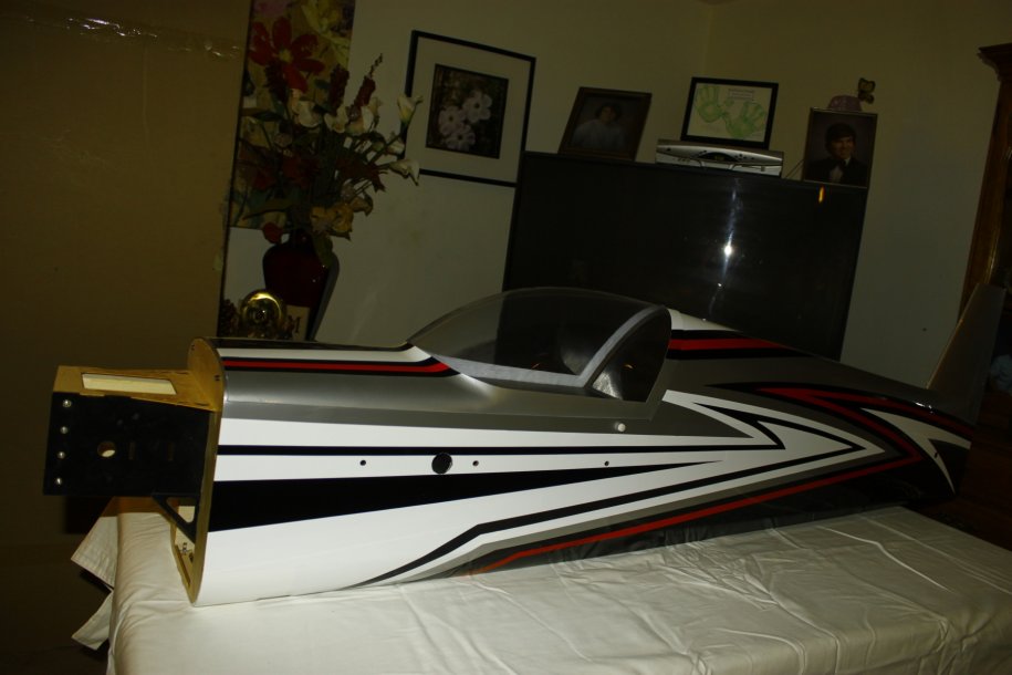

The fuselage in all its glory:

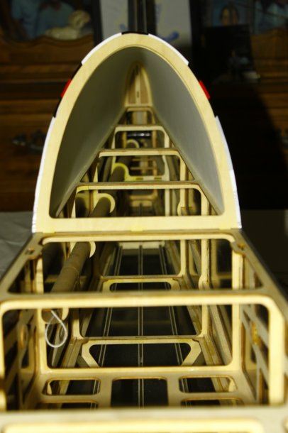

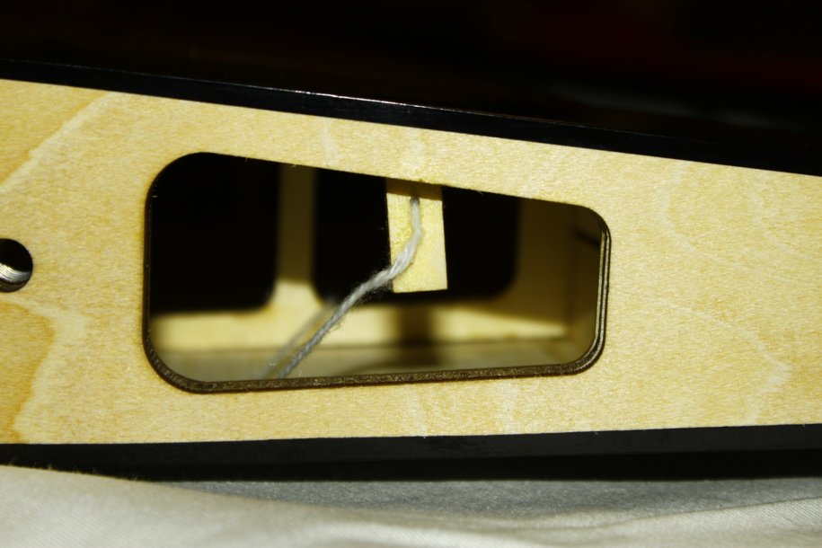

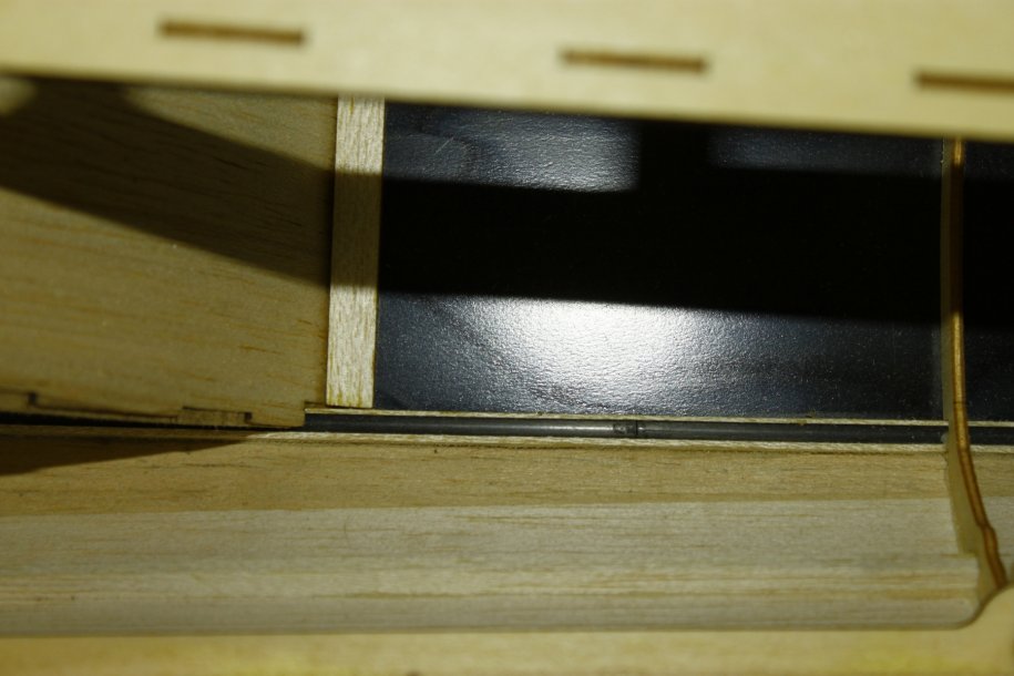

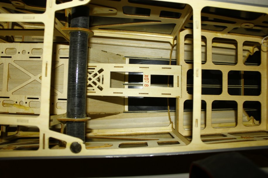

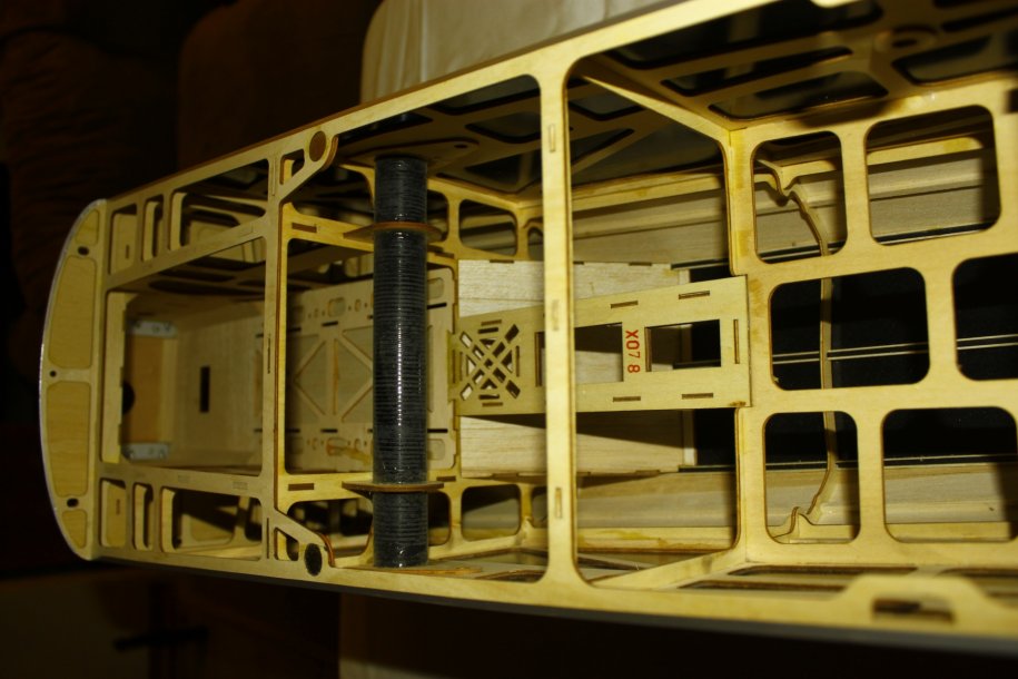

Looking down the tail. There is a tube already pre-installed for running wires through, with a pull string inside.
The stringers are reinforced with carbon fiber.

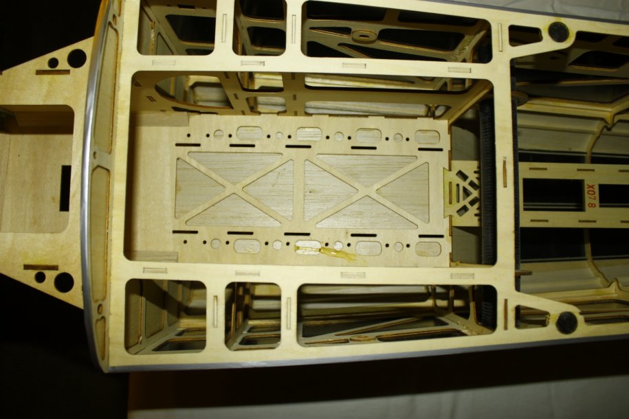

Fuel tank tray:

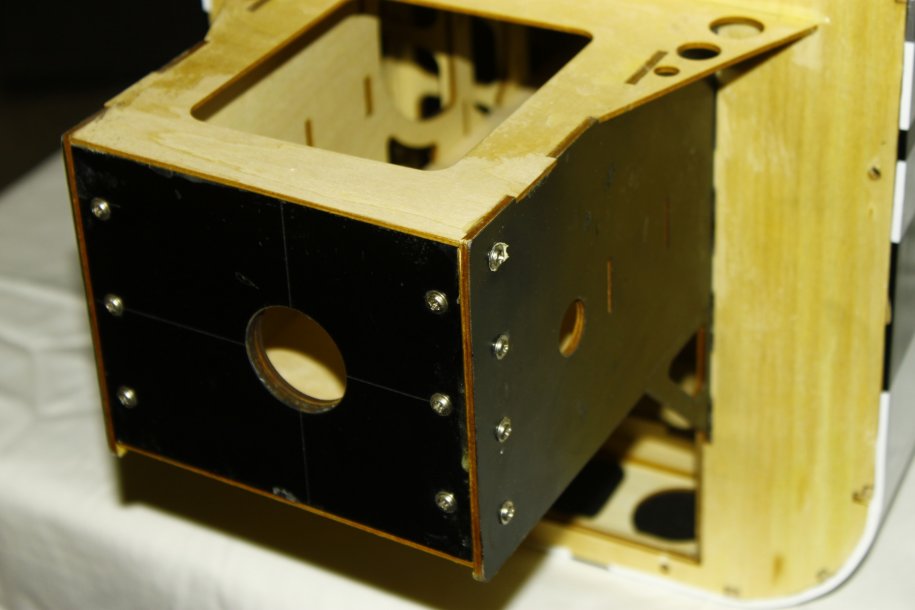

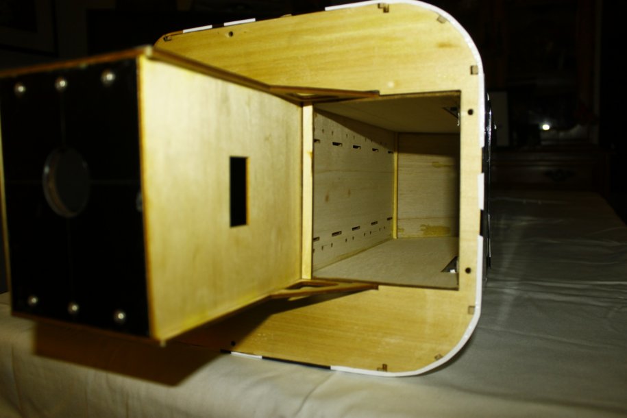

Motor box is reinforced with more carbon hotness:

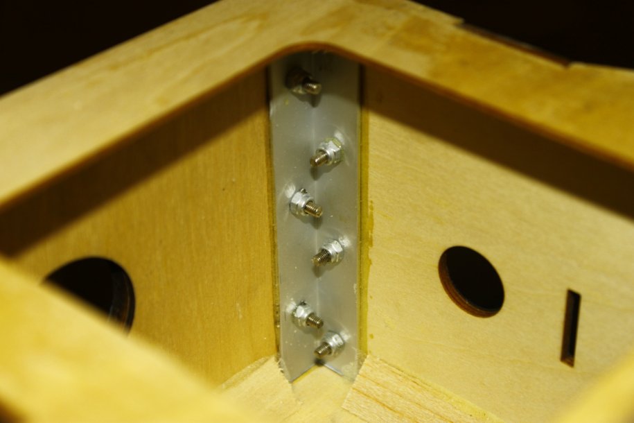

Inside you will find aluminum reinforcement brackets already pre-installed:
I should note that the motor box is fully built out of the box, thrust alignments already built in!
One more looking forward:

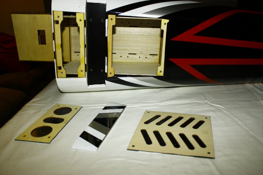

On the bottom of the fuselage, you will find several plates with cutouts in them to allow hot air out:
These are completely matched to the covering scheme as well. Also pictured is the main gear cover plate.

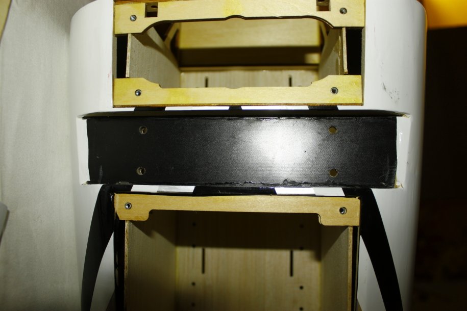

The gear mount itself is reinforced with carbon to make this area super strong and robust:

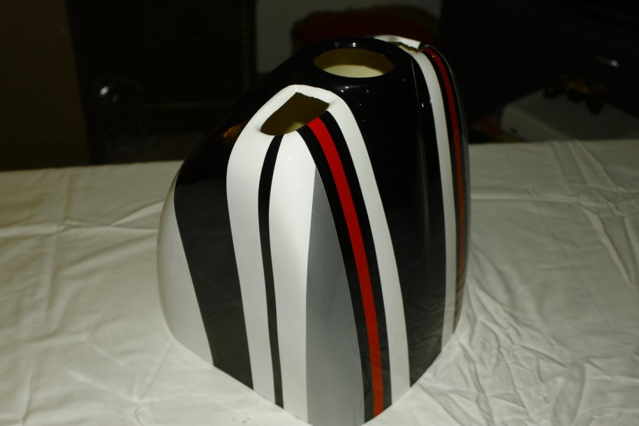

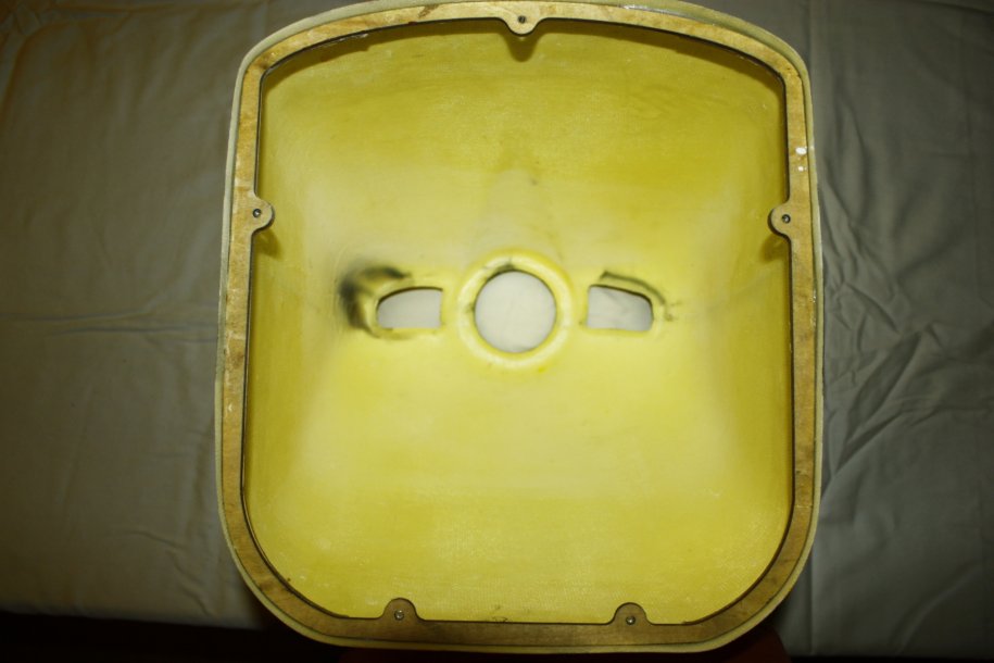

Cowl is painted to match, and does so perfectly:
Cowl ring already in place:

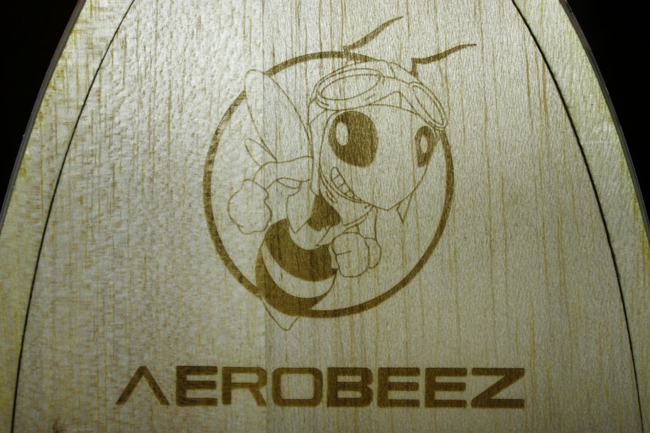

Canopy comes with a laser engraving with the Aerobeez logo:
This is also an access plate if you want to mount a pilot inside.

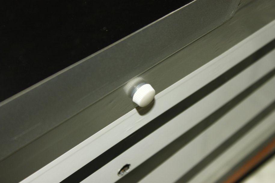

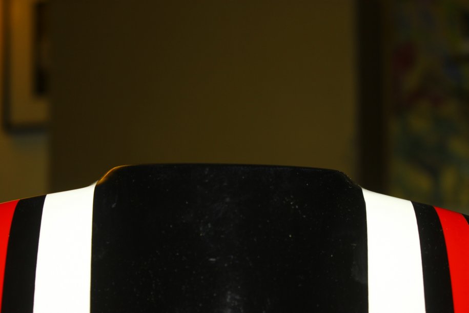

Canopy is secured with thumb screws:

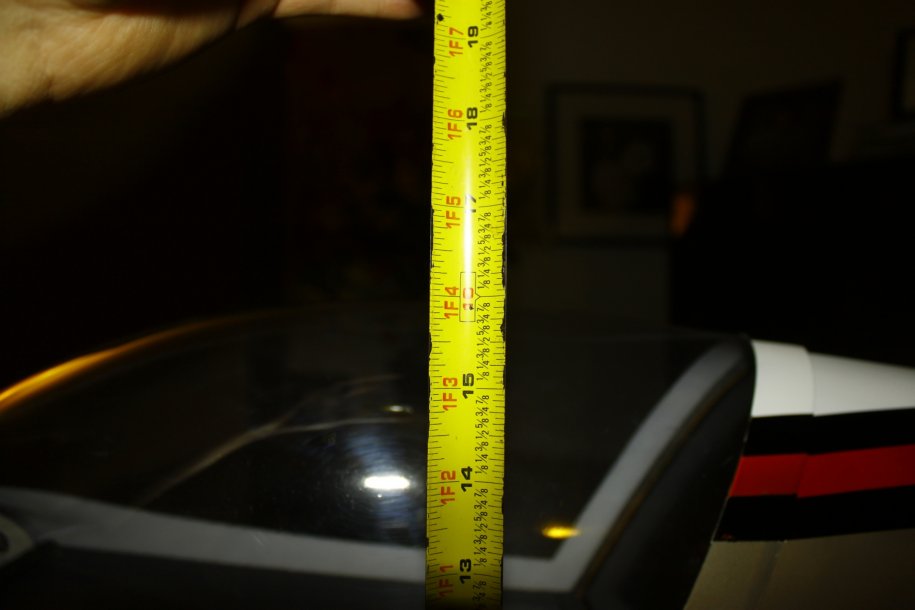

Fuselage is super tall, measuring 16" on its own!

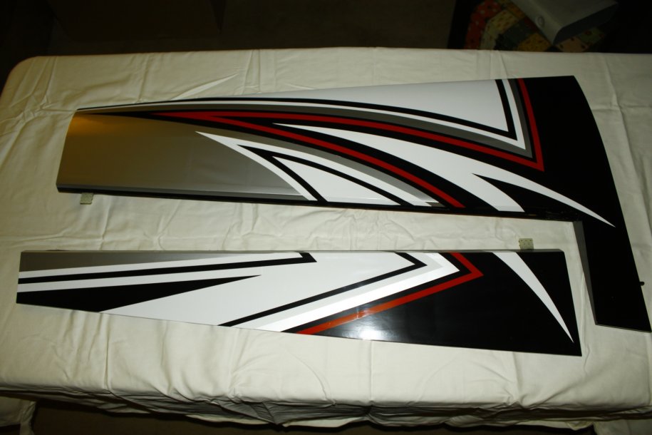

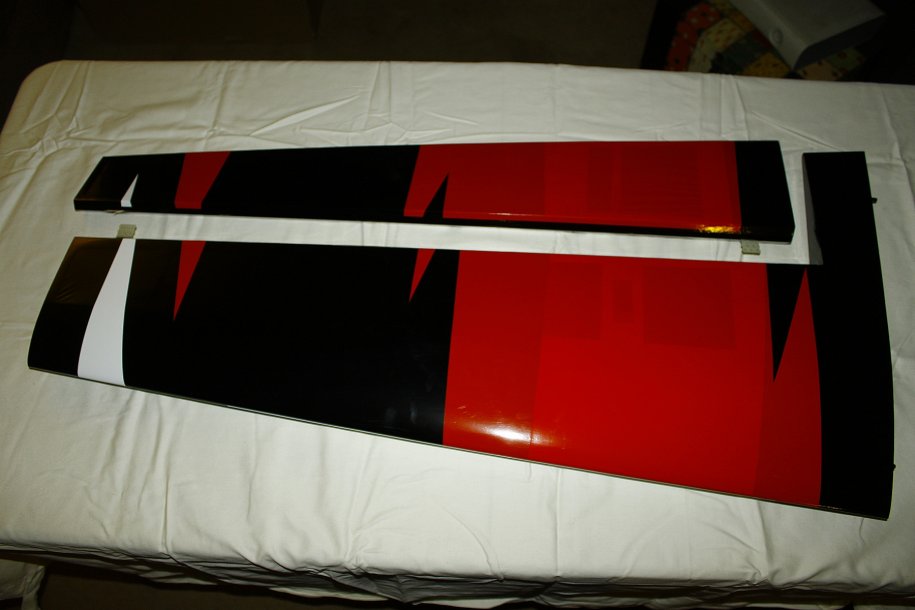

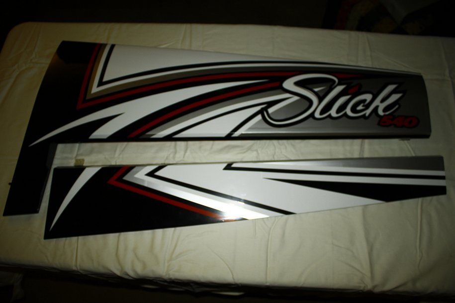

Onto the wing panels:
The control surfaces come dry-fitted in place using a couple of hinges, you will need to glue them all in- slots are cut.

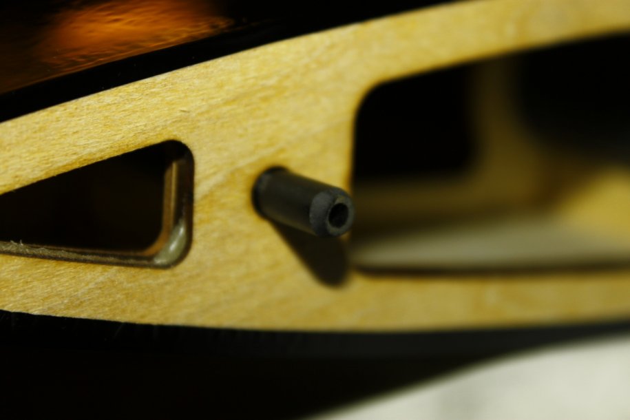

Carbon anti-rotation pins:

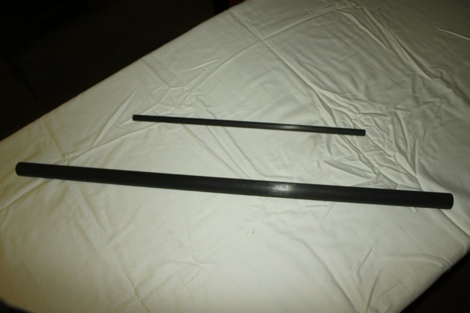

Wing/stab spars:
