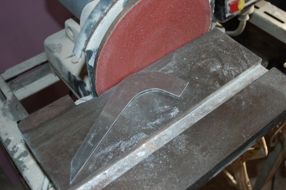

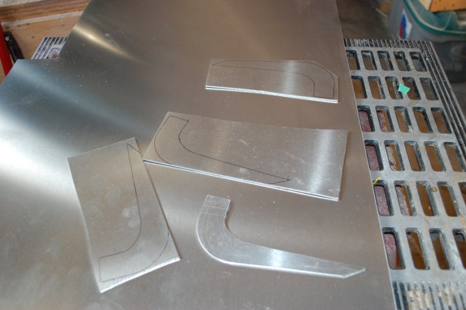

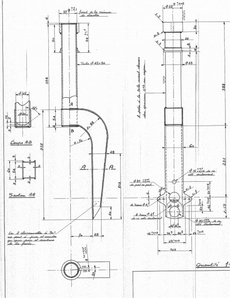

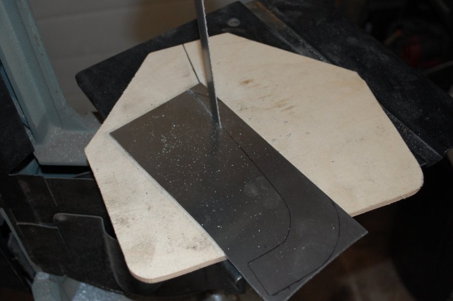

cutting aluminum plates for the bottom part of the landing gear

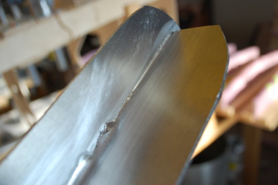

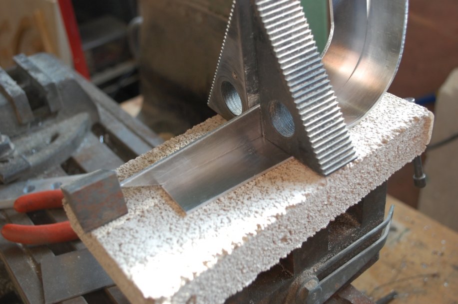

me too, seriously, its not that hard but simply paying attention to details, Yesterday I used the same .90" plate to practice some aluminum welding, with a low heat aluminum rod (735 degree) with acetelene torch, and it is awesome, I will post a picture of the weld seam, man if I can do this , anyone can...now I know I have to go back to some welds I did on the Pitts and redo them

Roger....I hope you have better success with this than I did. The stuff I tried was Durafix. It seemed to work and flow as advertised when I welded a canister stinger back on. Seemed strong when I tried to break it off by hand.....but the first flight it fell off. Haven't fiddled with the stuff since then. :(
I will definitely do a lot of testing first I assure you, and hopefully it will work, one thing I found though , is to clean to a shine the part to be welded with a stainless brush, but I hear you, so more testing ...

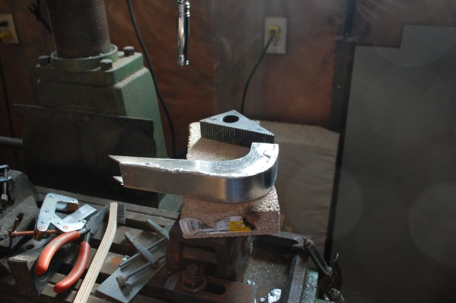

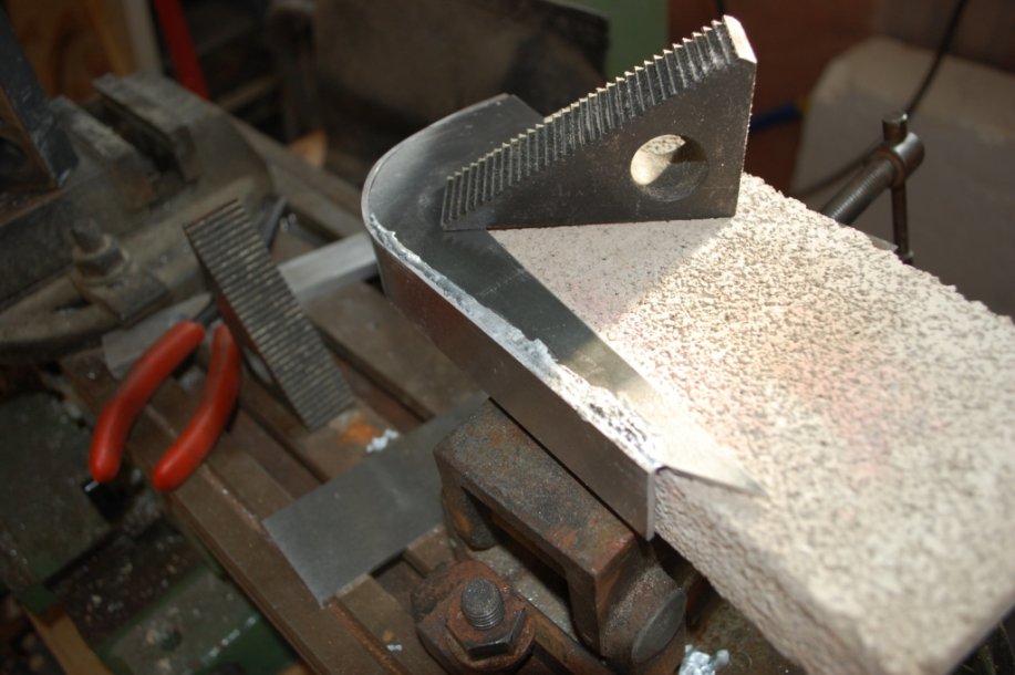

a good start, still the inner part to weld , then clean up and grind for proper appearance
