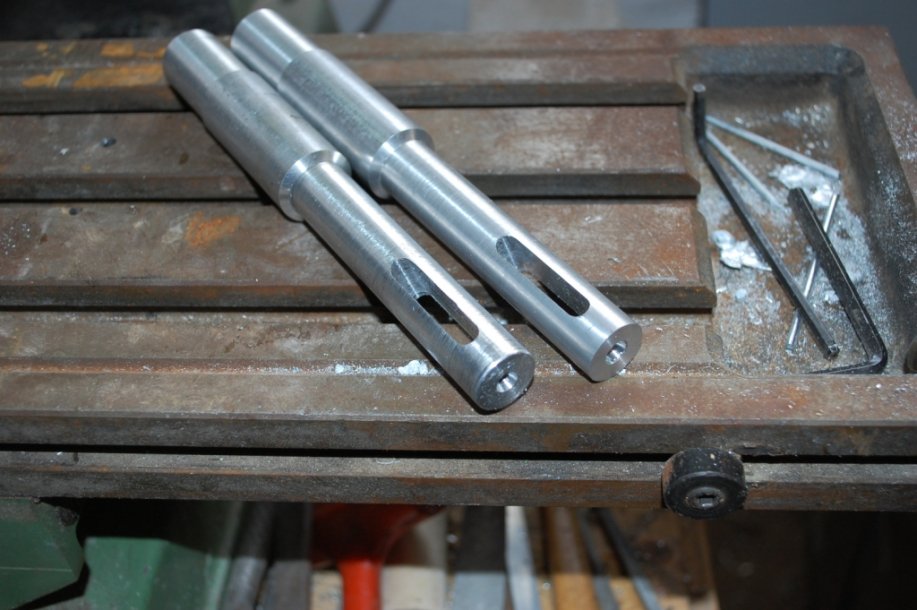

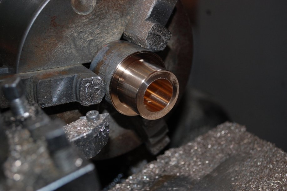

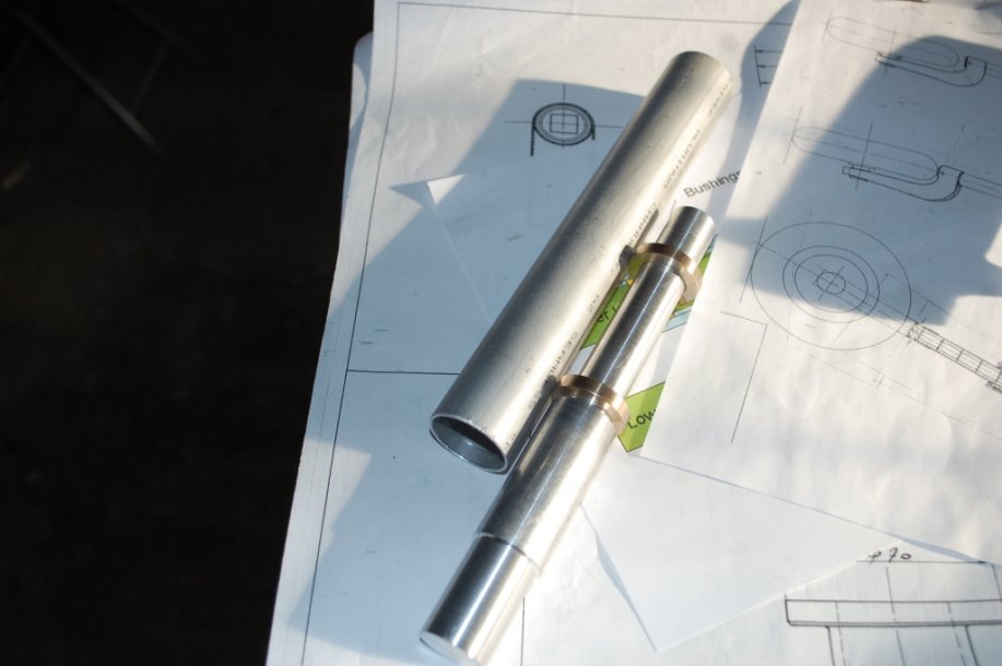

today after gluing some wood spars on the Dalotel junior, while waiting for the glue to dry, I started cutting aluminum and the brass insert for sliding the lower strut into the upper strut.

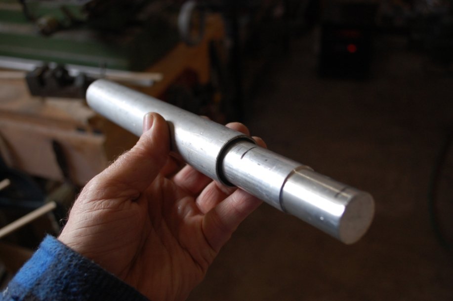

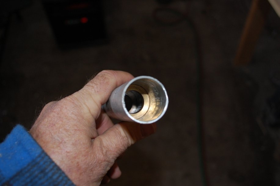

finished with the landing gear bushings, which are slightly oversized, since aluminum expands faster then bronze, it was just a matter of heating the aluminum tube and sliding the bushings in place, they are not going anywhere...

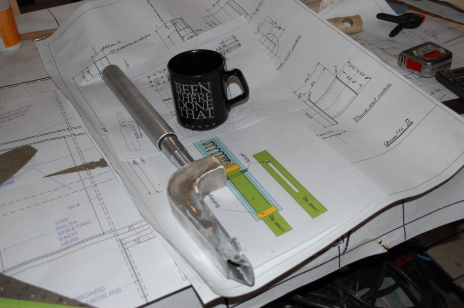

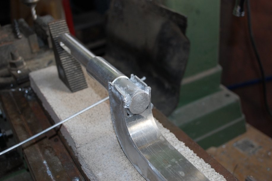

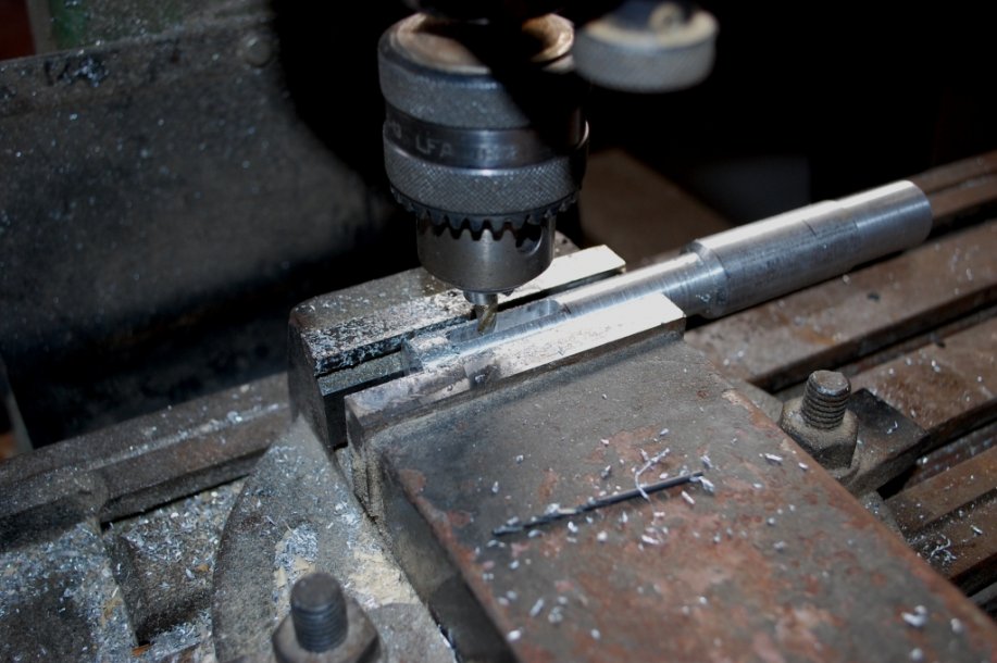

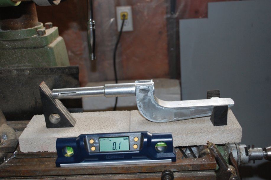

cut the slots in the strut and tack weld to the bottom

Looking good Roger. Have you tested the weld strength yet?
Would be a biotch to see that fail after all this great machine work!
