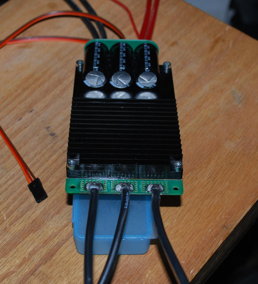

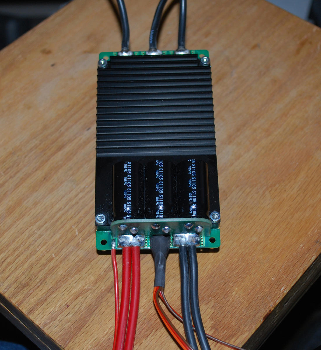

When I made my comment about the caps, I was not commenting on the quality, but rather the size/capacity....as larger caps can "and do" effect how long the wires can be. A case in point.....This ESC can have fairly long wires (up to about 18" I have been told), without adding any caps to the circuit, as it already has large caps. Of course the ESC itself is very large...
