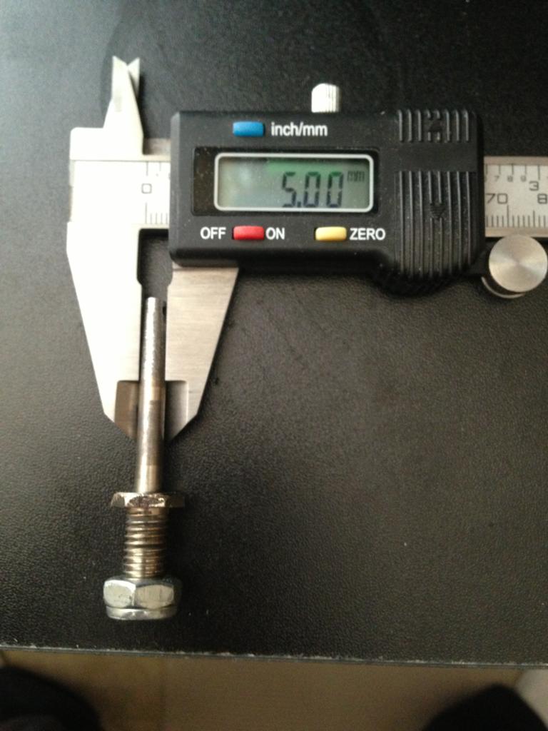

Are they 3/16" or exactly 5mm? I found some Titanium ones that are 3/16". Look a bit pricy..

The drawing showed diameter of 0.19" or 4.826 mm...

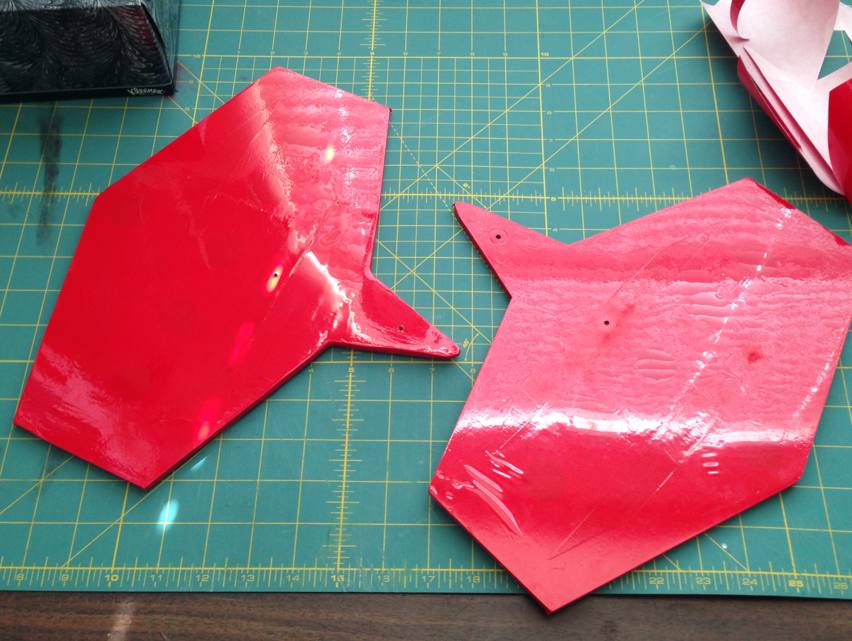

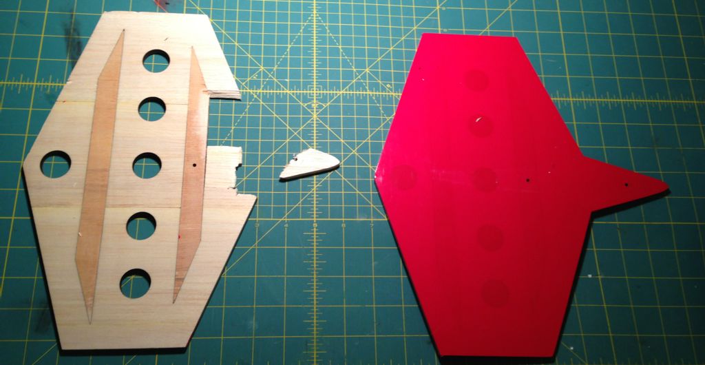

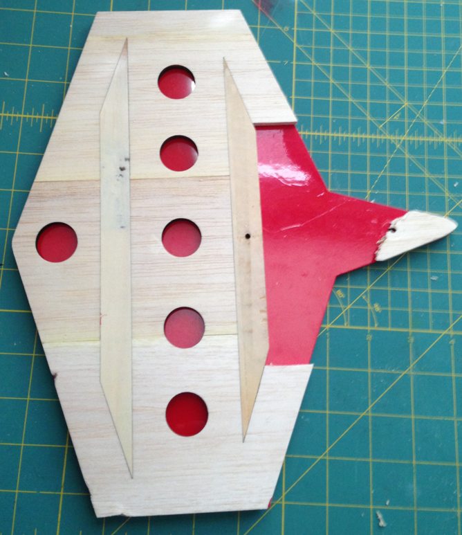

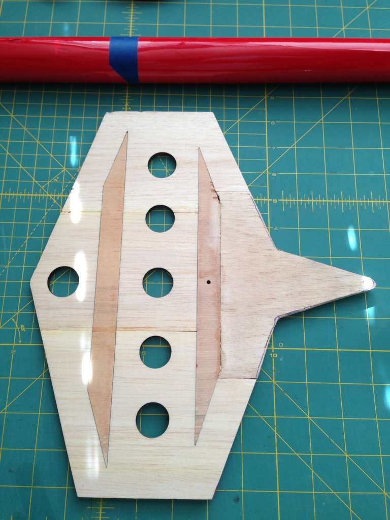

Well, since my SFG broke last time I flew, and there aren't any replacements on 3DHS' website, I rebuilt my own. In retrospect, I'm happy I took the time to repair vs. replace and get some experience.
Can you tell which one is original?

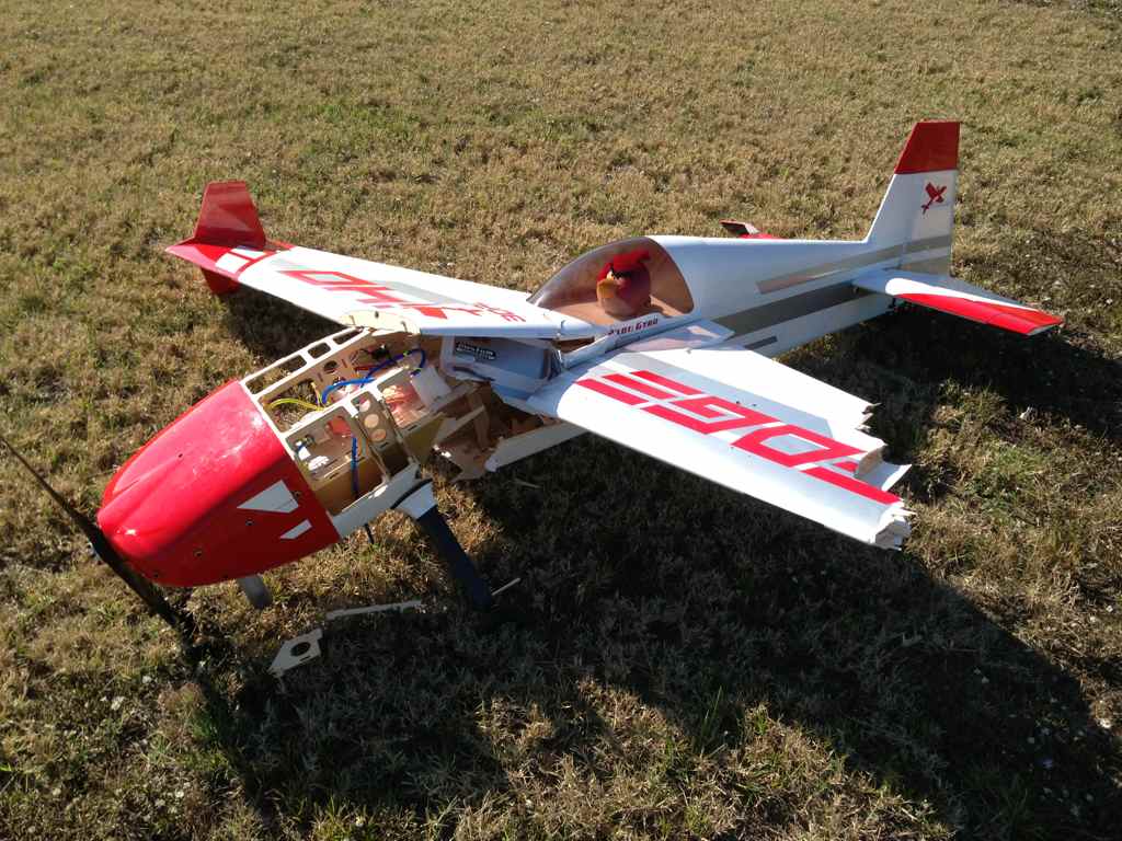

AAaaaahhh, that sucks! Please at least say that radian is confetti?! On the plus side look how well your gear block held up!!
