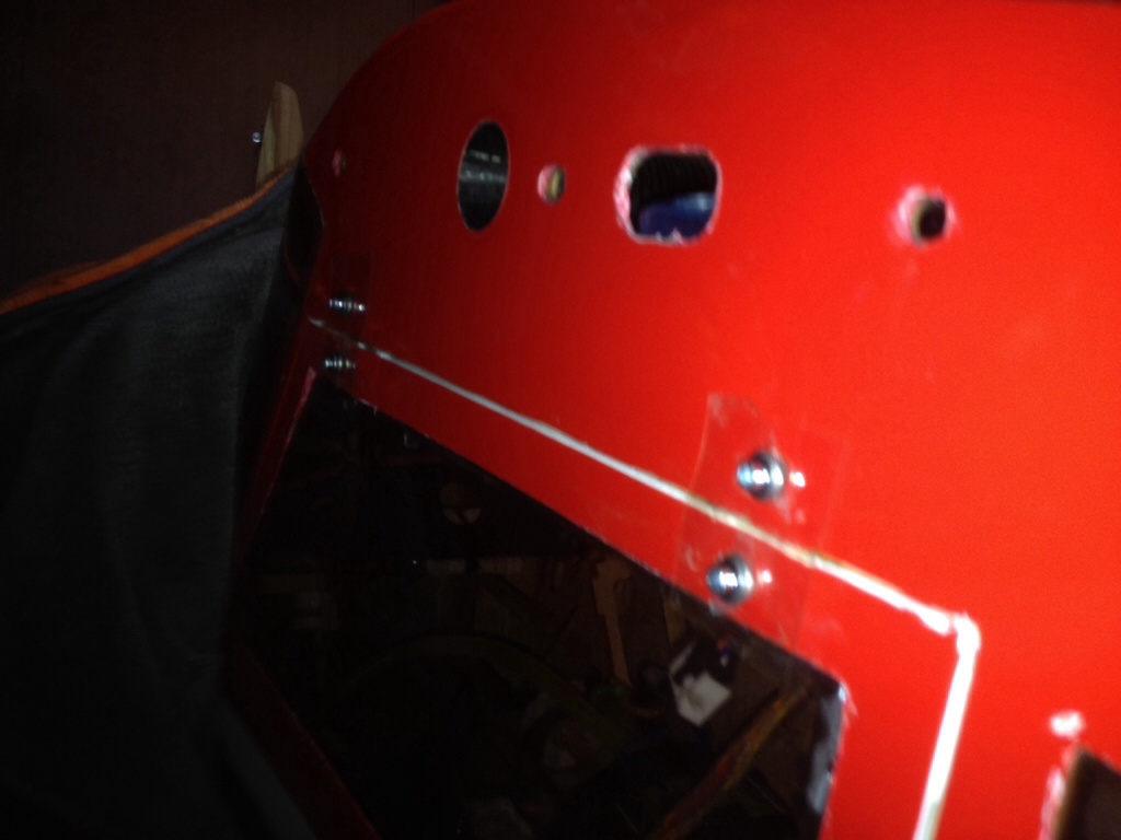

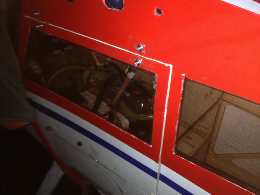

My door blows off and im running gas, i have a hole in the firewall..
I made some hinges for my door, the little paperish ones didnt allow the door to open all the way so i replaced them..ill post a picture when i get home

Thanks Ashleigh, I'd like to see the pics of your hinges. You are running a DLE-30 V1, correct?
RC Girl
Yes
Here are my hinges. Just thin piece of plastic screwed on. I havent flown it much like this so we'll see how they hold up ImageUploadedByTapatalk1382556851.062473.jpgImageUploadedByTapatalk1382556951.995300.jpg
