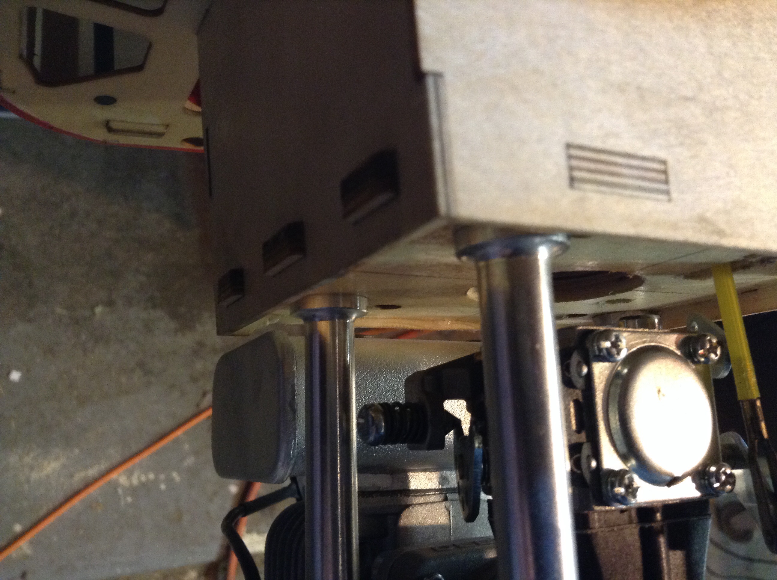

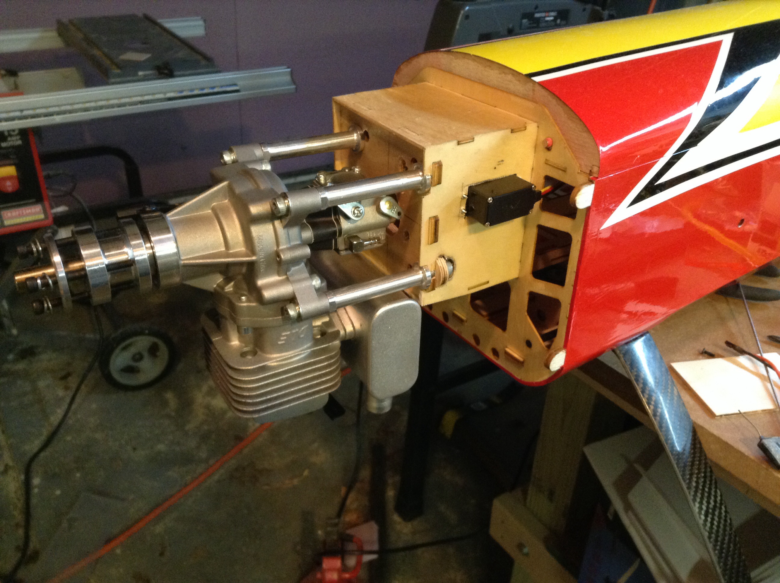

That is what I am debating. Either a metal rod with a nylon clevis at the carb and nylon ball socket on the servo or metal clevis at the carb with golden rod and nylon ball socket at the servo. I'm having a hard time thinking a nylon clevis is sufficient, but I've always used some sort of nylon on the throttle joints to eliminate frequencies.
And of course the DLE manual says locate the servo at least 12" from the engine, which is what I did on my Cap232. I guess 3DHS breaks all the rules.
When I am stuck using a solid pushrod, I use the Dubro servo arms as they have more flex than the stock hitec arms. All my linkages are either metal clevis or ball links. I don't think I have used nylon on any gassers, but they are on some glow stuff of mine. I would have to look through the fleet.
Abrams
Enterprise, thanks for the golden rod suggestion. That is what I ended up doing. I used a metal clevis at the carb and a nylon ball socket at the servo arm.
FYI, the DLE 35 muffler barely fits. It required a little carving.
