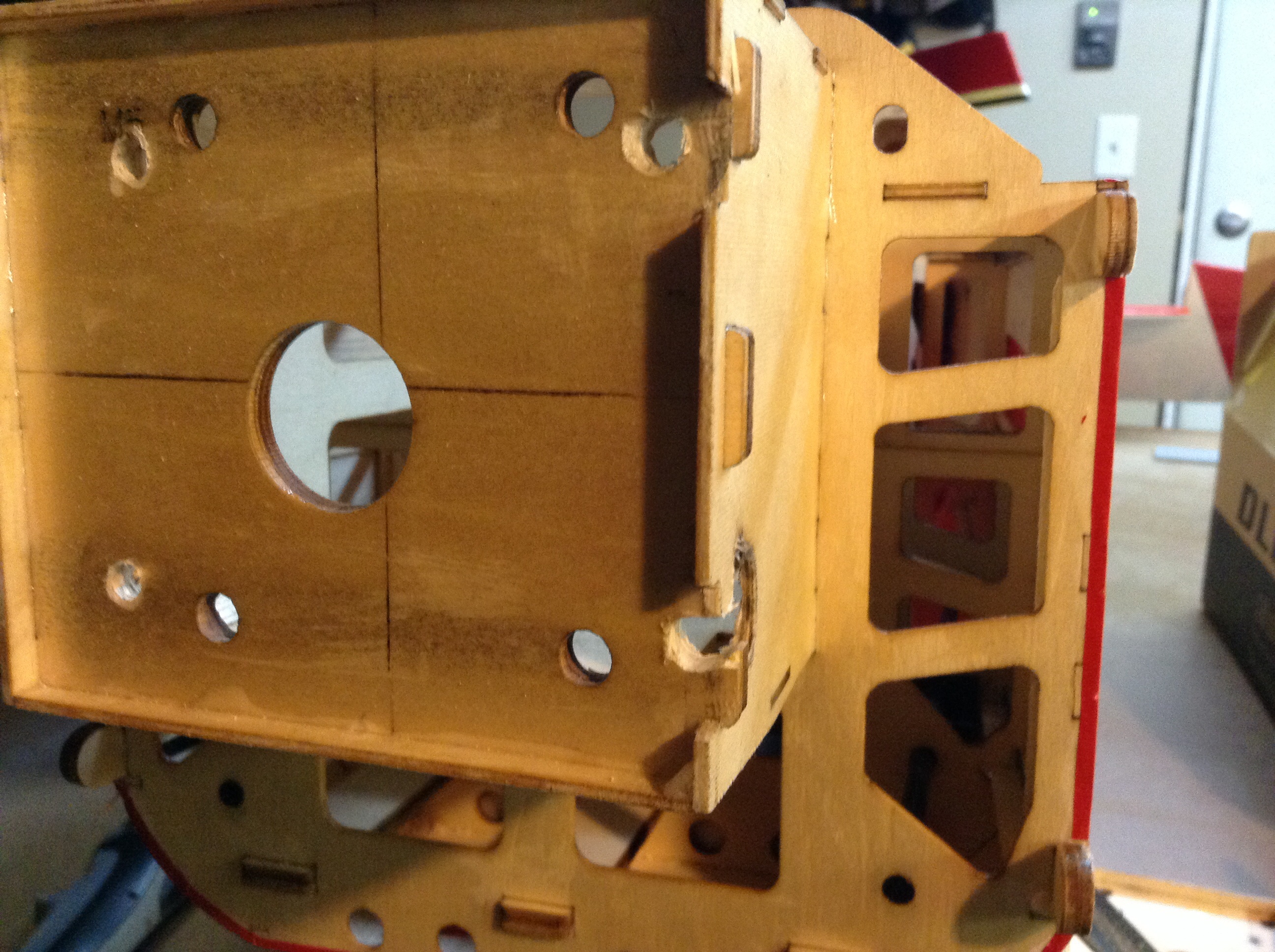

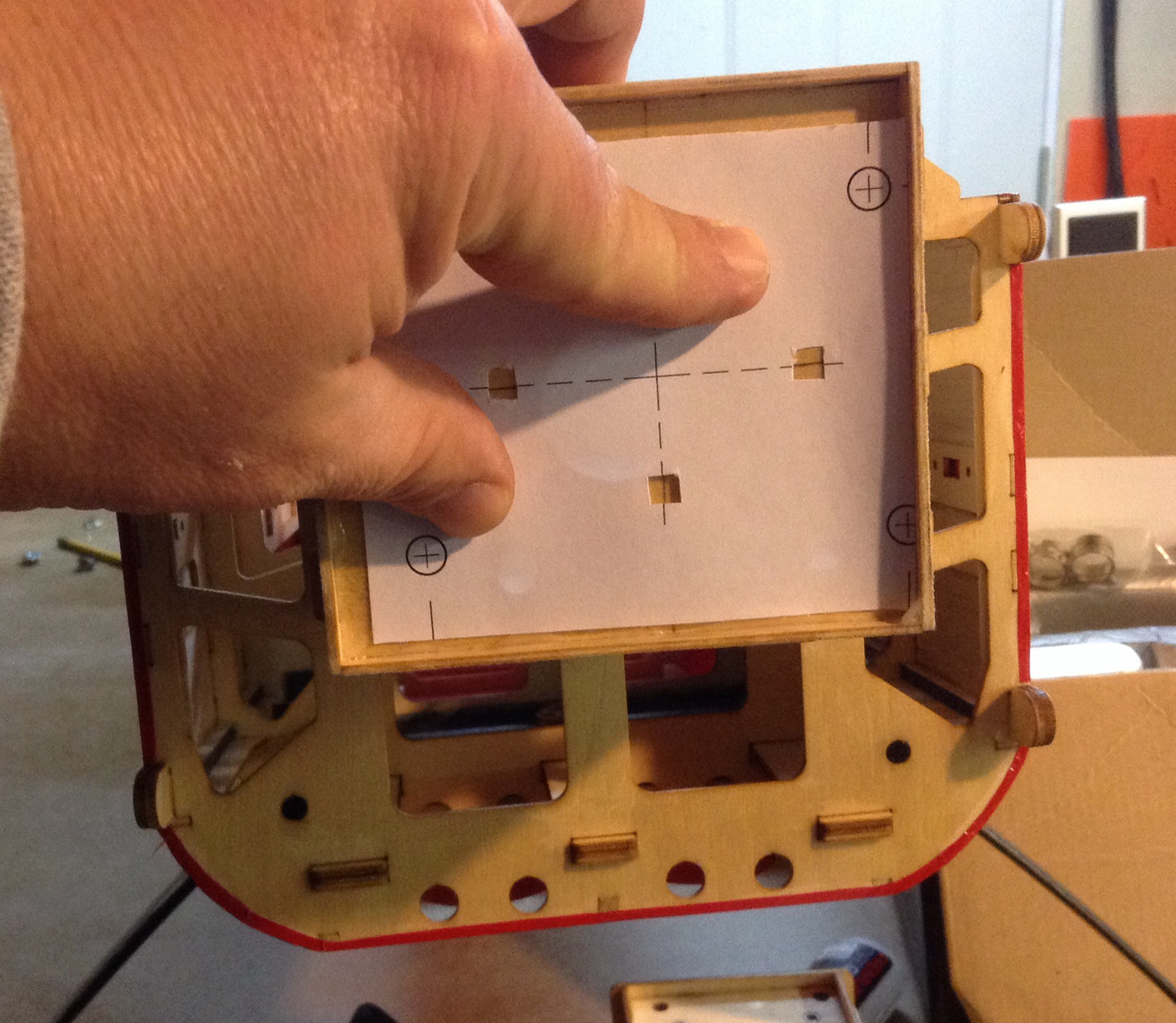

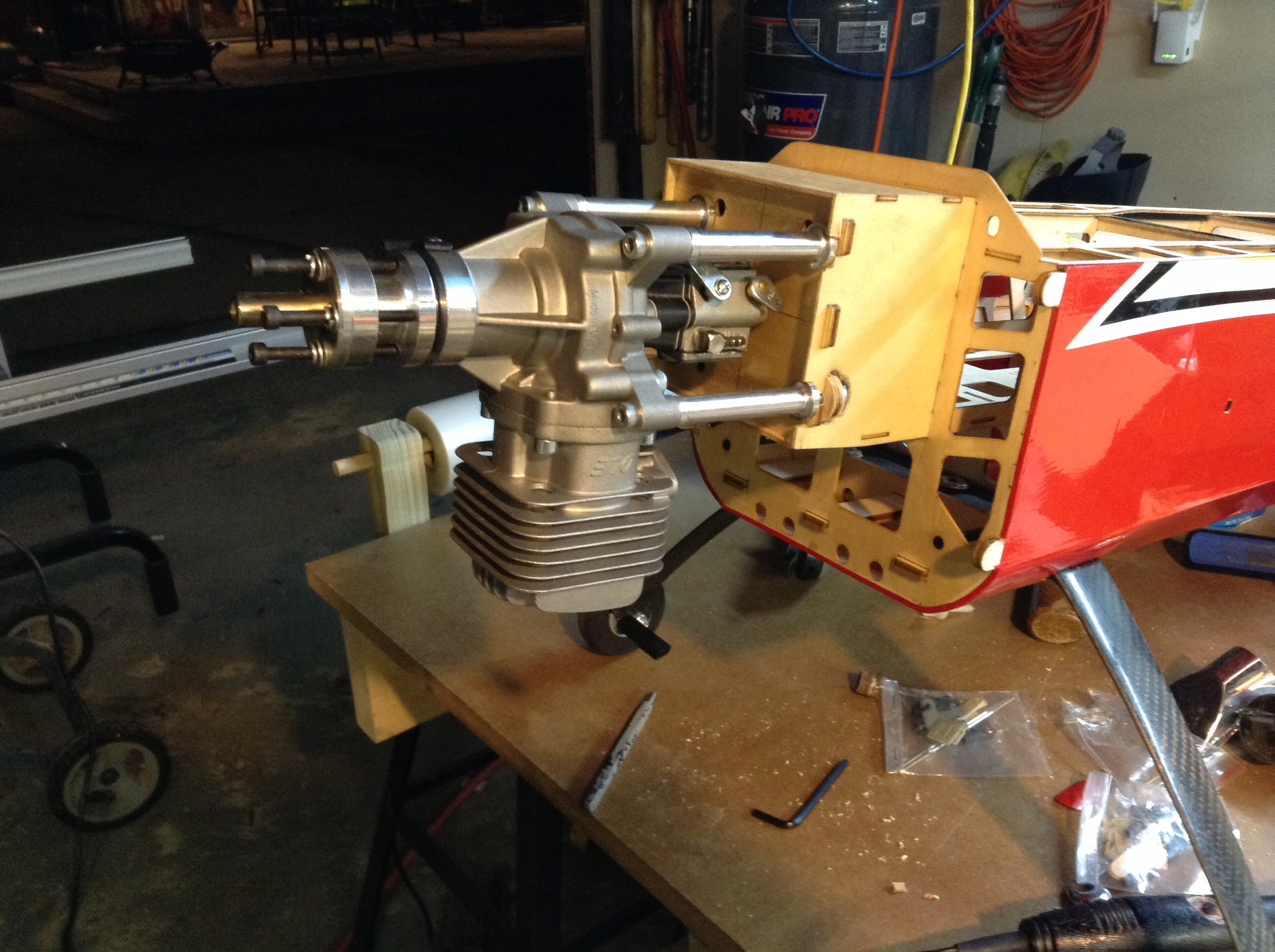

Ooooohhhh... it gets way more interesting. The DLE 30 is a tight squeeze to get the footprint of the standoffs on the fire. The bigger jug on the DLE 35-RA makes for a little wider footprint. OOPS!!!
I love an engineering challenge. Notice the bottom right hole.

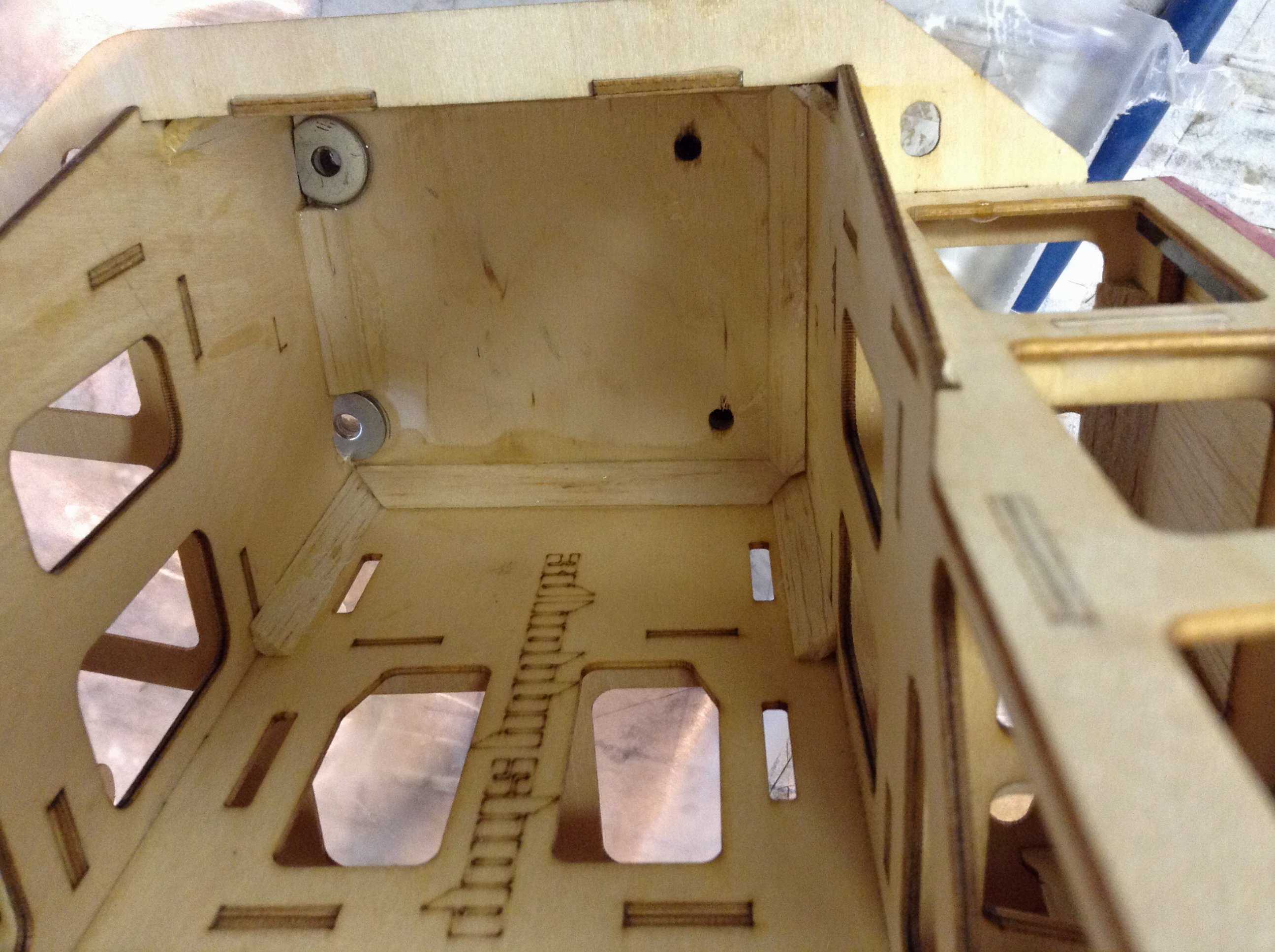

Epoxy on a piece of square stock, insert a threaded insert in the proper hole position and triangle the square stock. You might have to cut the bolt to get it to fit properly. I usually use blind nuts, but I think that will work.

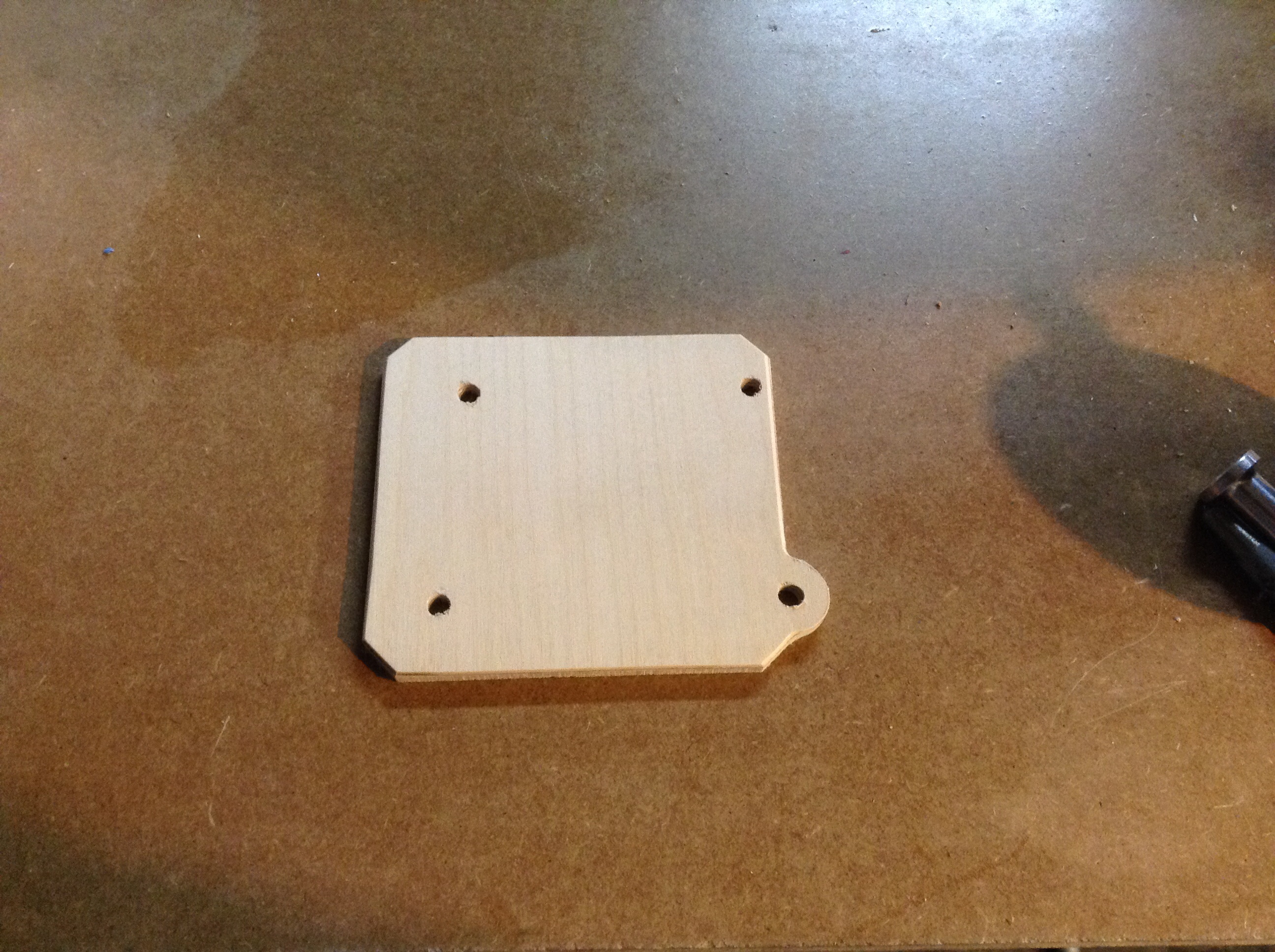

Firewall doubler to go on the back side. Brings the firewall up to the recommended 10mm.
Trimming to make the doubler fit.

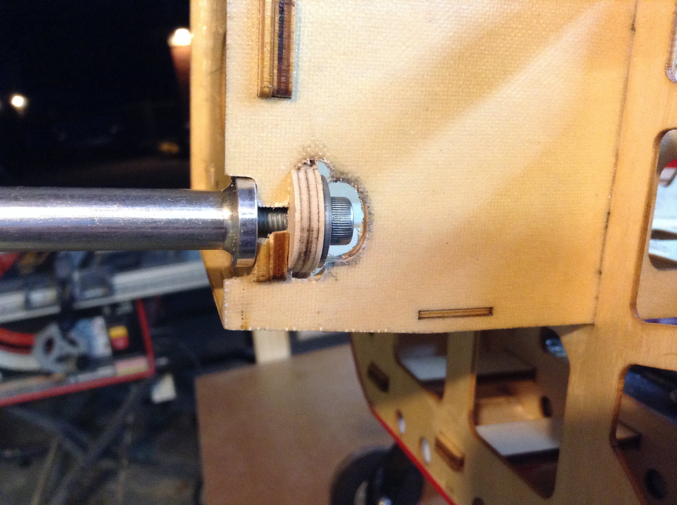

Bolt, washer and standoff installed.
Triangle stock in the inside of the firewall.
Finished product.
