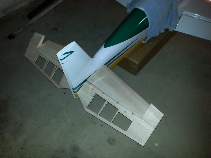

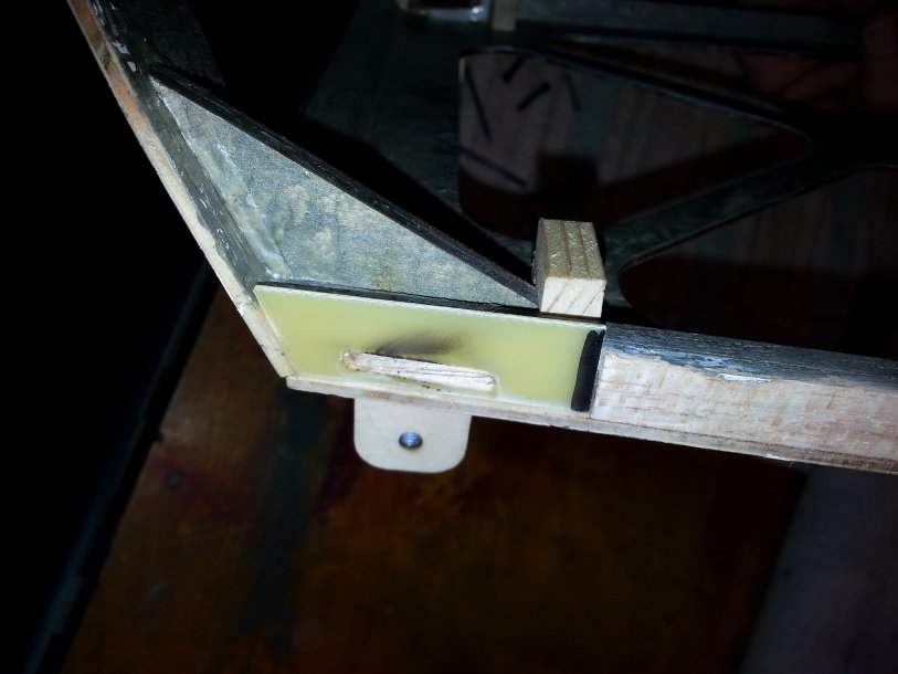

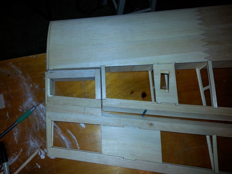

Here's a couple of pics of what I've done to the tail of my extra and also part of the new color scheme. Yes it was a beautiful model as is but I just had to add some of my own touches to it. I also have most of the fuselage ready, I just need to finish the wings.

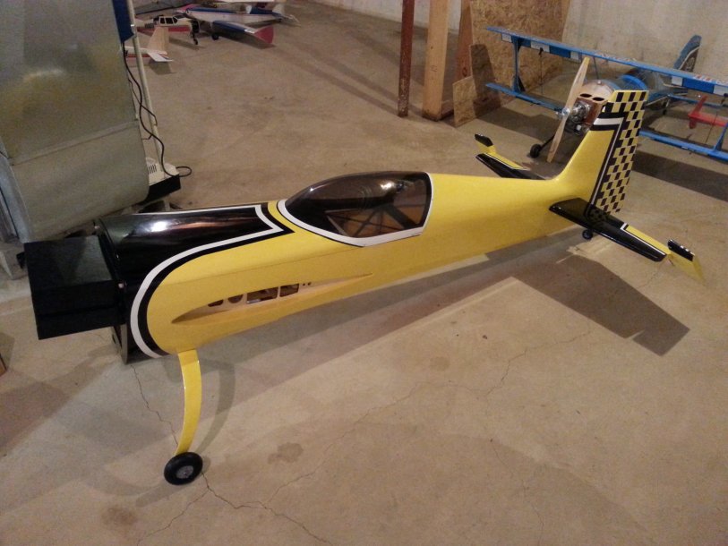

here it is on it's gear, I also made a quick release hatch instead of bolting it down everyday. I did this to my 50cc edge and it worked really well. Hoping the same here.

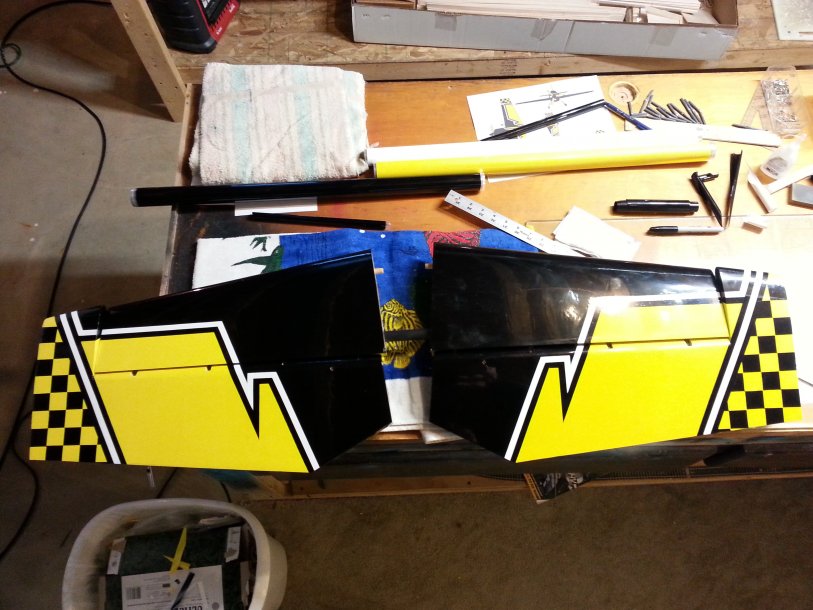

Here's the wingtip and what I'm building there. Just adding some small scale touches to the wings.

Thank you for sharing the photos.
I am not sure how much flight characteristics these mods might change, but it will no longer be a 300SP: the SP has no counterbalance on elevators or ailerons.
