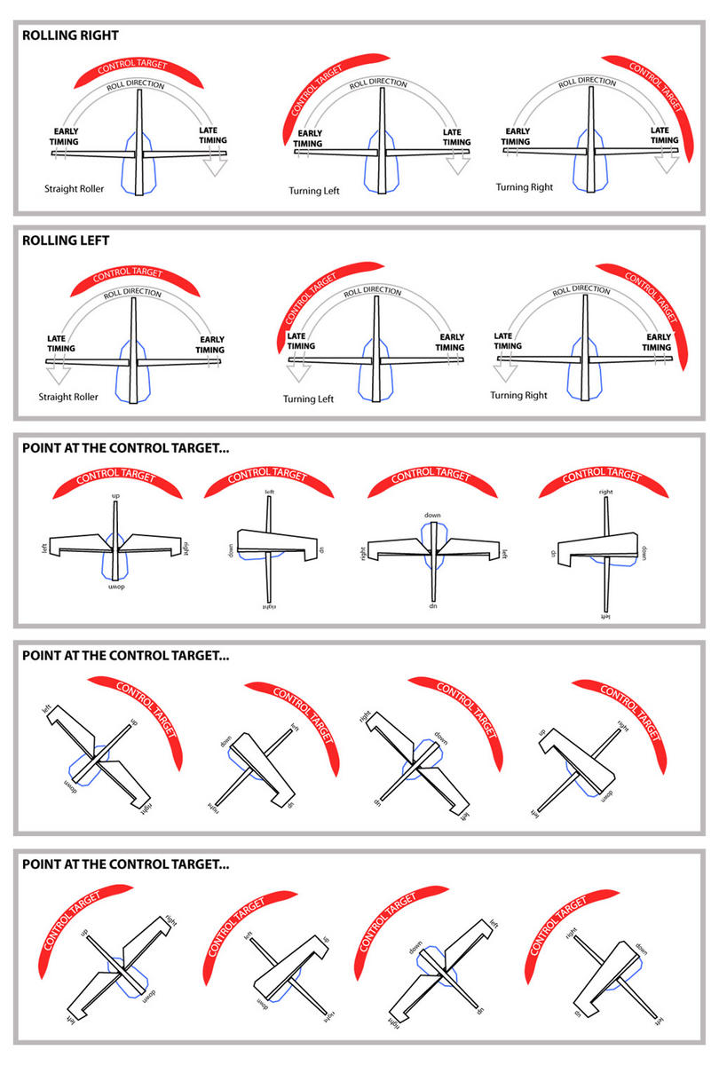

The Rolling Harrier is a stalled 3D maneuver where the aircraft is tracing a horizontal flight path, while continuously rolling, with the axis of the fuselage angled up at 30-60 degrees, usually 45 degrees. The pilot inputs up elevator, rudder, down elevator, rudder, and up elevator again repeatedly as the aircraft rolls to maintain attitude and to steer the path of the aircraft. Throttle setting is medium to low, requiring less thrust than a hover or torque roll but more than a standard harrier. The maneuver first gained widespread recognition at the 1999 TOC, where it was performed by Sebastiano Silvestri.

Start by practicing continuous slow or medium speed rolls with rudder and elevator correction. Use low rates to practice this. As the plane rolls to knife edge, feed in rudder in the opposite direction as you are rolling. Feed in some down elevator as it goes inverted. Feed in rudder in the same direction as you are rolling as it passes through the second knife-edge position, then as it comes around through upright feed in some up elevator.

Slow the aircraft to a low airspeed, about the same as required for a standard landing. Pull the nose up to about 45 degrees then command full aileron. As the aircraft starts to roll, feed in top rudder, then down elevator, then top rudder, then up elevator again as it comes around to upright. You should be starting to take out the elevator input as you are starting to give the rudder input, so that as the aircraft passes through 45 degrees, you have approximately as much elevator input as rudder input. The amount of input required will depend on the aircraft. Some with large control surfaces and lots of side area require about 1/4 of the stick movement, others will need full stick movements to keep the prop attitude. However, full aileron should always be commanded through this maneuver. Adjust the throttle to keep the aircraft at the proper sink or climb rate...increasing throttle will bring the nose up and cause a climb, decreasing throttle will cause the nose to come down and the aircraft to sink.

Change the timing of the inputs. Giving the inputs earlier will cause the aircraft to turn in the opposite direction of the roll, while giving them later will cause the aircraft to turn in the same direction as the roll.
