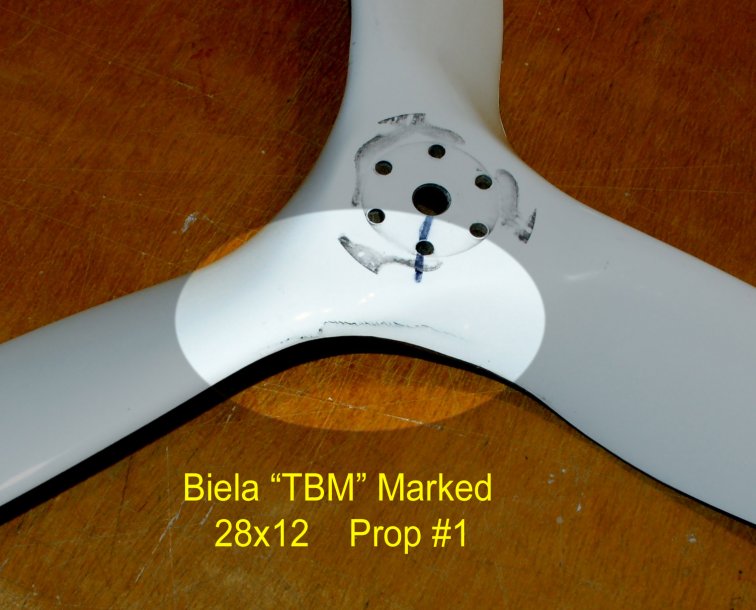

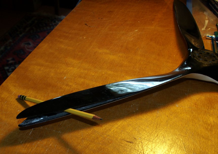

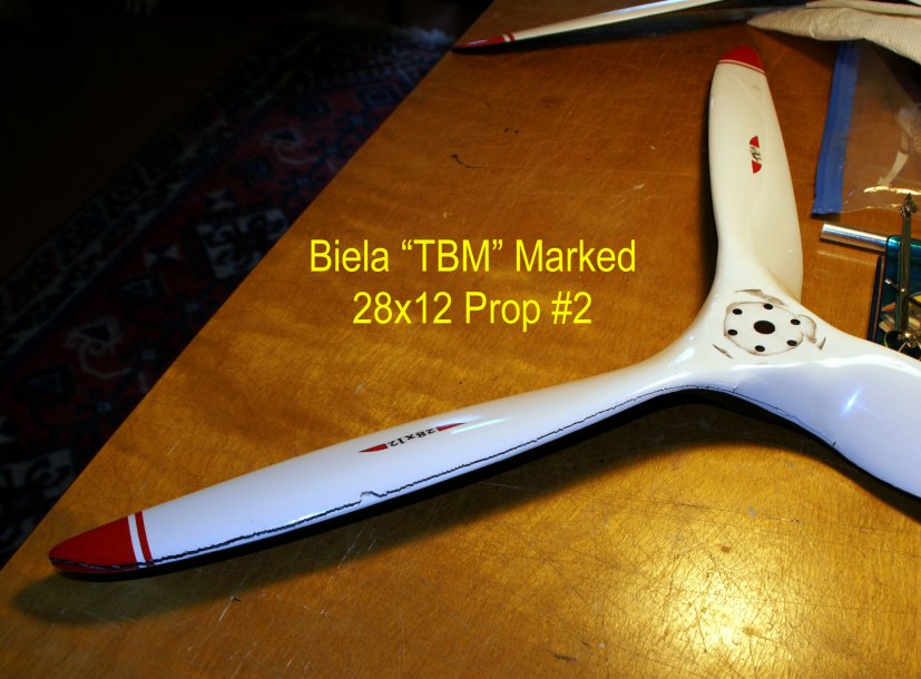

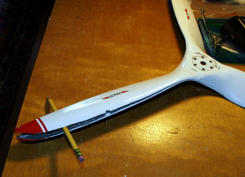

Wow! Never had one detonate like that but have had 2 failures in Biela carbon props on my DA150/RE3 Raven. First one cracked in the webbing between two blades. I found it when I was checking prop bolt torque. The second one let go in flight, but I shut her down and landed fine. No damage to the plane.
Beila did replace both, although I haven't used them yet. I do like how they perform though.
