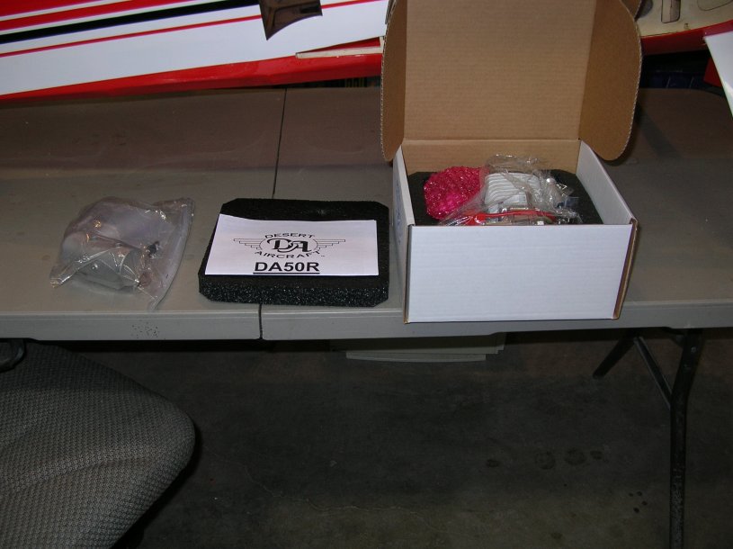

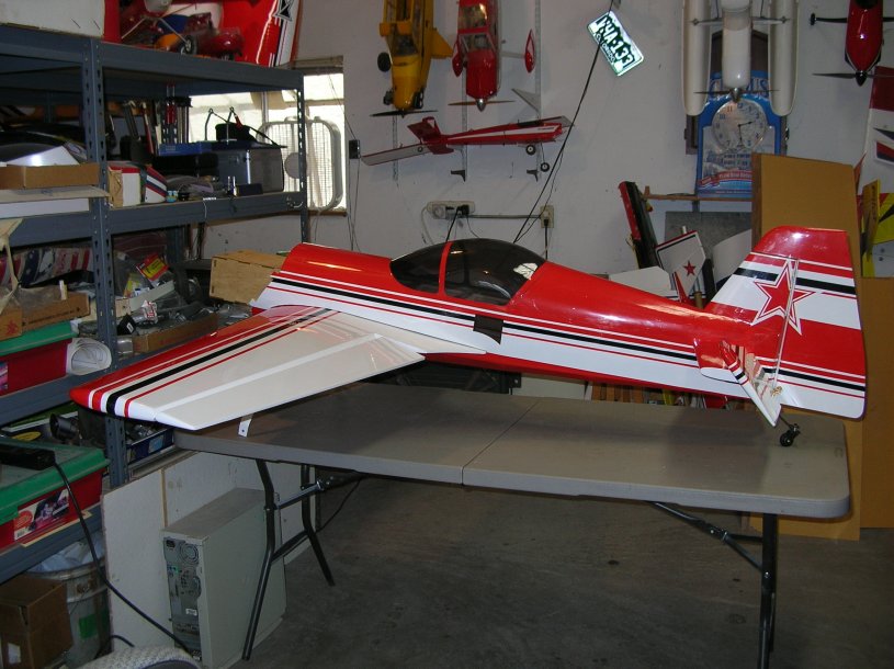

I'm slowly plugging away. Everything dry fit ok. Landing gear is on.Tail surfaces glued up. Elevator servos installed. Waiting for the UPS guy for an engine. Then I'll get serious. Trying to get some stick time in between the snow and high winds out here.
The washer was bigger than the hole for me, the slots and holes were way off and one TNUT wasnt threaded. I ended up cutting open both areas and made new balsa pieces and recovered. When I cut open the areas I found the sheeting wasn't glued at all on the one side and tri-stock pieces were kinda cracked in half instead of cut and the whole areas looked much different than the other. I cut more covering off so I could sand the new pieces of balsa and recovered, everything is fine now.

This is a PAU? They are usually much better built than this.
Yes it's a PAU and not what I was expecting either. I couldnt believe I had a problem with nearly every step that I will not get into but the final step was the wing bolts and they were really mis-aligned. Now I see the pull-pull wires are rubbing on the inside of the fuselage, I tried crossing the wires to no avail.
I agree that the newly designed PAU planes are likely much better quality but I wanted a Sukhoi and only read good things.
