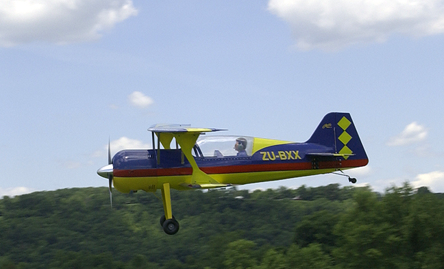

love that Pitts Model 12, which airframe is that?

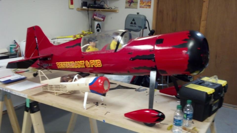

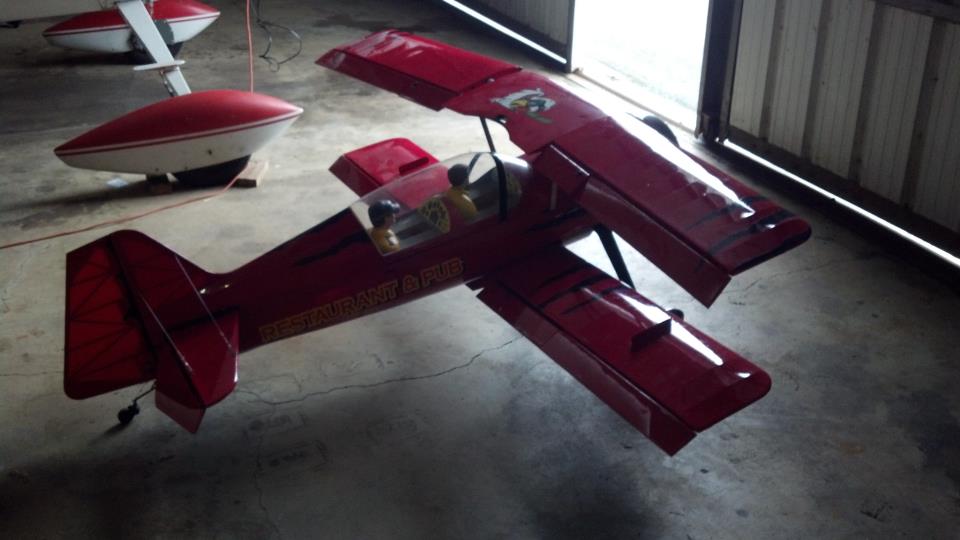

The Pitts is the Trueworthy 35%, it's been around the mill. As far as I can tell I'm the 4th owner, it's had 3 or 4 different looks also. Here are a couple pics I have of it when it was older, it was Red and Black when I got it.
