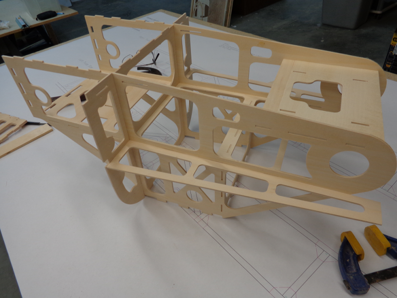

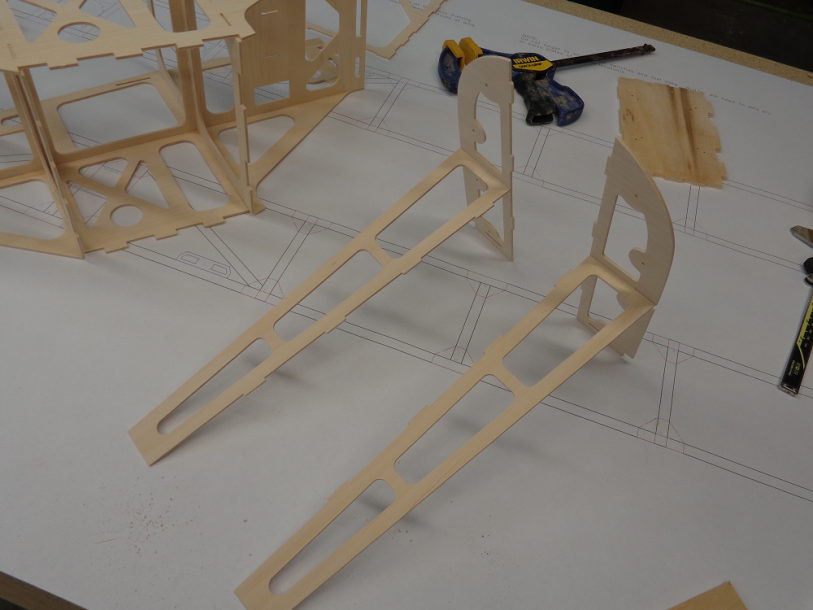

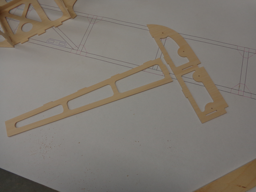

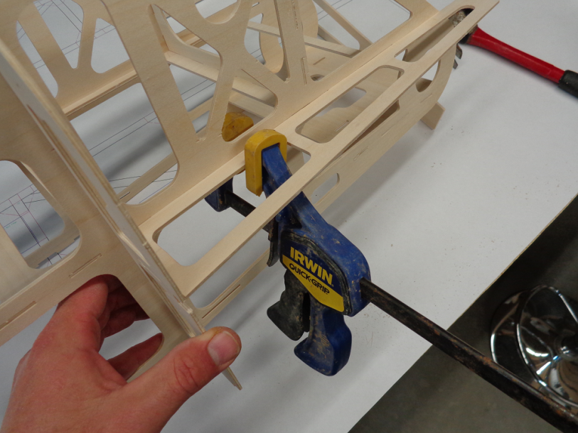

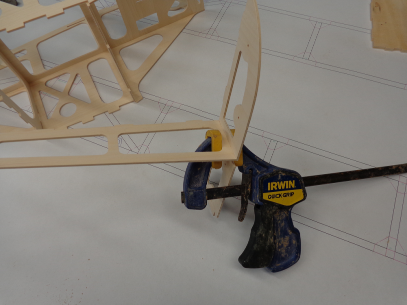

Working on the motor box sides I started with the LH of TG1 and F1 then fastened these two together and then done same for RH sides TG2 and F2 (no glue yet). For some of the parts instead of using a smaller hammer to tap parts together I use a grip clamp to squeeze them together. In fact I rather use this over tapping them together if possible. Then once they were together I installed the assemble parts to the motor box sides.

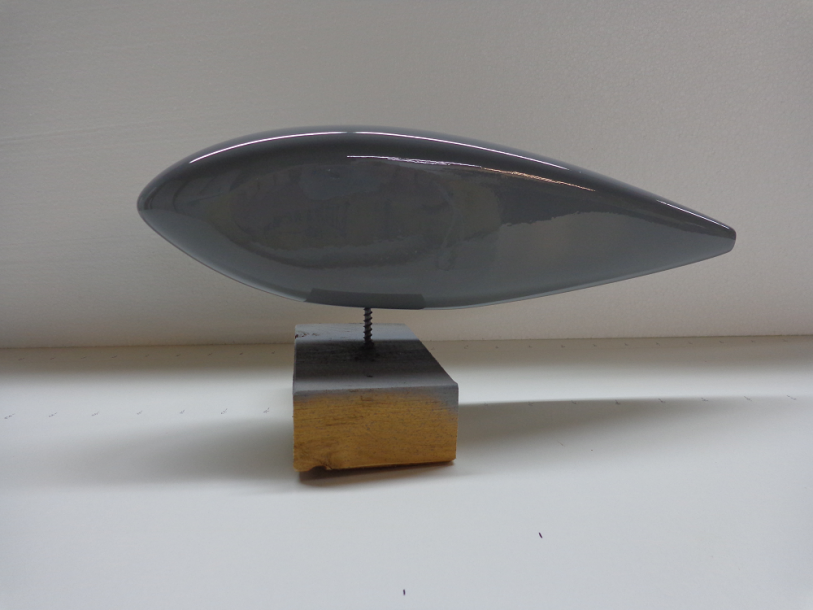

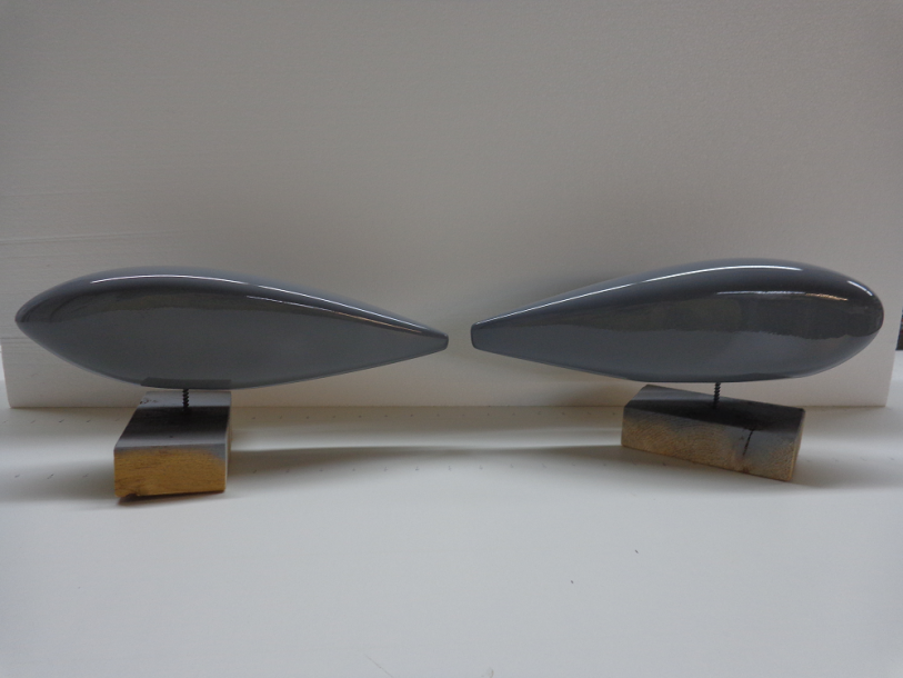

I also spent some time over the weekend working on a new wheel pant plug. This will be used for both the 35% HyperLITE and the new Viper-ST. After lots of sanding primer, painting the plugs are now ready and it's time to start on the parting board and making the new molds.
For paint and primer of the plugs I just used cheap rattle can primer and paint. The extra time and cost of high end auto paint never seems to be worth it when the real layer of the plug is not so great PVA mold release. I’ll post more pics and the process as I do this part. The second pic shows a new plug to be used for the 42% HyperLITE.
I used the grip clamps on the motor box of the big brother to this one and it does work very well
