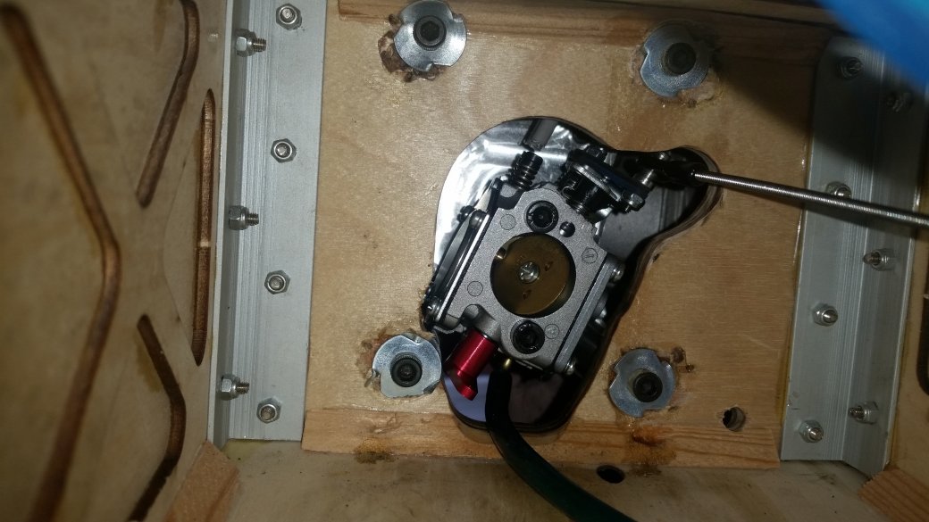

Just had an epiffany, while posting in the ZDZ lounge FB page........,
I could have not opened the choke all the way. It would make the engine run real rich, and make it virtually untunable.

This is how I found it today after work......View attachment 54640
That would seem to limit your RPM's a bit! But we'll go easy on you, it's Spring and we're all getting back in the groove for flying.
I actually had this discussion today with @Flyrcjoe, I'm a super choke servo hater as it adds another thing to fail and a little weight but on the ZDZ's they sure to make life easy and simple. I did run a bell-crank with a rod out the side of the fuse on my ZDZ90 that worked great, that may be an easy option as well.
I hear ya. A friend and I flipped on his DA200 for quite awhile one day and couldn't even get it to pop. We pulled the hatch to check a few things and instantly smelled cooked electronics. The 8711 he had on the choke was cooked.
But with some setups it sure makes life easier.;)
I did the bell crank thing on my 80rv the first plane it was in. After that, a ran a nyrod and curved it to the side of the fuse. Threaded a 2-56 bolt into the end so it stuck out just far enough to grab.
