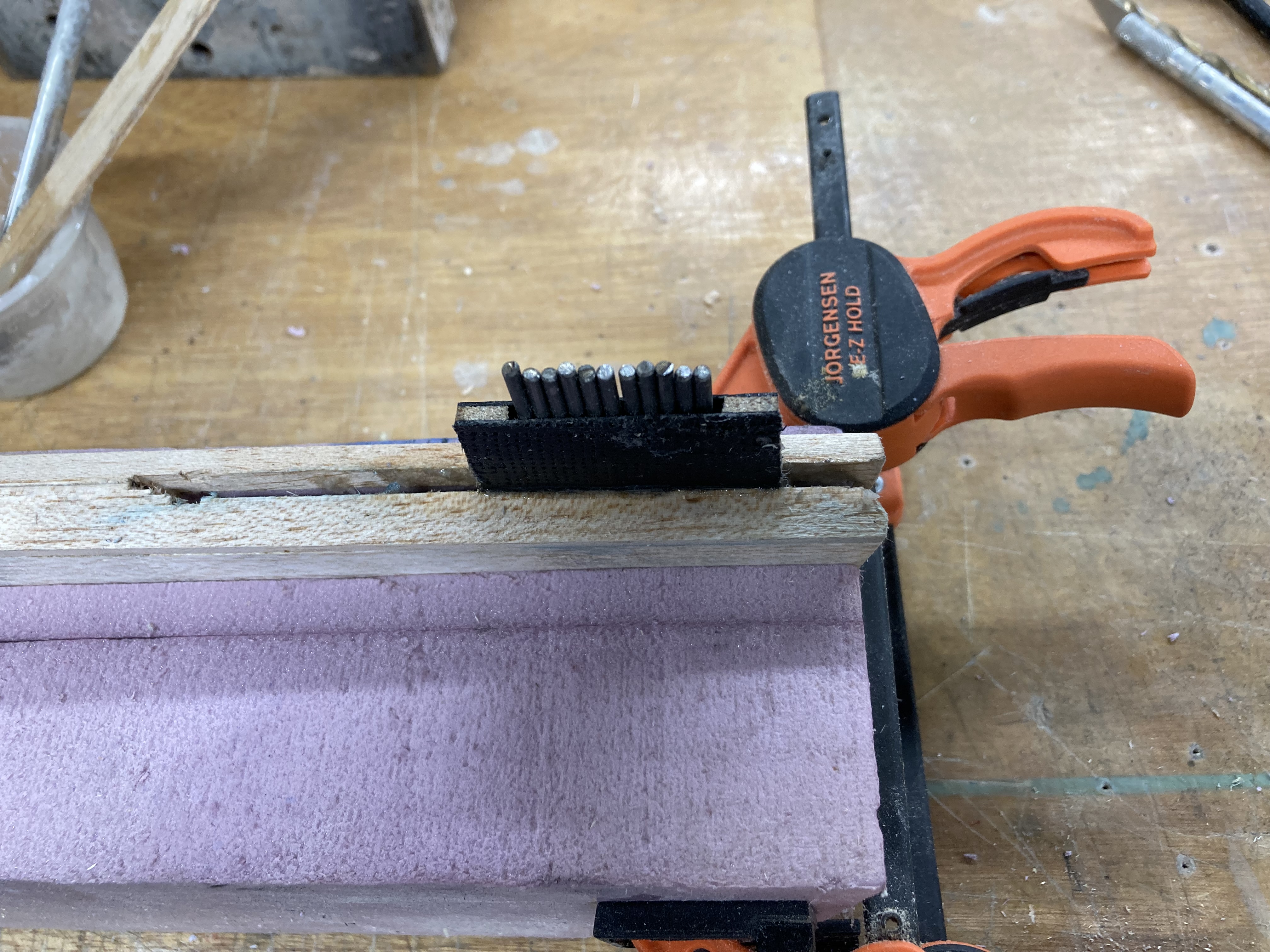

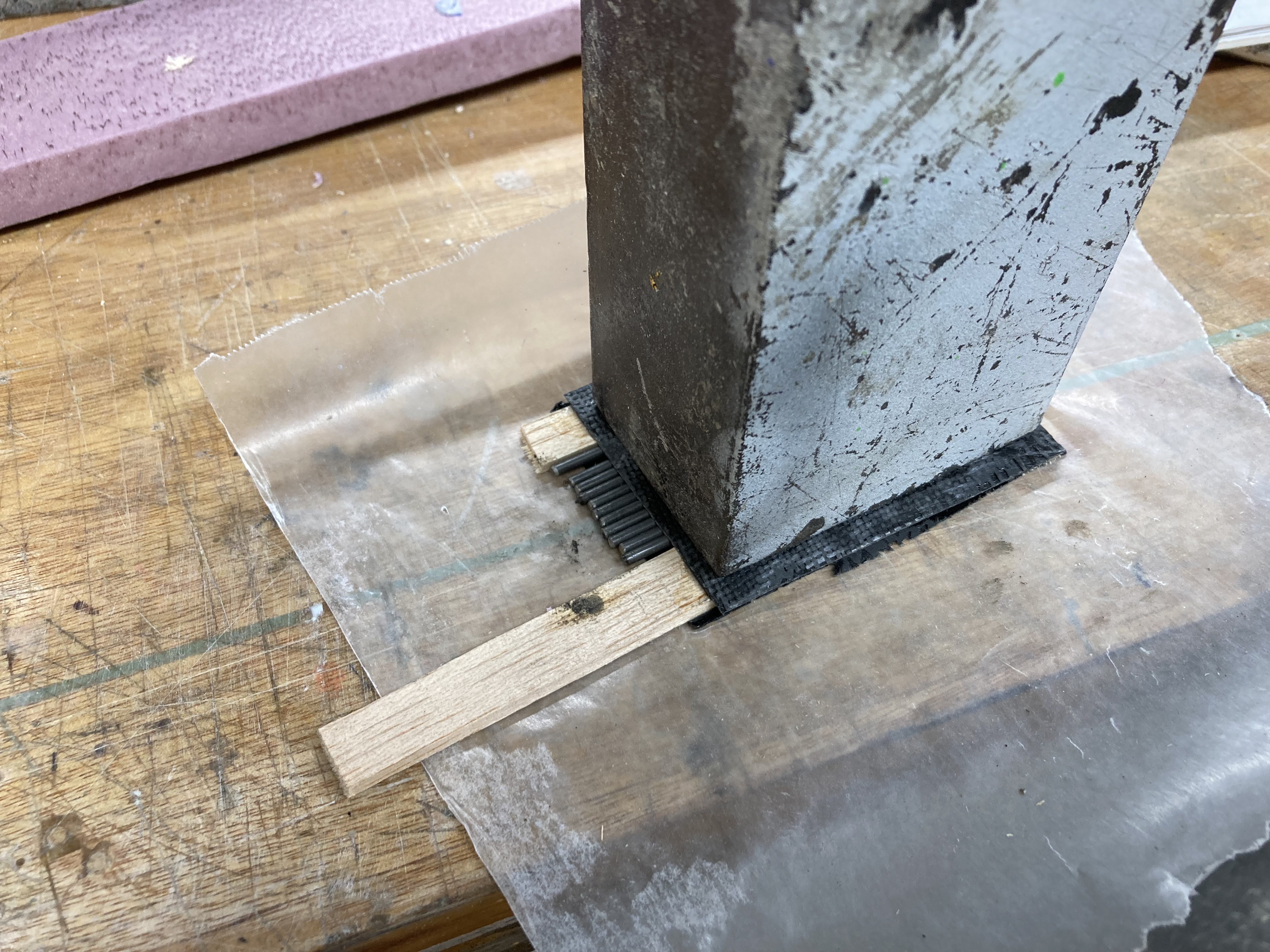

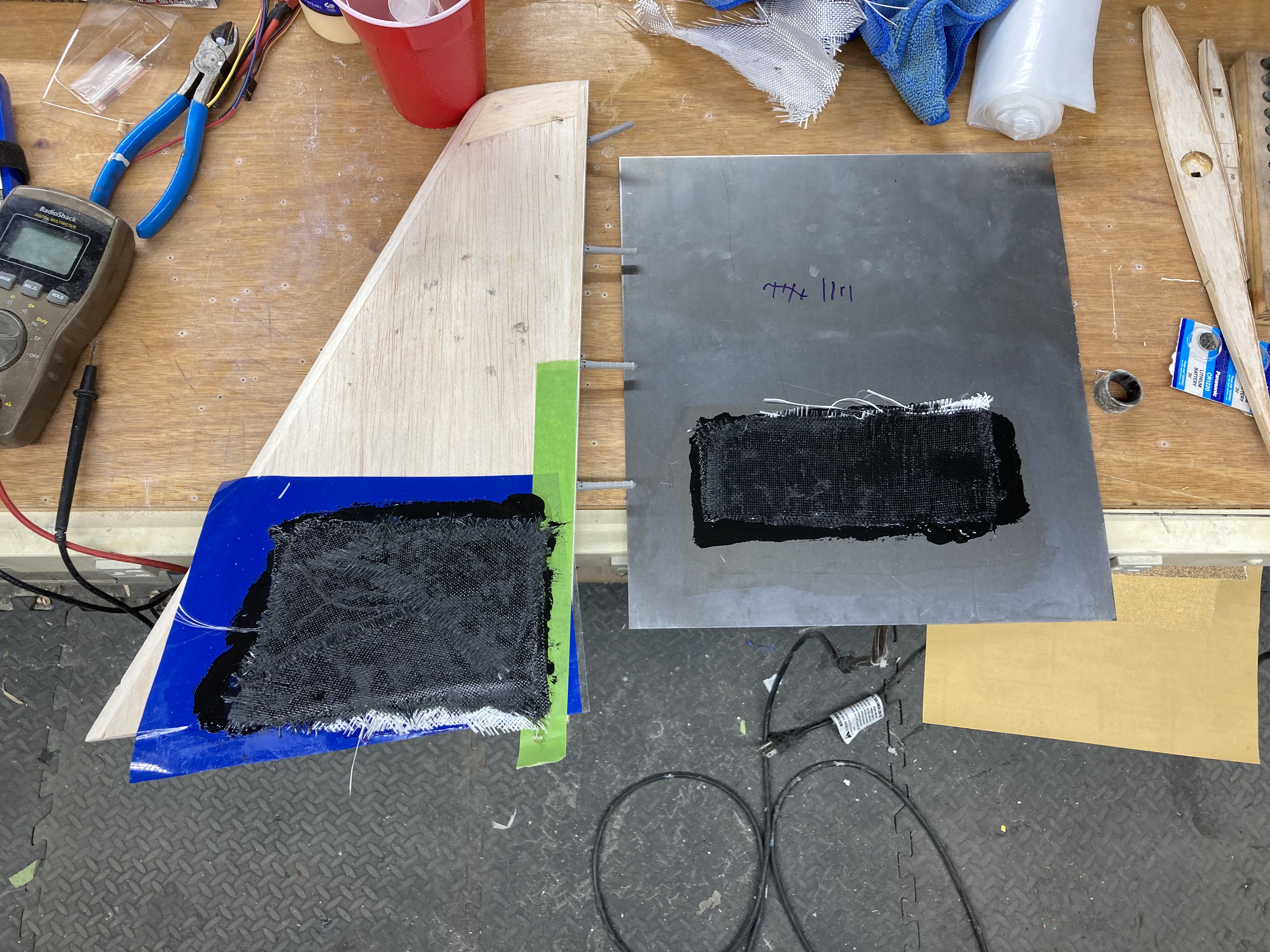

Started working on the RDS, made a mold of the fin area where the servo will be located, will lay up a glass hatch. I used Formica for the slider boxes in the original Cherokee, was thinking about using G10 for this build. The description of G10 on McMaster Carr states
"A good all-around choice, these Garolite G-10/FR4 sheets and bars are strong, machinable, and electrically insulating. They're made of a flame-retardant epoxy resin with fiberglass fabric reinforcement. Garolite G-10/FR4 is also called epoxy-grade industrial laminate and phenolic."
I thought rather than buy it just lay up a flat piece with low friction graphite power added, this was done on a sheet steel.
TonyHallo
Decided to use 3/32" music wire, the slider box was made with 3/32" balsa and CA glue. The balsa was sanded to .001" bigger than the wire and glued together with short stubs of the wire maintaining the spacing. On the first plane I didn't pay a lot attention to controlling the spacing so the left aileron had more clearance than the right side, always bothered me. This one has a nice fit. A groove was cut in rudder with a table saw and the slider box is epoxied in, once cured the remainder of the groove will get filled with balsa. The hatch is laid up and once cured the servo pocket will get cut. I have a 6 mm servo connector on the way to joint the servo to the wire.
