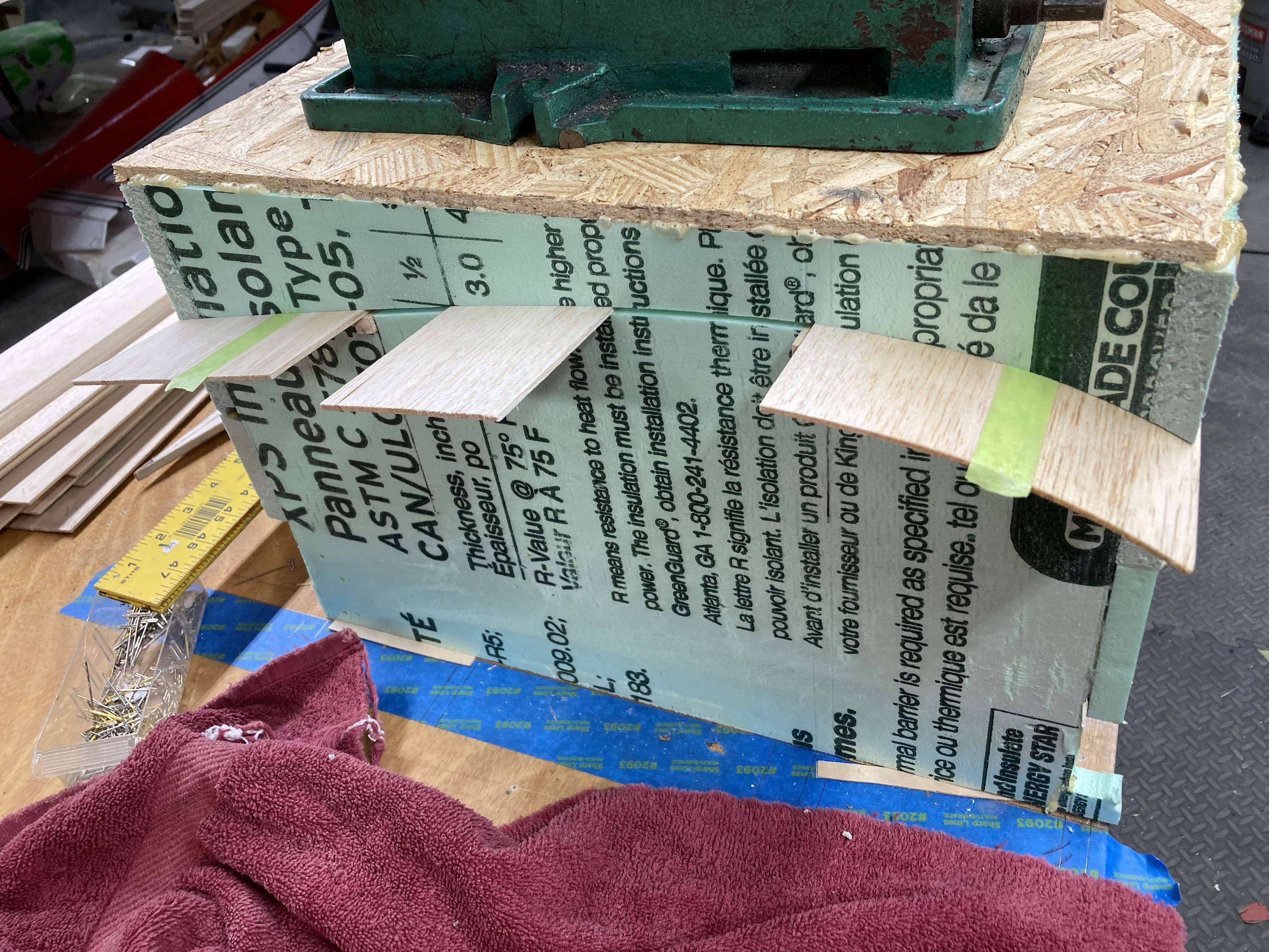

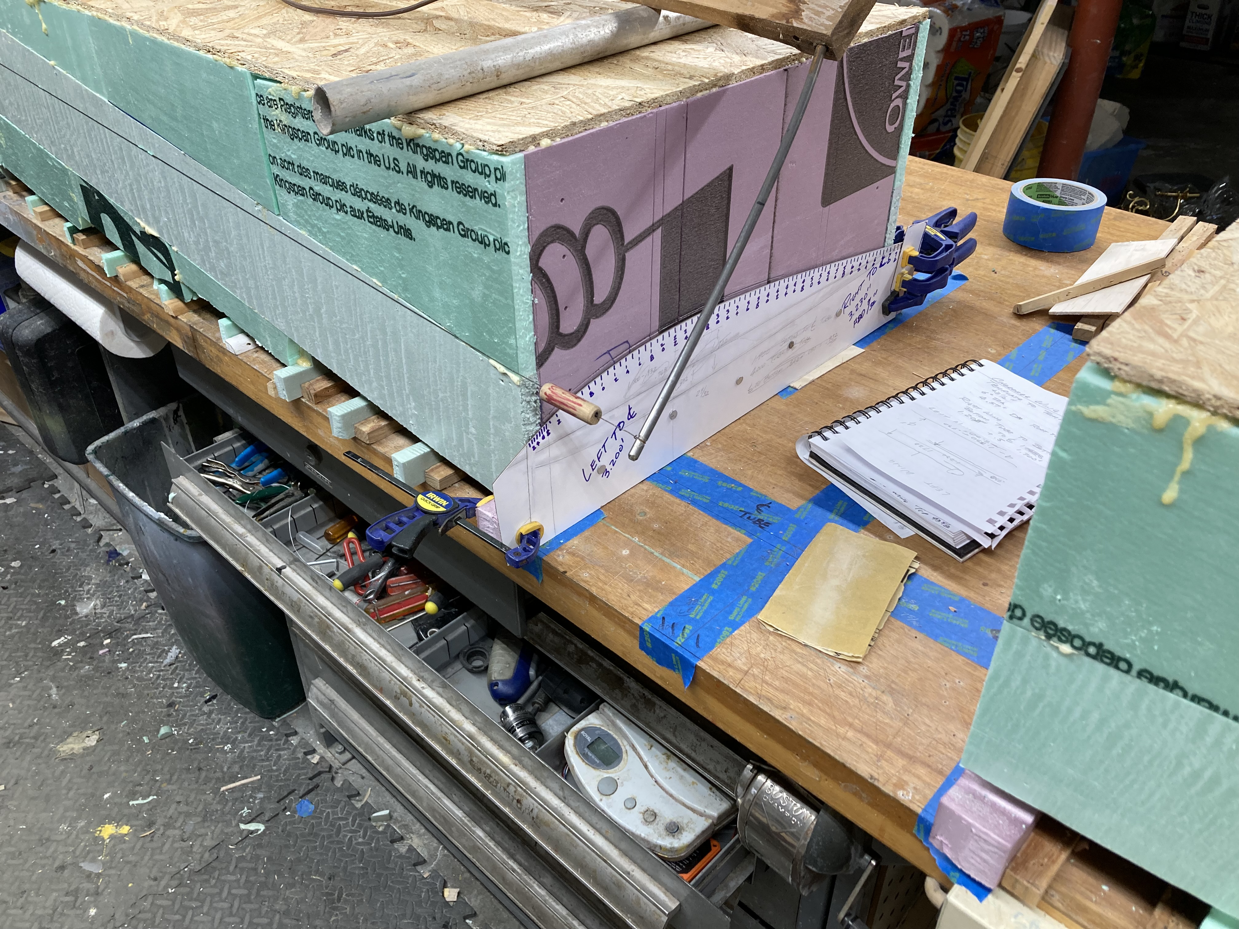

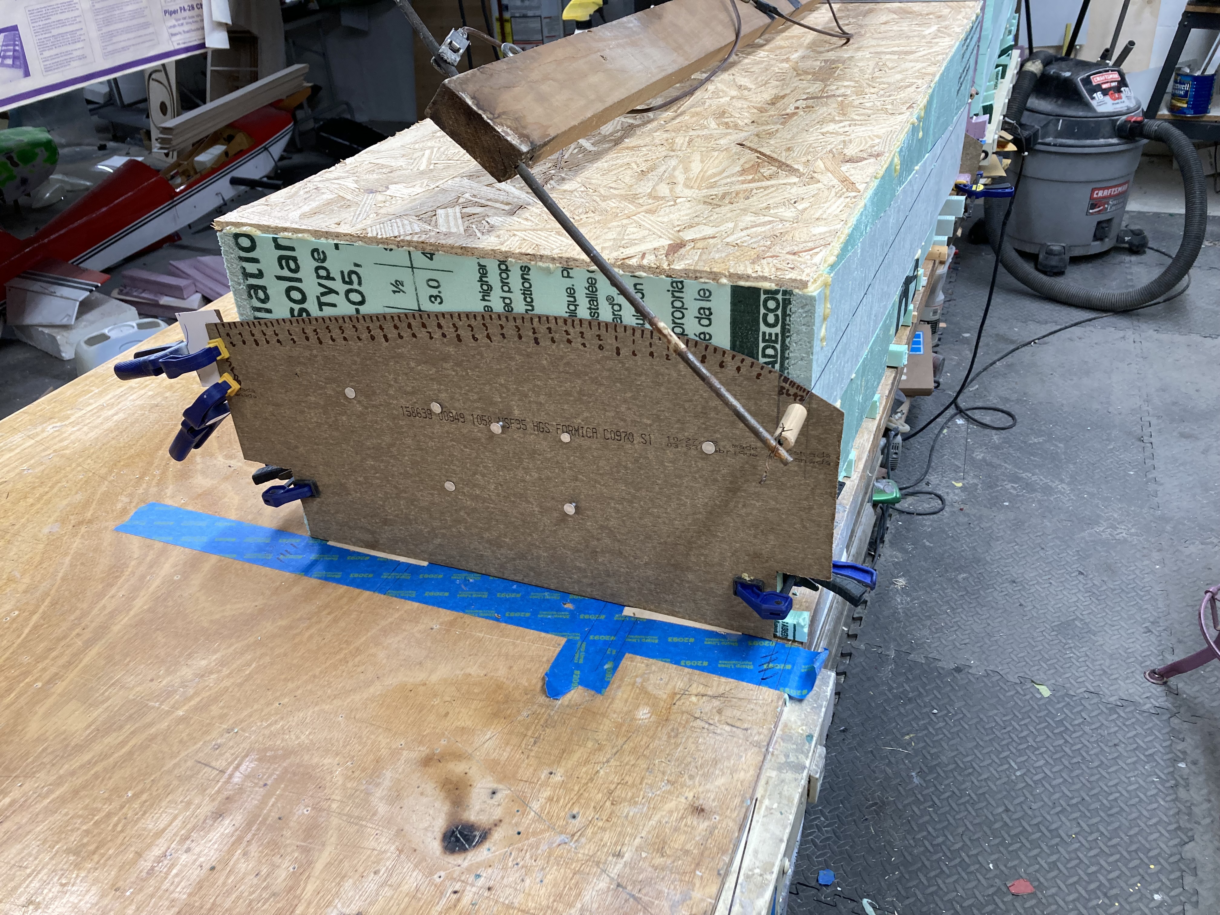

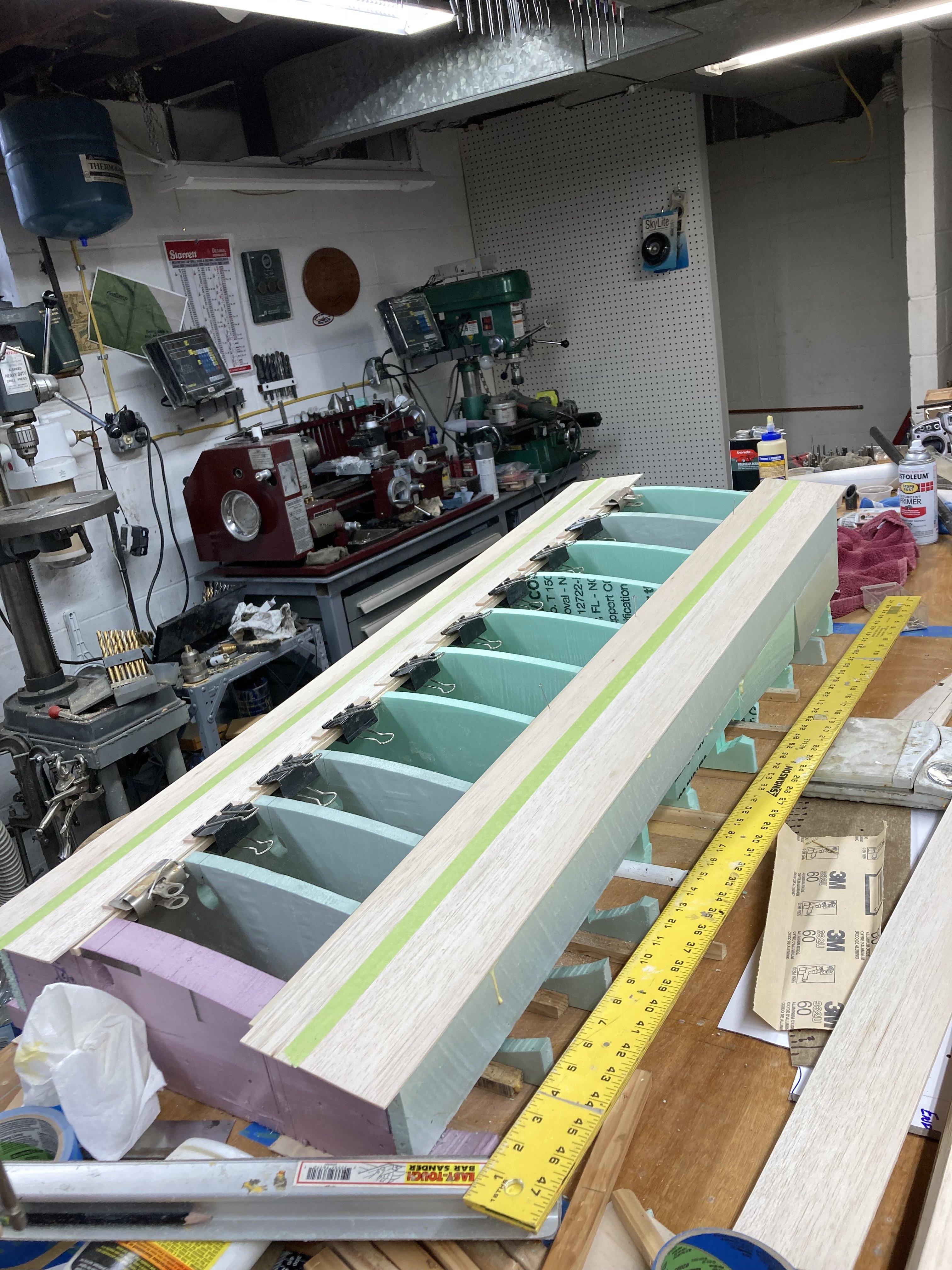

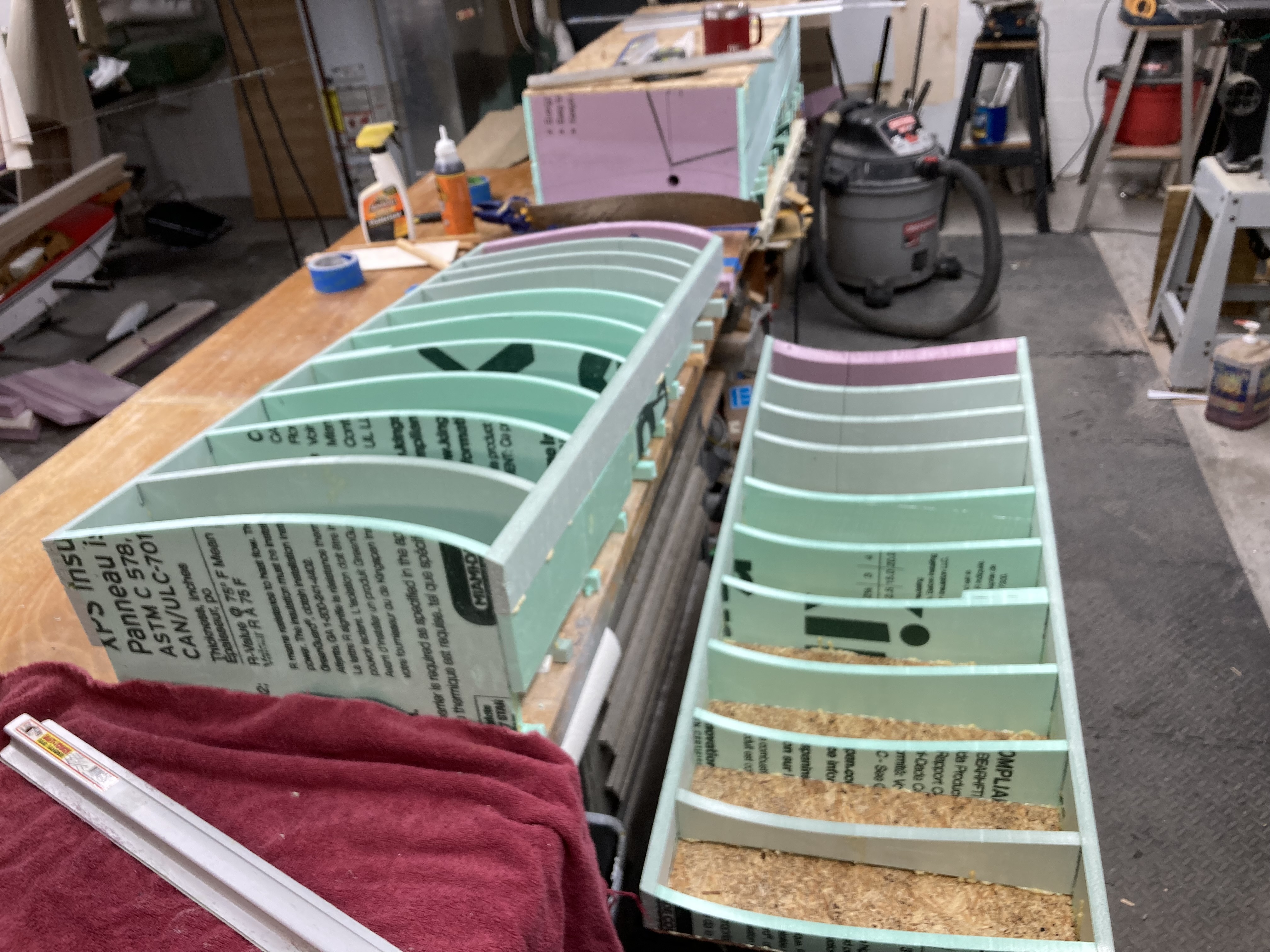

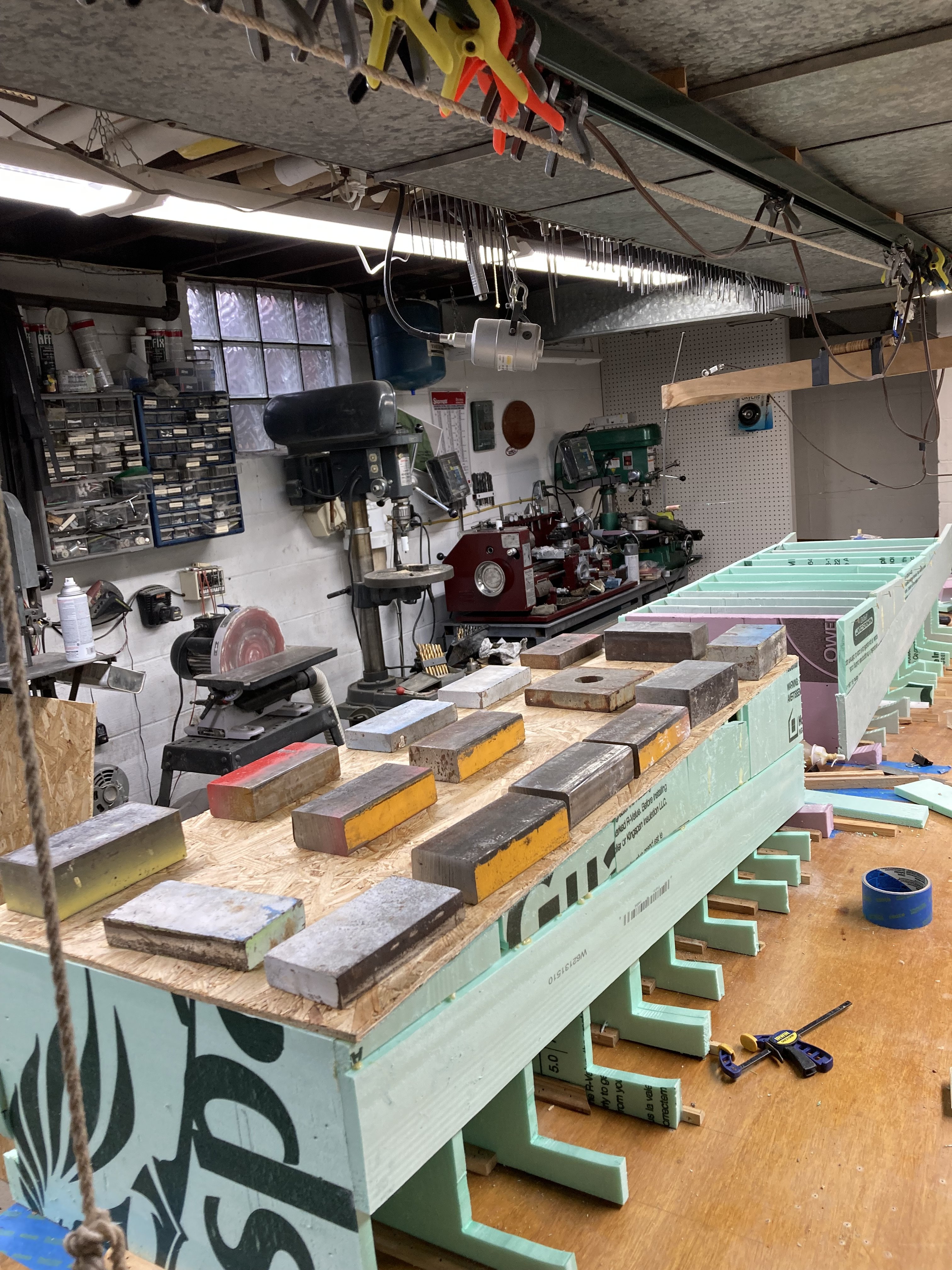

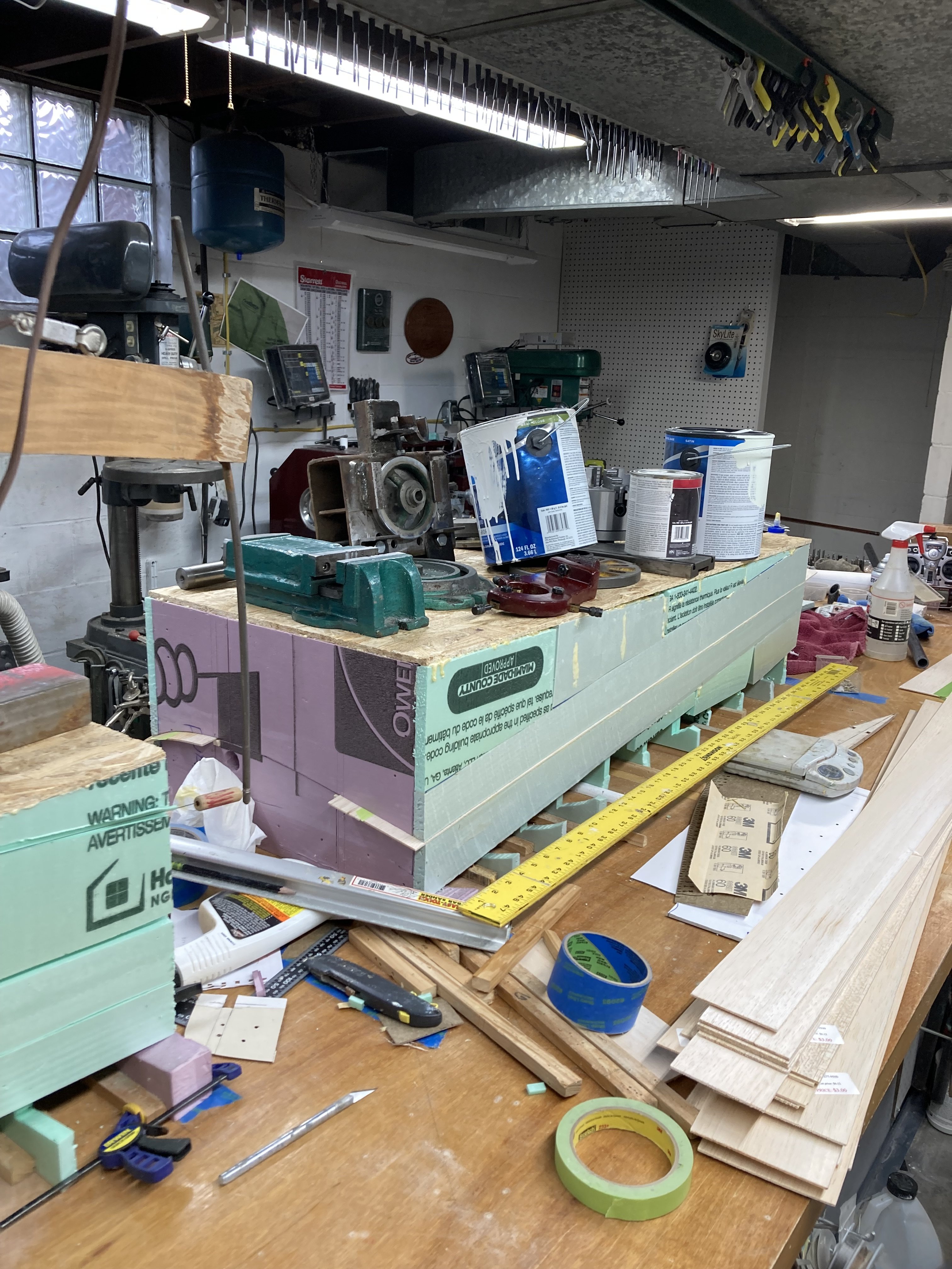

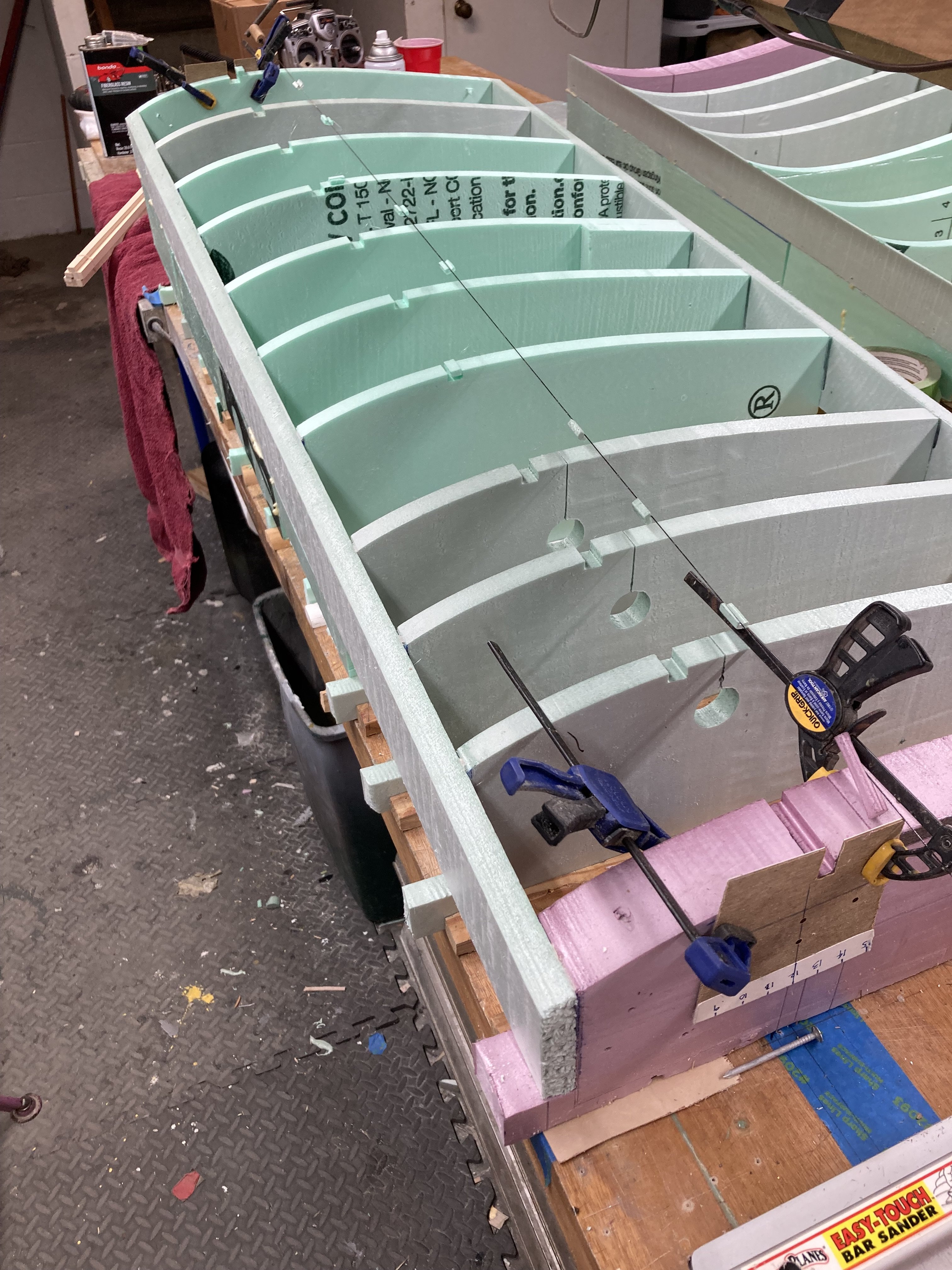

The leading and trailing edge sheets are installed and the 1/4" underlayment is glued on the left wing, the right side is a little behind.  Might get it glued in place tonight.  My wife is having eye surgery tomorrow so will not be able to cut the top airfoil until she is seeing better, maybe Wednesday.  I'll be out of pocket tomorrow and the following day at any rate.  The wing looks a lot bigger than the original Cherokee, it was 100" span, this one is 108".  2052 square inches.
