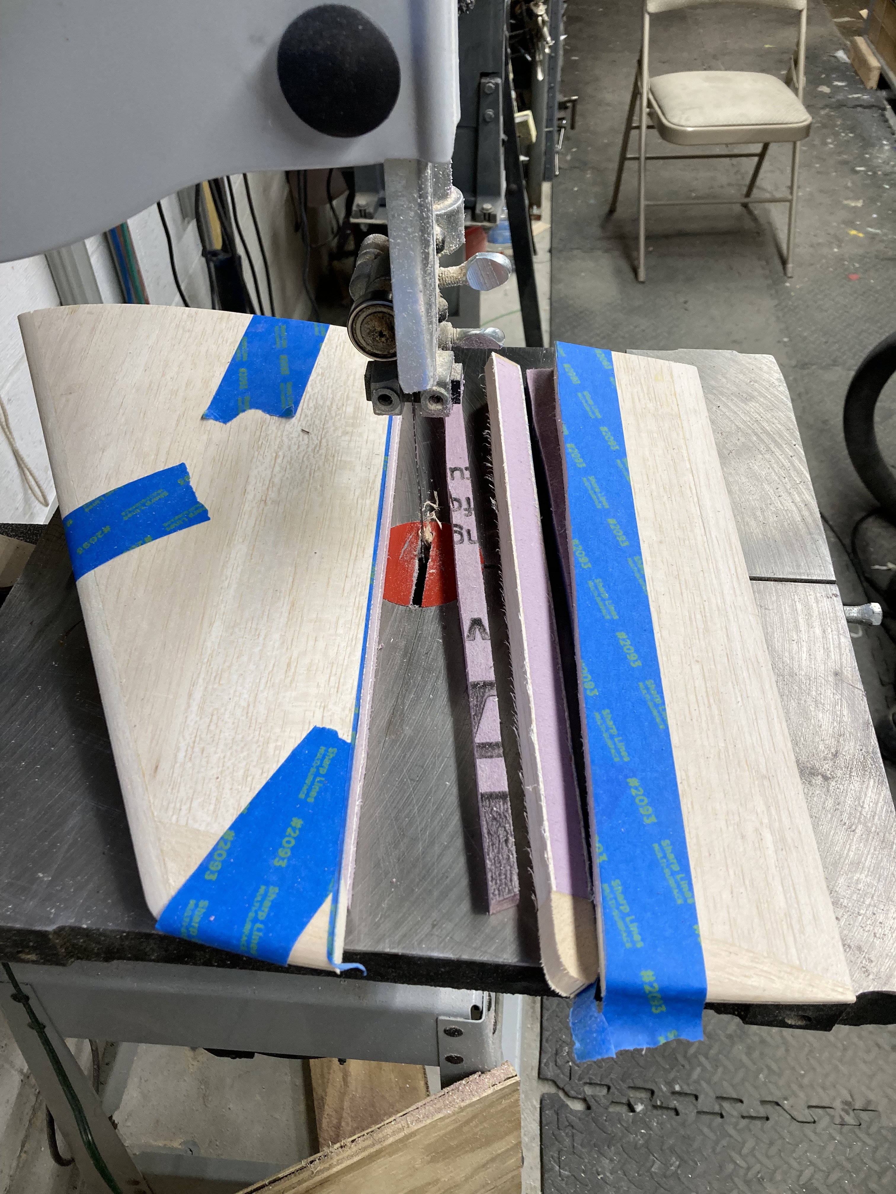

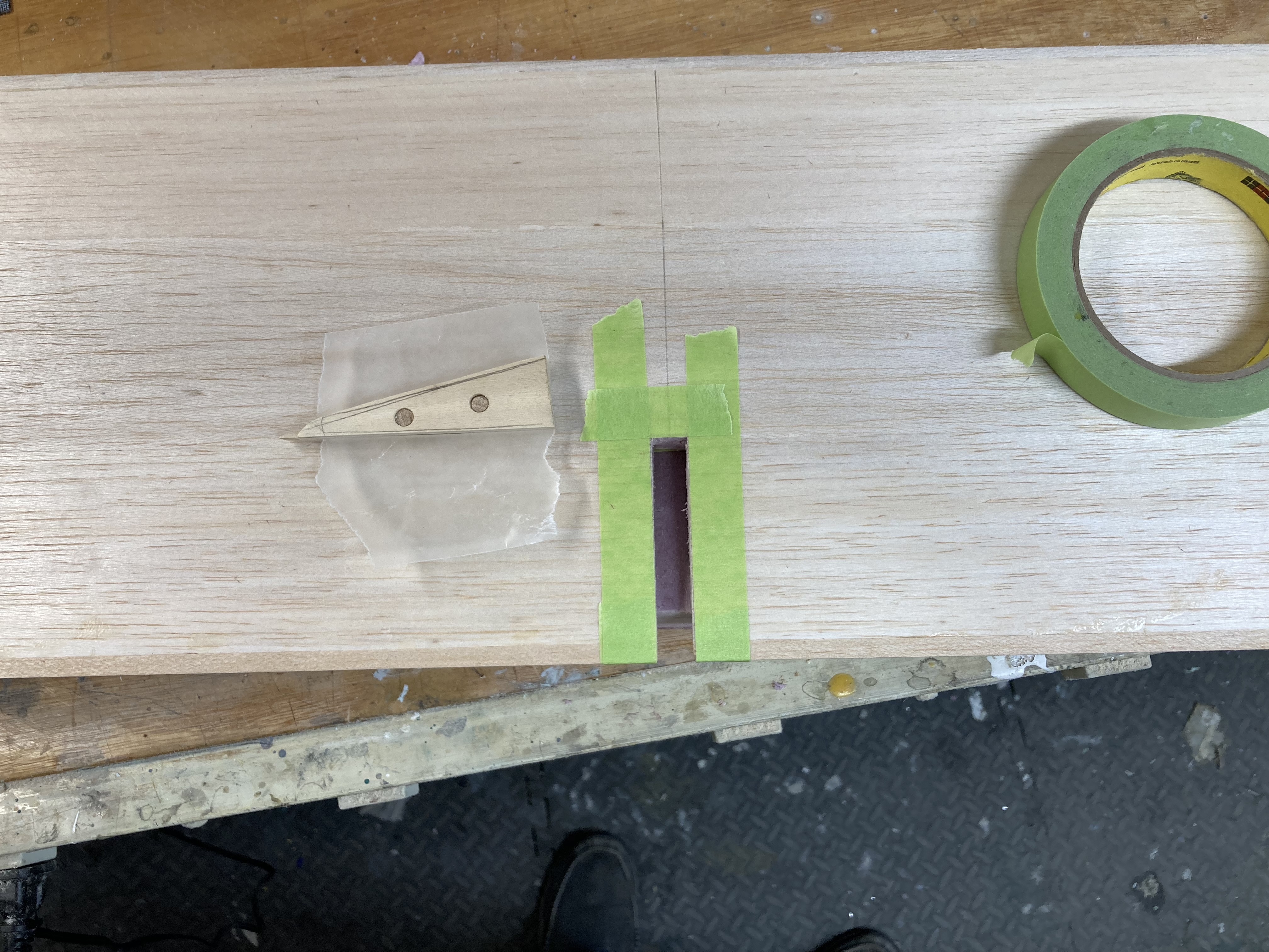

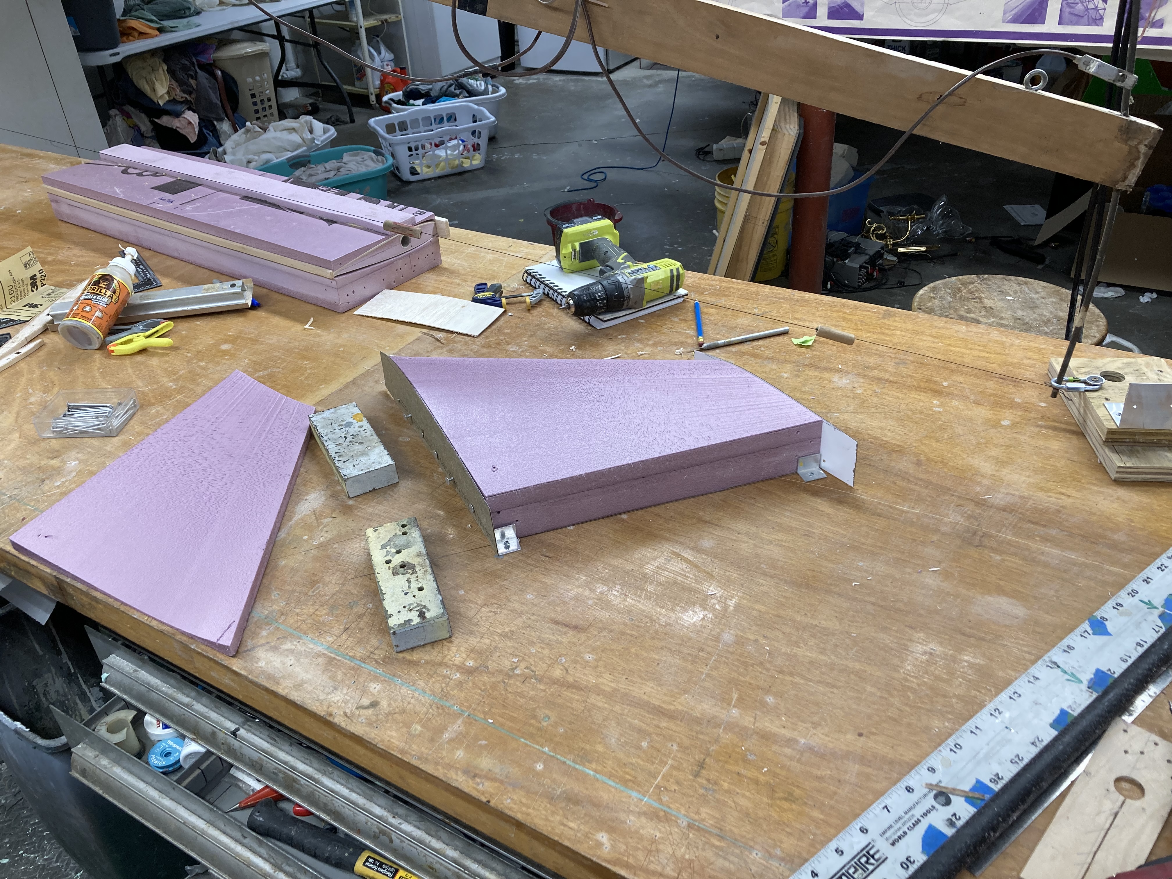

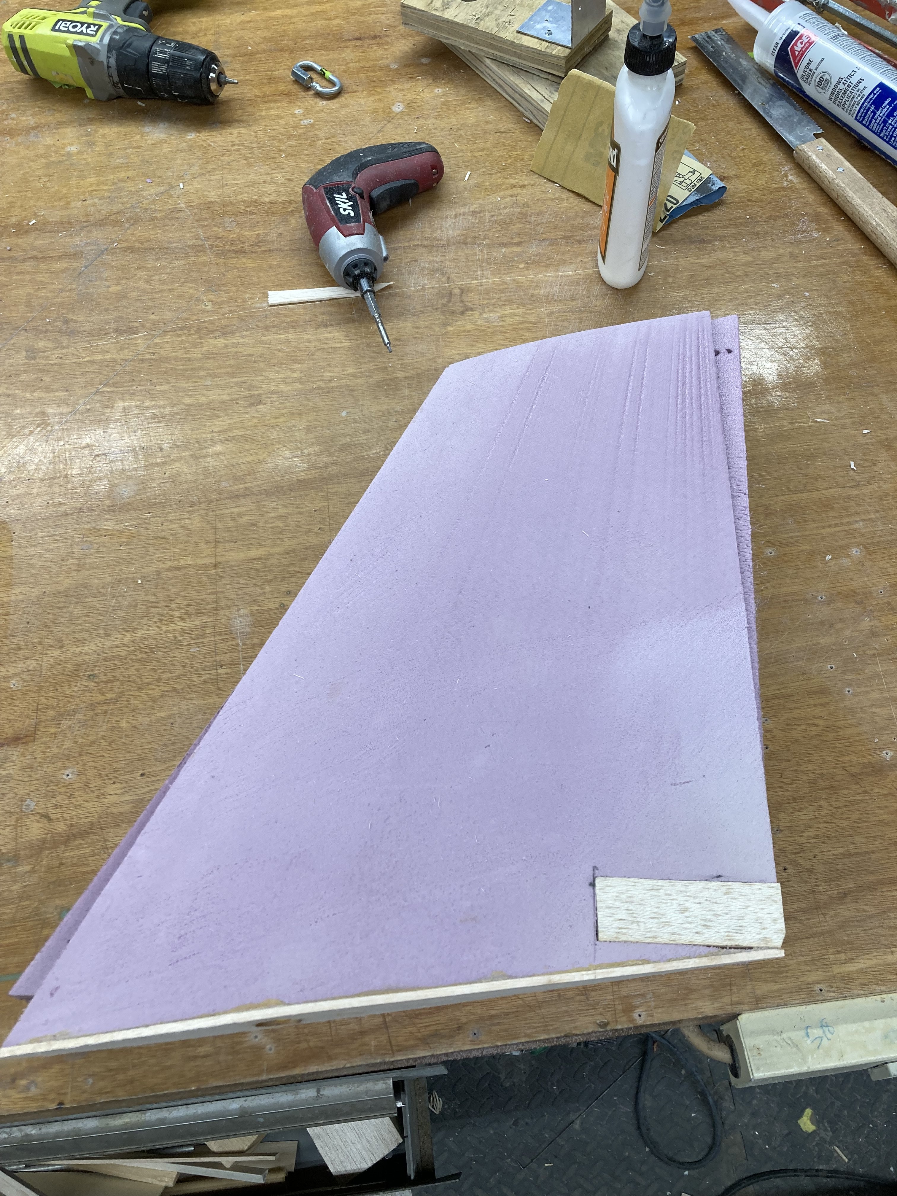

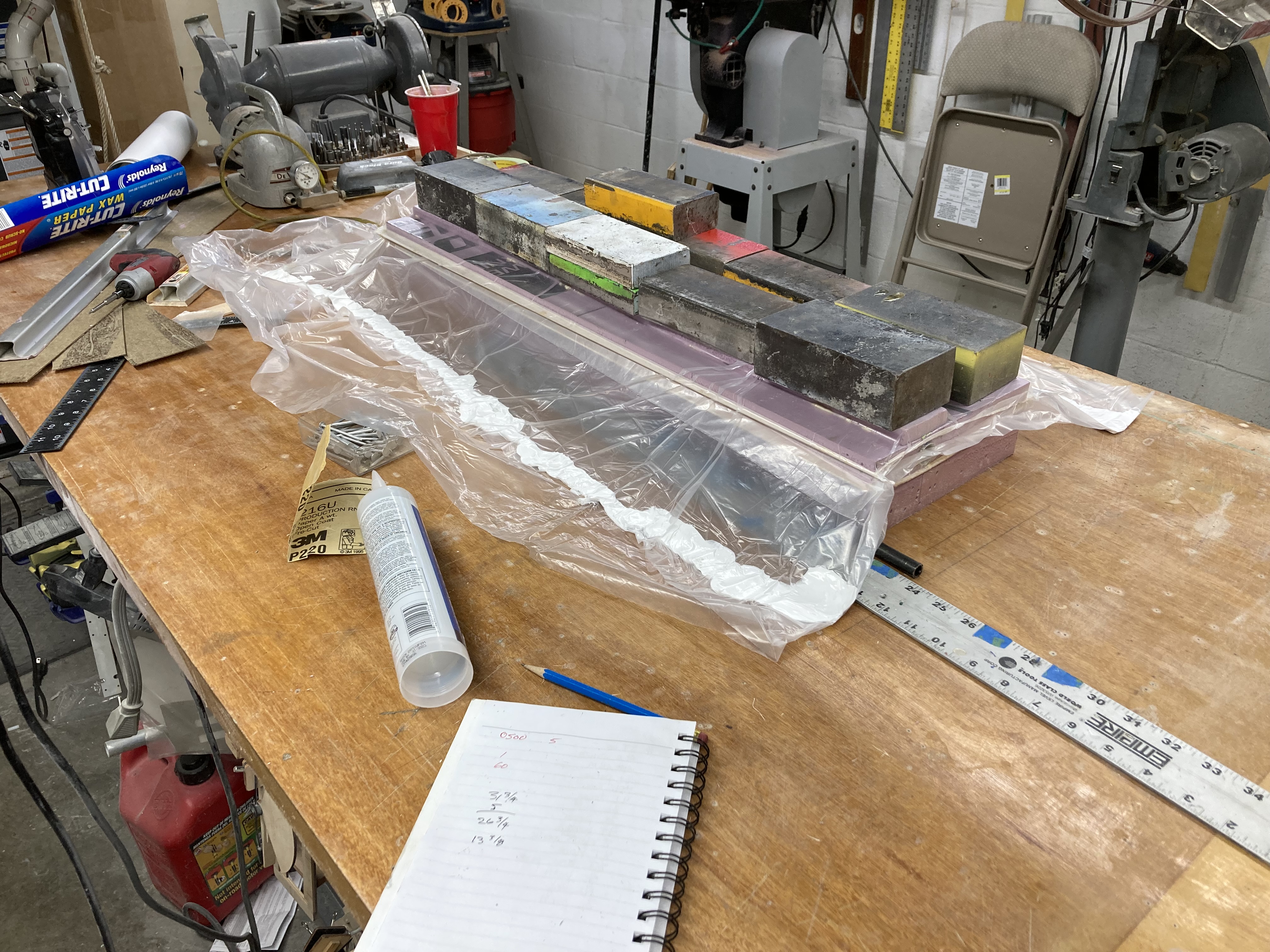

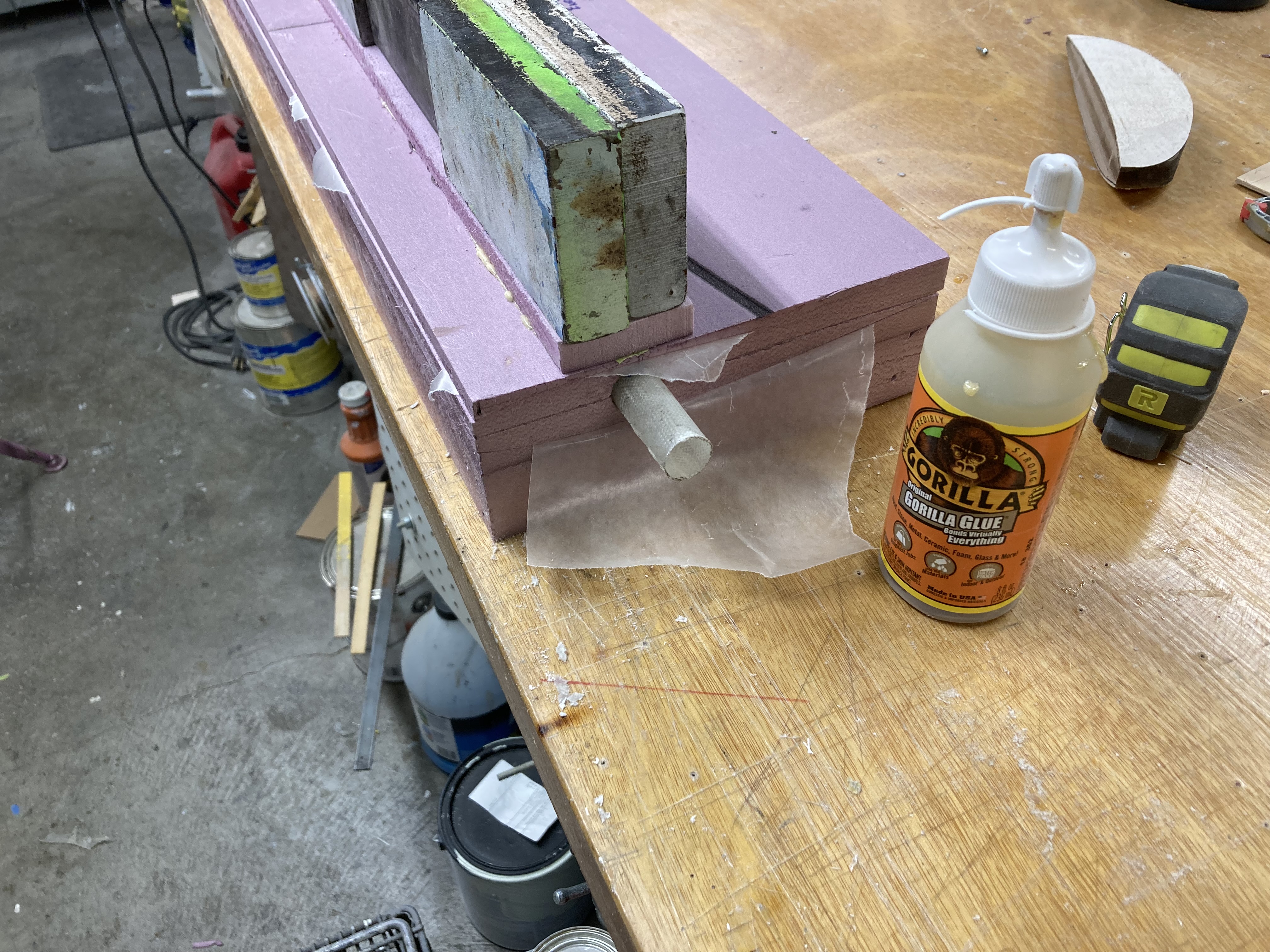

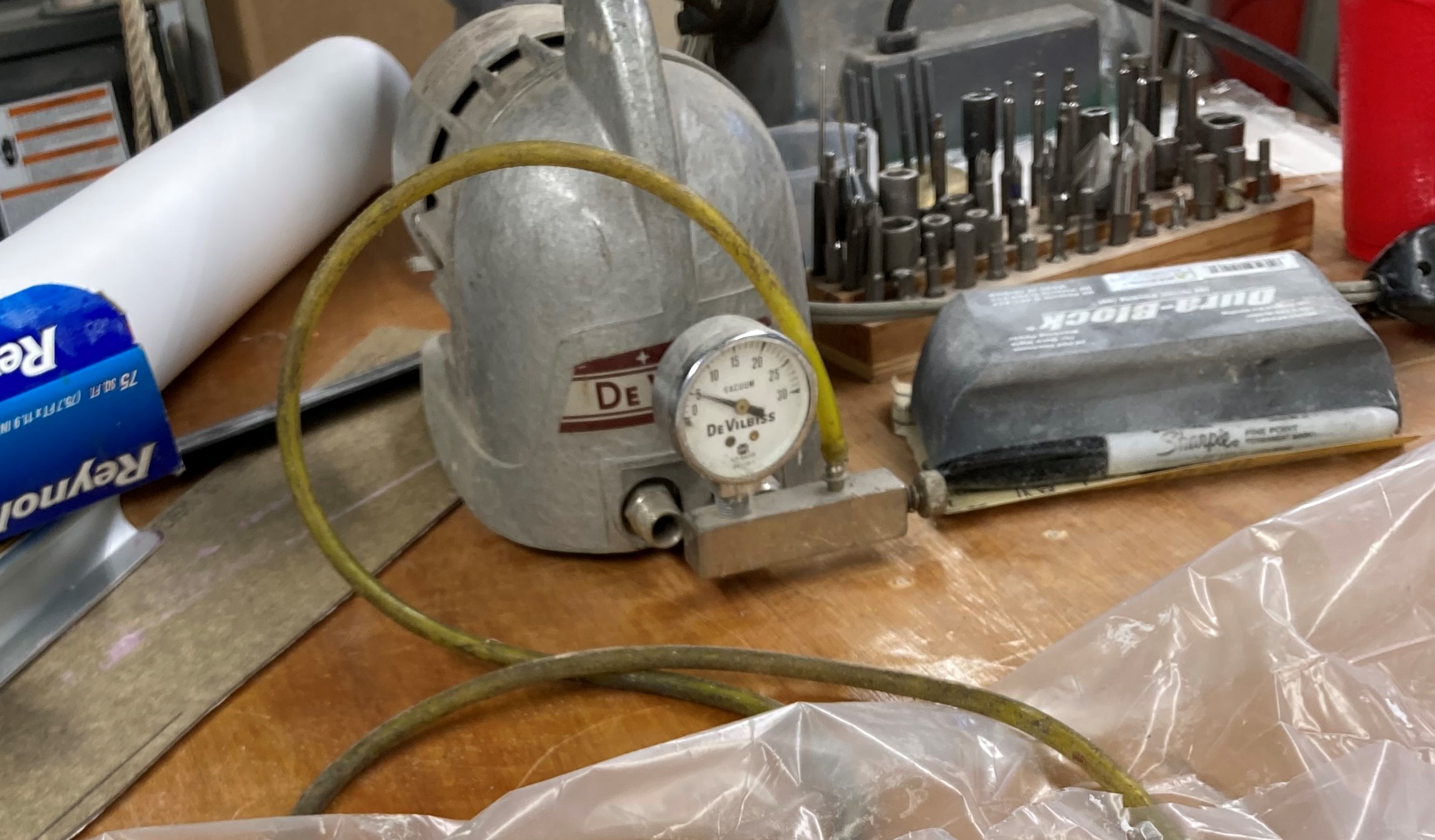

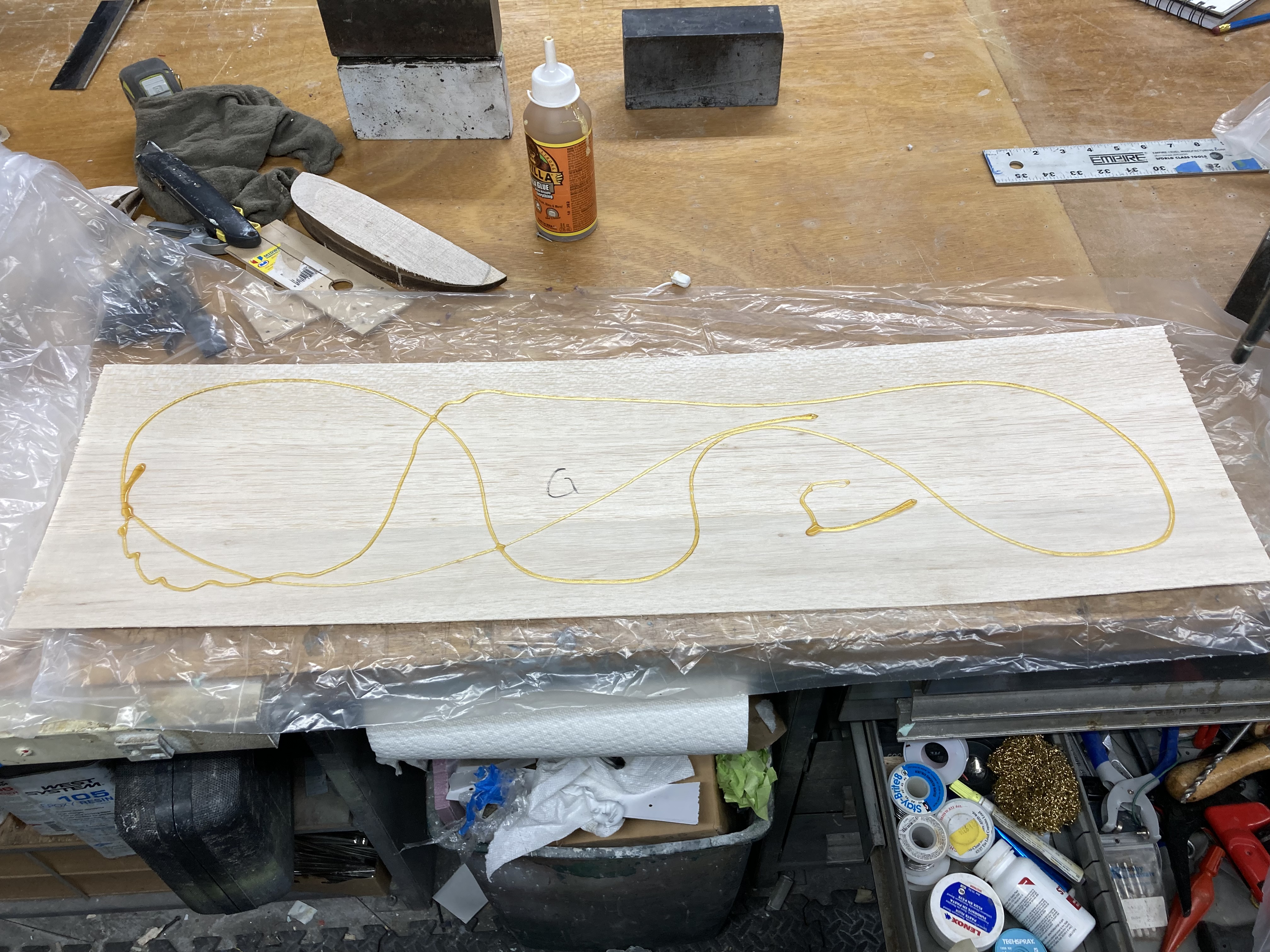

The sleeves are glued in with Gorilla glue, once cured the skins will get glued on.  The skins were block sanded with 320 and are ready to go.  The vacuum pump is checked out and ready to go.  It has been several years since the pump was used, bought at flee market some 30 years ago.  Use plastic drop cloth for the bag sealed with cheap door and window caulk, vacuum is controlled by a bleed valve on the pump.  Use 5" for white foam, will go a little higher with this foam.  The system is crude but effective, no need for fancy controls and reservoir.
Time to look at the vertical fin and rudder.
