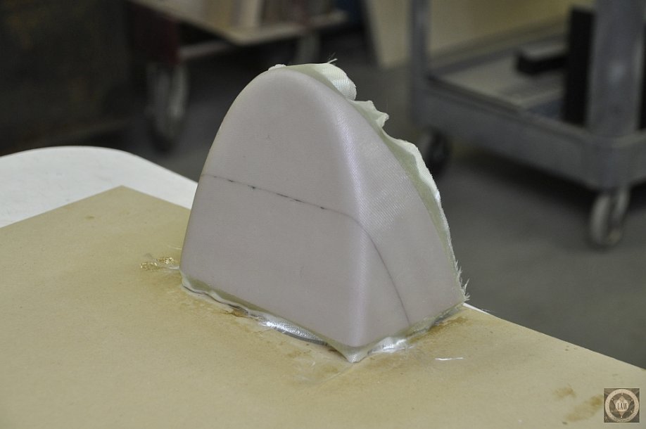

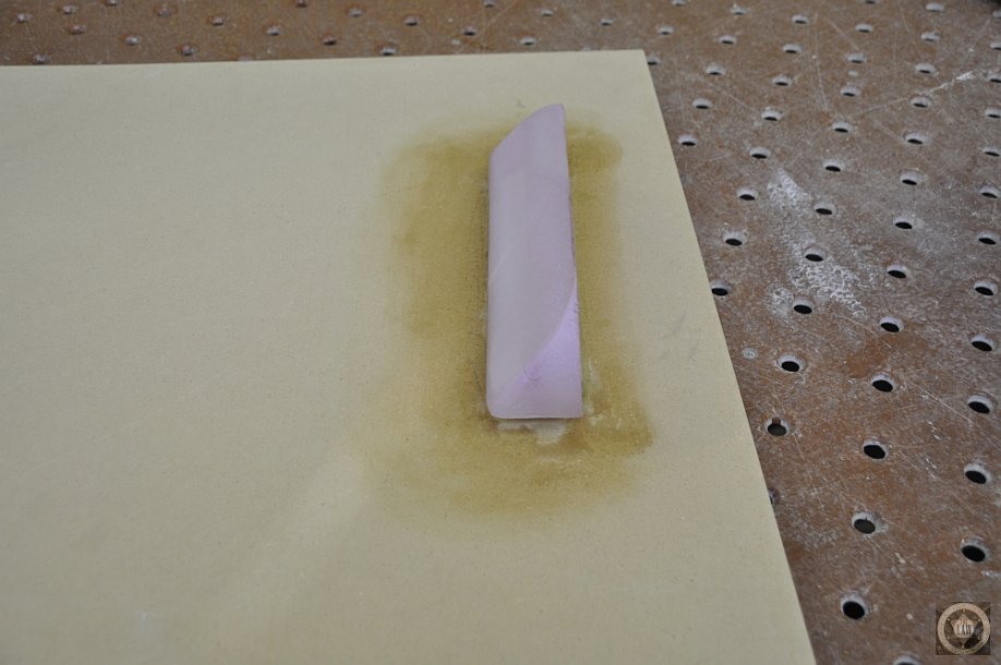

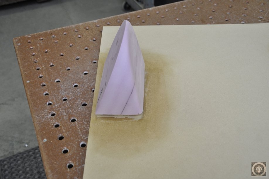

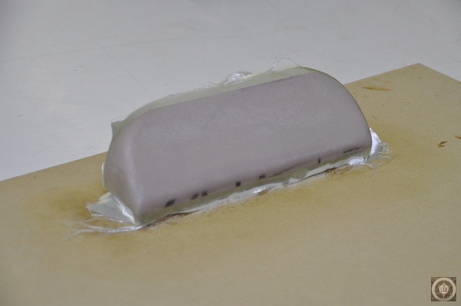

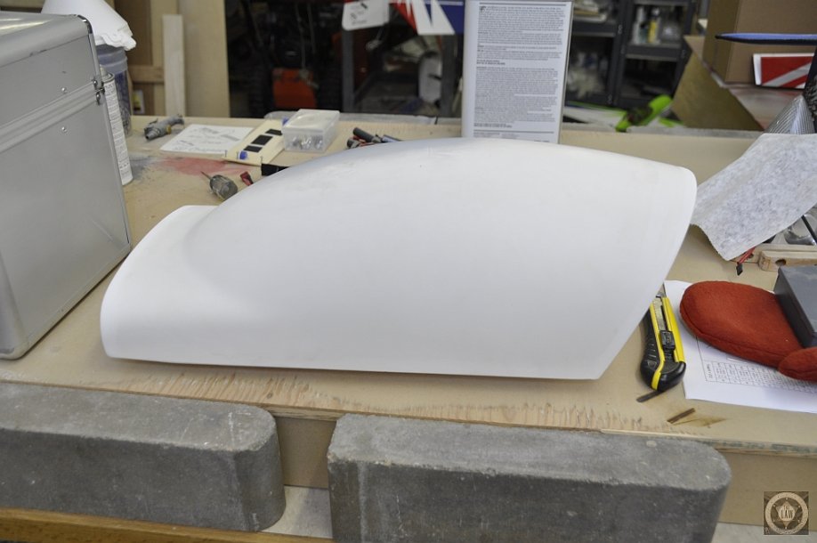

Made quite a bit of progress today. The canopy needed to have some positive relief added to both ends to aid in removal of the canopy after vacuuming. So I carved up some dense pink foam, hit it with some "thick n nasty" hairspray and laid up two layers of 9.5oz satin fiberglass. Before I left I was able to rough trim the parts. Tomorrow I'll hit them with some bondo, epoxy them onto my plug, blend that in with some more filler and I'll be ready to shoot a couple layers of epoxy primer.
Little sanding and ready to pull parts!!!

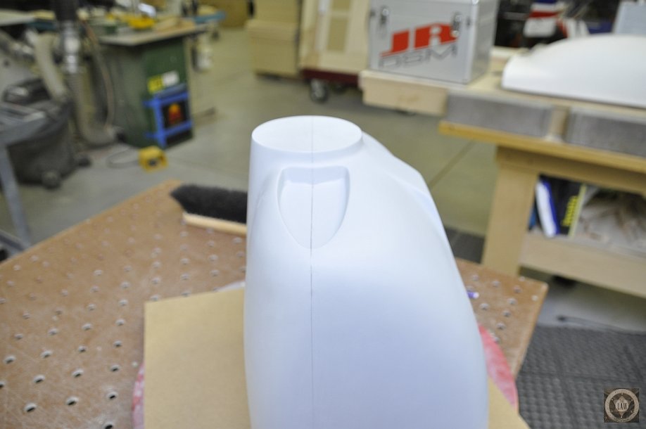

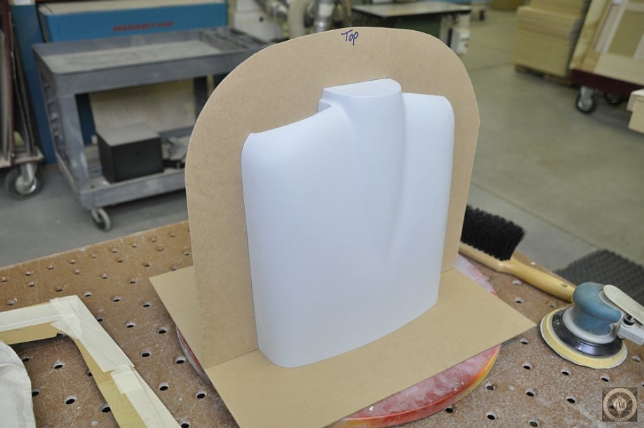

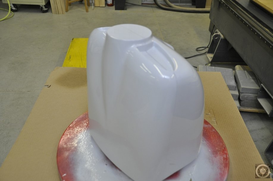

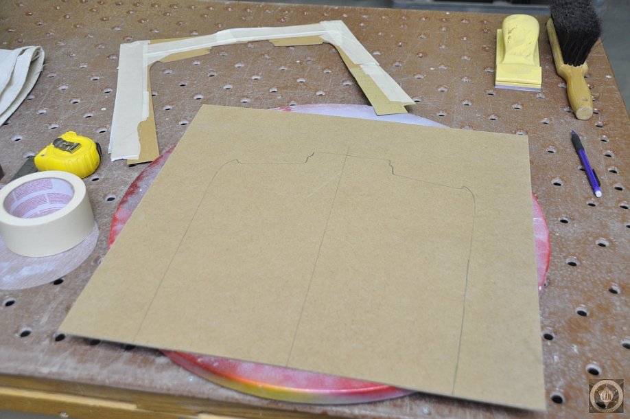

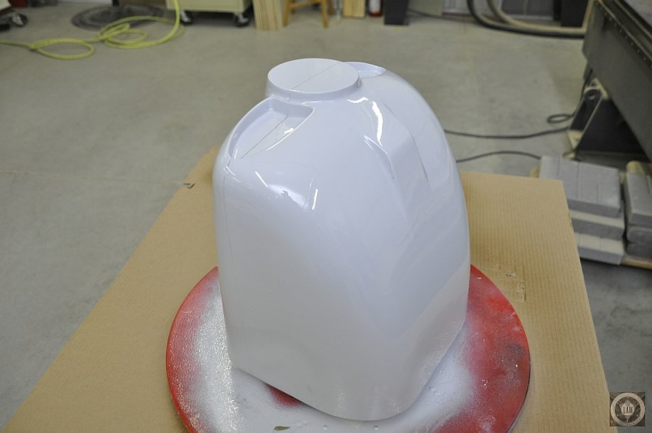

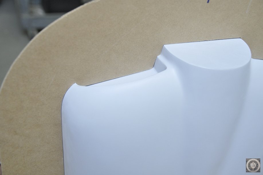

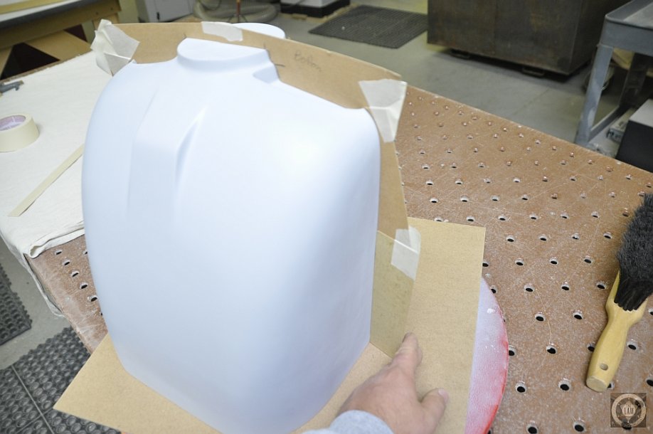

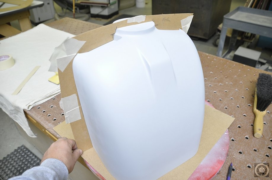

Cowl plug is getting super close. All materials to make the cowl mold should be here on Friday!! So, for those of you wanting a kit....keep your fingers crossed!! I made the parting board for the cowl split before I did my final sanding of the primered surface. This takes a bit of work but I used some 1/8" hard-board and it worked out very nicely. Most of the gaps I have to fill with clay are only a few thousandths wide!!!
I plan to make multiple molds for some designs this Winter so I glued up a hardboard "bed" that is weighted with bricks on the CNC bed to be perfectly flat. I can wax this entire board and use it multiple times through the season. With that and the parting board complete the only thing left was to final sand the cowl and hit it with a couple of coats of clear automotive clear.
Cowl looks very cool with clear shiny finish. Love the way the light accents the inlets and the deep cut "V" on the top, going to be killer looking. Let this dry for a couple days and start wax-on, wax-off, wax-on, wax-off, wax-on, wax-off, wax-on, wax-off, wax-on, wax-off.
