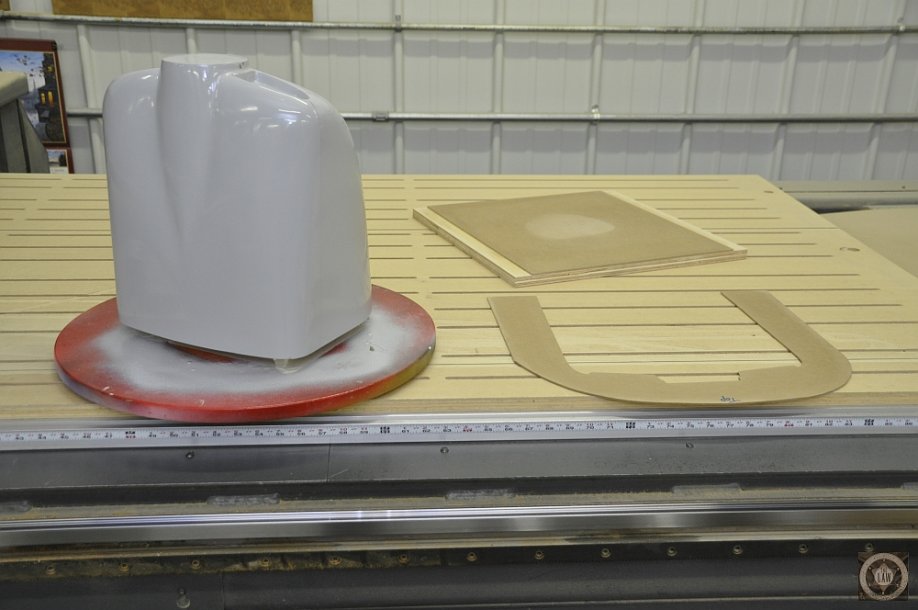

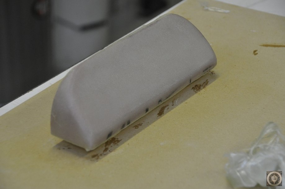

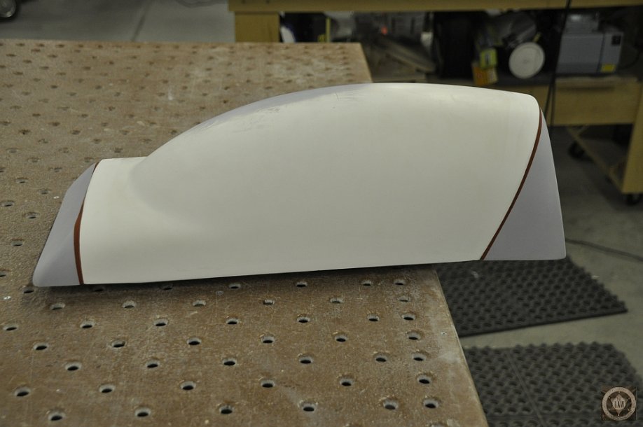

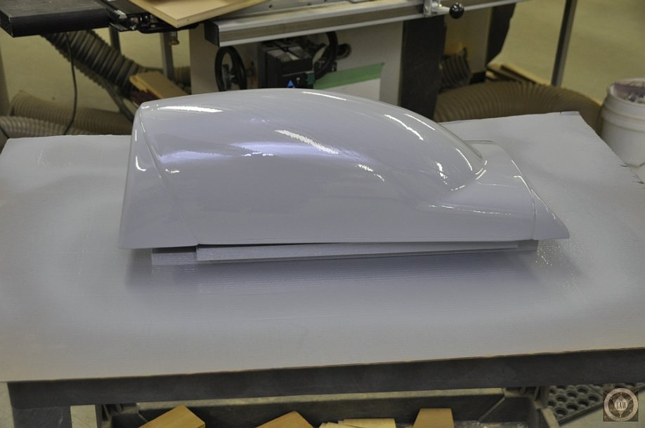

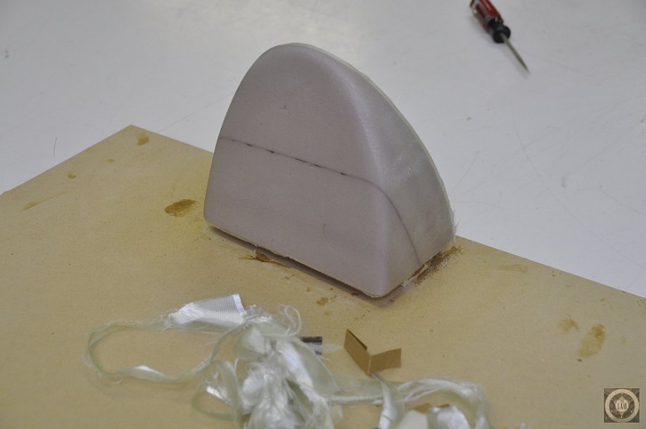

Well, little more time in again today. I knocked down the few dust particles and junk with 320 then buffed out those spots and the stuff that I could feel but could not see with 600. I got three coats of parting wax on the plug and a couple coats on the bed and parting board. One hour dry time between coats. 3-4 more coats and I should be good. I'll get all the waxing done on Thursday so I can assemble the parting board and be ready to roll with PVA on Friday when the UPS guy comes with my new PVA. My old PVA sprays like crap and the front of this cowl has a little too many angles to try to brush nicely.
Rest of the evening was spent waiting for paint to dry and doing research on the web. I cranked up the radiant heat to help flash off the epoxy primer and I got 5-6 nice coats on to help smooth out a couple of blemishes, plus I think the plaster of paris soaked up the first two coats like water. For how heavy it is, it's pretty thin so it does not build much. I know I'm in for some work (from what I've read) but I'll have to wet sand out a couple of funky spots and prep for vacuuming. From what I read this epoxy primer actually gets harder over the course of a few weeks, so I'll sand on Thursday AM.
Canopy plug looks dumb, but it should release well and the base plug is 1" longer than needed on each end so we should be good!!
