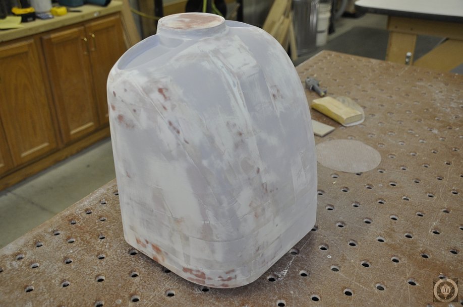

I'm going to experiment with that at a later time.     What we discussed would be the drawback of laying them up as part of the mold is they are fairly complex so they will be mainly filler material and resin (heavy).     We are going to try to do a few things like carve some up and vacuum form them to make a mold.    They they could be laid up thinner glass and less resin to be applied separately by just gluing them on and blending in with filler like I'm doing with the wood ones.
Jetpainter
Terry, if you ever do this again you should look at using Spies Hecker spray polyester filler for this filler step. If your last glass and resin step has sealed off your foam then spraying the Spies can really speed along the process. It fills really well and sands way easier than the glazes. Plus since your spraying it on, it's laying on flat and not leaving the inevitable ridges from smearing by hand. And those are what you spend most of the time sanding.
I've tried many different spray poly's and the Spies has them all beat in my book. It has a few drawbacks. First since it's a polyester product activated with MEK it stinks to high heaven and a good respirator and nitrile gloves are a must. It will eat foam if it can get to it. And, it takes a special gun with a huge tip to spray it. There are some cheap knockoffs out there that work great. But even after all that the benefits outway the drawbacks by far in my opinion. It's something to think about anyway.

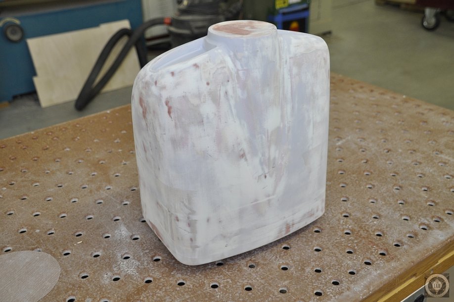

Looks much better today.      Had a couple of pinholes left when I left for the day today for a a couple of flights.     So, cowl plug will be done tomorrow and canopy plug just needs a little relief on the front and back and a coat of epoxy primer.....getting closer!!!     I can't wait to get started on another one (or two) of these!!
Sorry, forgot my disk at the shop but I'll post a pic tomorrow.

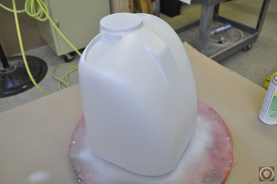

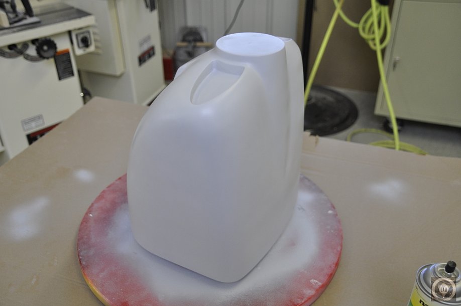

Feeling pretty good, after drying all night the primer looks good. I'll prime it again today after the last couple spots of red putty are sanded and probably shoot it with two coats of automotive clear for a nice hard glass smooth shell.
