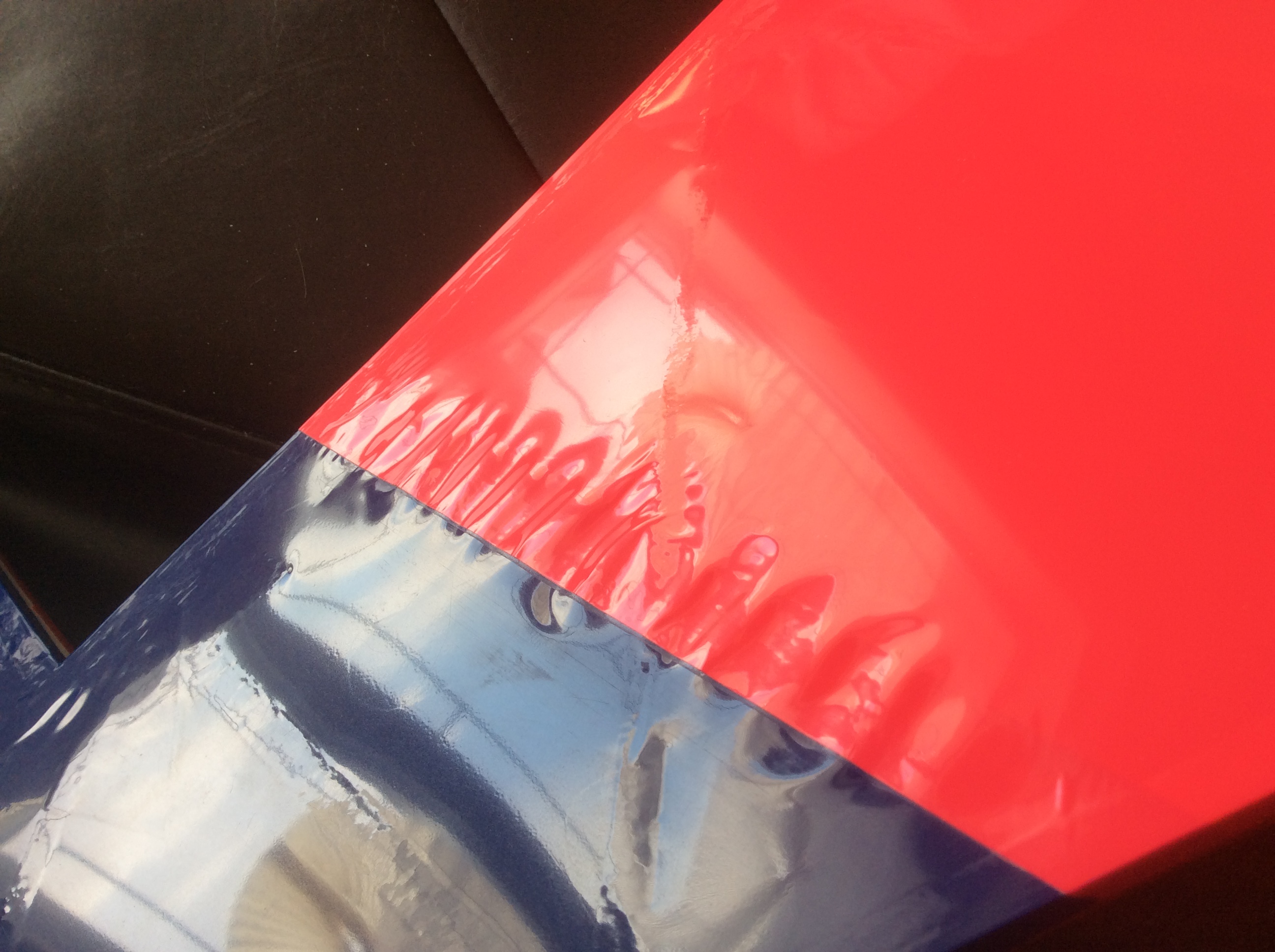

If somebody knows how to beat this your help will be appreciated thanks.

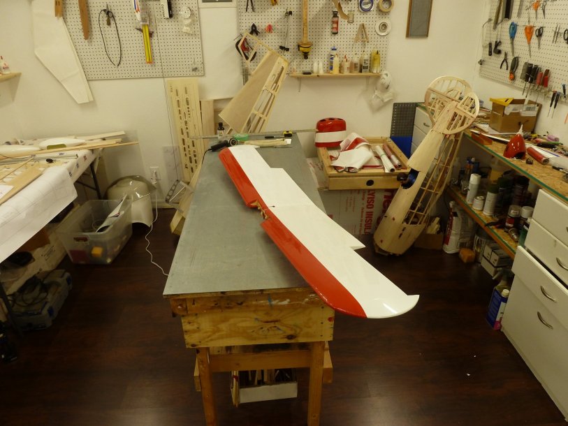

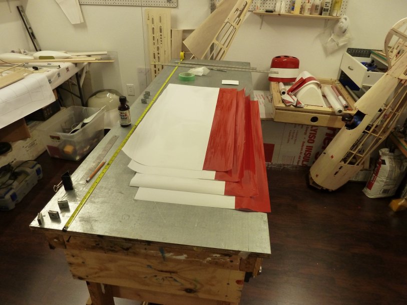

The coverings are shrinking at a different rate. If you have a trim iron you can use it to heat each color of covering and should be able to accommodate the different shrink rate. This method works for me. Below is some panels I made up and the wing they went on.
Looked at your pictures and my panels look just like yours that part went well and the joint was good I could not pull it apart. And it would lay flat on the work bench. It was dead flat on the stabilizer all the edges glued down and wrapped around the edges everything good. But when I went to pull it tight is when all went to hell. I been thinking about it none of you gentleman seem to have the problem but I do the only thing I can think of it is the fluorescent pink it is Ultracote but it is different. Next time I try will be with out a fluorescent colour. The covering on your wings the joint is it on an open structure. When I did it on a closed surface it worked perfectly no problems at all.

The red stops at the trailing edge of the spar, the white is open bay. It did the same thing as noted with your pic, the red shrunk up tighter than the white. I used the trim iron on the white until it shrunk and matched the red. I have had this happen before on both solid backing and open bay's, I think it all depends on the color of covering as to the rate it shrinks. I did a profile several years ago, see pic, and it was like an old prune but the trim iron worked it all out.
On yours it look's as thought the blue is shrinking faster than the red, continue shrinking the red until it get's close and then do both together in small increments. Just because one is tight does not mean it can not be heated slightly more for the other to catch up.
