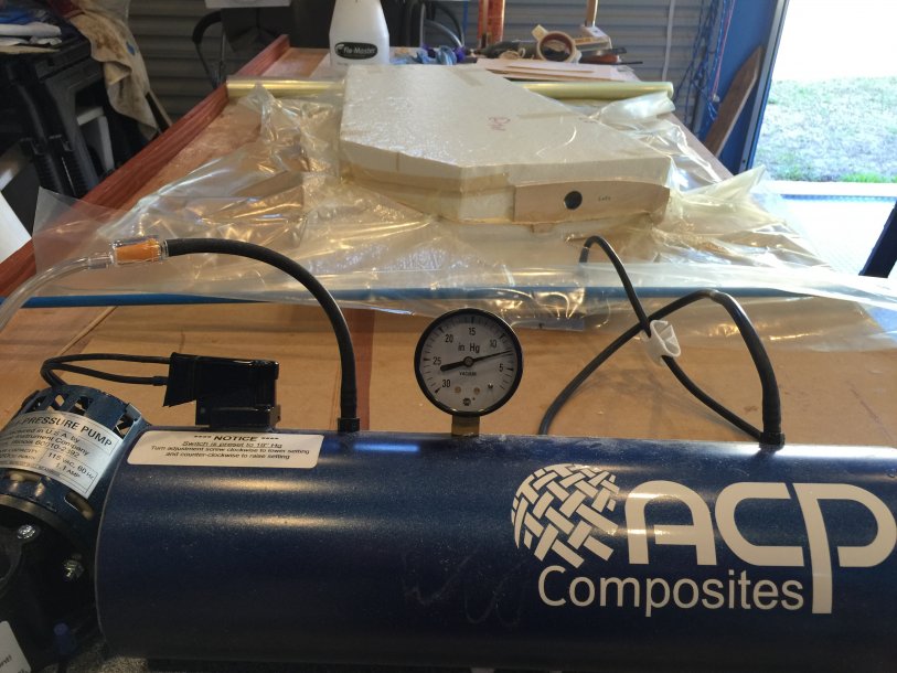

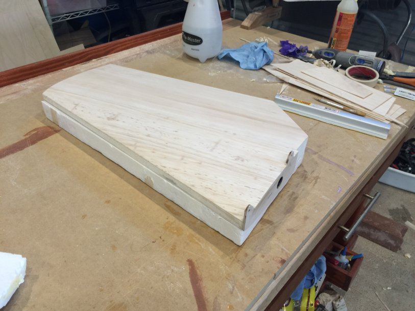

I have sheeted the bottom of the stab, and so far, so good.
Should be ready in one hour or so, and then I will sand smooth and show you all my final result.
The right stab, I will sheet both sides at the same time.

You seem to do quite a bit of building, if you plan to do quite a bit and particularly if you are going to leave the pump unattended I'd recommend adding the mechanical safety valve I showed in my thread from McMasters. Not saying it will happen to all of them but my ACP system blew a switch after about the 6th use and it pulled up to 24hg. Luckily I was only doing a sample layup so nothing lost. Since replacing it I've done 5 airplanes without issue.

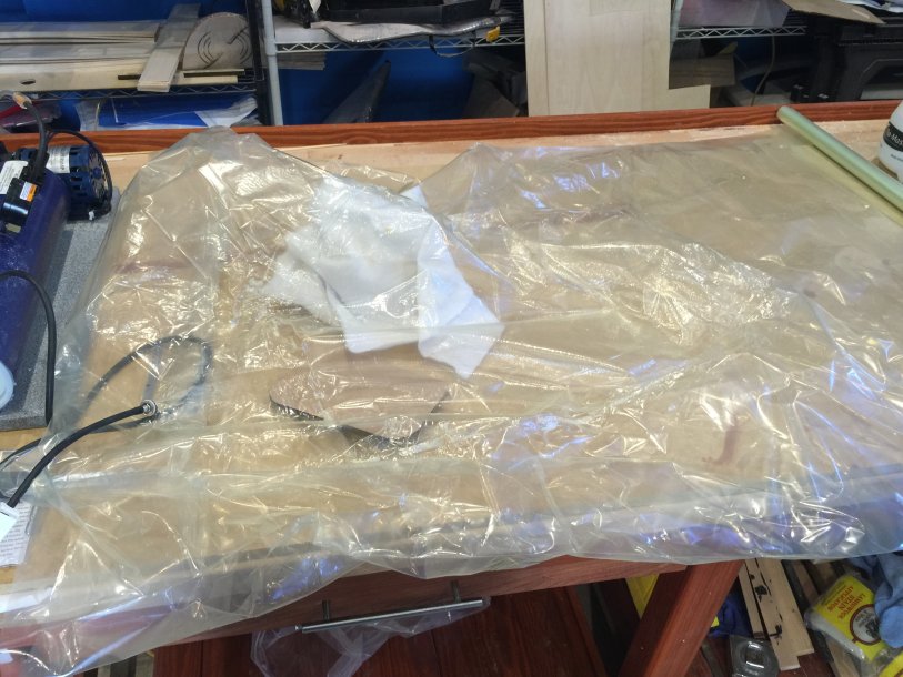

One more question, how many times do you use the bag?
SO far, this one has been used two times.
Do you use it once and then discard?

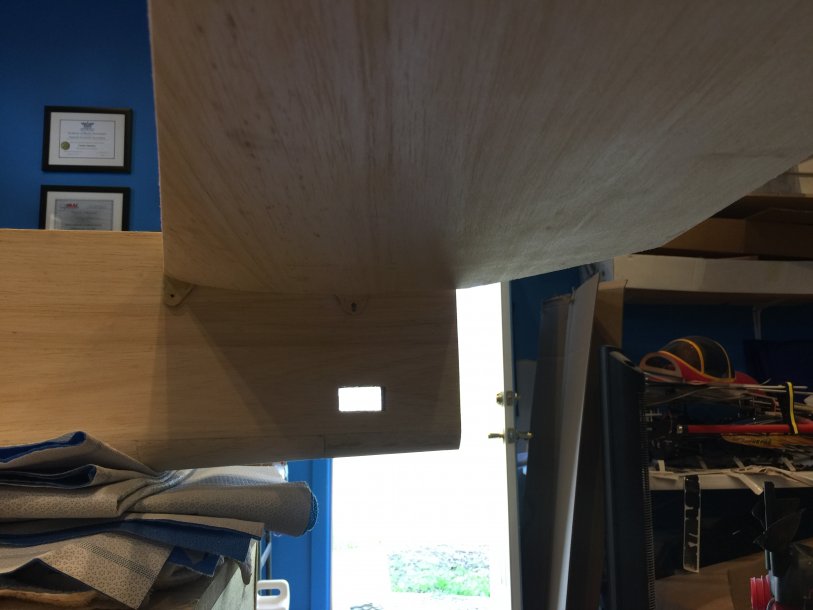

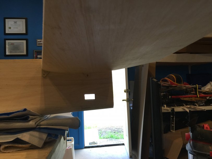

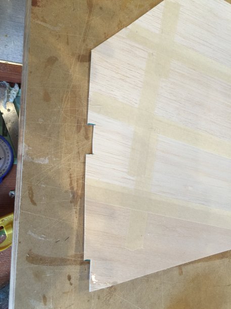

ok, I am just really amazed at this bagging technique. the left stab is awesome.
One thing I have noticed in past, once I have glued the sheeting to foam, when it comes to sand it smooth with the foam, if you sand perpendicular to the sheet, usually, it will debond and break the sheeting. But with this technique, the glue is strongly adhered to the edge. Awesome.
the bottom surface:
top surface:

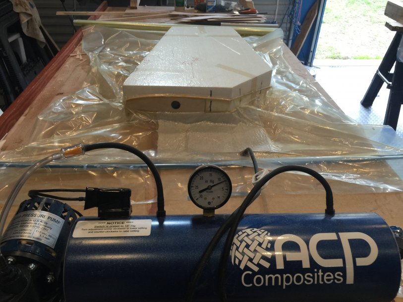

was able to get the second stab bagged as well.
This is fun!!
i did both sides at the same time.
(since i now know the novice level use of this system).
'This was also the 3rd time I used the bag, and so far, it is holding up. I do not know how many uses one can get out of it.

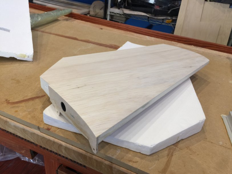

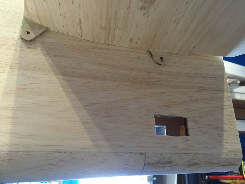

I wanted to demonstrate the cut out on the root side of the bottom sheeting, so you all can get an idea of what I did. This will be one solid stab. I like it....:dancing-chicken:
