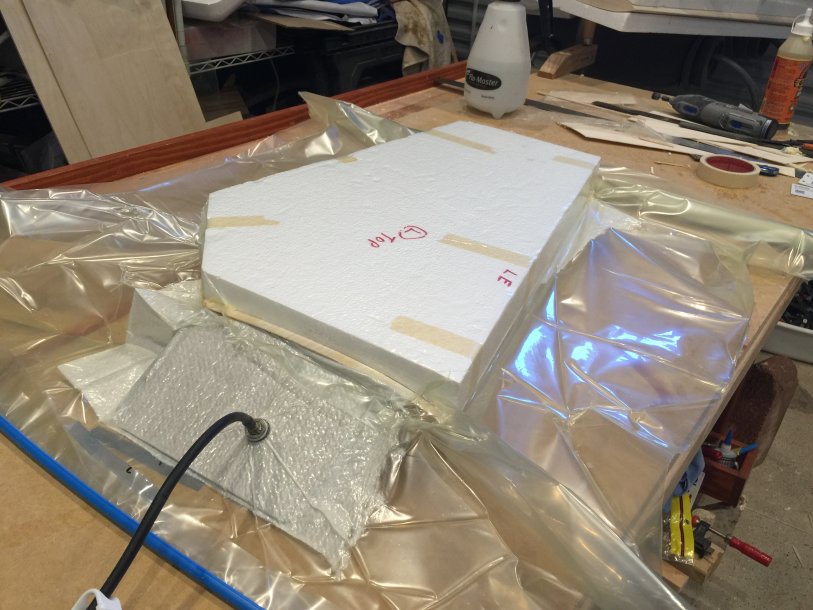

This bagging technique is the bomb!

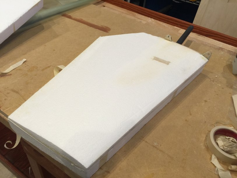

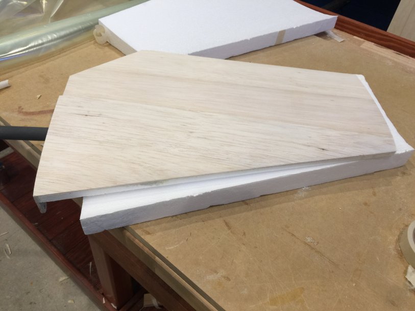

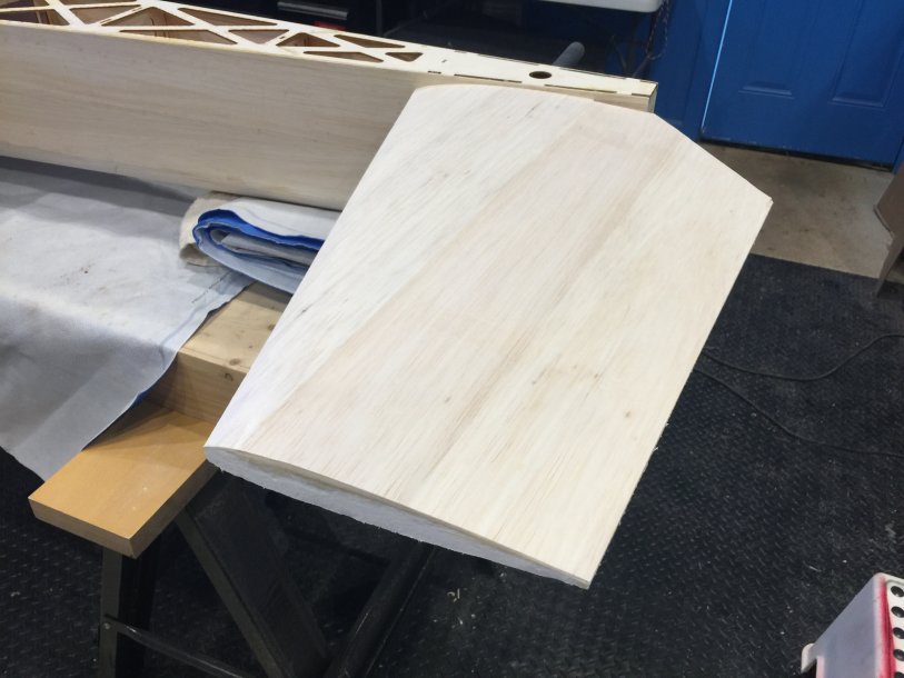

I was able to sheet the top surface of the left stab. and This is awesome!
I am stoked!

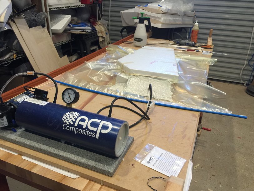

What a bond.  Wish i had done this in the past.  It is money well spent in the investment of this pump and bags and all.

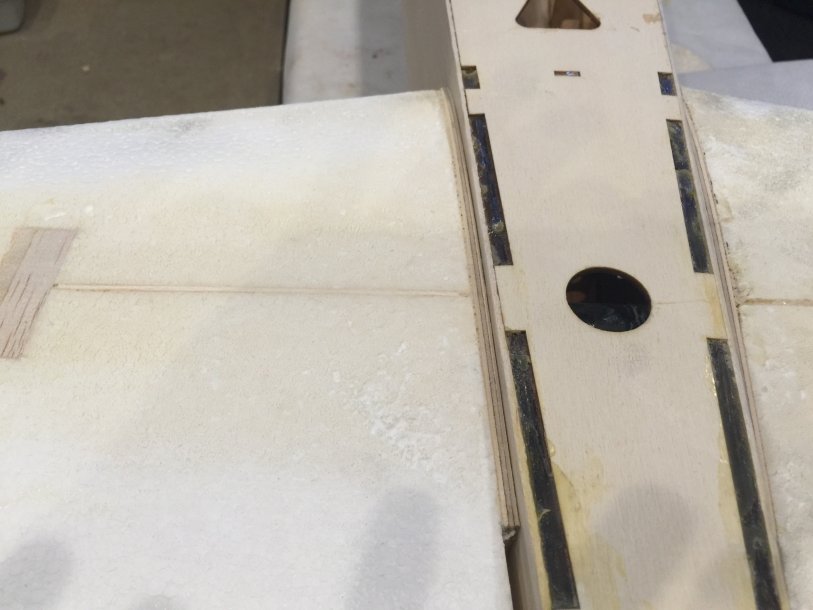

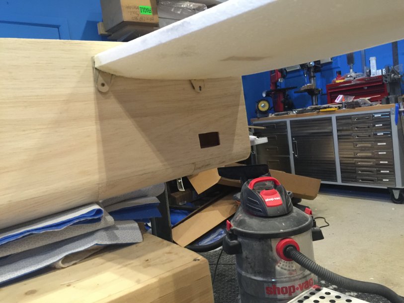

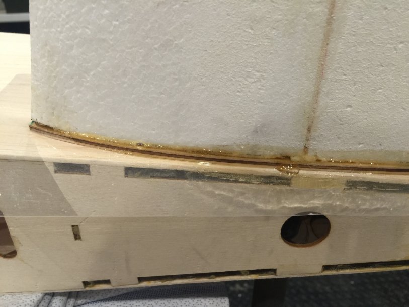

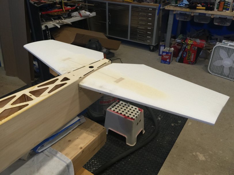

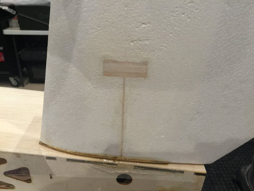

I sanded the edges flush with the foam, and then installed the left stab onto the fuselage, and it is noted there is no gap between the stab root and the fuselage.

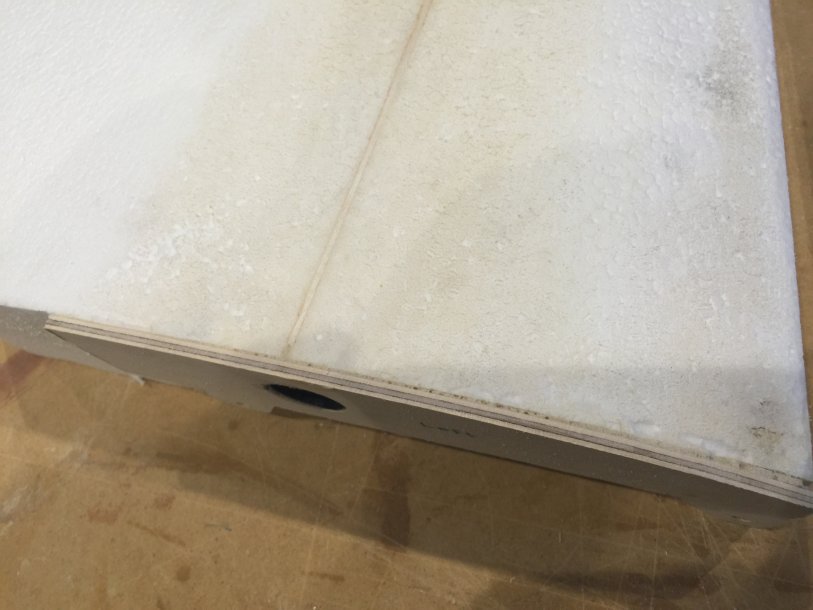

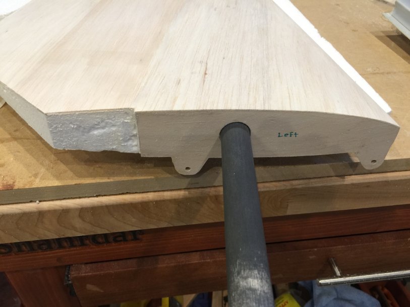

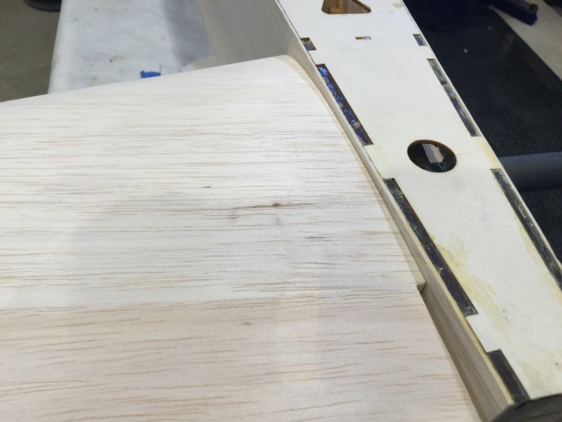

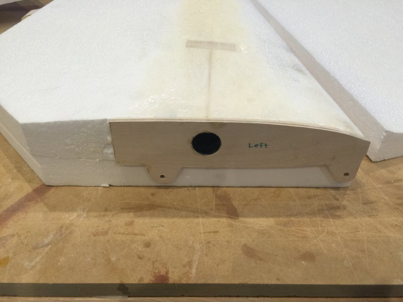

Wanted to demonstrate the bond between the balsa sheeting and the plywood cap.  It is fantastic.  no gaps at all.  I also did not experience the depression of the wood or the sheeting at the interface between the foam and the cap, as mentioned by Snoopy. I am thinking, maybe, he did it with too much vacuum pressure.
