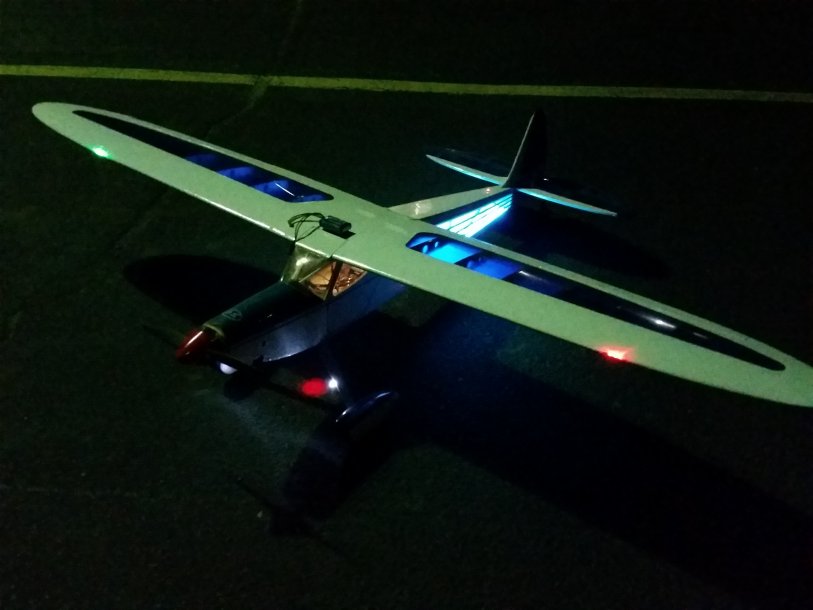

Work and weather didn't cooperate today but I got a couple of night parking lot flights on the Rascal
