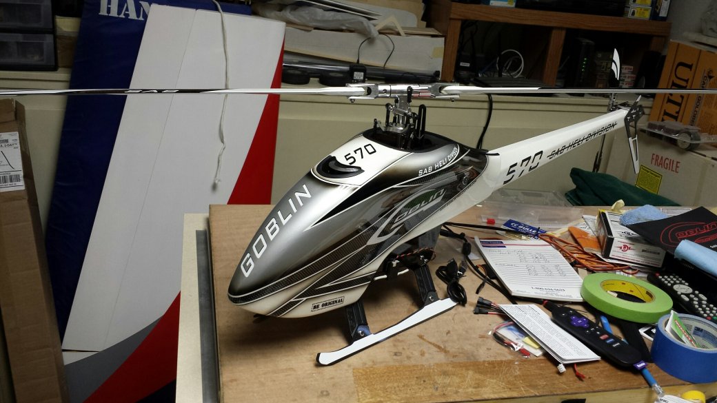

Just got back from a day at the field. I flew my Goblin 570 for the first time. Man that's a nice machine! I chickened out at the last minute and had my buddy Mike that's been flying heli's since before I met him in 85 do the maiden. I'm kind of glad I did because I had the tail gain was set too high and in a high speed pass the tail started to oscillate pretty bad. It would have been scary for a new guy like me, but to an old hat like Mike it wasn't an issue. His 35 + years flying heli's sure beats my 35 flights I had before today. I can loop, roll, hover nose in, and even hover and fly inverted a little, but a guy needs to know his limitations. ;)
After a little tweaking and another short test flight I got my turn. This thing is smoother, more maneuverable and more powerful than my T-Rex 550. I really like it!
One thing I know for sure is that while the white gray and black scheme looks great, it sucks to see on a cloudy day. The canopy I have was damaged in shipping and has some cracks. USPS made good, and a new one is on the way. I'm going to take this one to work this week and repaint it in some brighter colors.
