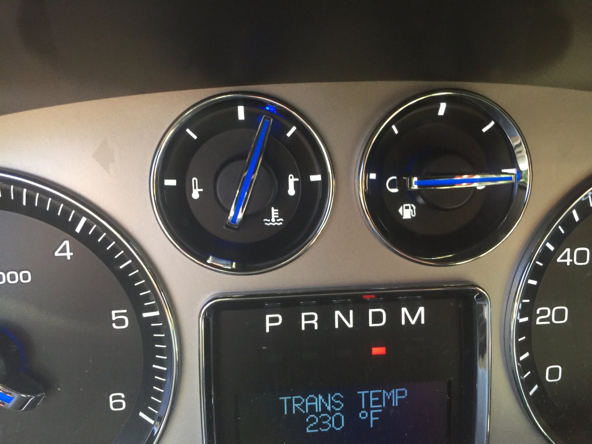

    does it have tow mode?
    Sent from my SM-G930P using Tapatalk

    also with that many miles make sure your radiator isnt stopped up with bugs and dirt. check to make sure your engine fan is working correctly.

  5. Try a cooler thermostat. They typically come with 185 or 195F temp thermostats.
    It is very possible that your radiator is plugged up, from the outside, thru the fins. Could also need a flush and fill. Wouldn't hurt to have the transmission serviced as well.
    My '14 F-150 with the 3.7L V6Pulls my 6x14 V Nose well. I just don't get in any hurry when going places with my trailer. Temps never exceed normal operating, even climbing steep grades.

    Sounds like the transmission isn't locking out the torque converter. I would agree with others here, if you are going to do a lot of traveling to contest, a diesel is right up that alley. I love my chevy duramax. 196,000 miles on it still pulls strong, it is 15 years old started looking but will probably try to hold on to it a bit longer. I don't think you can really go wrong with any of the three (GM, ford, dodge). If you are really wed to a half ton, you might consider dodge's eco diesel 1/2 ton. Plenty to pull your small trailer with some really really impressive fuel mileage.

    yes, but when I put it on, it runs at higher RPM and heats up more.

    definitely sounds like it is not locking out the torque converter.

    Yeah something is not right. Running a higher RPM should take some load off the engine and cool it down. I would get it checked out.
