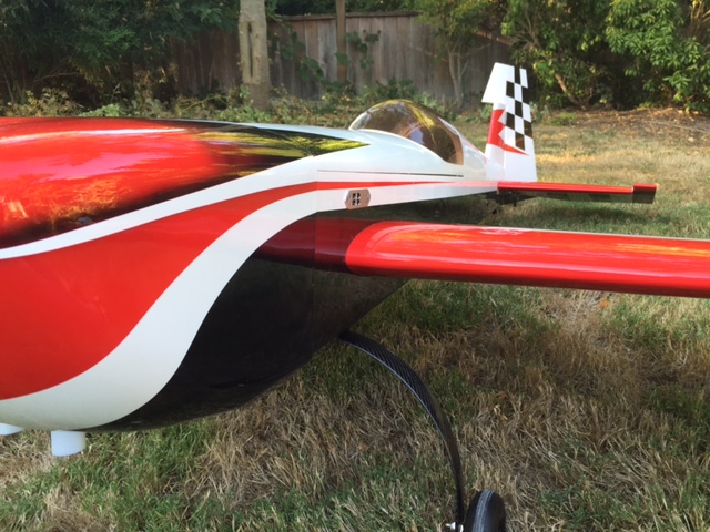

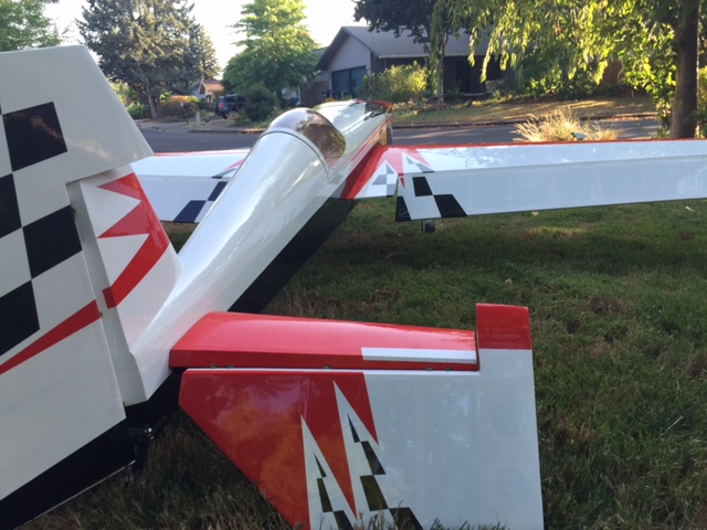

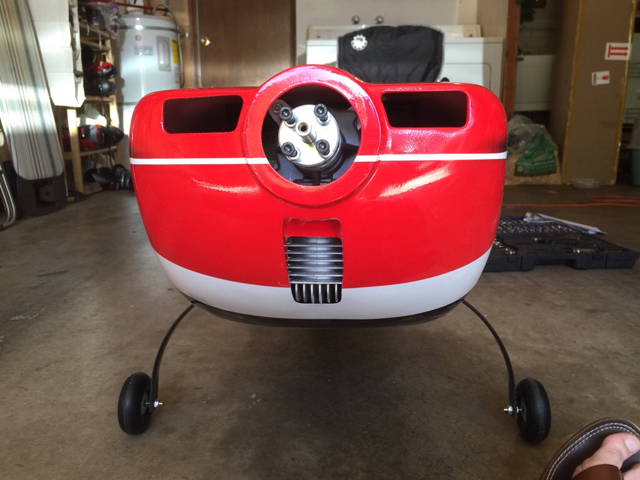

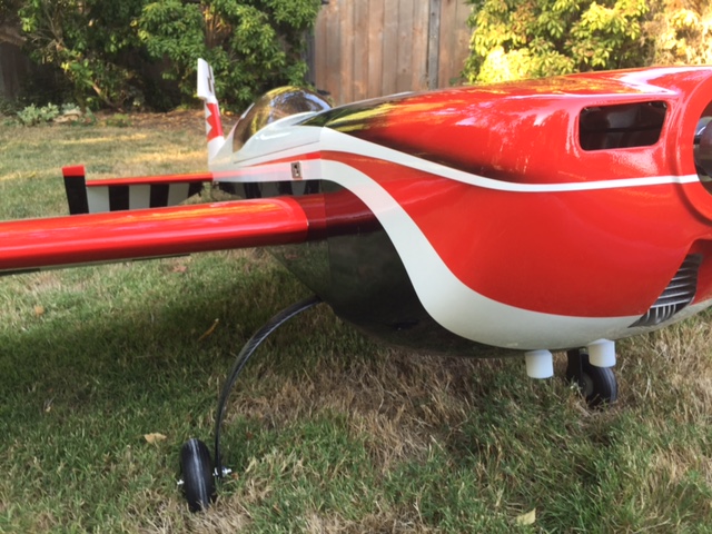

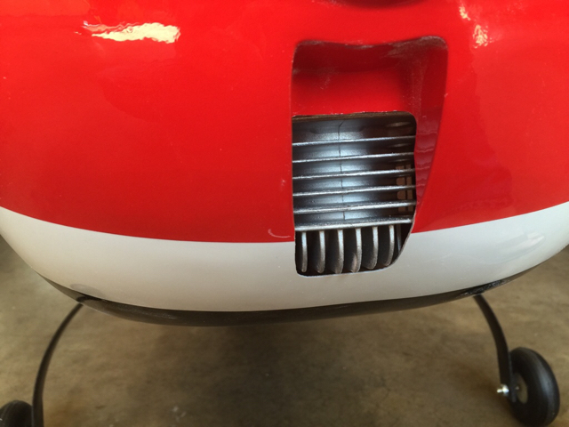

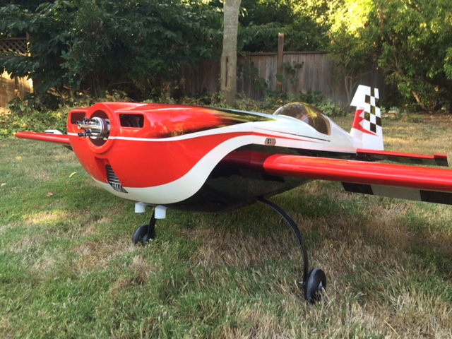

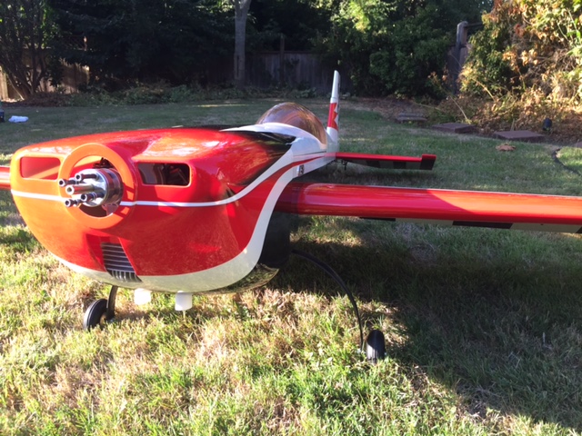

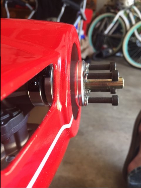

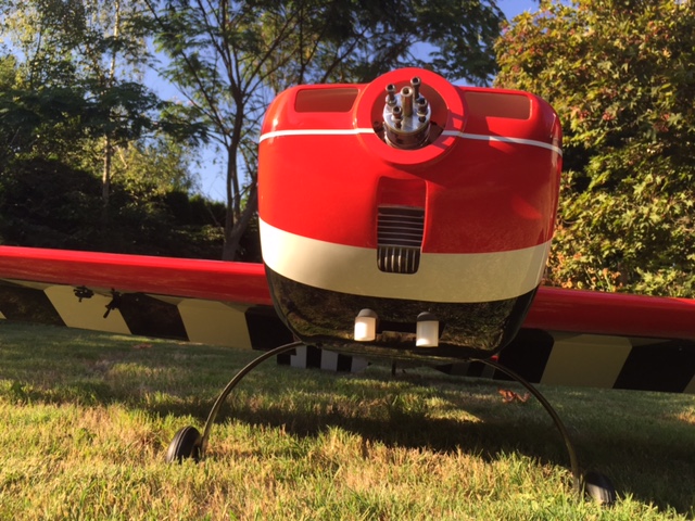

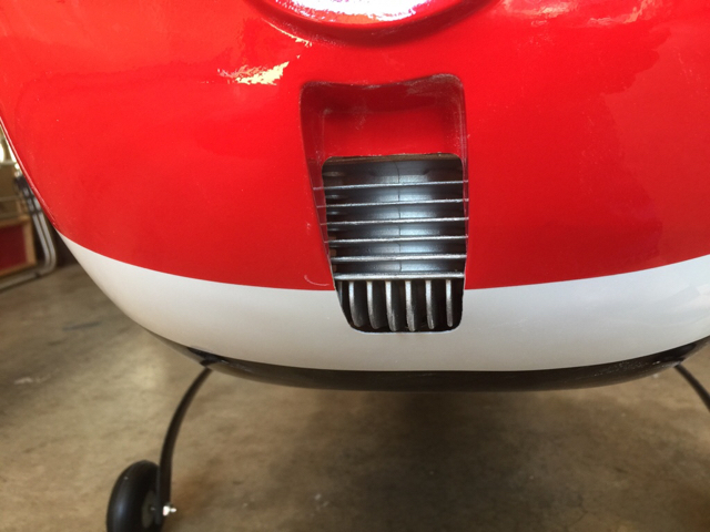

Did some cowl work! I think it looks bitchin! If the pics don't show I'll fix shortly.
3dmike
Cut the exhaust as well and setup the choke. This is such a beautiful cowl that I took my sweet time and I think it turned out good.
