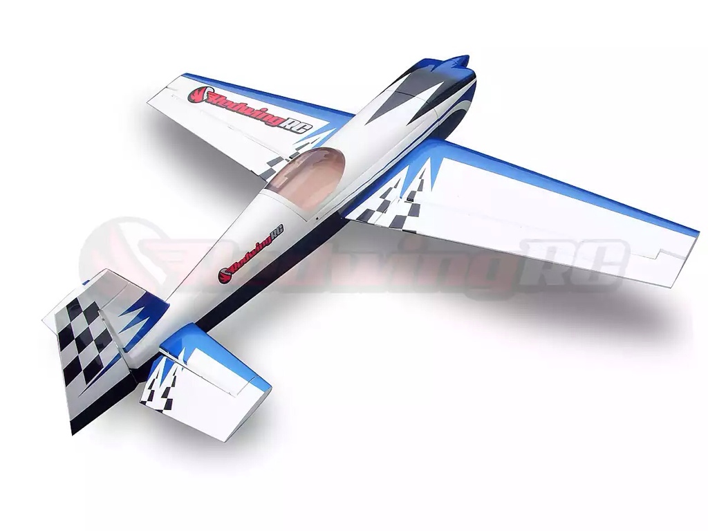

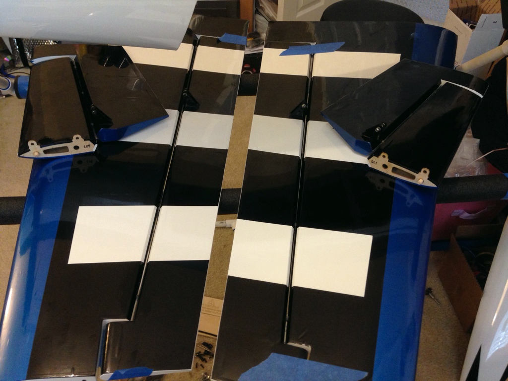

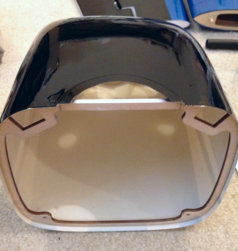

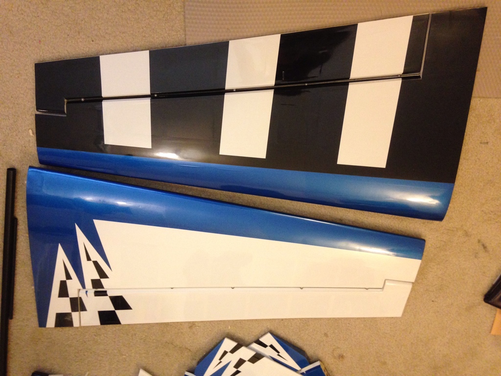

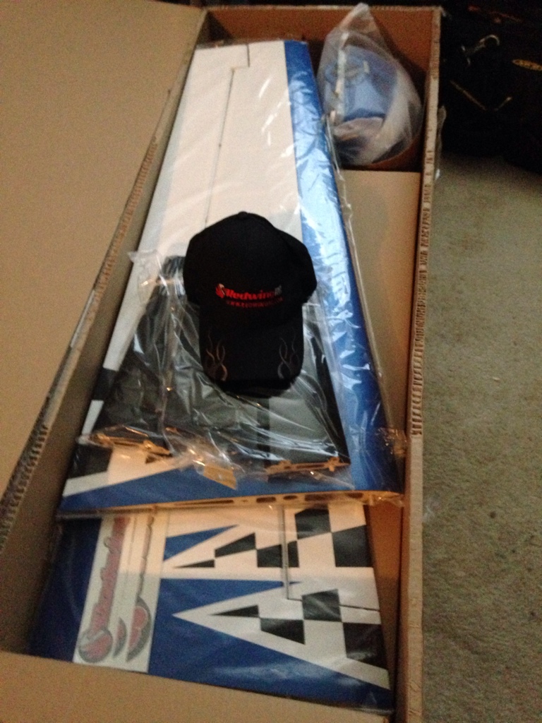

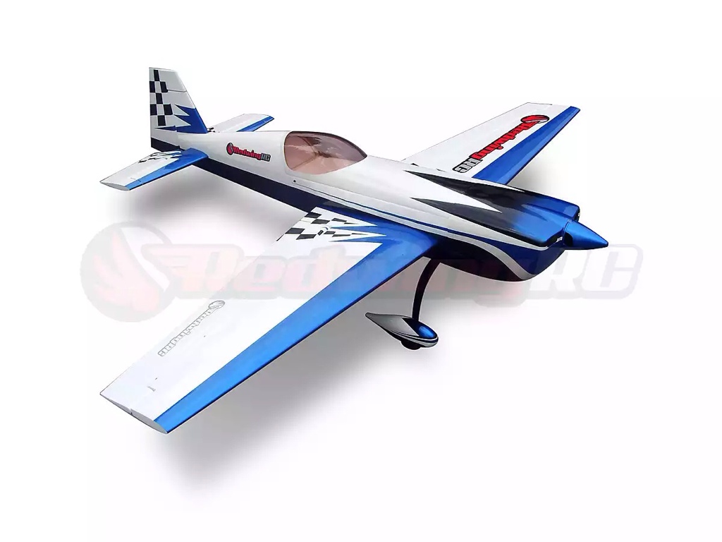

This will be my build log of my new Redwing Extra 330sc!
Manufacturer specs and features:
Wing span: 1930mm/ 76"
Wing area: 1145 sq inches (wings and stabs measured ONLY) More surface area when considering fuselage
All up flying weight: 11 - 12 lbs
Length: 1663mm / 65.5" without Spinner
Engine: DLE 30, DLE 35RA or similar, or Equivalent Electric System
Recommended Spinner Size: 3"
Recommended CG: 5" to 5.25" from the LE at the root of the wing
Recommended Prop Size: 18x8 to 20x8
Recommended Throws: adjust to liking as you fly
Low Rates Settings | High Rate Settings
Rudder: 30 degrees, 20% expo | 50 degrees, 35% expo
Ailerons: 25 degrees, 25% expo | 40 degrees, 40% expo
Elevator: 20 degrees, 20% expo | 45 degrees, 40% expo
Removable stab
Ringed cowl
Adjustable push rods
Canister ready
Carbon fiber landing gear and accessories
Painted matching spinner (optional)
Fast fly and easy build features, such as : Pre drilled hinges, pre plumbed fuel tank, pre installed rudder cable,
NOW COME WITH SIDE FORCE GENERATORS!

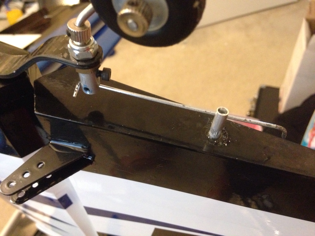

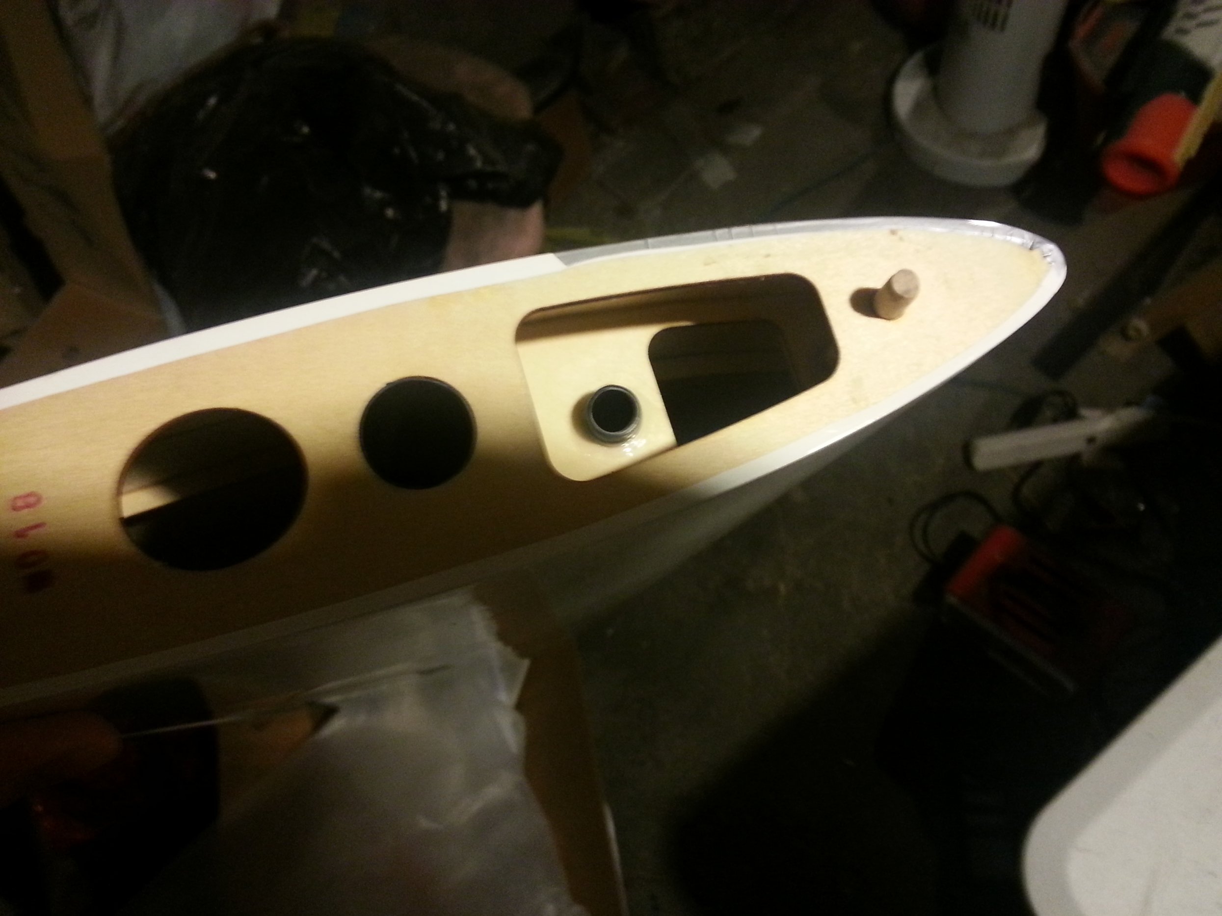

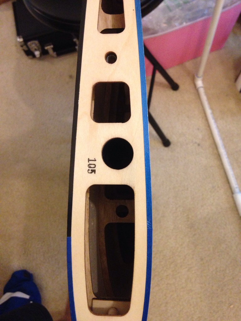

Removable stab
Ringed cowl
Canister ready
