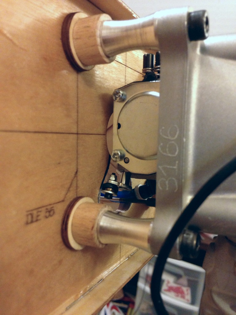

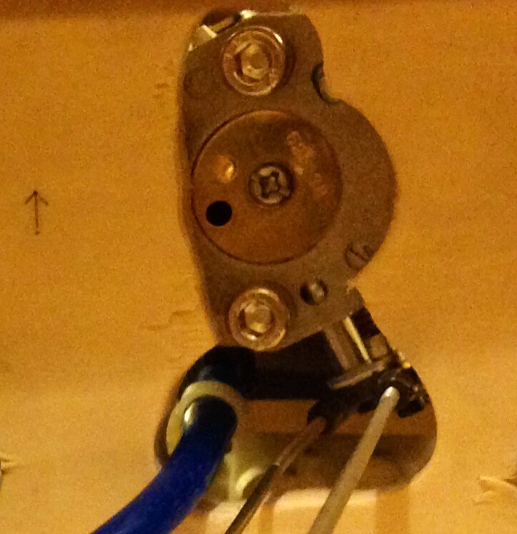

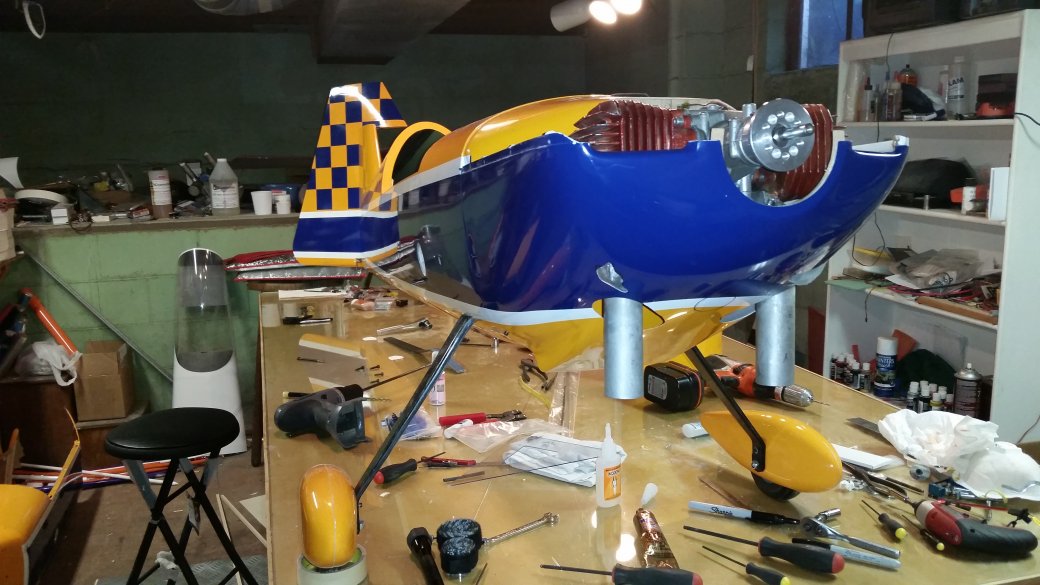

Gary will that carb have enough room? You may want to enlarge that hole to avoid weird turbulence issues there as it pulls in air.
gyro
GSN Contributor
You don't think this will be enough? My thought was that it'd be pulling air from inside the fuse...

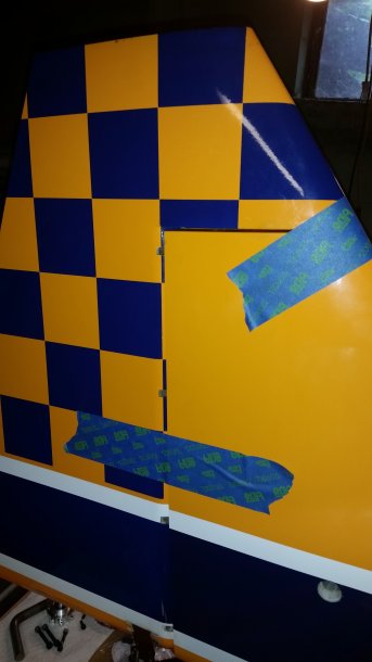

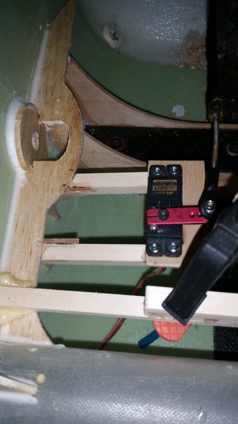

A little more work done... Both elevators are hinged up. No issues, took about a 2mm gap to get full throw, so I'll put some clear ultracote in the gap later to seal it up.
I really, REALLY love the oversize elevators. Also, the metallic blue covering contrasts so nicely with the white, this scheme is amazing.
It looks like you can move the linkage in on the servo arm and still get full throw. If you can do that, you will get more torque and your gears will last longer.
