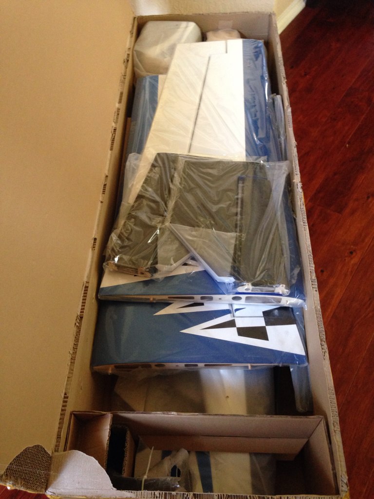

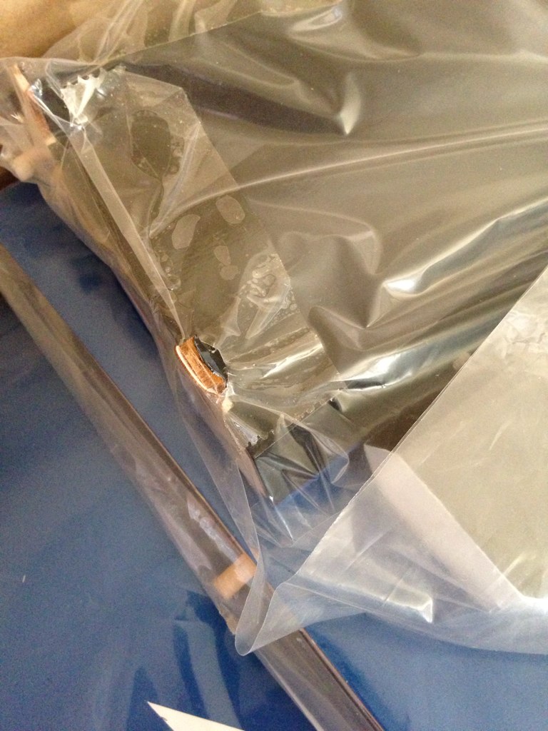

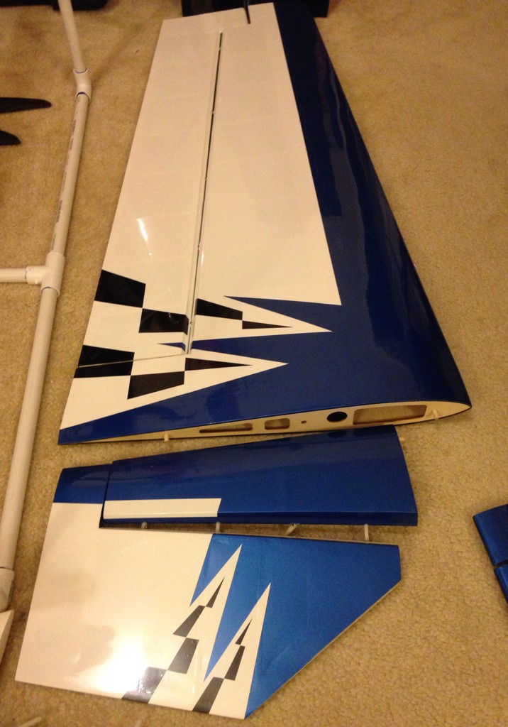

My plane shipped direct from China... And it showed on the box. All the corners were rounded, and there were a few tears and punctures in the outer layer of the cardboard.
Inside, this is how the plane arrived:

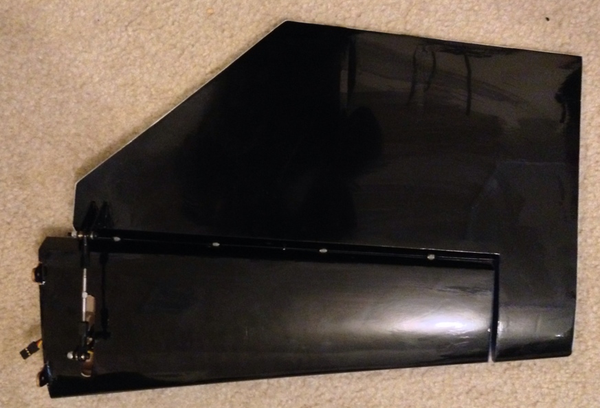

The small attachment tab for one elevator was broken, and I was surprised that the wings and stabs were not taped in place, but moved freely inside the box.

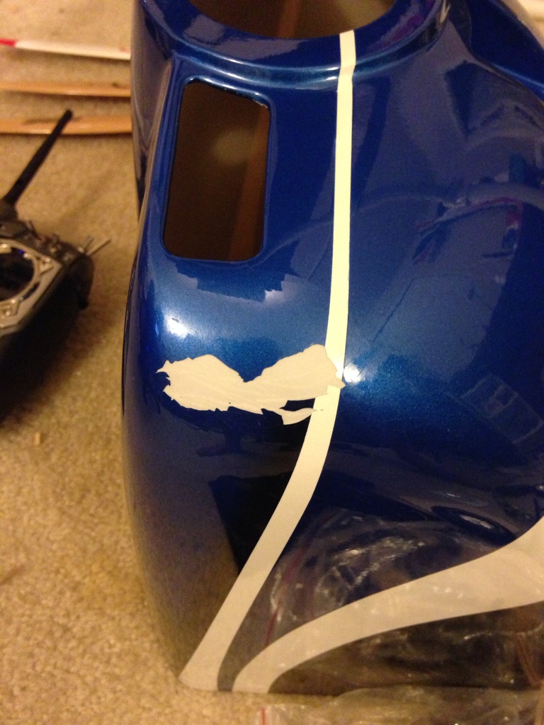

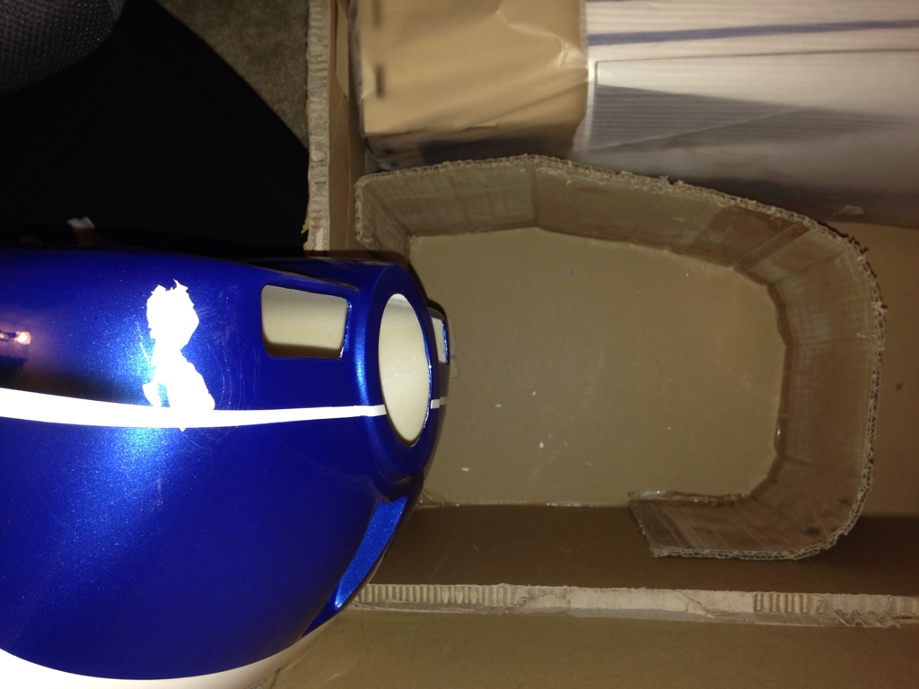

Once I started unpacking, my heart sunk a little... When I picked up the cowl, some paint chips fell the the floor. This is what happened during transit:
I know this cowl reflects a ton of Tim's heart, soul, and effort to bring us a cool and unique airplane, so I truly wish the factory would have better protected it.
I've already heard back from Tim that a replacement will be on its way shortly.
The rest of the plane arrived ok, and here is what I can say from my initial observations.
It's going to be a 3D monster, the control surfaces are huge!
The airfoil is also thin, so I suspect it's going to be a slippery plane too... Which means plenty of speed for spins and tumbles!
The bottom is nice and flat, should help it stay stable in upright harrier.

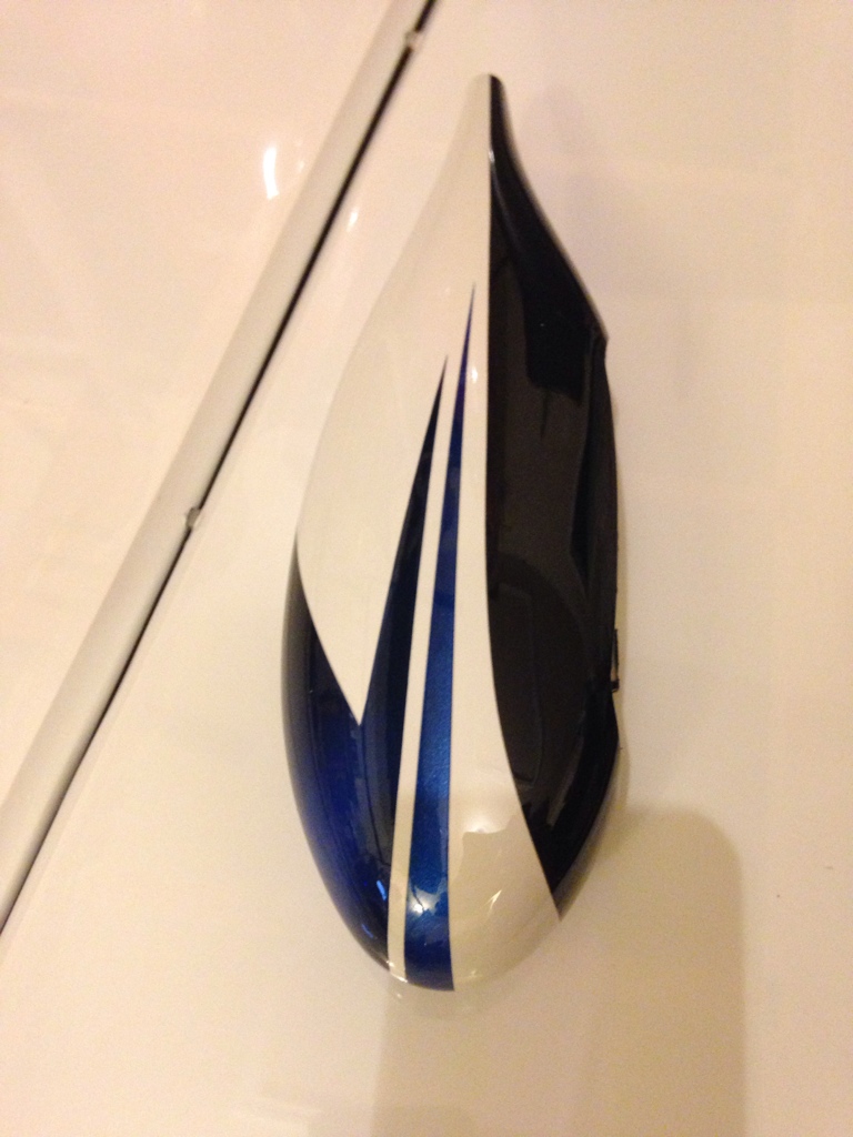

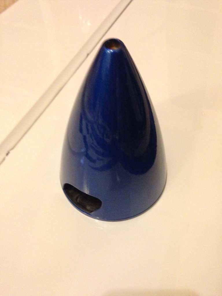

Beautiful painted matching spinner, and side force generators not pictured on RedwingRC's site were a nice surprise!
Also, amazingly beautiful wheel pants! One of a kind for sure!

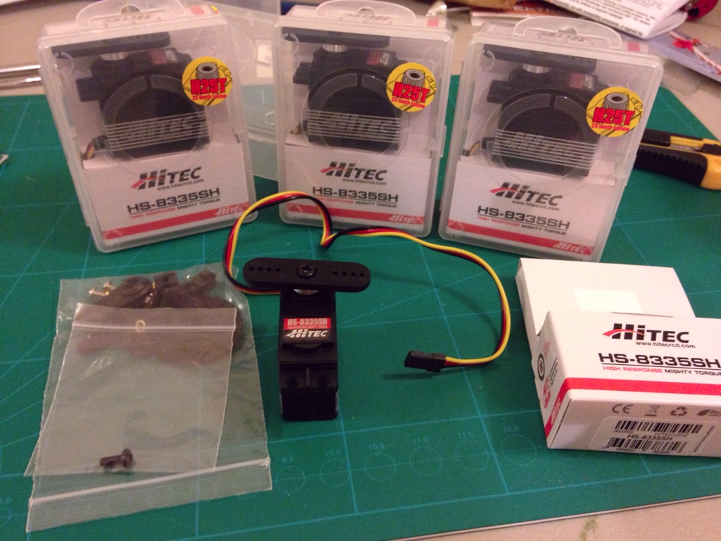

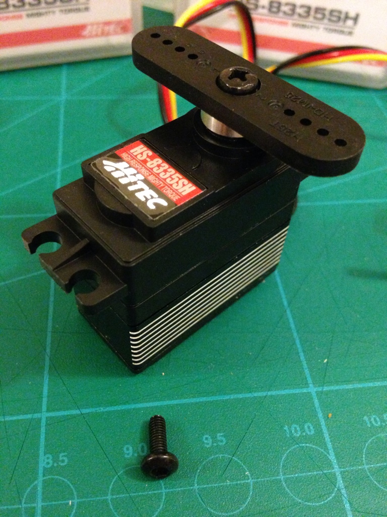

Yeah, that's an easy choice for me now... Plenty of other quality servos out there to pick from, but I'm going with what I know and love.
Speaking of... Check these guys out!
ImageUploadedByTapatalk1403790844.312051.jpgImageUploadedByTapatalk1403790877.638180.jpg
Tons of torque and speed:
Speed @ 6.0V: 0.16 sec/60° at no load
Speed @ 7.4V: 0.13 sec/60° at no load
Stall Torque @ 6.0V: 256.90 oz/in. (18.5 kg.cm)
Stall Torque @7.4V: 333.28 oz/in. (24 kg.cm)
Dead Band Width: 2usec
Motor Type: Coreless
Bearing Type: Dual Ball Bearings
Gear Type: Metal Gears
Connector Wire Length: 11.8†(30mm)
Dimensions: 1.57†x 0.79†x 1.45†(40 x 20 x 37mm)
Weight: 2.25oz (64g)
Drop in a go fly! Simple easy to use with no programming required and ultra low deadband at 2usec.

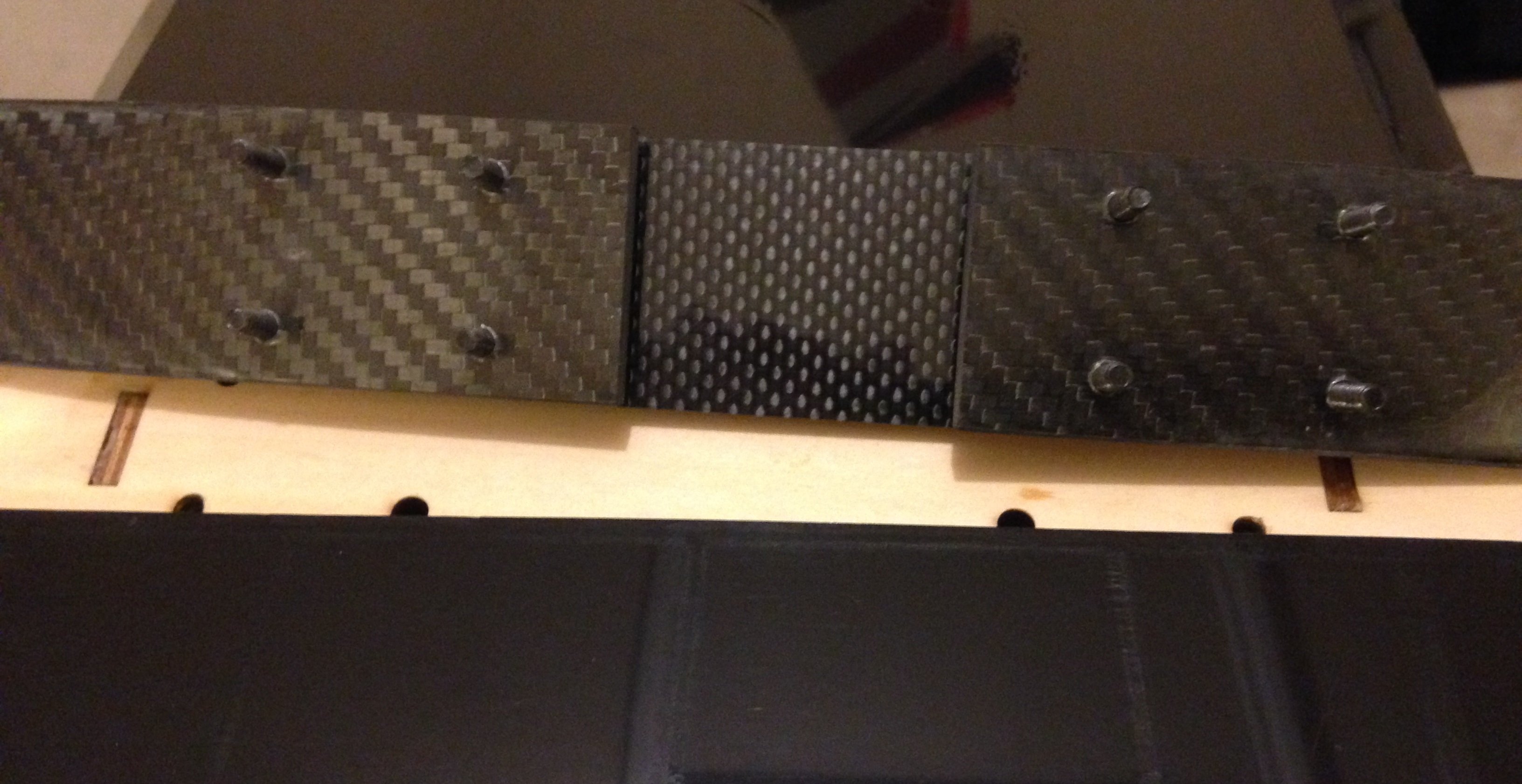

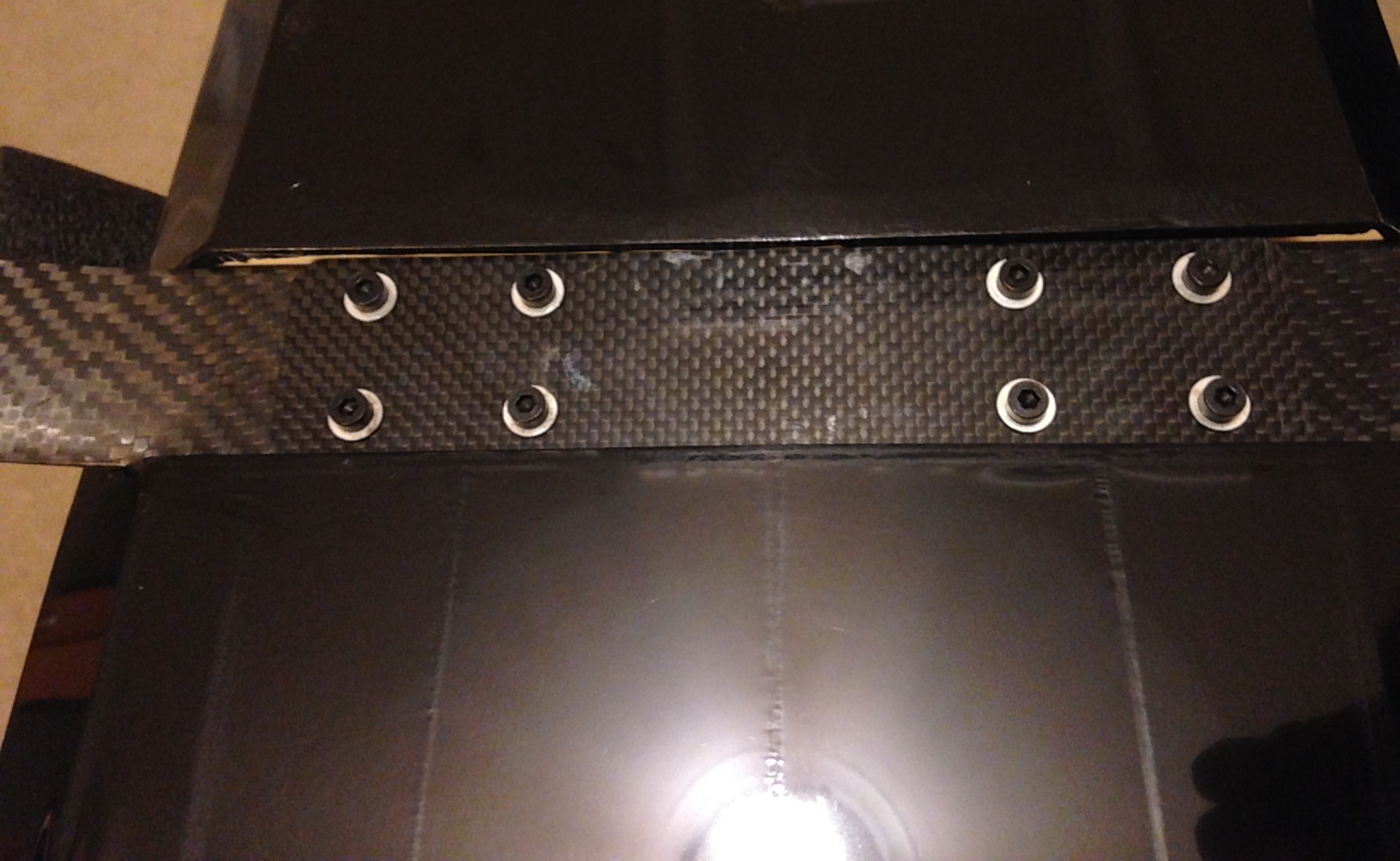

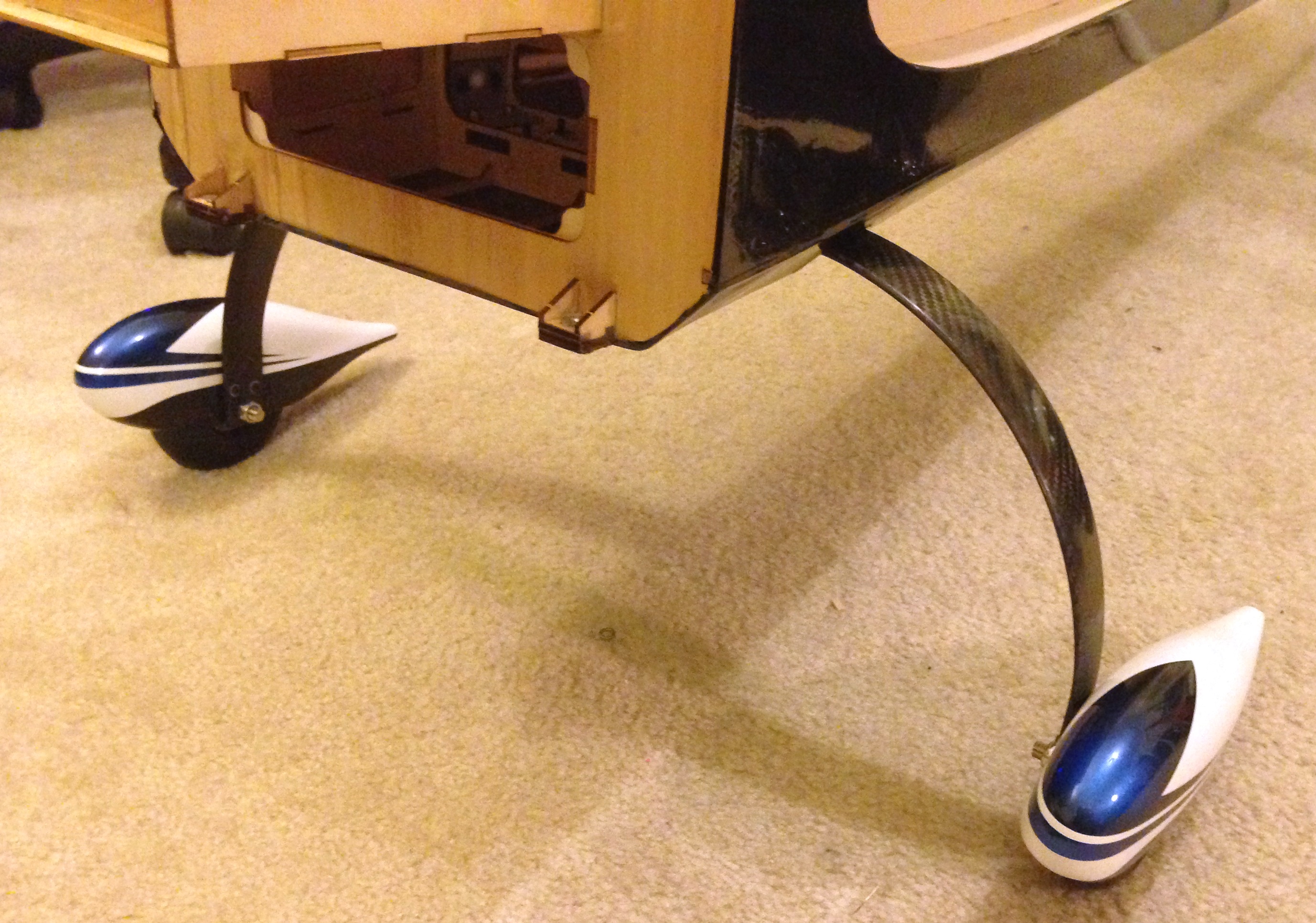

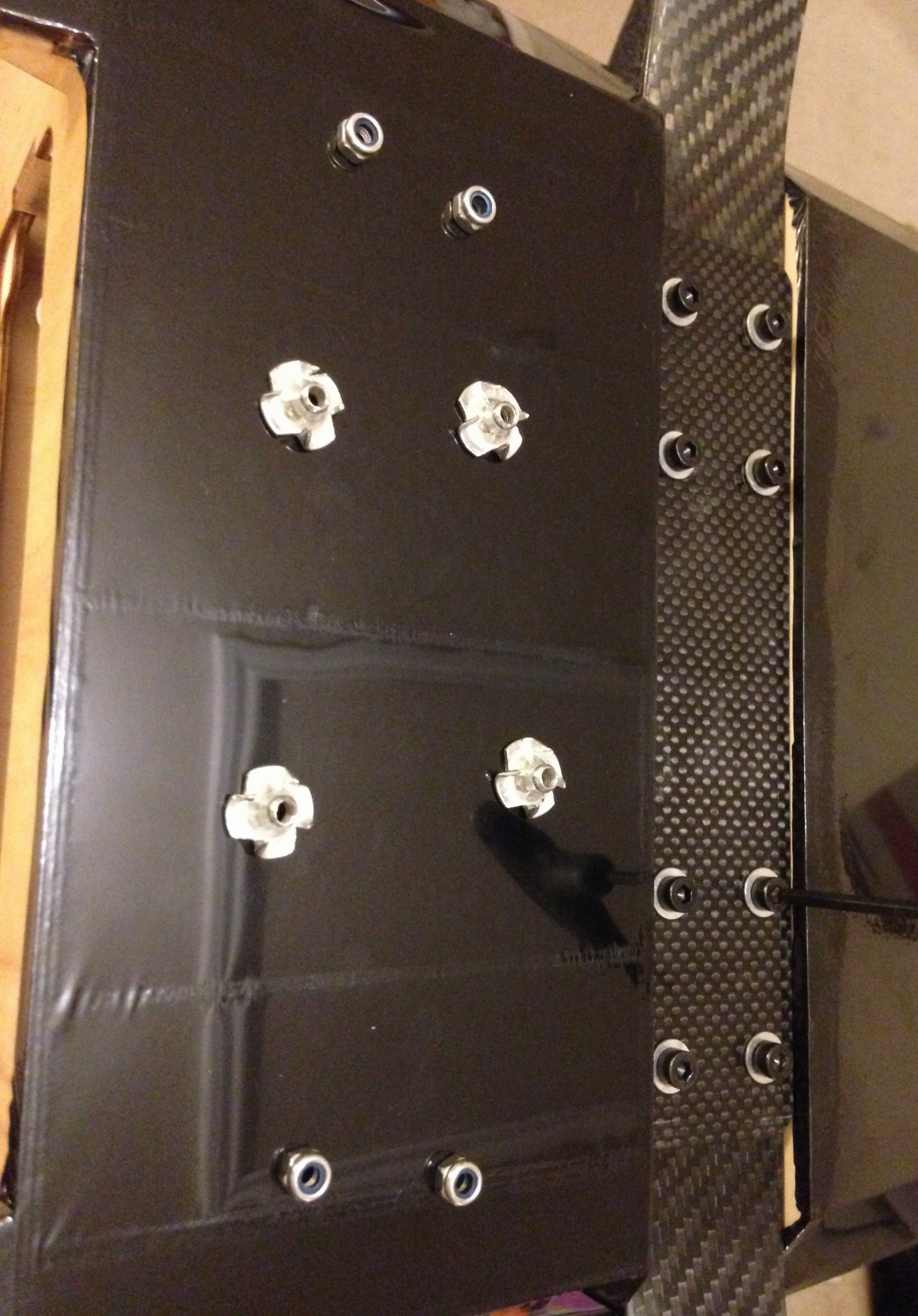

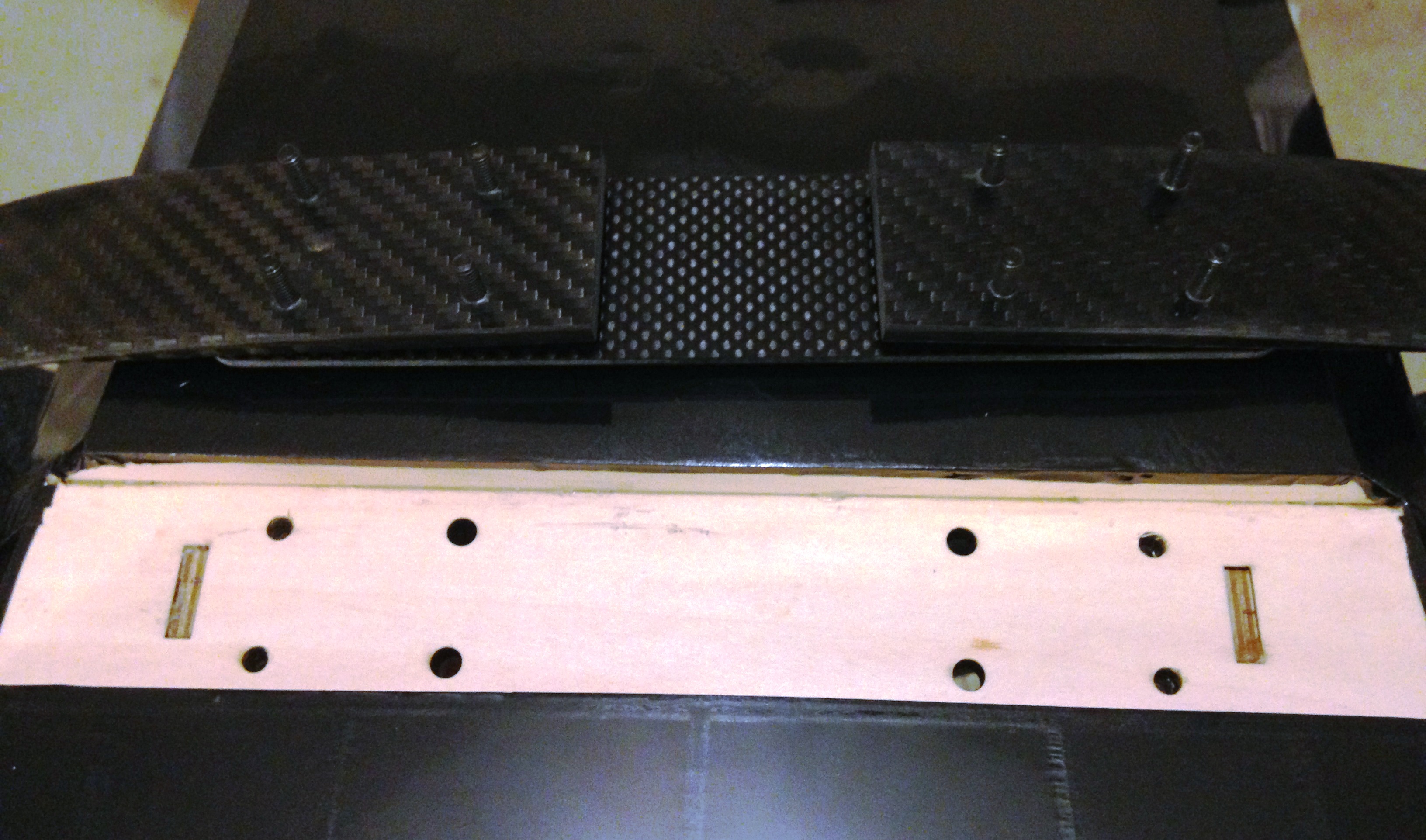

First, lets talk about the landing gear. It's two piece, and has 4 bolts per side, with a connecting plate for support...
it's kinda weird... and to me doesn't make a bunch of sense. would rather see one piece with a robust build and tons of strength.
first, the stuff:

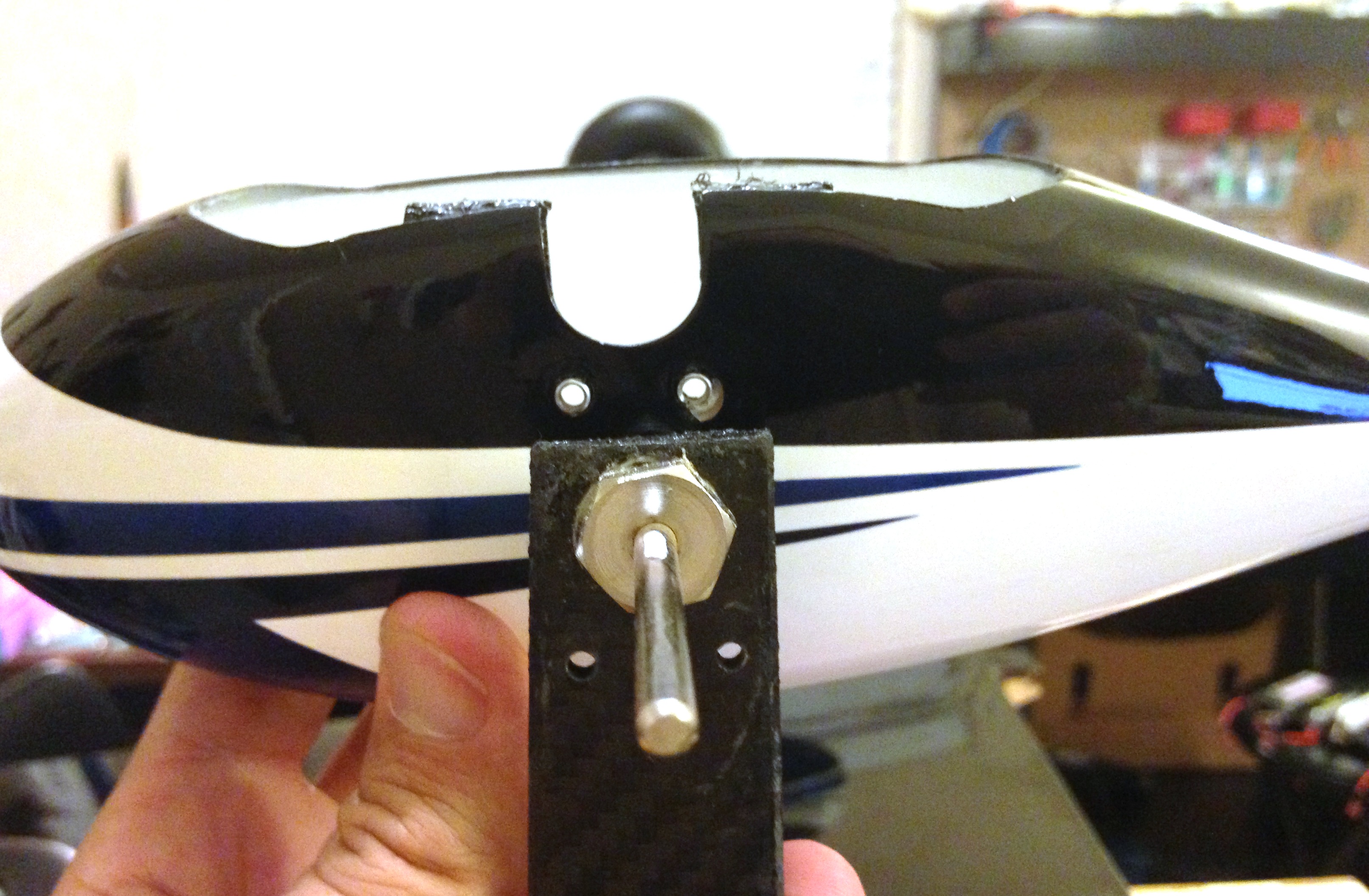

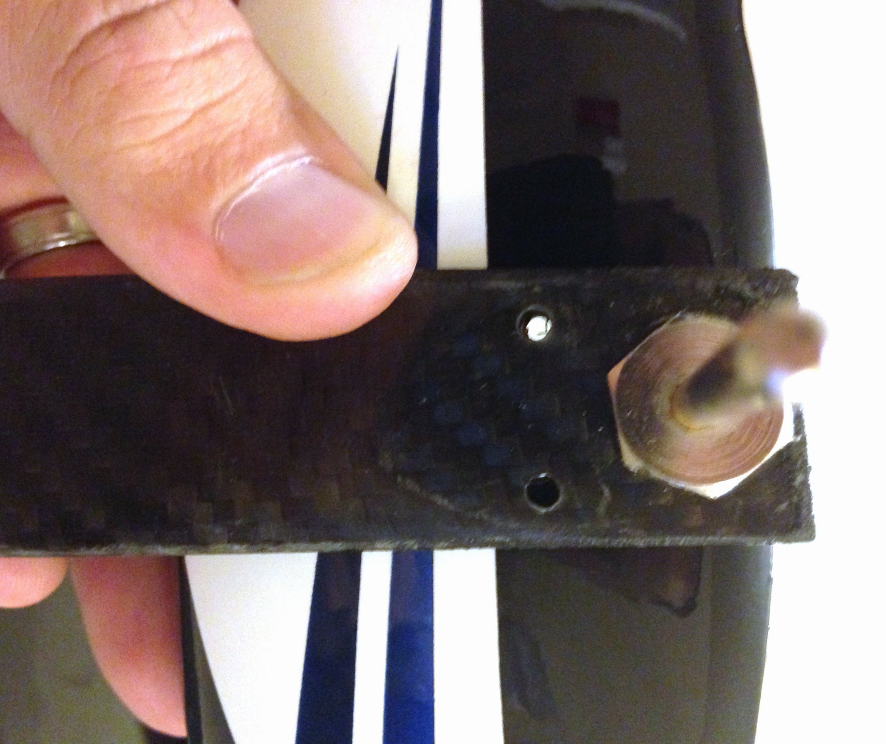

As you see... THERE ARE DIFFERENT TYPES OF NUTS FOR 2 OF THE 4 BOLTS PER SIDE. Well, 2 need thread lock, 2 don't. The outer bolts thread into lock nuts over the aluminum L brackets, and the inner bolts thread into blind nuts. The outer bolts are not long enough to go all the way through the lock nuts. So, in order to change the gear, the whole plate has to come off. It was a bit of a PITA to install... since you can't install either side independently. I looked in the included manual (on cd) but this plane isn't in the manual, and there is no explanation for the gear).
but it's on, so up next is the wheels and pants:

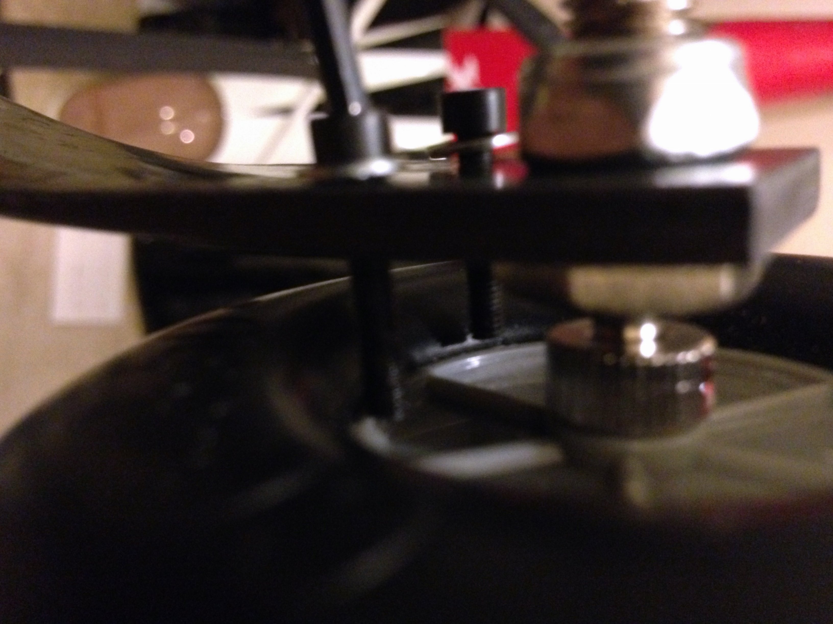

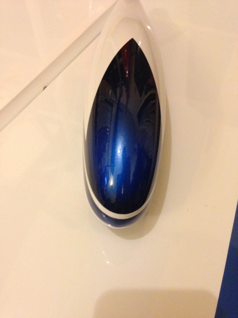

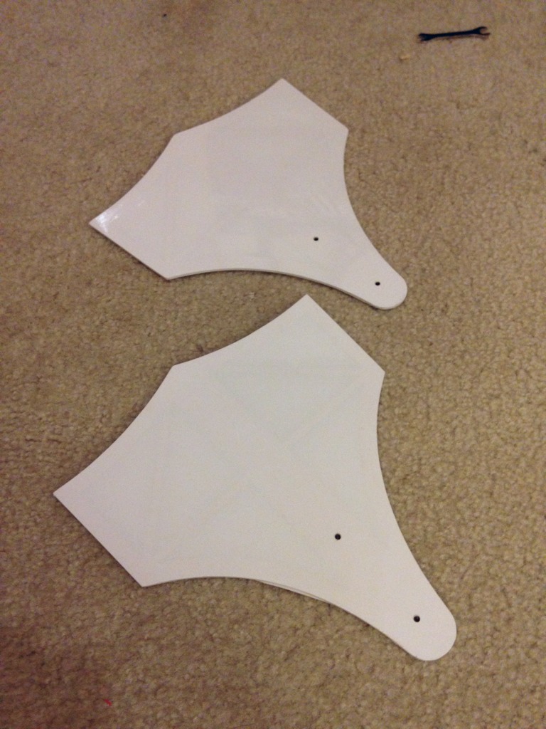

Another little snag. After getting the axles on, and taking the time to install the blind nuts in the pre-cut holes in each wheel pant, I go to mount them.... and whoa nelly... the don't align. see below:
I spent a little time with my dremel elongating the rear holes so I could mount the pants. Once on they look great.

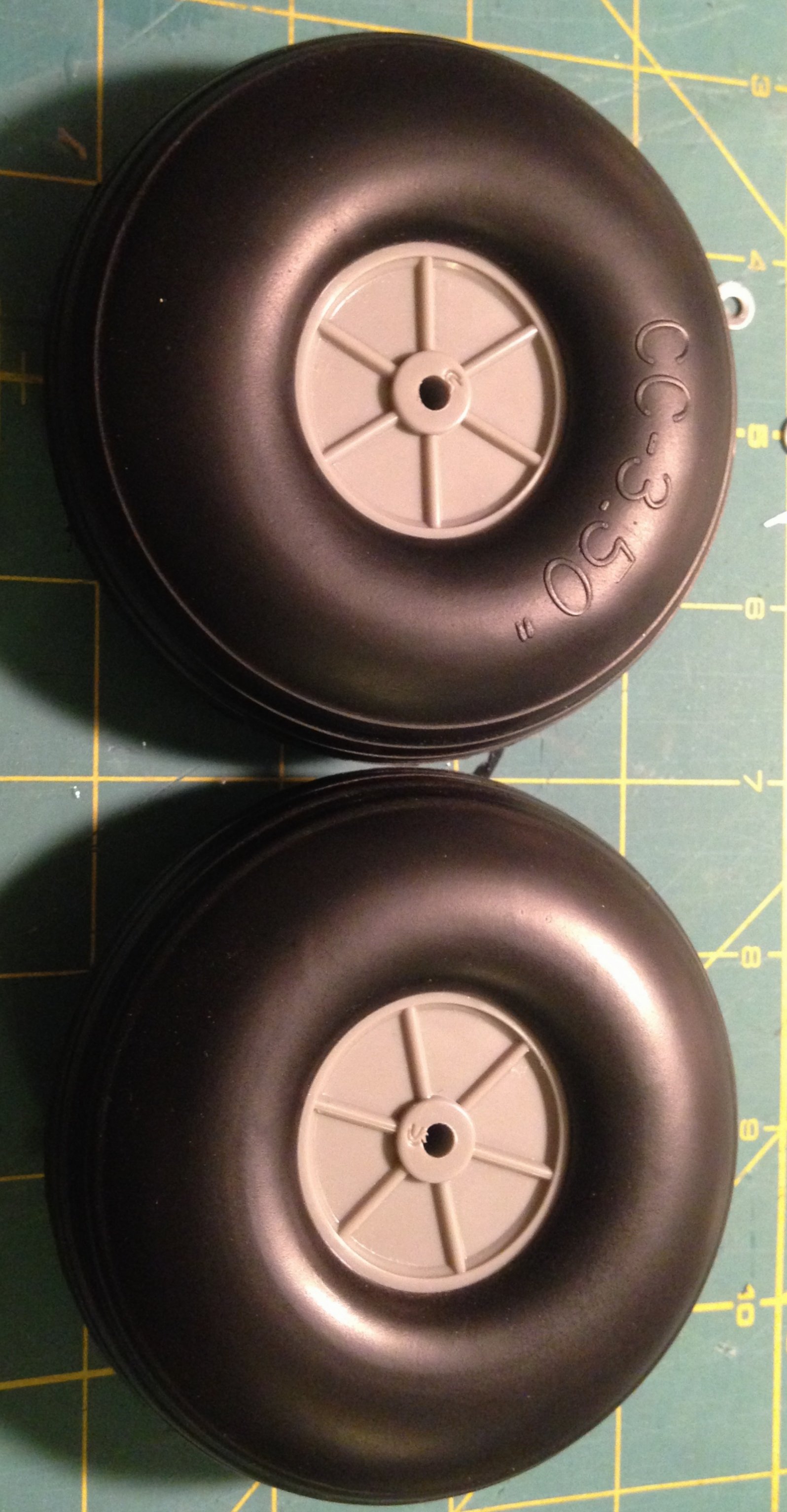

A little surprised to see an all plastic wheel hub, and a smaller diameter axle, when many other vendors in this size provide aluminum hub gear and thicker/stronger axles.
Also, the included bolts for this part of the plane are about 2mm shy of rubbing on the plastic wheels, so I went with some shorter bolts out of my parts bin.

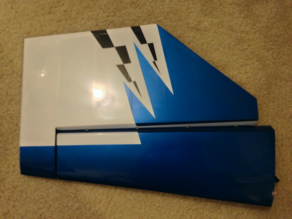

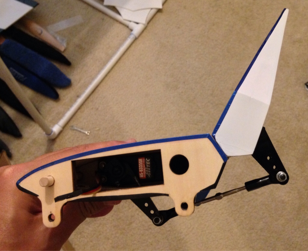

A little more work done... Both elevators are hinged up. No issues, took about a 2mm gap to get full throw, so I'll put some clear ultracote in the gap later to seal it up.
I really, REALLY love the oversize elevators. Also, the metallic blue covering contrasts so nicely with the white, this scheme is amazing.
