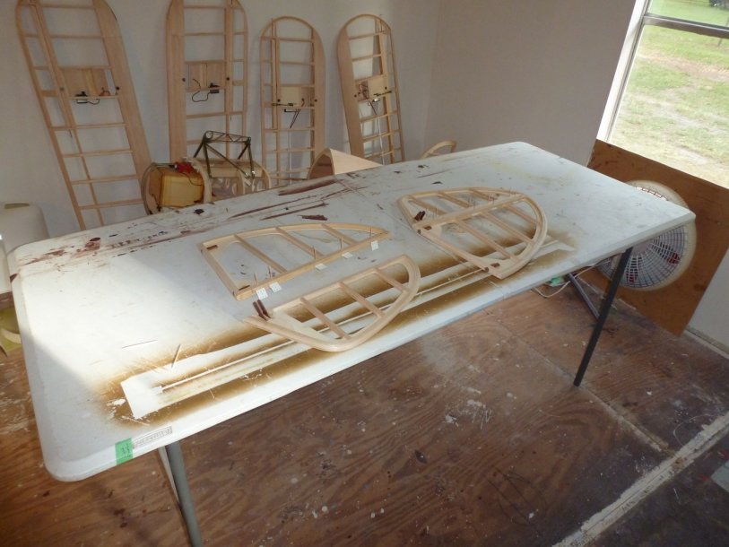

The brakes took a whole lot longer than expected, had to do it twice for they gave me the wrong pads.
The ele/stab has been sanded and hinges drilled for pinning but my bottle of GG said I don't think so, it obviously has expired, hard as a rock. So I am going to make a HD run and get some GG and pick up a 6' shop light.
Ace - I think you answered my next question in your pic. You are installing and pinning the flat Karvan hinges before covering and using the expanding GG ???? I have only used GG on smaller ARF's with Robert pin hinges, and have never had a hinge pull loose.

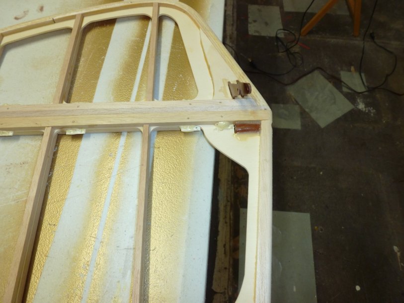

You are correct in every regard except, the Kavan hinges are not flat. But rather, they have a taper which make's using something that expands such as Gorilla glue far better. I adhere the covering to the T/E of the stab and L/E of ele then using a small syringe squirt GG in the opening. Then slide the hinges in and install the pinning stick (tooth pick), let dry and then carry on with the covering. For the record I use c/a for the pinning, the fit is tight and any other glue would just be squeezed off during insertion.

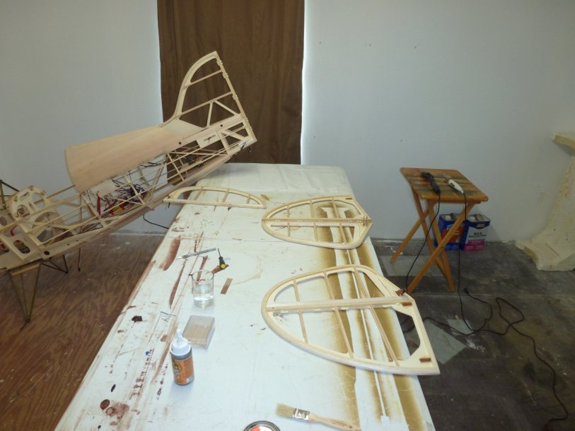

The hinges have been glued in and pinned. I had to revert back to the normal way without putting the fabric first, way to hard and messy. I will give it a bit then sand the dowels and start covering. The second pic shows how well the GG does the job.

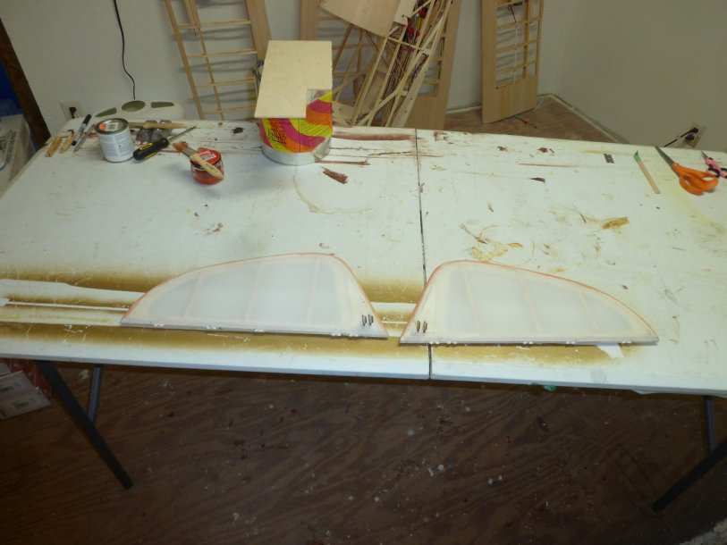

After posting the hinge's being glued in this morning I figured being they need two hours to cure I would run to a friends. The run was to pick up the clear coat and some fine line, I really figured I would be back in two hours. But somehow it turned into five, then a neighbor asked if I would lift his cattle trailer with my tractor so he could fix the tongue jack. I finally got back to the covering about 6:30. The ele's are covered, next up the stab's.
