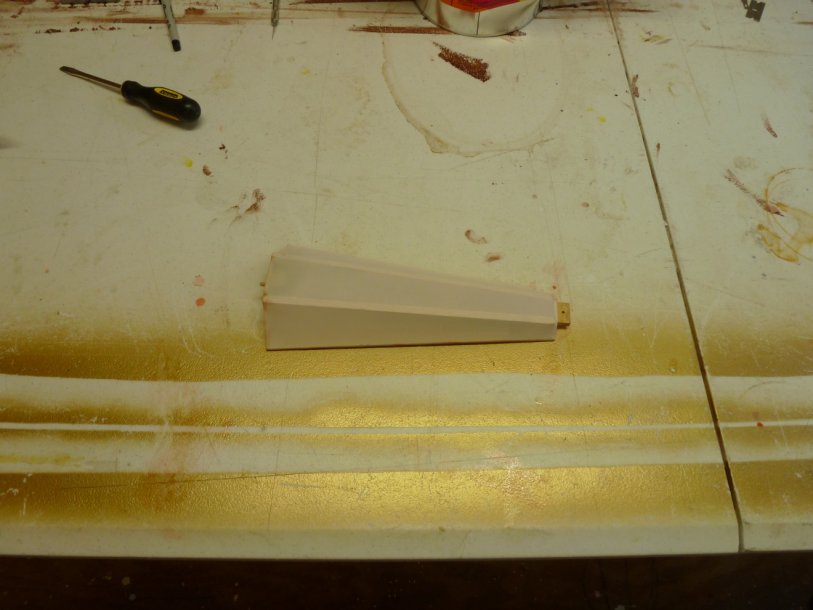

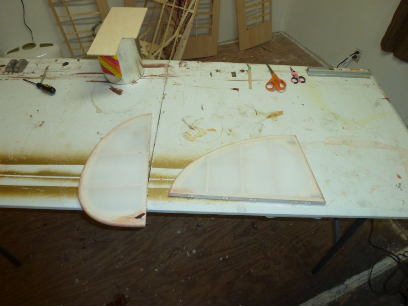

acerc
The other stab and the fin are covered. Doing this without the pink tapes requires a lot more care on the perimeter and cut, much slower than I had anticipated.

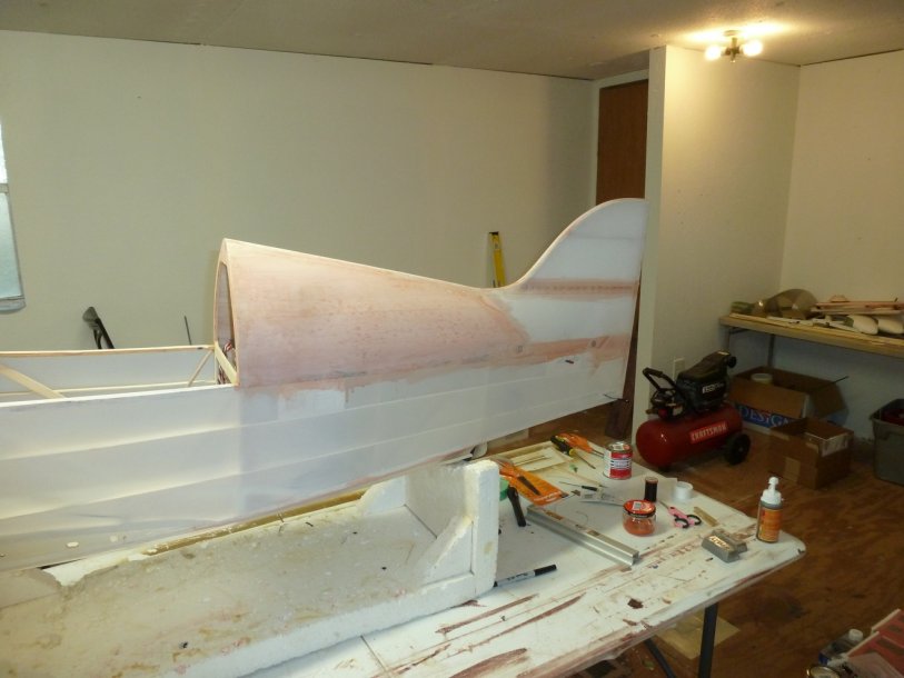

acerc

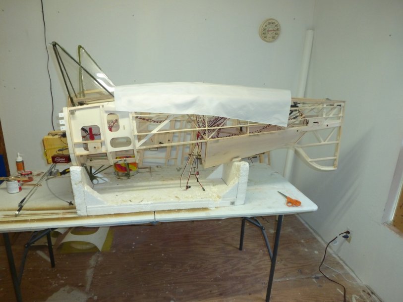

And here is what probably will be the easiest part of the covering job, the rudder servo fuse hatch.

acerc

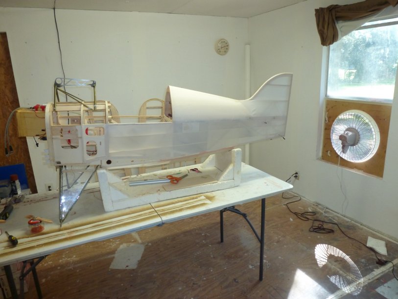

I have the fuse prepped and the pieces cut, but, it is up to 90° in here. So, I am calling it a day, closing up the windows, and turning the A/C on. The wife went in early today and will be home early, so there will not be any evening work, maybe.

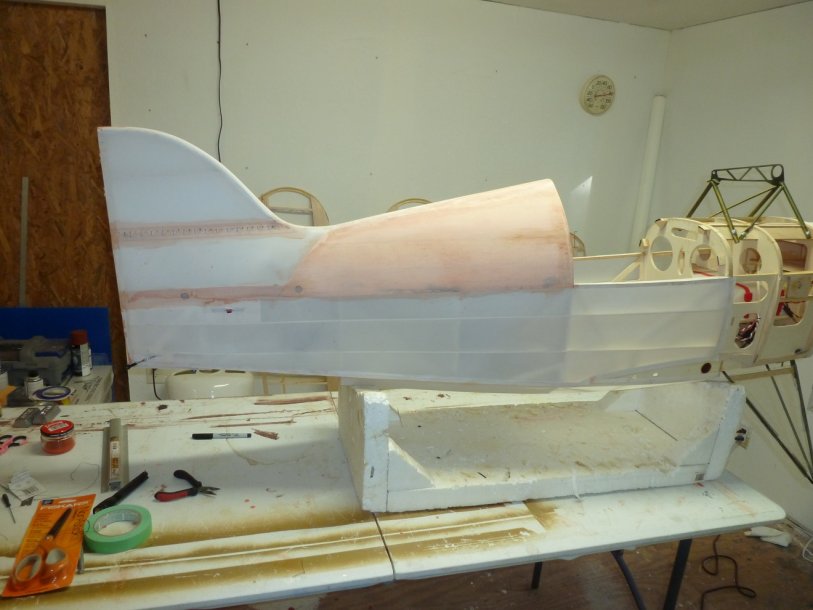

The fuse is covered. Before I can shrink the covering fully I have to tie the fabric to the fin's bottom rib. Being I have no fabric tape, thread, or even a needle I will have to stop and go get it. I want the fuse finished so as to put the bottom wing on and check the fit, it may be to tight and require sanding which before I cover it.

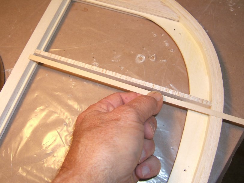

Jaketab
Working on the tail sections of the Pitts. Have idea to add/paste a 1/32" basswood strips to raise the ribs and to make the ribs stab out and give the tail sections a slightly airfoil look. The basswood will sand smoother than balsa. Any thoughts on whether doing this could have adverse affects on covering or otherwise ??????
Thanks - Jaketab

acerc
I don't see any adverse affects, but the full scale used tubing and did not have an airfoil, just saying.

Jaketab
The truth might be that I got too aggressive with sanding and got into the balsa ribs.
The thin strips over the ribs will help conceal my aggression.

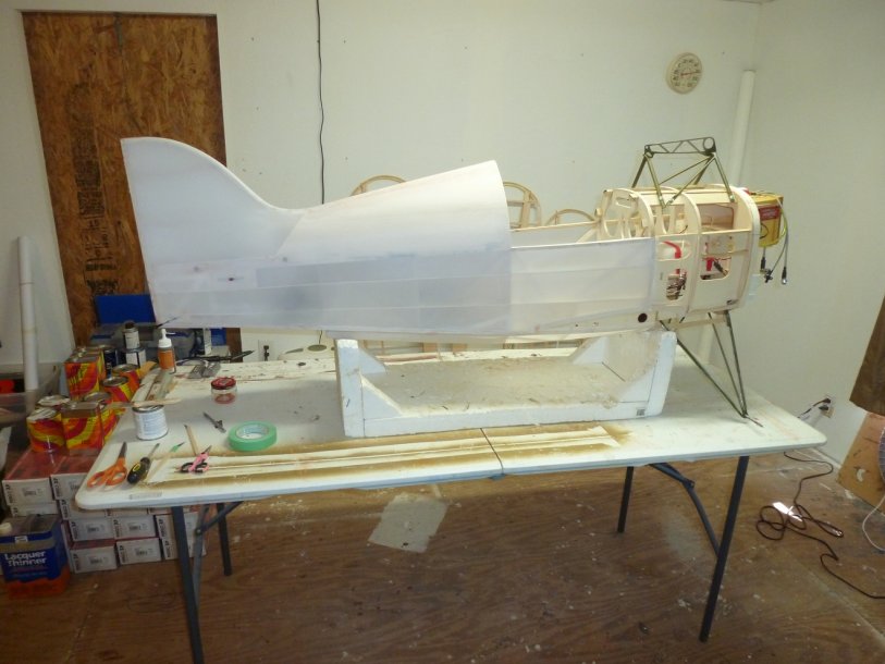

acerc
The fuse covering is complete, now to fit the lower wing halves then cover them.
