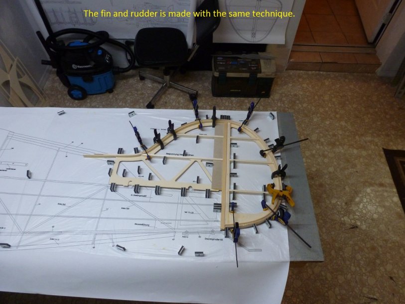

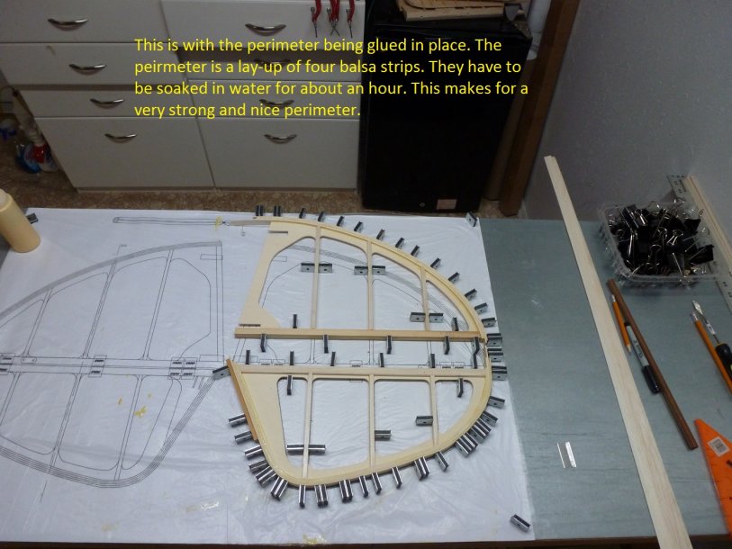

I prefer to wrap on layer at a time, and after soaking in water be sure to wipe dry as much as possible. If you laminate all of them at one time the water, regardless of how well wiped, will dilute the glue so as to take nearly 24 hours to dry. One could use c/a in the process to hold while the wood glue dries or in lieu of, just saying.
Below is a shot of my tail feathers in the process, if it gives any ideas, great.

Thanks for help. I had in mind to apply the 1st perimeter strip and let it set up till dry.
Then apply the other four.
