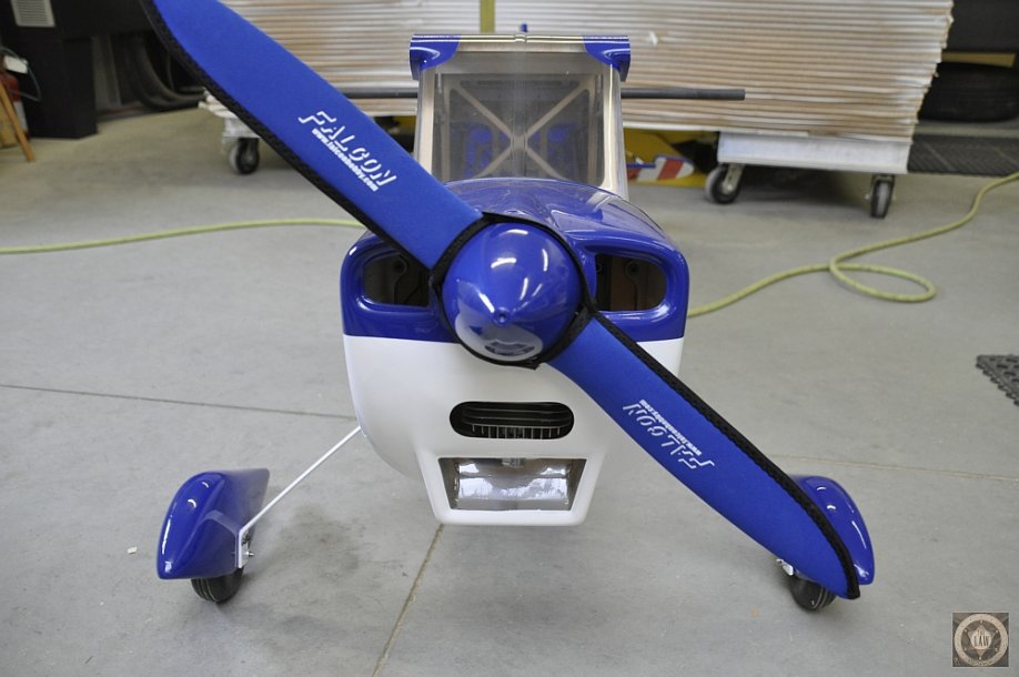

Had just enough time last night to wrap up the decathlon and get a quick test run. The DLE85 is so smoooooth on the proflow canister!!!! I had to lean the low end just about 1/8 turn to get the low end to like the can but then it really was happy.
Finished weight is basically 27lb. and a couple ounces with the DLE, header and large canister. So with a DLE55 / DA60 it probably would come out at 24lb. and change. With such a large wingspan though I really think the 85 is the way to go. I did have to cut a hole in the side of the cowl for the header but not that big of a deal.

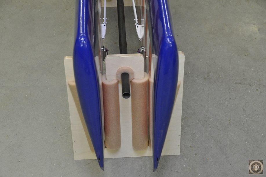

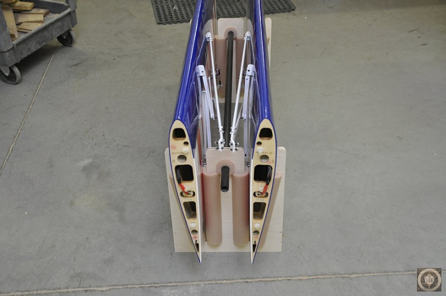

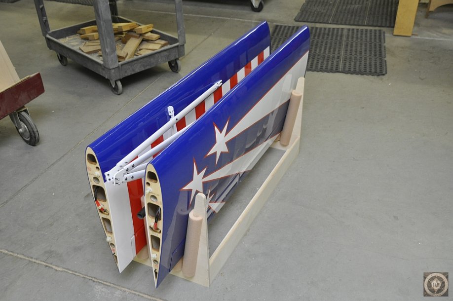

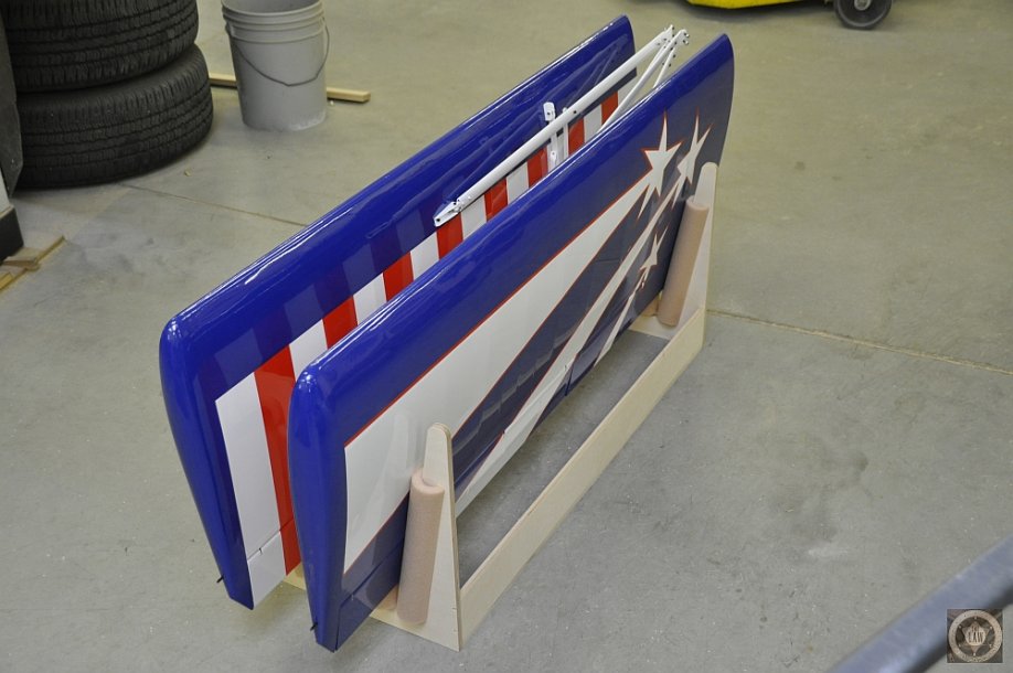

The wing panels are 59" each and the struts stick out beyond that so even a 40% plane wing bag is not quite large enough. I drew up a holder in about 5 minutes and had @thelaw cut it out for me on the CNC. Couple more sticks and a little foam and less than 30 minutes later I have a wing cradle!! I put some foam donuts on the ends so the wing tube is held snug in place but also serves as a handle for the cradle. Worked out pretty darn good!!! I gooped a box from one of the servos to the inside of the cradle to hold wing bolts and spare hardware for installing the struts at the field.

Oh, and I love the wing cradle too!

Like the cradle. Do the struts lock down and stay in place, or can you bolt those together so they aren't banging around. Sum Beach, that is another one.

I put a piece of foam between the struts and a velcro strap around them. No banging around. Weather sux otherwise we would be flying. Maybe tomorrow if things work out.
Very Nice. I did not realize the bend radius was that much but you did an excellent job for the cut out. You said you did run it. How did that exhaust tone work out?

Exhaust tone at idle is deep and smooth. Extremely quiet. It has a little bark at full throttle. I picked up a Falcon 26x10 at Joe Nall. TSA was a little confused but luckily let me carry it on For the flight home.
I did end up cutting the DLE170 header and adding a section of 1.5" ID teflon about 2" long to extend the middle of the header by 1.5" or so. It actually got me to a header length that @Planebender recommended for the gp88. It worked for the dle as well. Hope to get some video tomorrow.
