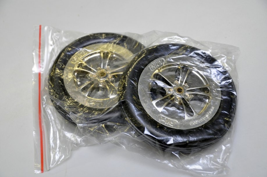

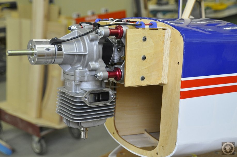

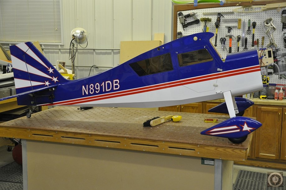

I had an hour or so tonight to wrap up a few things. All engine related components are complete except for header and bolt the cowl on. Started to prep the interior for receiver install. Bolted on thew new wheels / tires and wheel shoes. I think these tires are much better fitting for this style of plane.

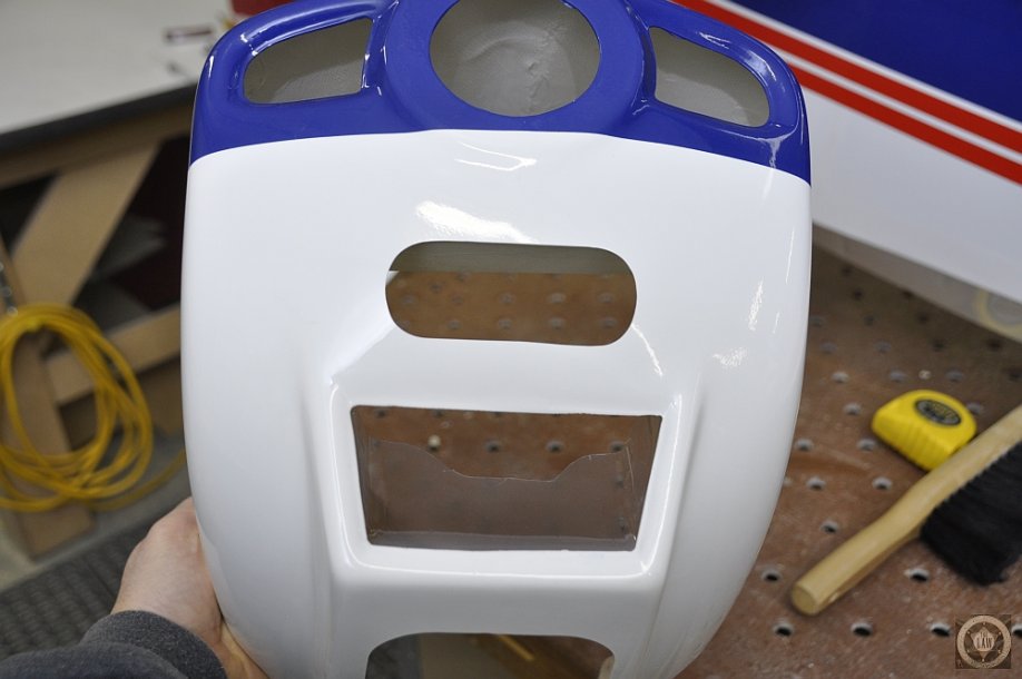

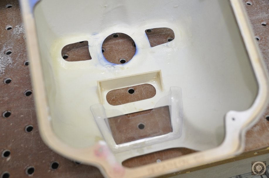

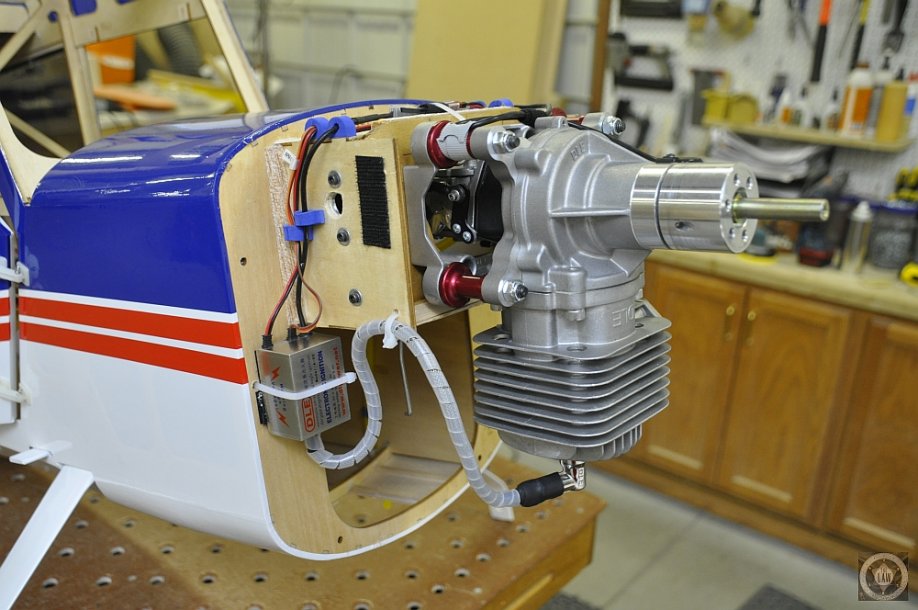

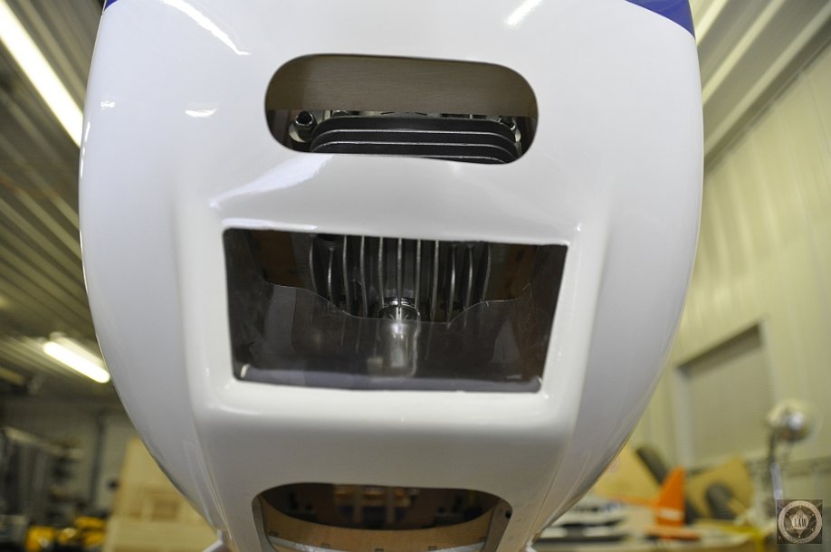

It comes with a clear air deflector for the bottom hole to aim the air up towards the head. I added another hole and put another baffle on the top to keep as much air going at the fins as possible. I think this should work just great.
I have to say that this thing is freaking huge, I can not imagine a 55 or 60cc engine hauling this thing around with any gusto at all!!!! The 85 is going to be just perfect!

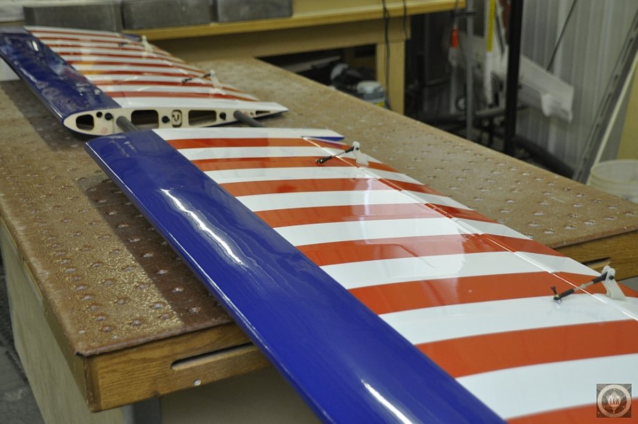

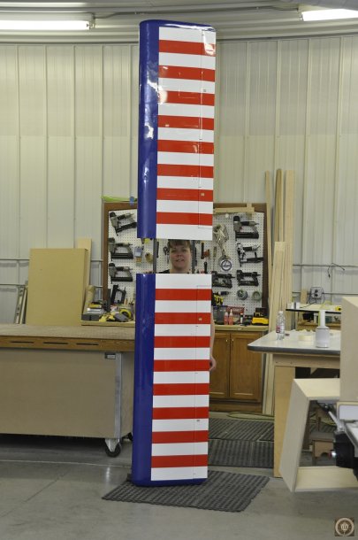

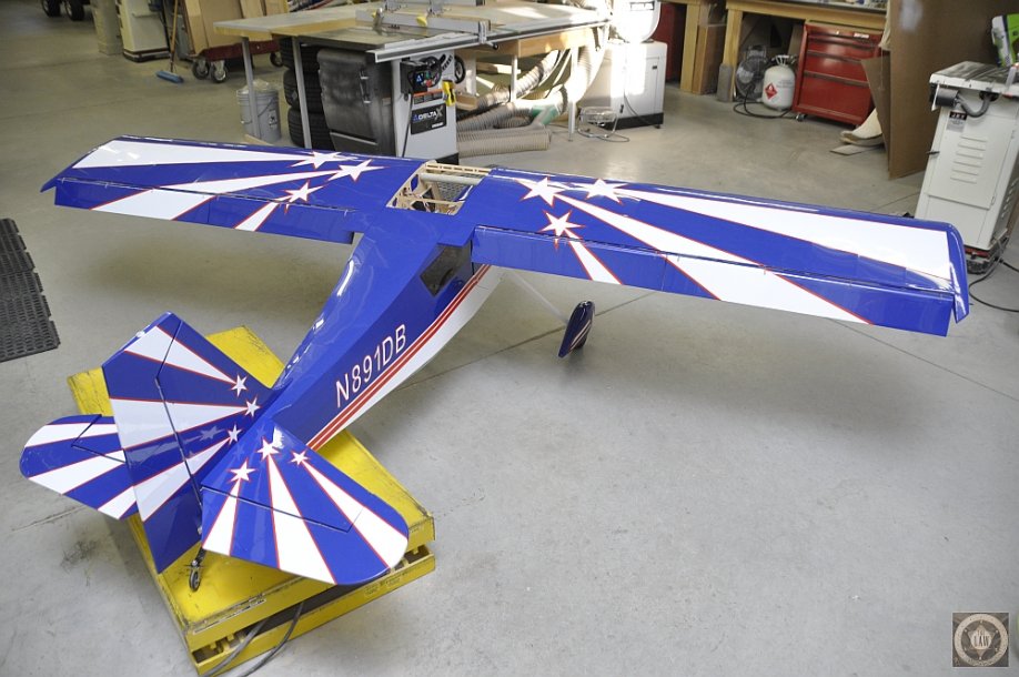

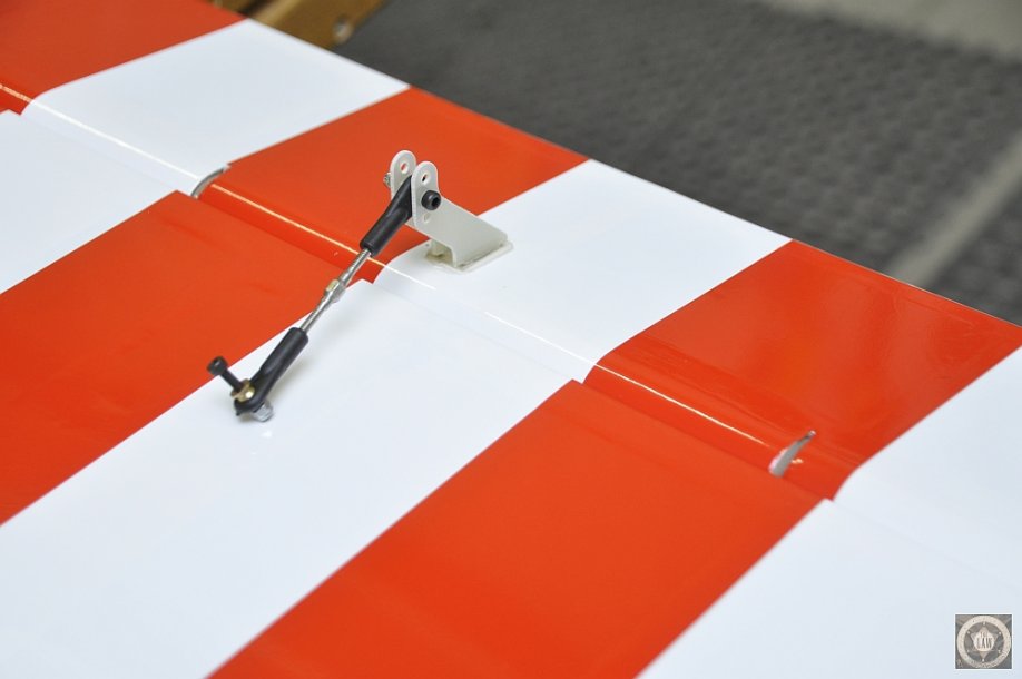

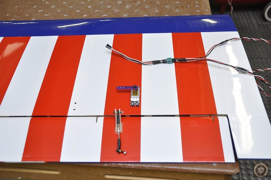

I just took a pic of LAW holding the fully assembled wing. Didn't have time to play today but I'm getting the aileron hinges installed quick before I leave. I'm hoping the 85 is snappy enough to give it a little bit of punch out of a hover or I can see a 111 maybe finding it's way in there with heads sticking out the sides of the cowl.

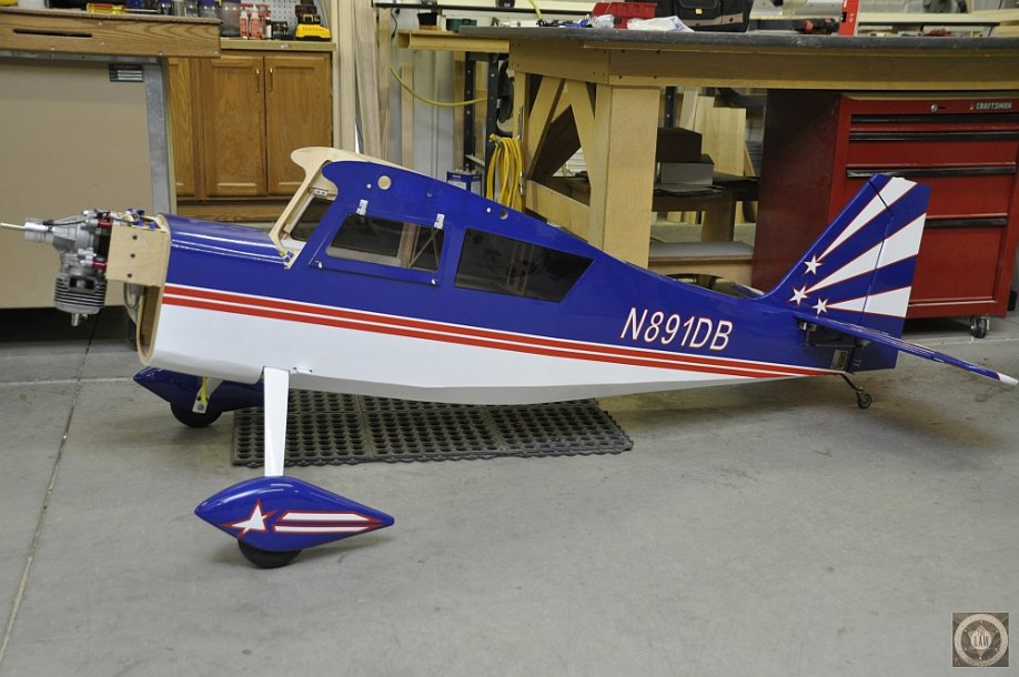

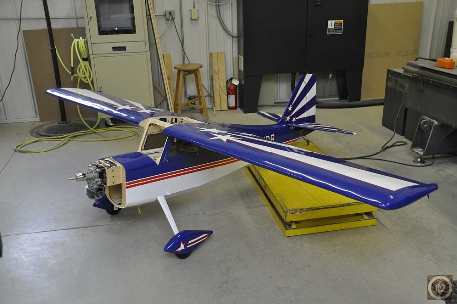

Well, servos mounted and ready to hook up. Pretty much install the tail wires, struts, header and windshield and it's all set for maiden.

Either you shrunk the Law or that is a big wing! :way_to_go: That plane is going to be awesome.
