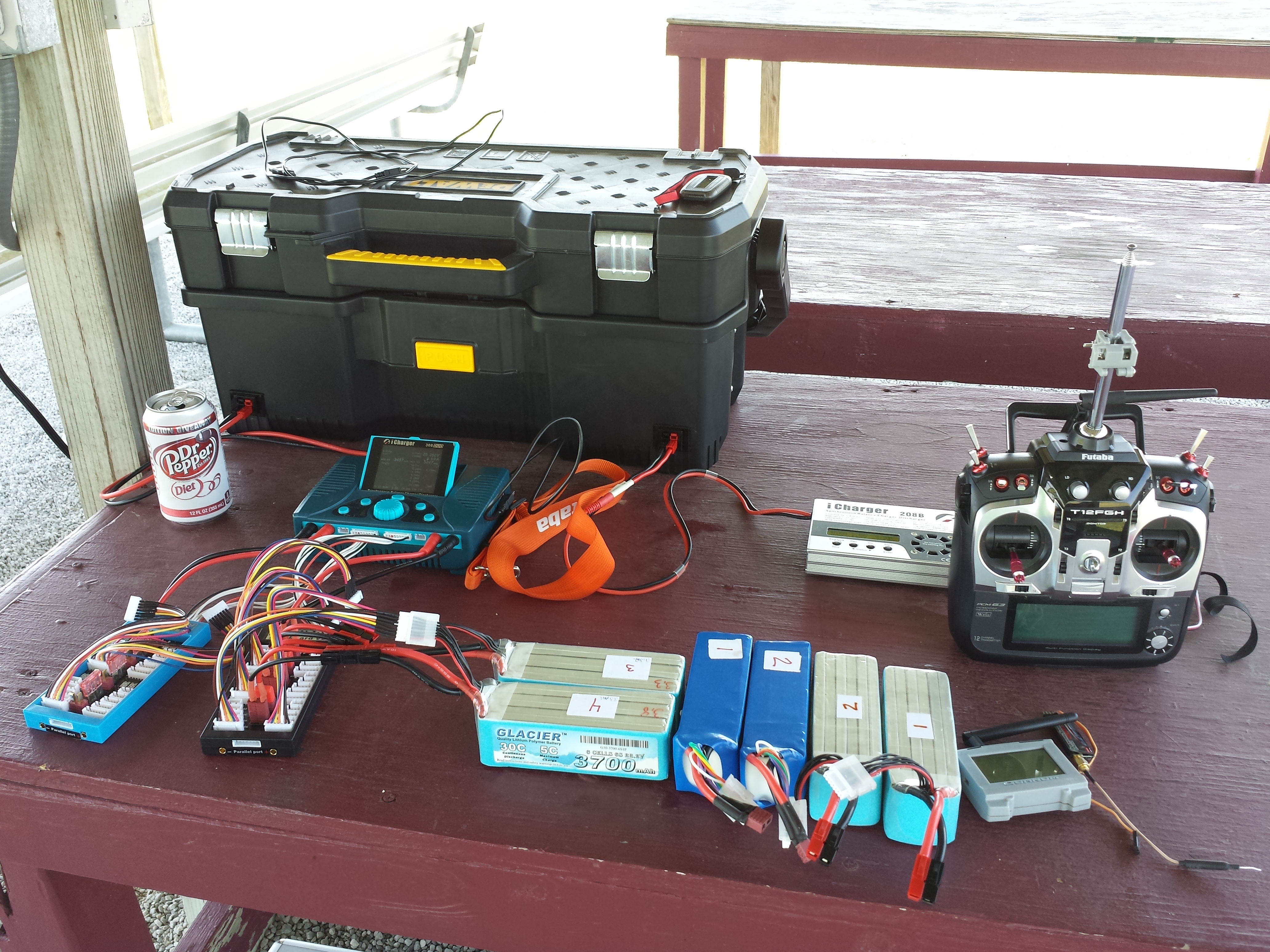

I have a 650 watt generator I take to the field that I got pretty inexpensively. Total cost of my iCharger, AC power supply, field case, and generator was around $500, though I am limited on the max charging power I can use because my generator is only 650 watts max capable. Running the iCharger at 24v and charging 2 6s 5000 packs at 10 amps can start to push ~500 watts which can tax the generator (definitely can hear a load being put on it). The setup works fine though as I can have a set of packs charged every half hour. With my thunder power pack, I can have it charged in half the time!
