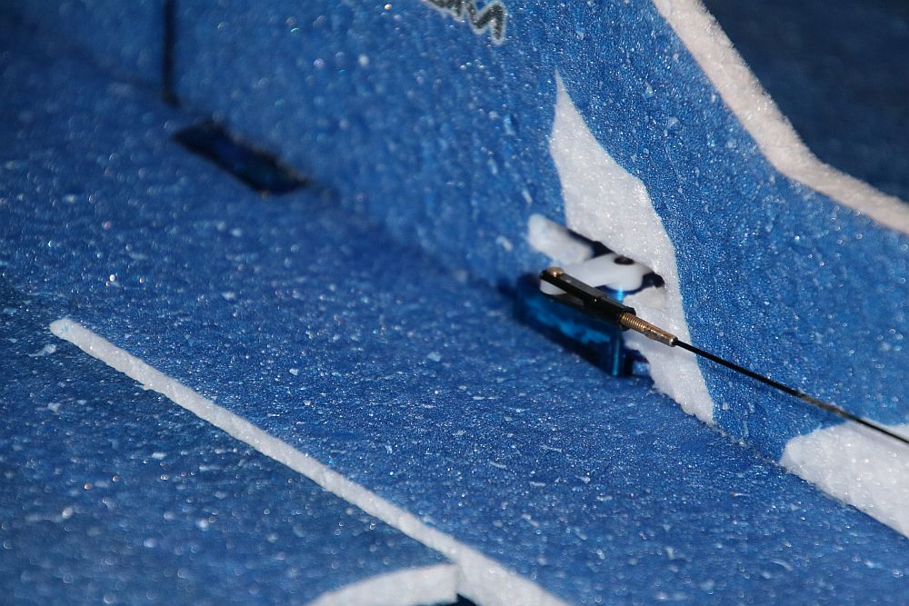

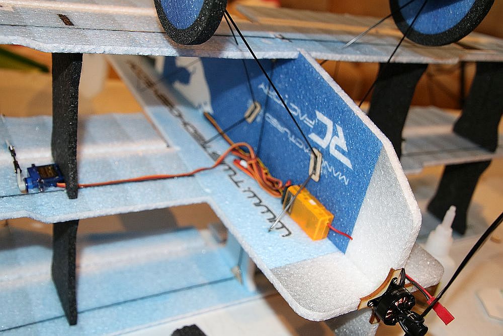

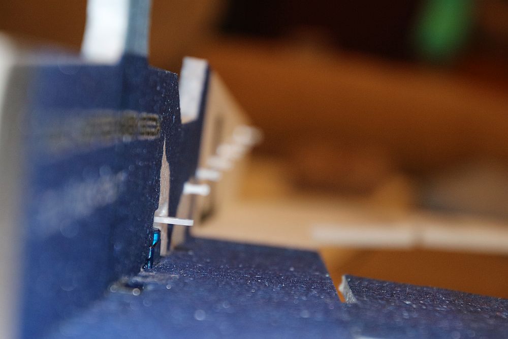

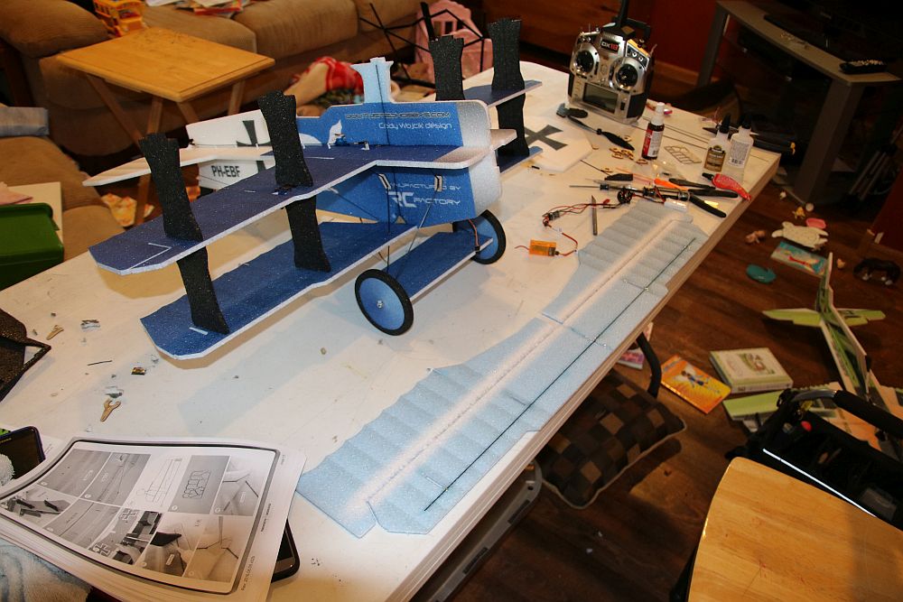

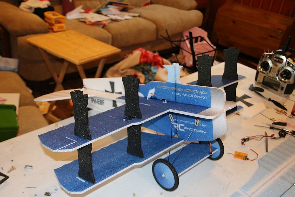

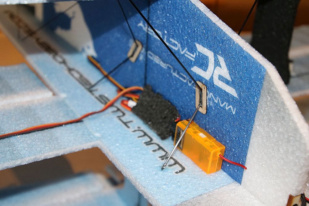

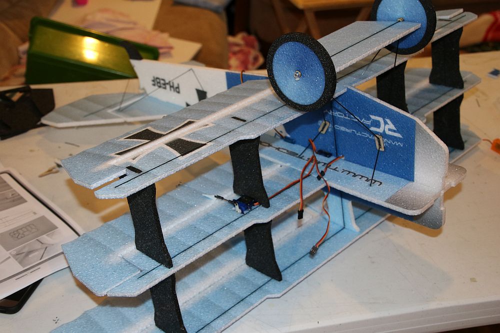

Upper vertical fuse and top wing were next. I had some trouble getting the fuse installed while pulling the wire for the serv
o through. Takes a little patience and time. Top wing was easy. Add the cabanes and flip it over to install the wing.

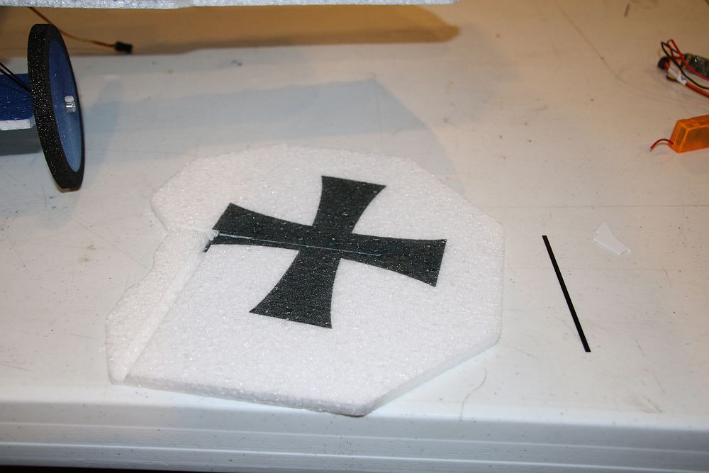

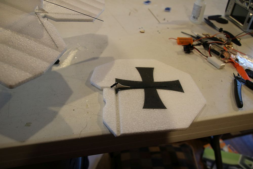

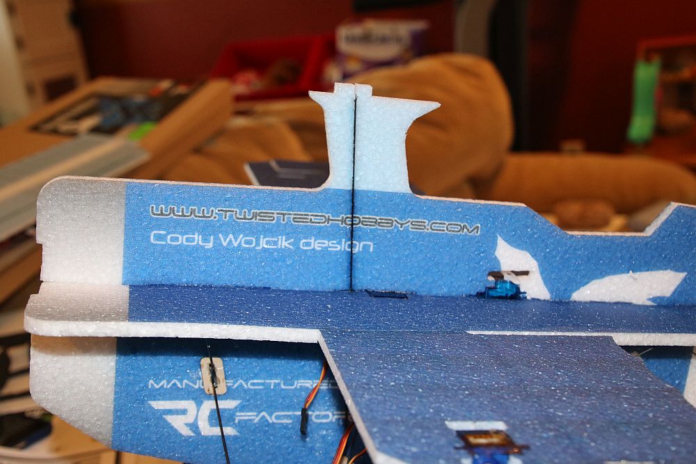

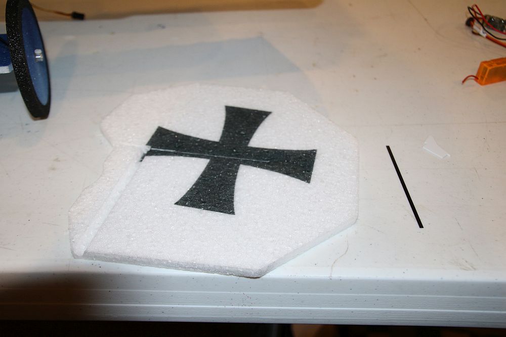

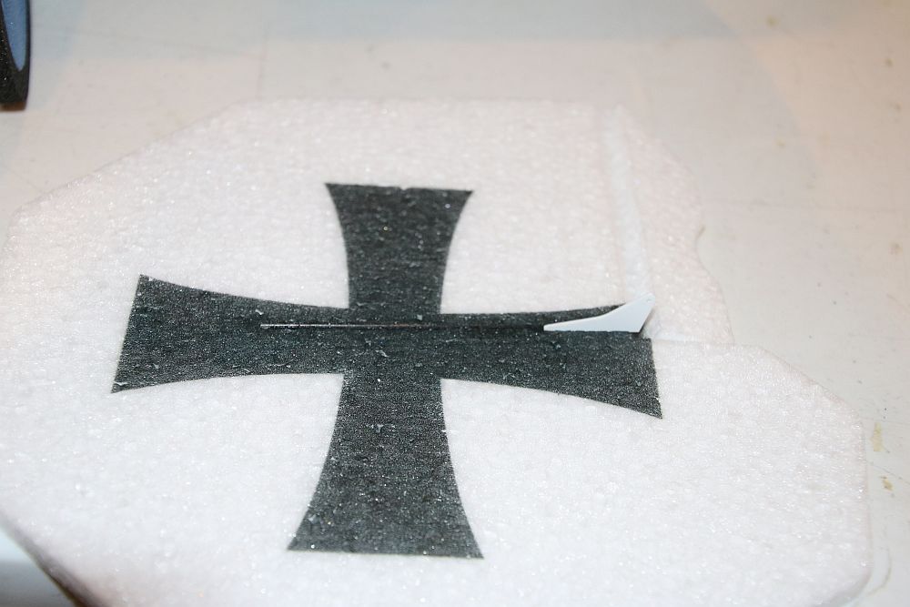

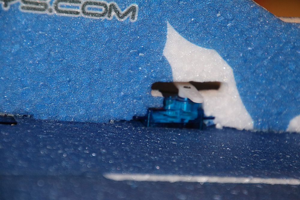

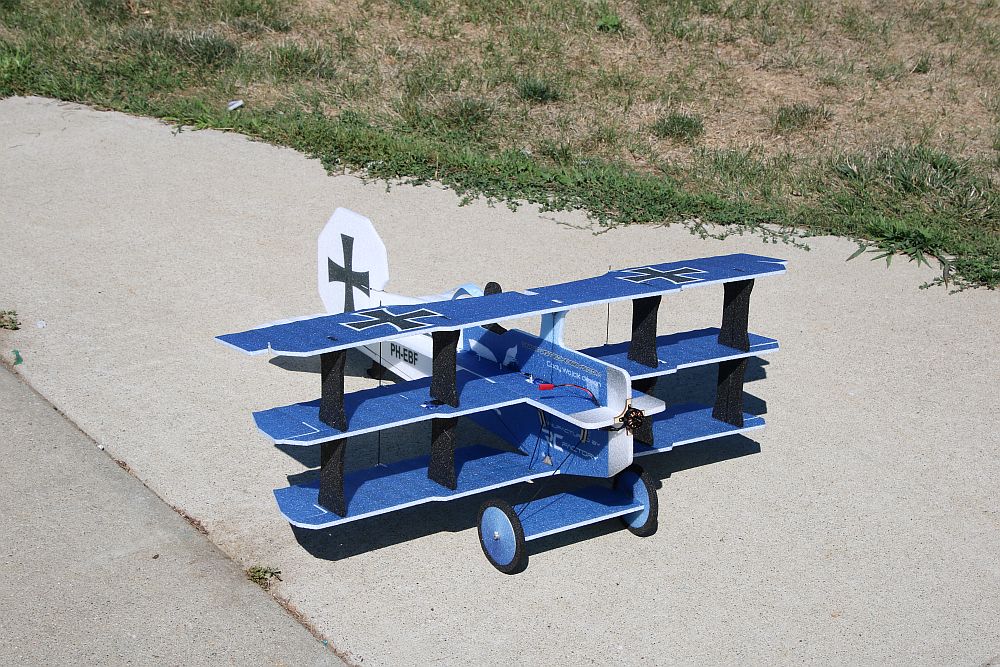

The tail was next. Add a cf piece and the control horn, then attach to the fuse. Control rod was the same as the elevator.

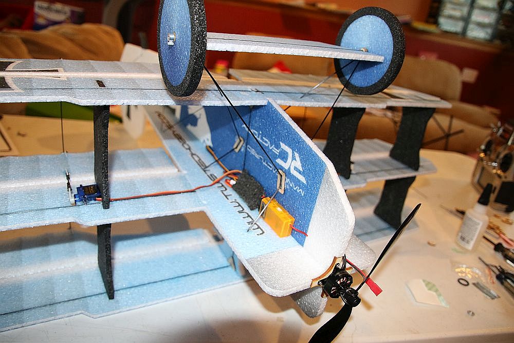

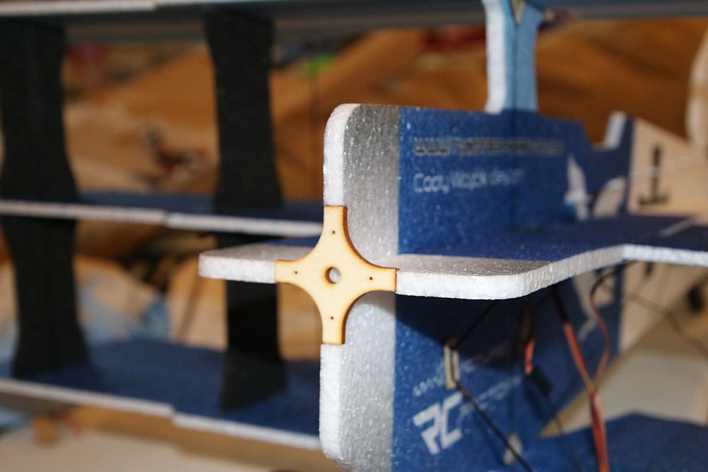

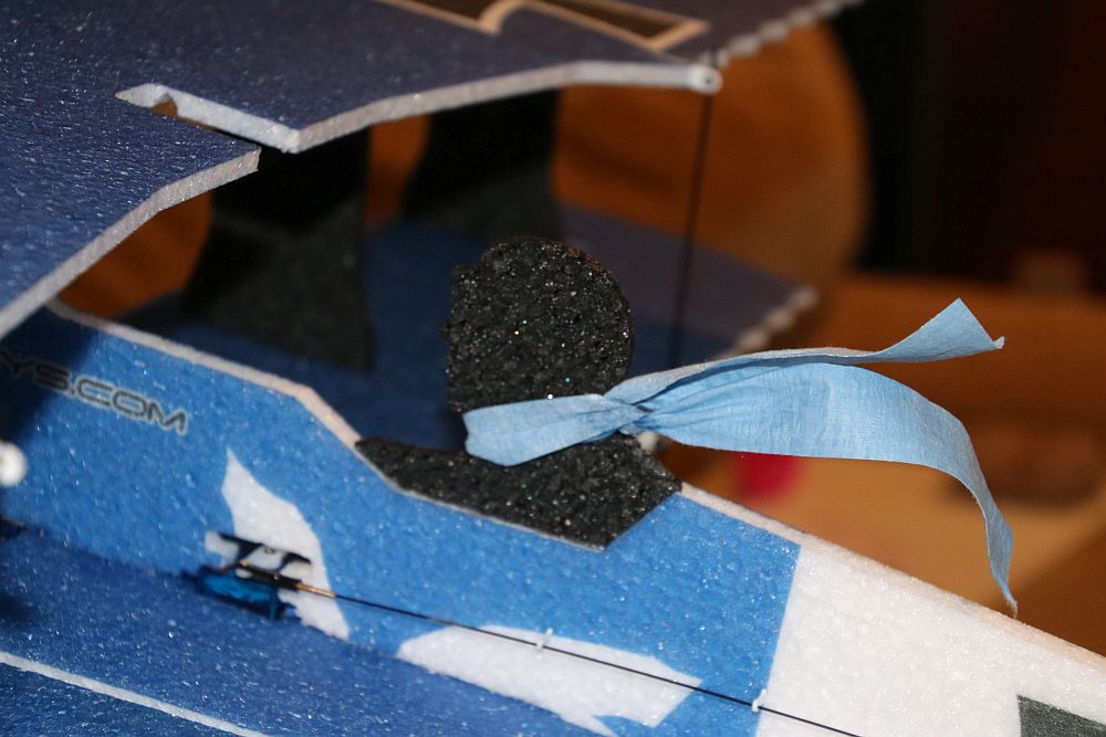

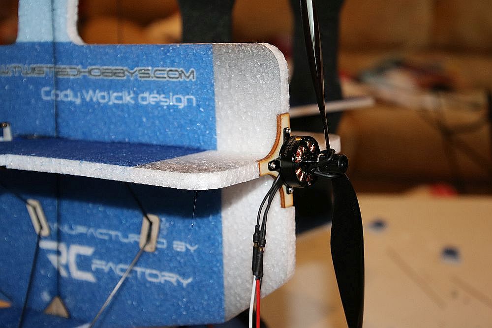

Motor mount and pilot are next. After I glue on the motor mount with welders, I put a small amount on the back side in each corner for extra strength. I added a piece of cloth to the pilot to add to the cool factor.
