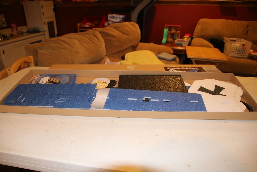

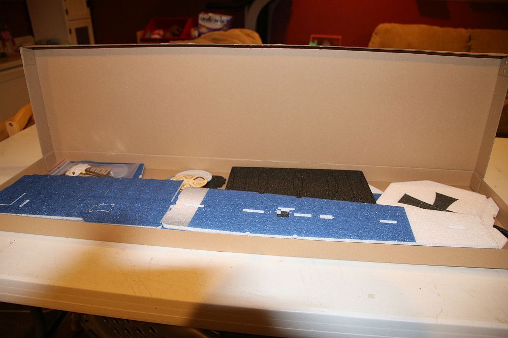

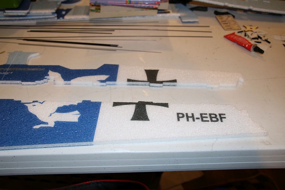

    Alright, here is the packaging.

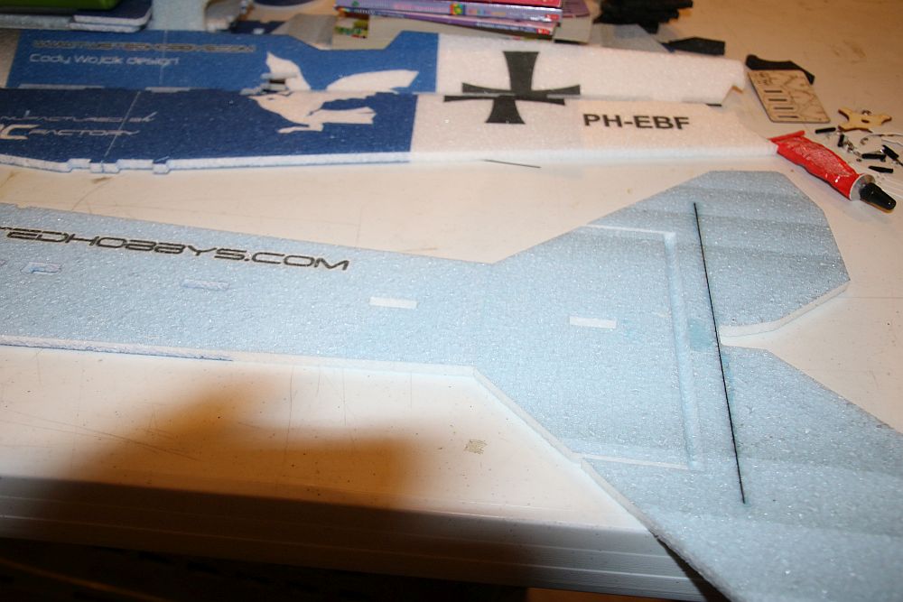

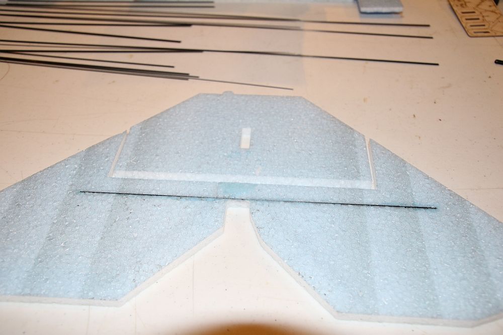

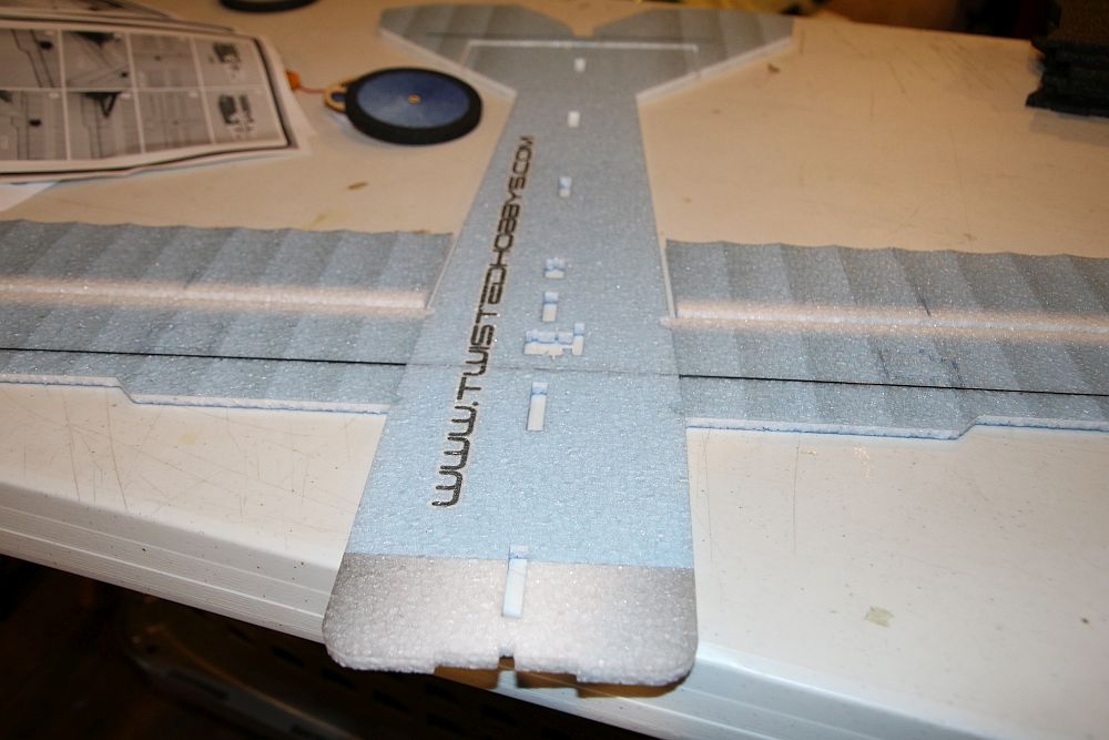

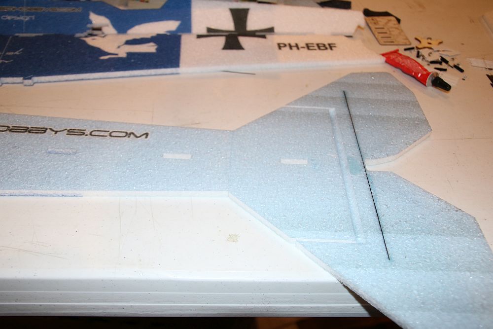

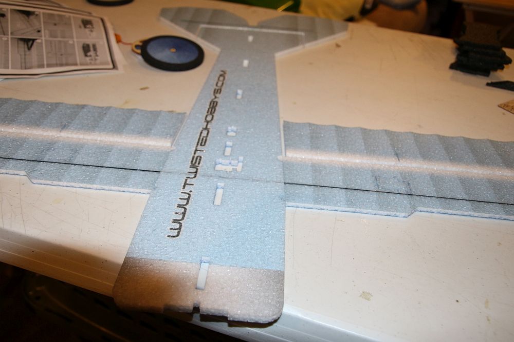

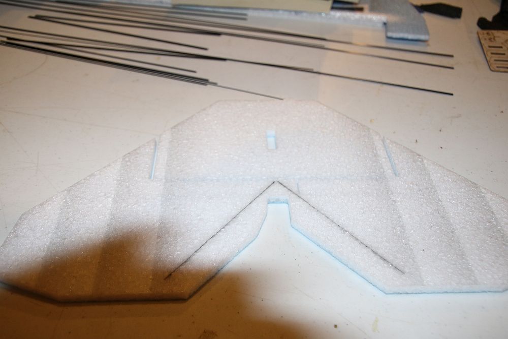

    I started on the tail. I used thin CA to glue in the CF braces. I then glued the fuse to the horizontal stab. image05.jpg image06.jpg image07.jpg image08.jpg

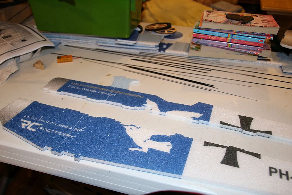

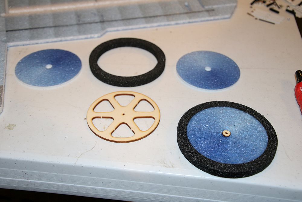

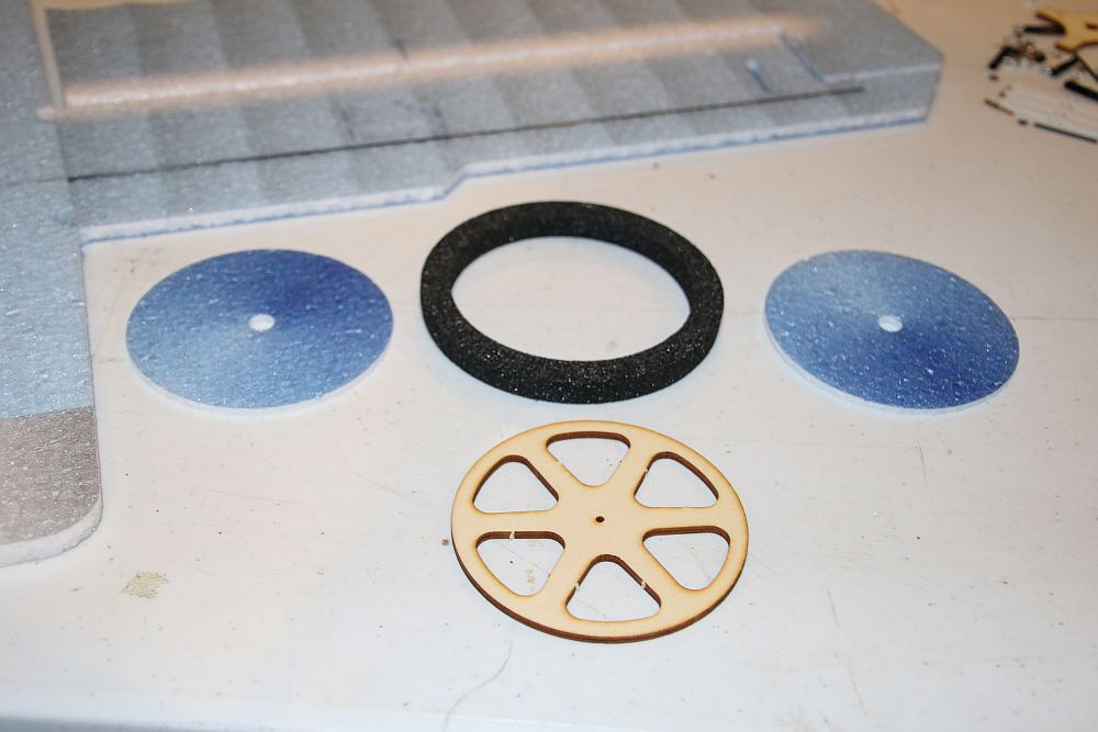

    Next I sliced the vertical fuse at the tabs. After that I built the wheels. They are made up of a center wooden disc with a foam "tire" around it. There is a foam disc for both sides and a small wooden doubler that goes on each side to help support the axle. image09.jpg image10.jpg image13.jpg image14.jpg

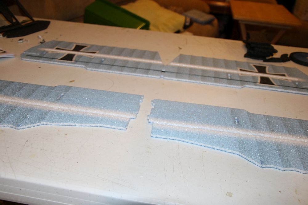

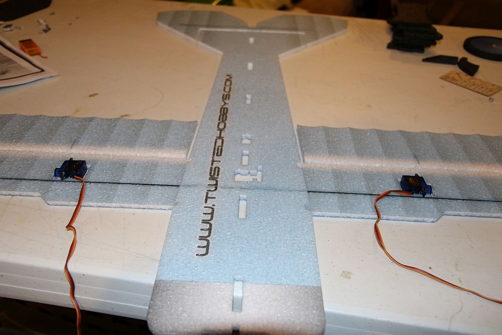

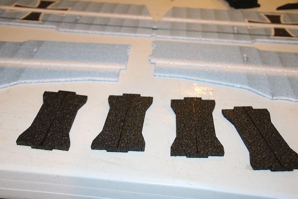

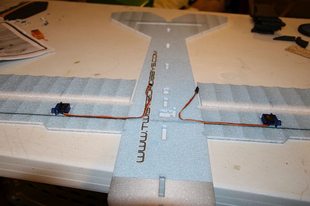

    Finally for the night I worked on the wings. I attached the middle one to the fuse and added the CF support. The servos go in the middle wing, so I also glued those in. image11.jpg image12.jpg image15.jpg image16.jpg image17.jpg image18.jpg I glued the bottom one together and added the cf support to the other 2. I also added the cf supports to the 4 cabanes that get them.
