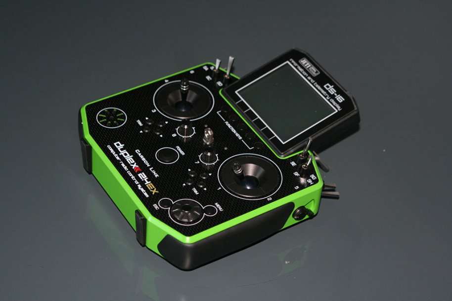

jeti DS 16 thread
Skyluc
here it is:brian-banana:
and here is my new start sound
