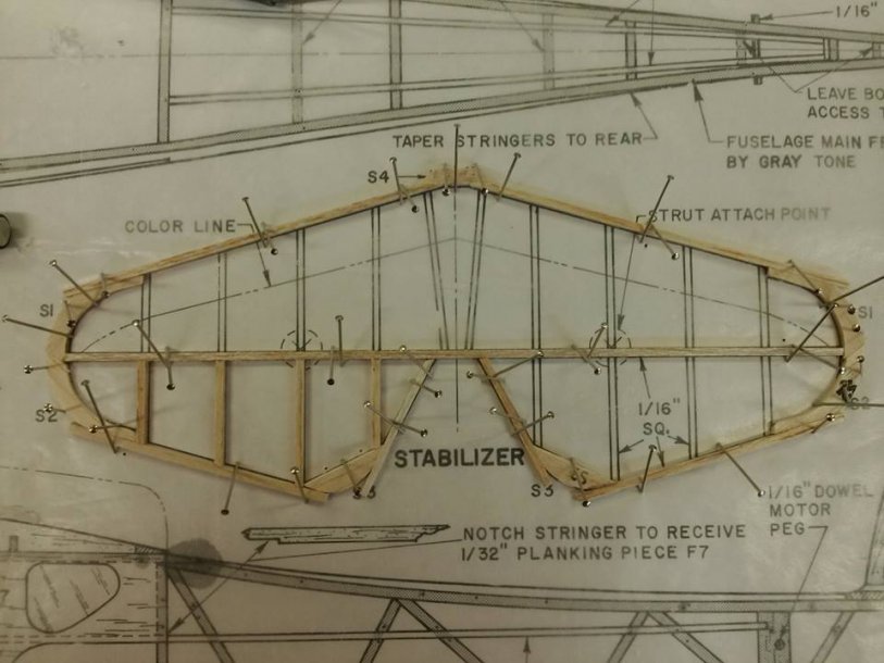

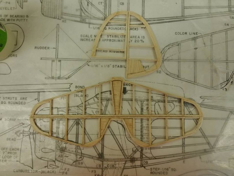

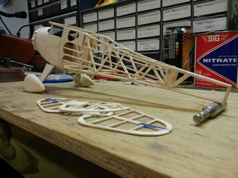

Started the horizontal stab and the elevators before I burned out for the evening.

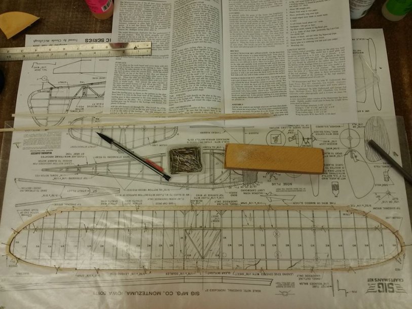

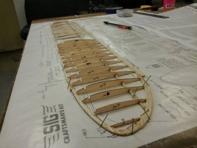

So on to the wings!

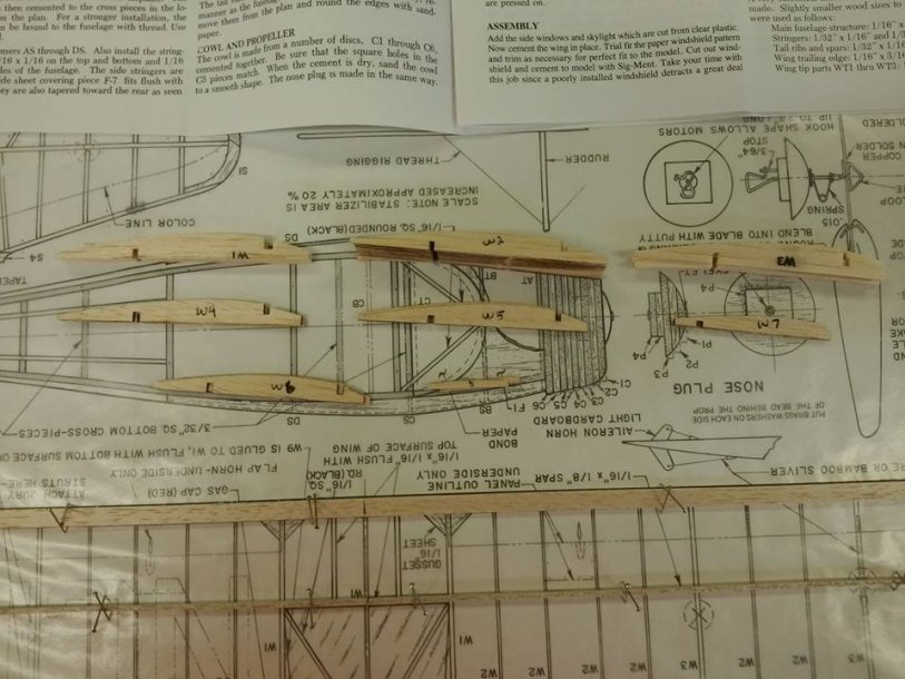

Leading and trailing edges, tip parts and rear spar are pinned down and glued in first. Then on to the ribs, all THIRTY-TWO of them lol. Most of the ribs are 1/32" thick and laser cut (I know, Sig and laser cut don't seem to go together!) The root ribs and the ribs where the struts connect are 3/32" and are die-crunched, but Sig must have found a way to sharpen their dies because all the die-cut parts have been great.
Finished installing one panel of ribs before I burnt out for the night.
