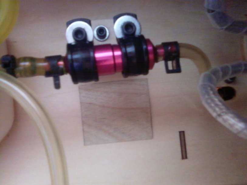

I have a similar set up on my gassers. I just use a large volume filter with a brass micro element.

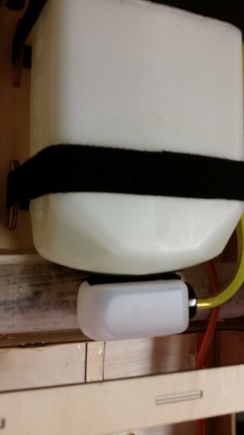

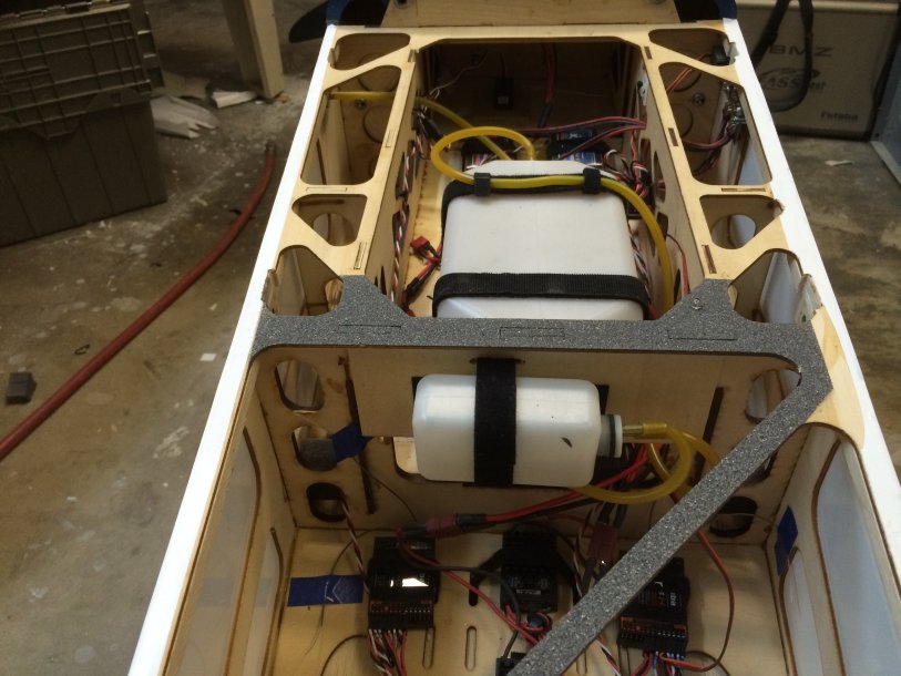

Here is the photo. You run your vent line out of the main tank into a clunk in the vent tank. The vent tank has a line going outside the fuse as normal. When you fill the main tank, stop before fuel fills the vent tank. In flight the vent tank may fill a little, but it will get pulled into the main tank as the fuel level goes down.
I was surprised at how much cleaner the bottom of my plan was after converting to this method

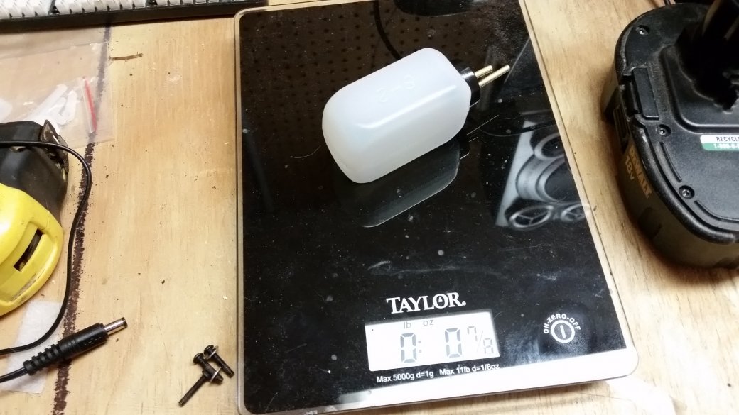

Installed the 2oz tank yesterday. Cannot wait to find out how it does. less than 1oz of added weight.

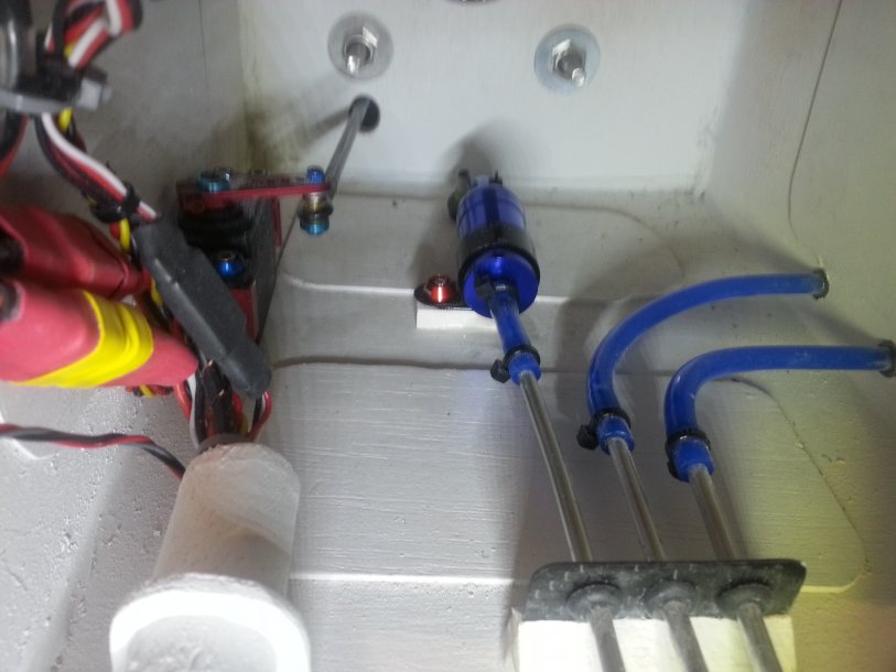

Installed quickfire filter /fuel balancer. Not really a header tank but holds 1/4 oz of fuel and good size element. Like the idea of ready fuel supply with 3 line system for starting and a lil extra fuel on a really long downine.
It would have to be a really really long downline to grab a bubble even with a traditional system though. But that the heck, gives another reason to bling something.
