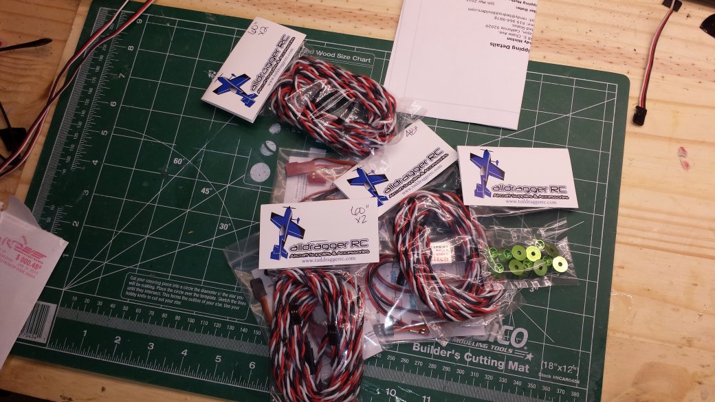

Got everything out of the bags and it all looks great.

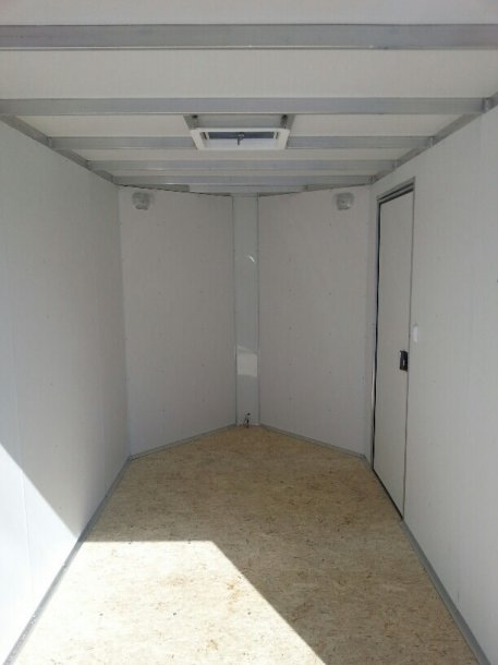

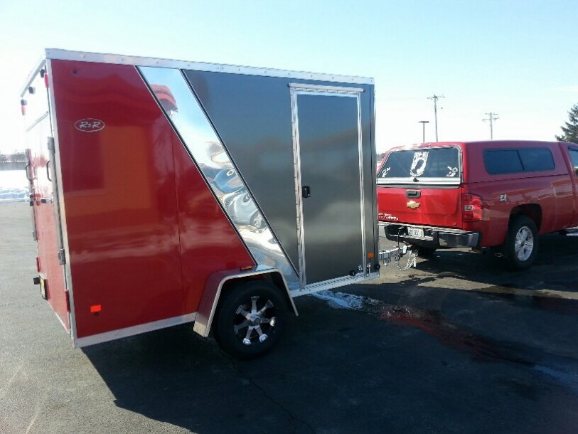

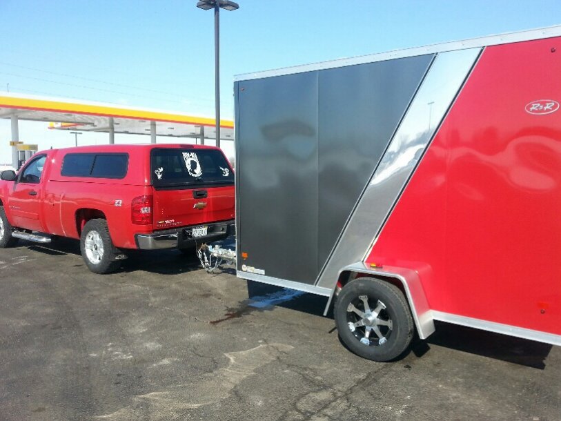

Not a whole lot of progress to report, other than I went and picked up my trailer this morning.
Wow that aluminum trailer is beautiful. You will enjoy hauling those giant scale planes in that rig, the paint scheme is beautiful, I like it very much.

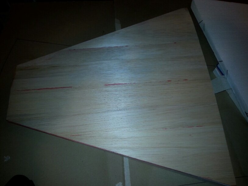

I got the leading edges and trailing edges glued on the stab/elevators and fin/rudder. I'm done teaching for the rest of the year until this fall, so now I will have more time to work on my build.

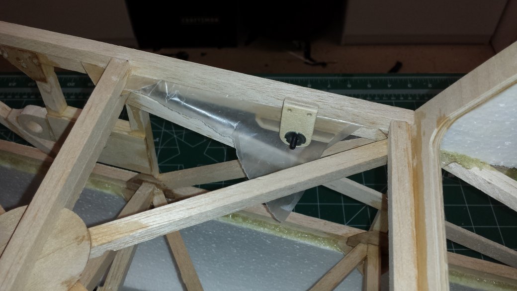

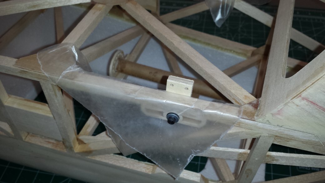

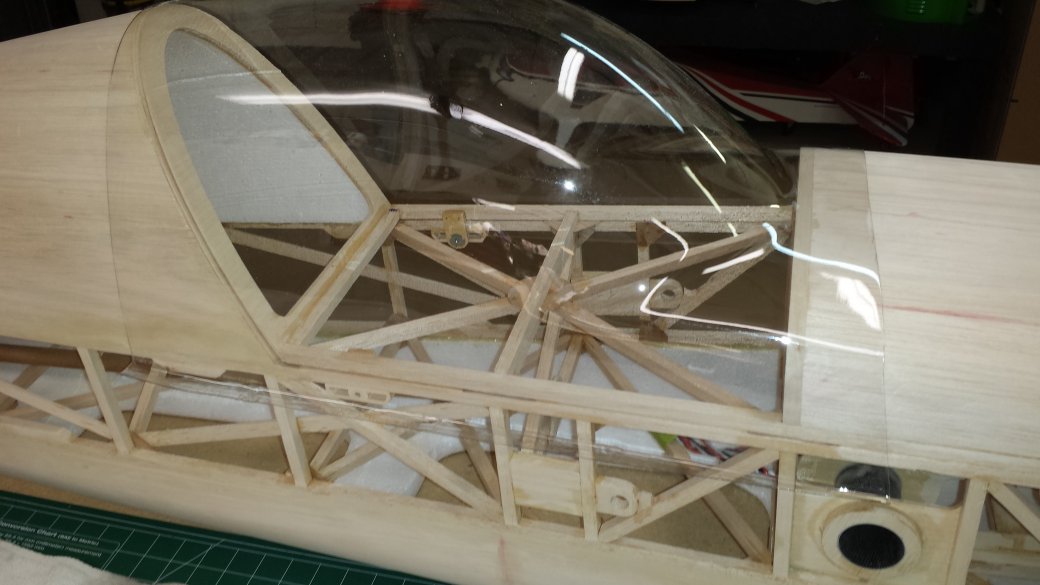

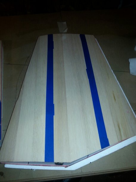

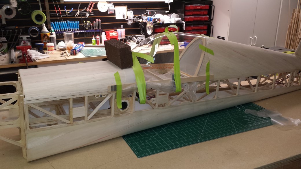

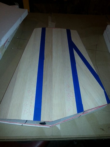

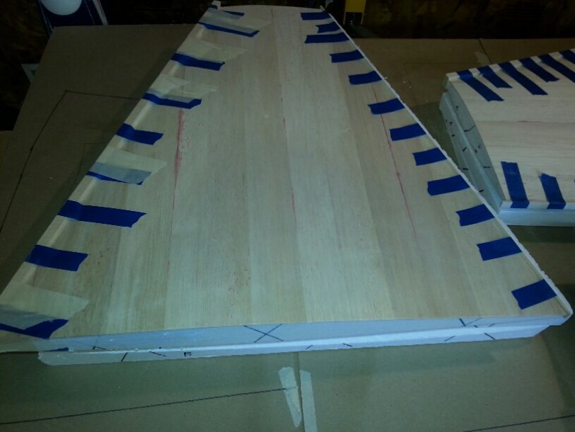

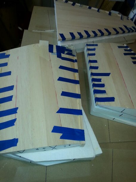

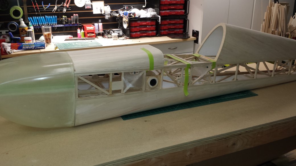

I got some time today to get some work done on mine. I finished up the canopy and hatch. It all came together very nice and fits up near perfect. I wish ARF's came with the canopy fitting so well.
Started getting to servo wires ready to pull threw the fuse. Tail is complete. Wings are sheeted and I will cut the ailerons tomorrow.
