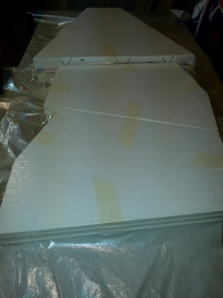

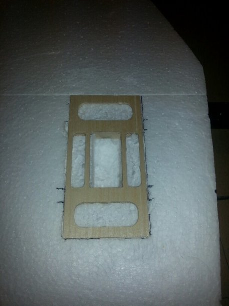

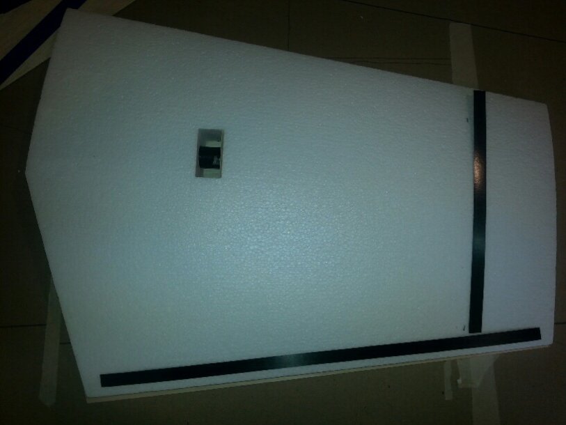

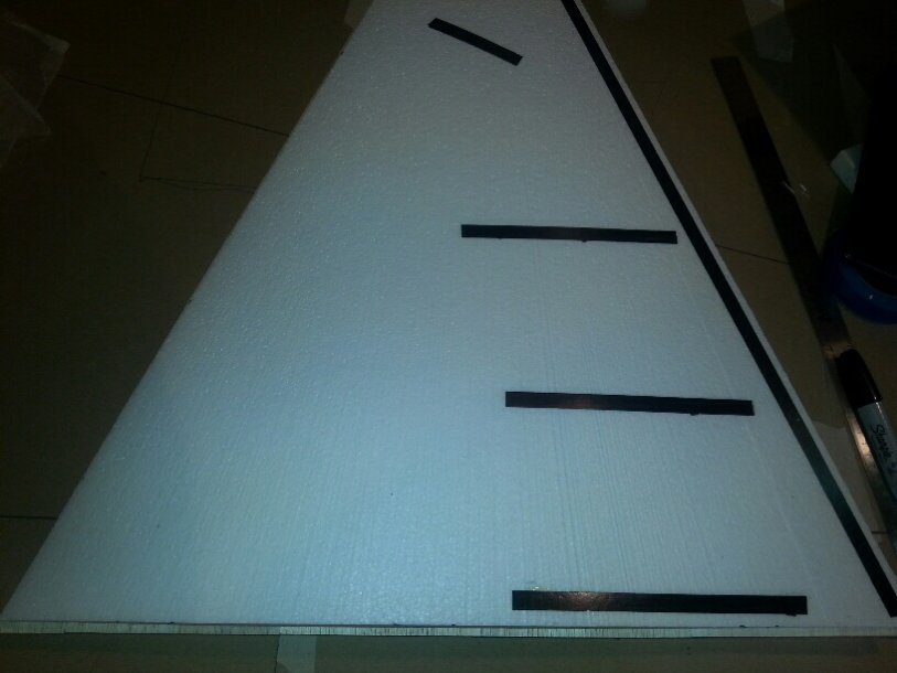

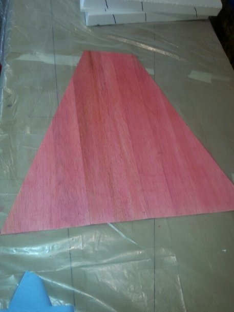

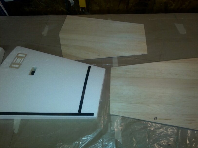

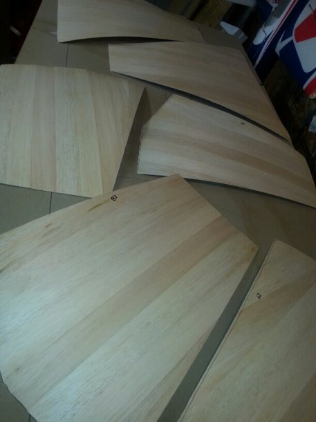

I got the stabs/elevators and fin/rudder in the bags today. You see the carbon fiber placement in the photos. I'm going to deviate from the plans and add counter balances to the elevators. I was able to get all three items in the vacuum bag with the small pump without any problems. I sure do like this vacuum bagging. I'm going to try and get the wings ready during the week so maybe I can get them bagged next weekend. Finally making some good progress again.
